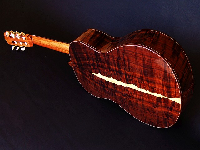

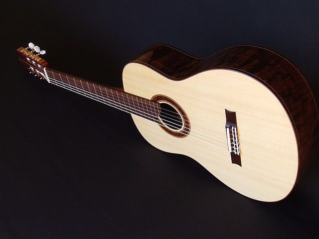

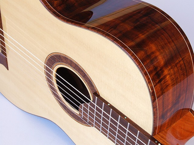

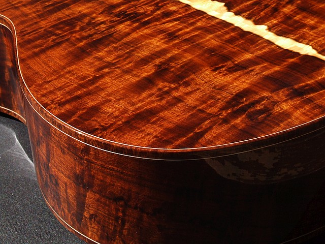

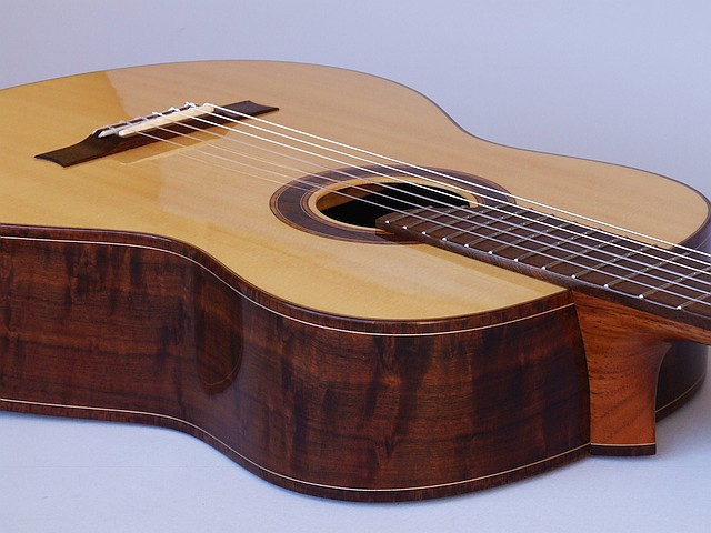

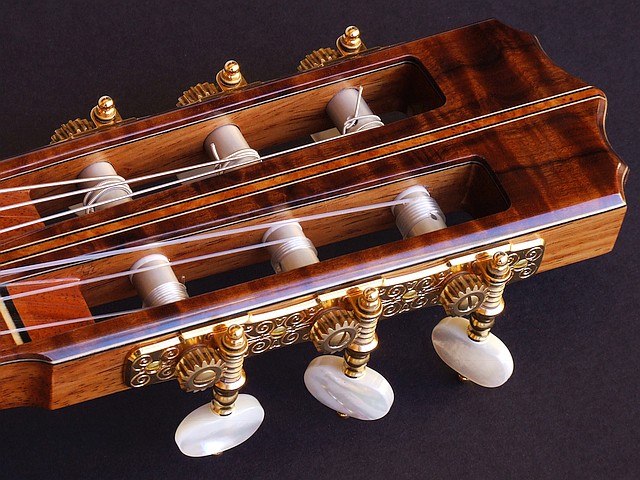

I did a search through the gallery and couldn't find anything with gidgee back and sides, so thought you good people might be interested in this one. Lutz top, figured gidgee back, sides and head plate, straight grained gidgee fretboard, "mad" gidgee bindings, NGR neck, "mad" gidgee segmented rosette with amboyna trim, with the amboyna also appearing in the head plate. Aus. Blackwood bridge, Gotoh premium tuners with real MOP buttons. All the gidgee was courtesy of Pete (Curly Timbers) and Jeremy at http://www.australianguitartonewood.com. Thank you, gentlemen!

Wow, Trevor, it looks amazing. Am I right in assuming the mass of the back and sides negates the need for any extra side mass? And, what was the gidgee like to bend?
Martin Taylor
- Posts: 1640
Re: Gidgee Classical
Thanks, Martin. The extra mass helps with projection, but the side masses are also about tuning the main top resonance. I managed to land the resonances close enough to where I wanted them without trimming with additional side mass, so as it happens, this guitar hasn't got any side masses in. It weighs about the same as an EIR guitar with sides masses.
Straight grained gidgee should bend fine - it just needs to be very hot, then it plasticizes well. The highly figured stuff is very difficult to get smooth bends in. The bindings have grain that runs straight through the thickness, so were a real challenge. Gidgee is very brittle when cold. As I was cutting the bindings some of them broke as they flopped off the saw!
nice work.
great that you got the binding to match.
what sort of bracing is it? fanned? and did you use traditional 3 braces on back?
how did you decide the bridge shape? , looks very light weight, do you have a bridge plate?
red cedar or Spanish cedar neck?
it is interesting you got the weight down, is it under 1.5kg?
what bracing wood inside?
can you do a sound sample?
I ask all this because I like it from the photos

kpcart wrote:nice work.
- Posts: 1640
Falcate for classical.kpcart wrote:what sort of bracing is it? fanned?
No. I haven't given a name to the back bracing I use, but I use the same system for SS guitars as well. It's in the book; three transverse braces and a "star burst" in the lower bout.kpcart wrote:...did you use traditional 3 braces on back?
Structural efficiency.kpcart wrote:...how did you decide the bridge shape?...
Yes, it's light. And no bridge plate.kpcart wrote:...looks very light weight, do you have a bridge plate?
No.kpcart wrote:it is interesting you got the weight down, is it under 1.5kg?
Spruce.kpcart wrote:...what bracing wood inside?
It was a commission. Gone already.kpcart wrote:...can you do a sound sample?
And thanks to everyone for all the kind comments.
