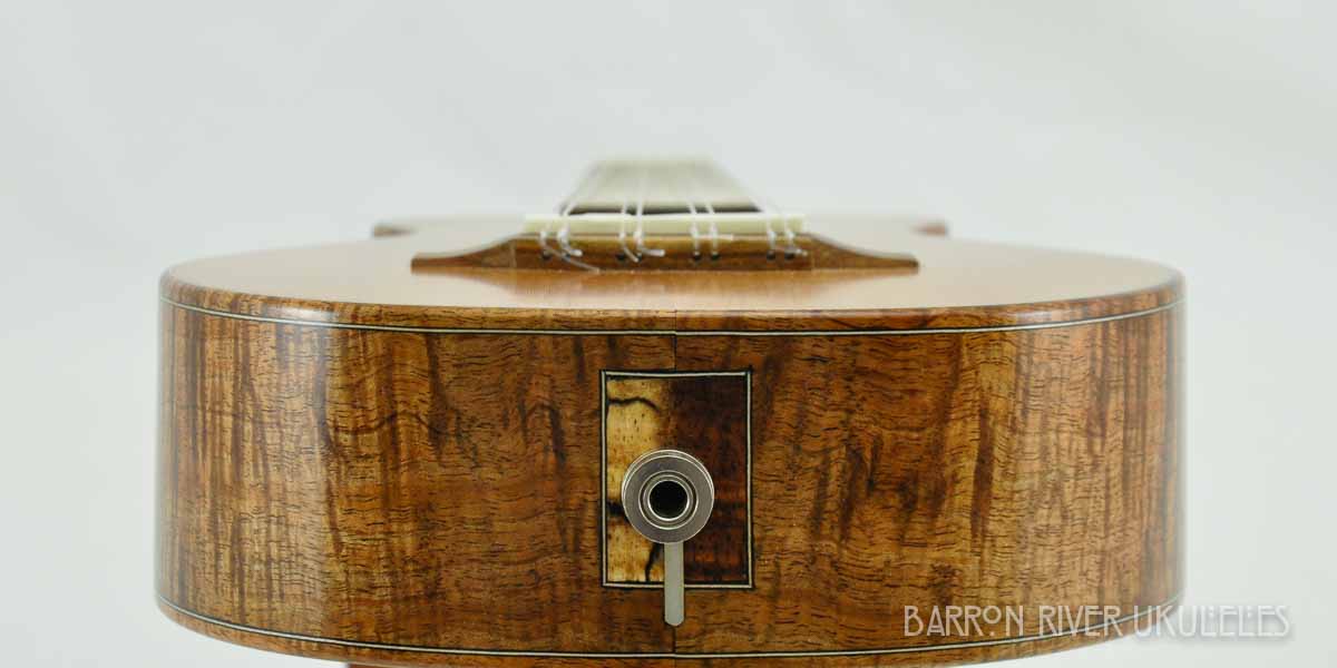

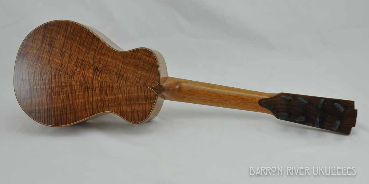

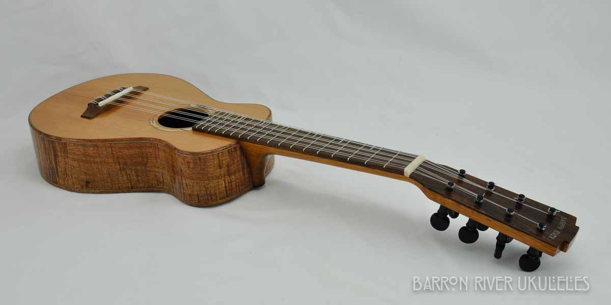

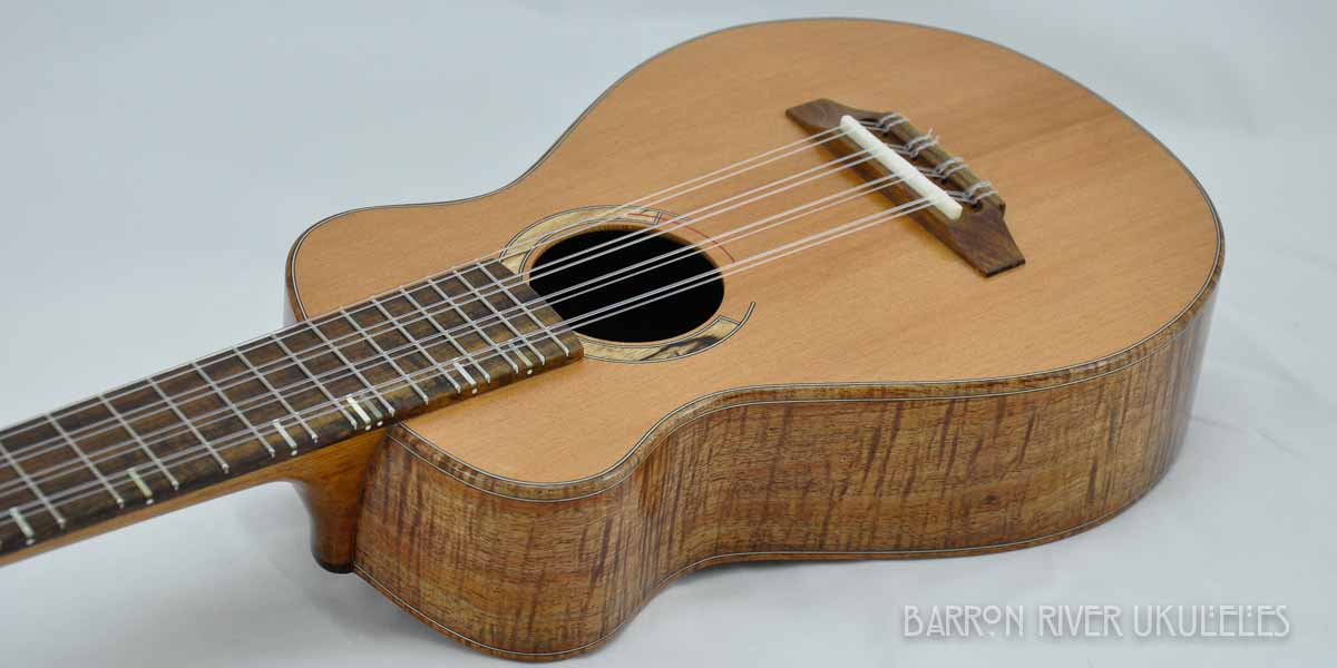

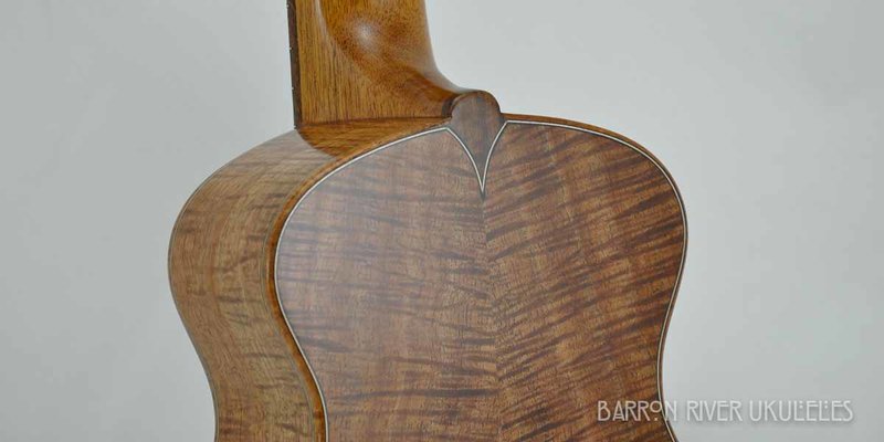

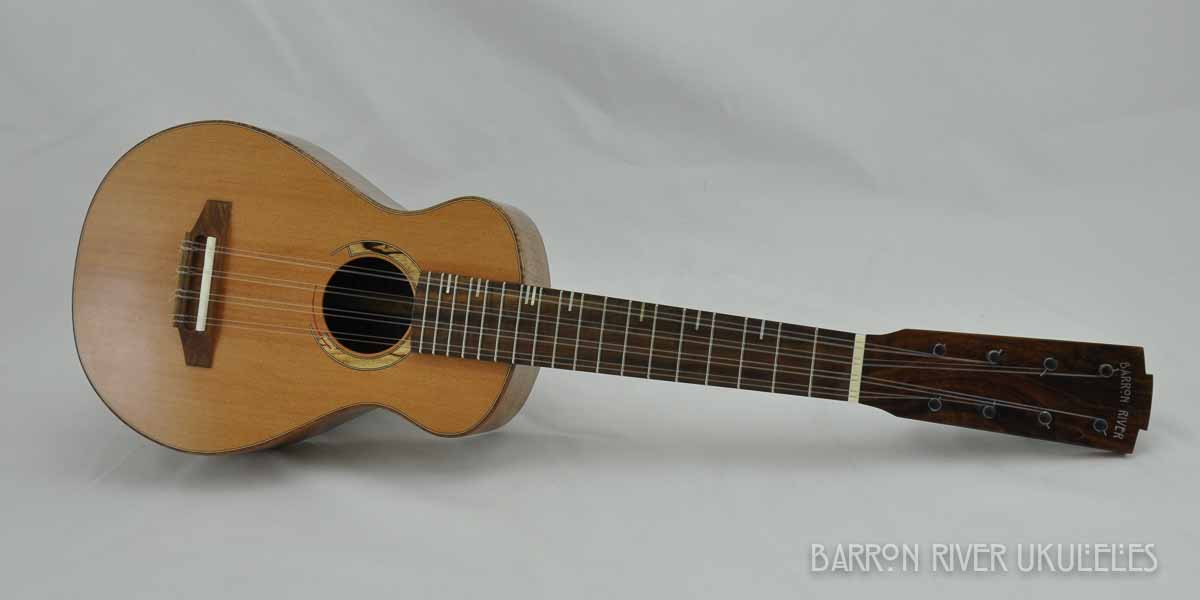

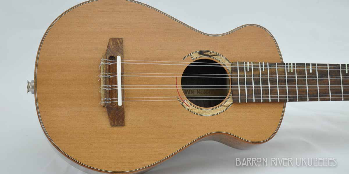

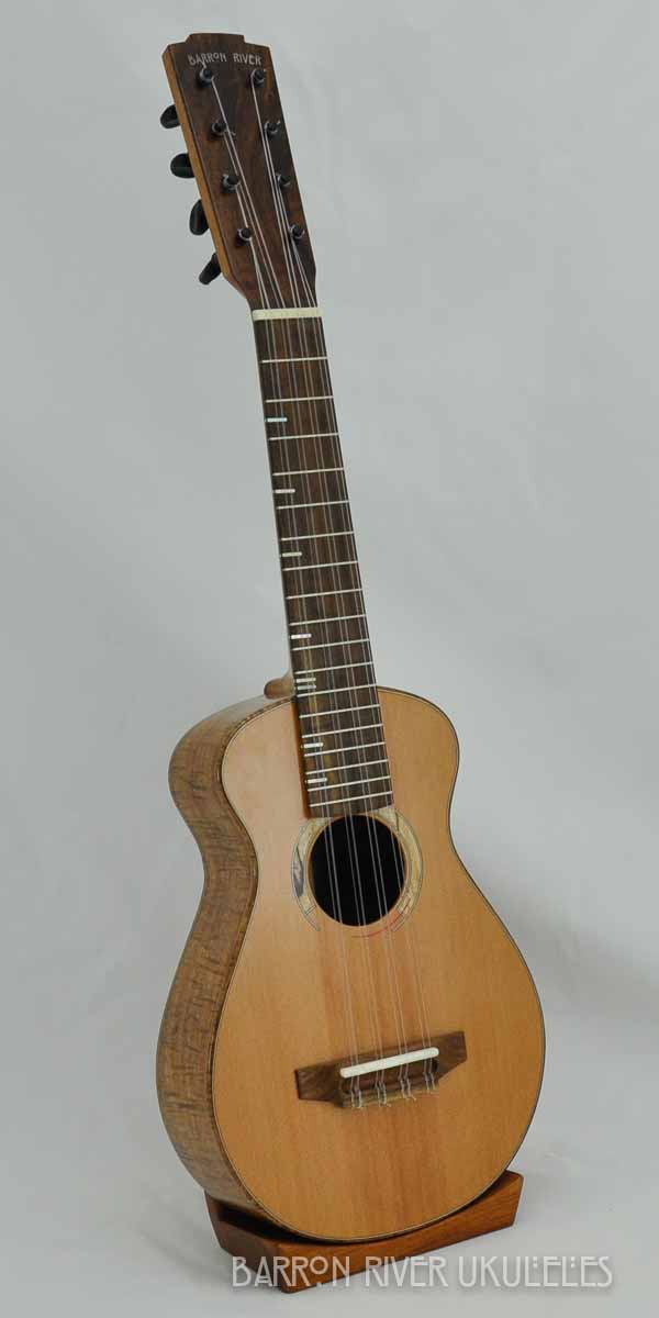

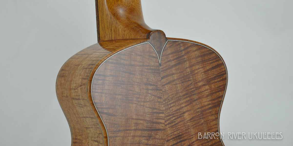

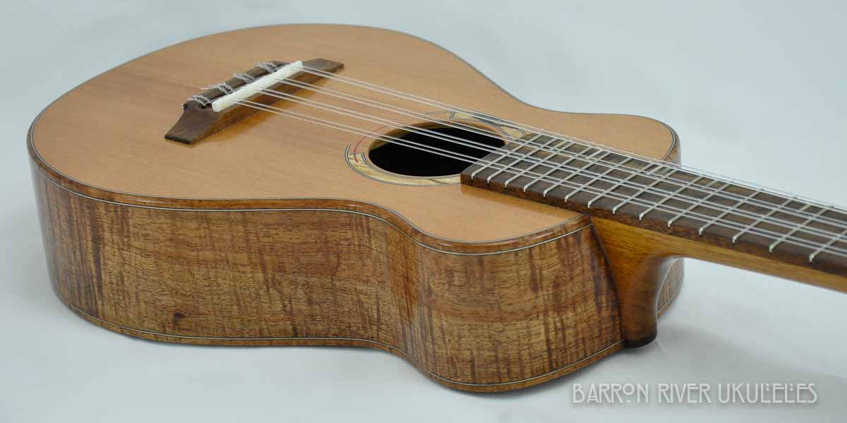

Post by Allen » Fri Sep 04, 2015 5:48 pm
A Taropatch uke is an 8 string concert tuned to gG, cC, ee, aa. I really have no idea why it's only the concert that is called this except that perhaps for the longest time a tenor uke wasn't considered a ukulele.
Made with Australian Blackwood and King Billy soundboard. the fret board, peg head veneers and bridge in Gidgee. K&K Aloha Twin pickup. Finished in 60% gloss lacquer.

That's an other ripper Allen. Real nice piece of Blackwood.
Did you make the fingerboard a touch wider to accommodate the extra strings?
Ross
Re: Blackwood and King Billy Taropatch Uke
Post by Allen » Sun Sep 06, 2015 5:47 am
Yes, they are typically either 38 or 40 mm at the nut. Double the difference from your normal nut and add that to what your string spacing at the saddle normally is.

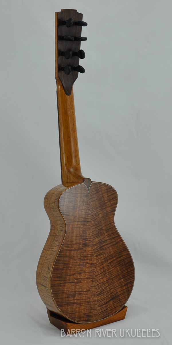

Nice work Allen. What are the tuners? Theyre planetaries?
Post by Allen » Thu Sep 10, 2015 11:01 am
Yes, they are Peg Head tuners at 4:1. Very light as there is a real possibility for something like this to be head heavy. These make it a perfect balance.
