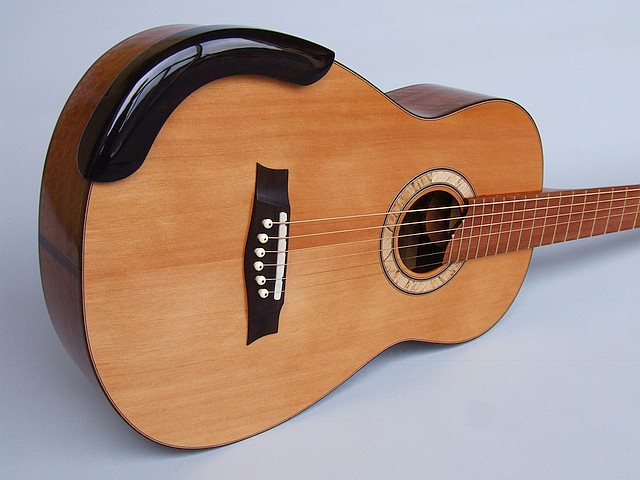

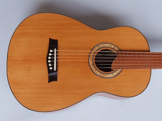

Strange as it may seem, this is the first 100% Aussie timbers guitar I've done, for a very much all Australian customer.

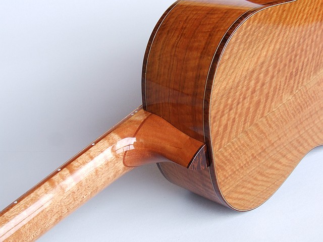

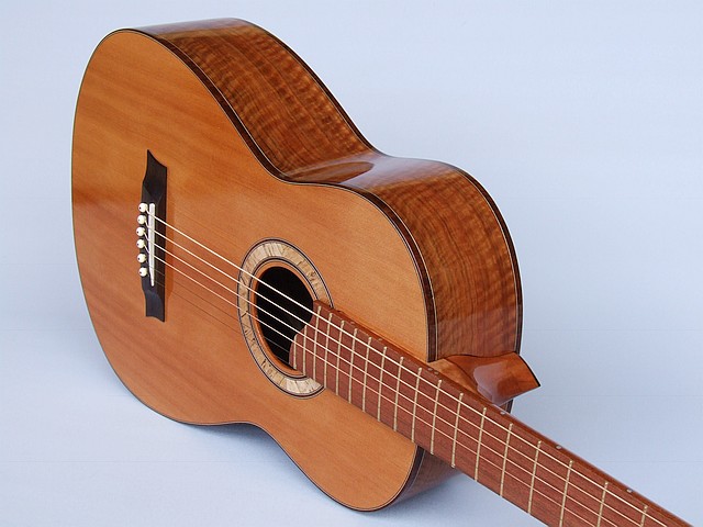

Wandoo B&S, KBP top, KPB/CF falcate top bracing, silver ash back bracing, that @#$! mad gidgee for binding, spalted blackwood rosette (gidgee rings), figured QLD maple neck, brush box fretboard, QLD walnut stained bridge (can still smell it every time I switch the bandsaw on, AND that stuff eats blades), brush box bridge plate, QLD maple end blocks, silver ash linings, stained brushbox magnetic arm rest. FP finish for top, B&S; nitro on the neck and arm rest.
It's based on my small classical body shape (340mm lower bout), but I tucked the upper bout in a bit; 24.9" scale, has a tilt neck and otherwise the stuff I normally do. Seriously loud for a small guitar. For any guitar, for that matter.

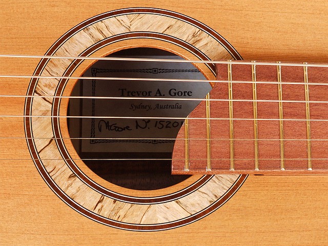

Thanks Wayne. The rosette was inspired by Jim Matheas (Melbourne). Jim and Jack (Spira) are making some really nice rosettes, mixing tradition and modernism. Those who visited the Melbourne Guitar Makers Festival will know what I mean.56nortondomy wrote:That looks great Trevor, all the timbers go nicely together and I love that rosette.

What sort of Stiffness modulus figures did you get on the King Billy soundboard Trevor?
Re: All Australian
I didn't know Sir Les played guitar.Trevor Gore wrote:Strange as it may seem, this is the first 100% Aussie timbers guitar I've done, for a very much all Australian customer.
- Posts: 1643
Re: All Australian
Normally, I can answer a question like that really easily, but it's not in my records, so I must have missed hitting "Save". The wood was not rectangular, with a bark edge diagonally across the upper bout and I remember doing a lot of fiddling around to get a result, which by memory was around 4GPa for Elong; really quite floppy. Ecross was similarly low, but no record. Probably below 0.5GPa. Maybe I didn't hit Save because of all the program changes I had to do to force a result. Anyway, the target thickness using the usual formula was 3.5mm; i.e. massive for such a small guitar. I do have a separate record for that. The T(1,1)2 is 191Hz, which is close enough to what I was aiming for and the T(1,1)1 is at 100.6Hz.jeffhigh wrote:What sort of Stiffness modulus figures did you get on the King Billy soundboard Trevor?

I used the 3.5mm number. Then the usual edge thinning etc. during the build. I don't have a record of the density (gets saved with the other data) but by memory it was "average" for KPB, neither particularly high or low. I think the reason the guitar worked so well was that it was small - so the overall soundboard mass was still reasonably low. A lighter soundboard may have sounded too banjoey., and on a larger guitar this wood would have been well down on monopole mobility. I have it on good authority that KPB does come in light and stiff, but I haven't seen any of that stuff yet.jeffhigh wrote:How did you end up on thickness, did you use the 3.5mm target or compensate in some other manner
Probably will work OK for small guitars - but too small and the bass drops out too much.jeffhigh wrote:When I tested a few soundboards in my stash a few years ago with deflection testing (pre the Books) they were coming in under 5Gpa and without being particularly low density to compensate.
