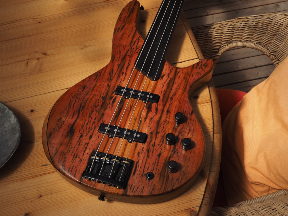

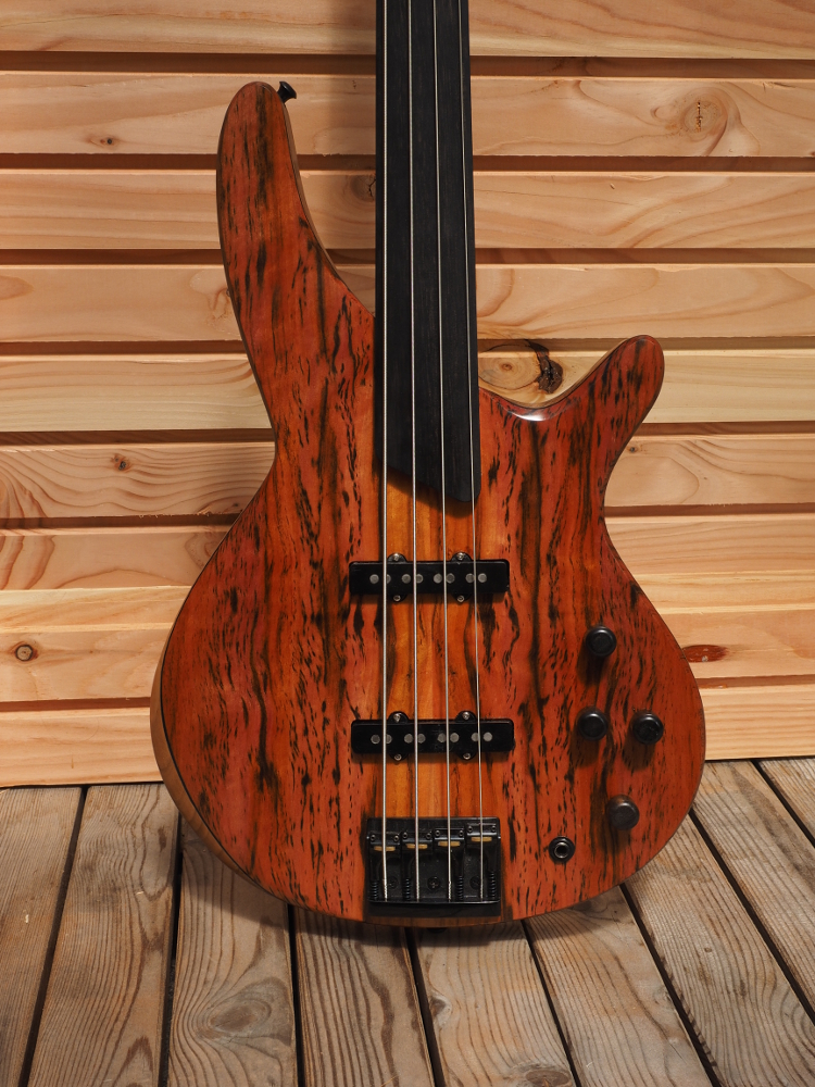

finally got round to finish my fretless bass
body is chamberd one piece european walnut
top is tiger myrtle (from australiantonewoods - thanks mate!)
Ovangkhol neck with ebony fretboard
splitcoil Jazzpickups wound by me, they sound a bit "rounder" than standard ones but still typical jazz
Schaller 3D piezo bridge
Schaller mini tuners

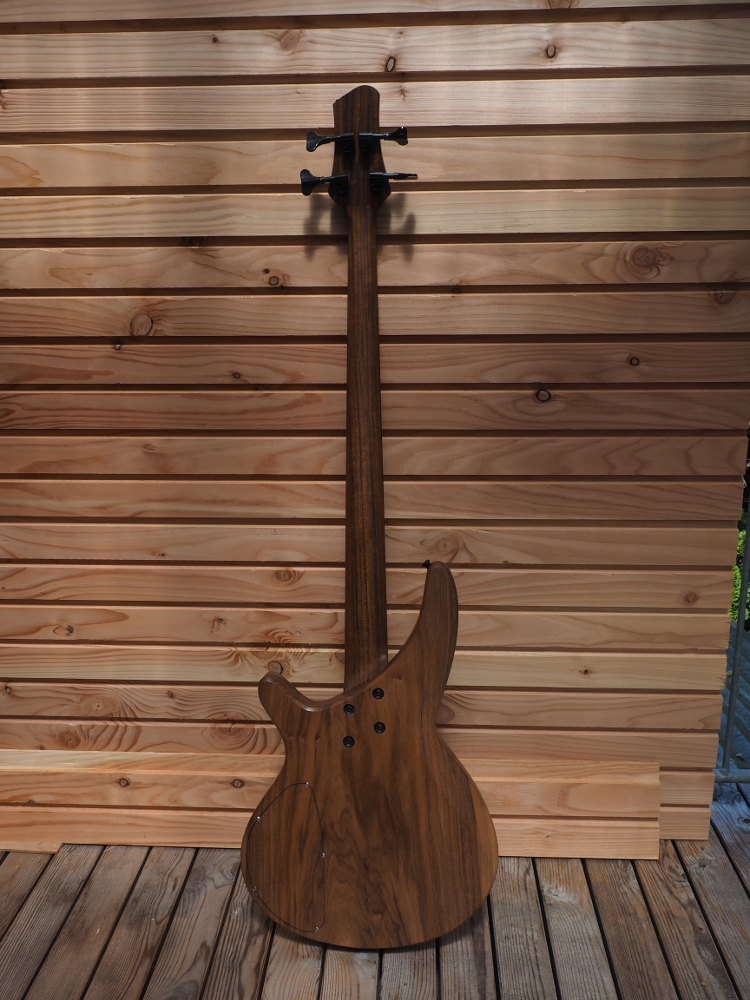

control cavity cover is cut from the back for grain through effect
volume/volume/volume/tone passiv controls (piezo is buffered)

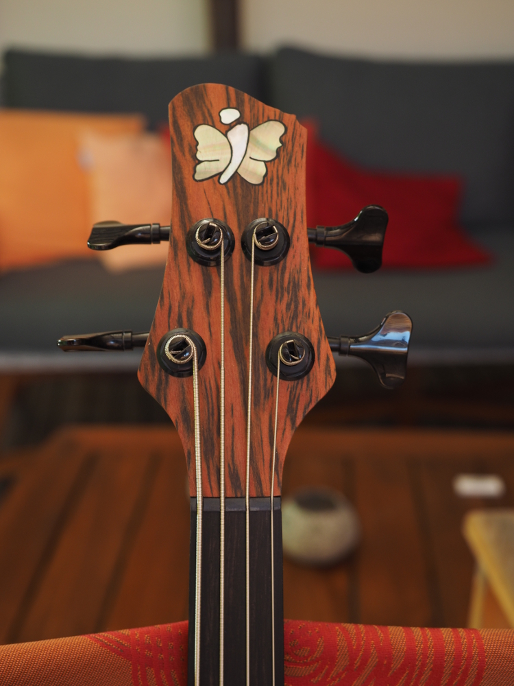

Fodera inspired headplate inlay - J for Josh :)

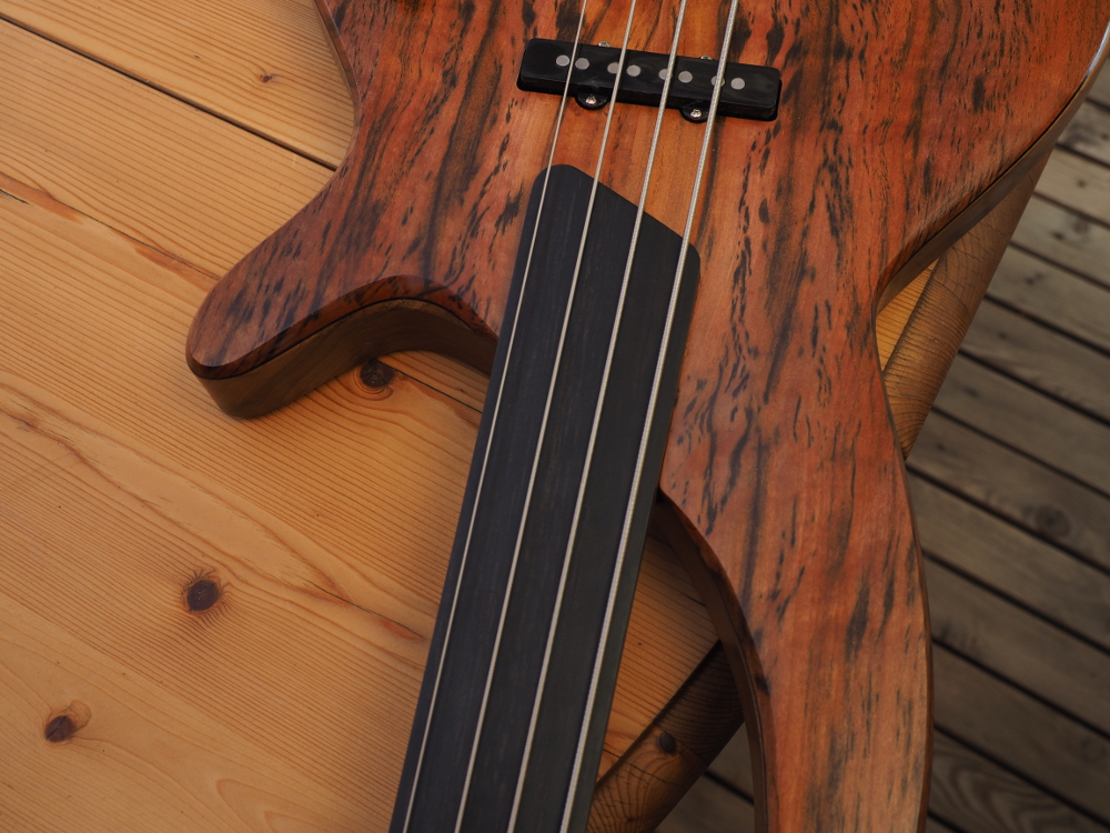

no dots or any of that crap, not needed anyhow
special compensated nut, that was tough to do... :wink:
bridge stringspacing is 19mm, bridge is not adjustable
my own bodyshape, originally drawn with pickguard
another bass is in the build
usually I prefer opaque instruments, but it just didnt feel right with this top :lol:
and since it didn't turn out too much like a mueslicaster (if you know that term) I named it "cereal"
logo is a nod to fodera, who I adore a lot
as a buffer for the piezo I used the one from cafewalter.com
sounds pretty neat with the bridge, none of the well known problems
what I still nedd to do is change some screws for black ones and get a proper black jack
so far I just painted it black and that aint a longterm solution at all...
best
j

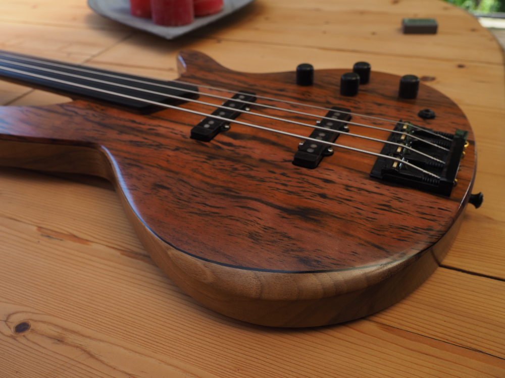

Love it can I ask what you used between the top cap and the body to get the black line that bit I like a lot ,cheers John.

used 0.5mm black fiber as the middle layer
