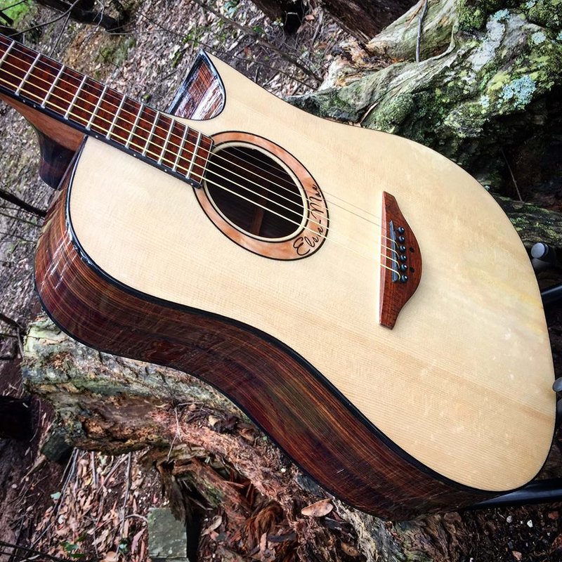

Stunning Allan! Well done! :D
What's the extra 2 hole sin the bridge? Are they carbon fibre pins?
demonx
Posts: 1395
Location: Ballarat Victoria
Re: Engelmann/Rosewood Dread cutaway - built with the assistance of CNC
Post by demonx » Thu Jun 30, 2016 1:15 pm
felix wrote:Stunning Allan! Well done! :D
Thanks.
The two holes are small bolt's which act as bridge mounting security. It also makes glue/clamping the bridge a breeze!
Some people may say it's not needed, but the person whom I pinched this method from told me a story about one of his customers who was doing an Australian tour and after much travel, hot cars, being banged around etc etc the bridge had come unfixed. The bolts held it in place and he was able to finish the tour using the guitar until it could be repaired. Such a simple thing, two tiny little bolts can make a massive difference.
Steve.Toscano
Posts: 495
Location: Port Stephens NSW
Post by Steve.Toscano » Thu Jun 30, 2016 2:12 pm
Thanks Allan.
RE: the story you were told i'd think if the guitar had been traumatised so much that the bridge glue joint failed there would also be other failures having a drastic affect on the guitar that would make it almost unplayable/sound terrible - bracing is the first to come to mind.
I also wouldn't hold much faith in 2 bolts holding down the bridge well enough (after a glue joint failure) without sound drastically changing.
Out of interest: How much weight is added by the bolts?
