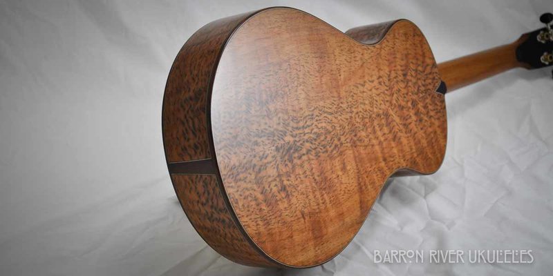

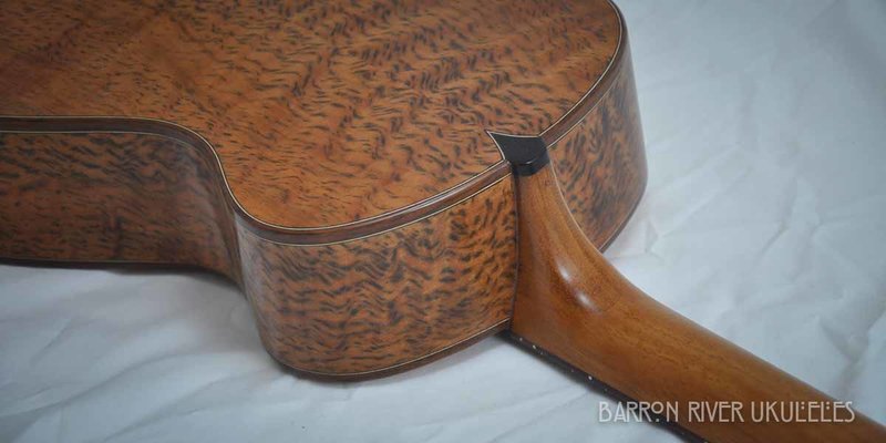

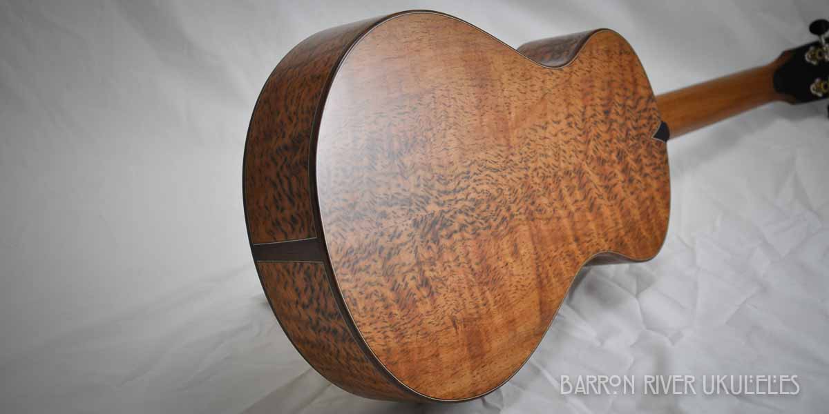

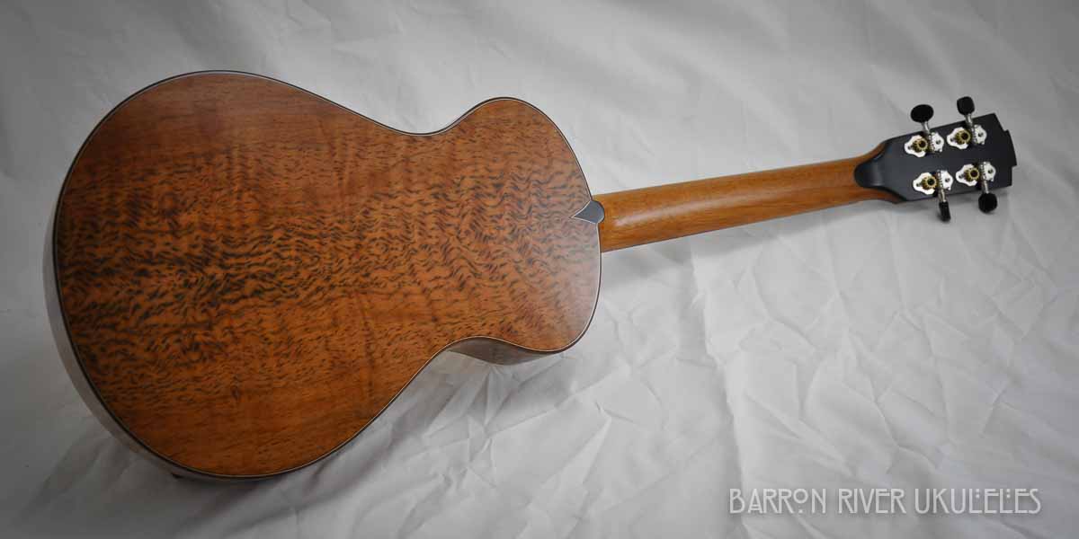

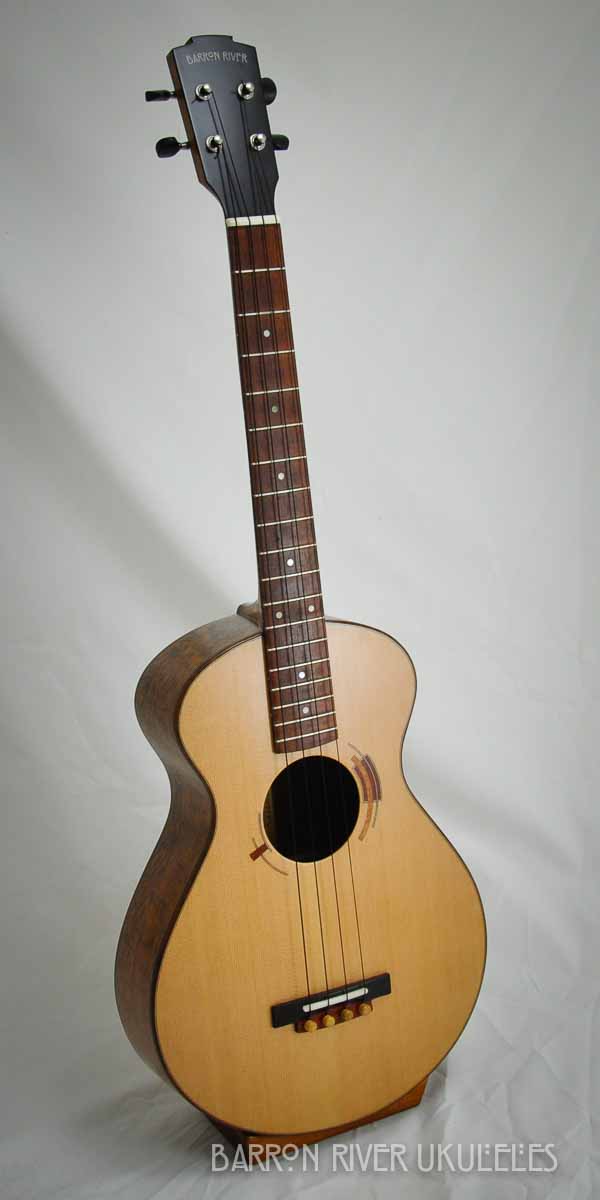

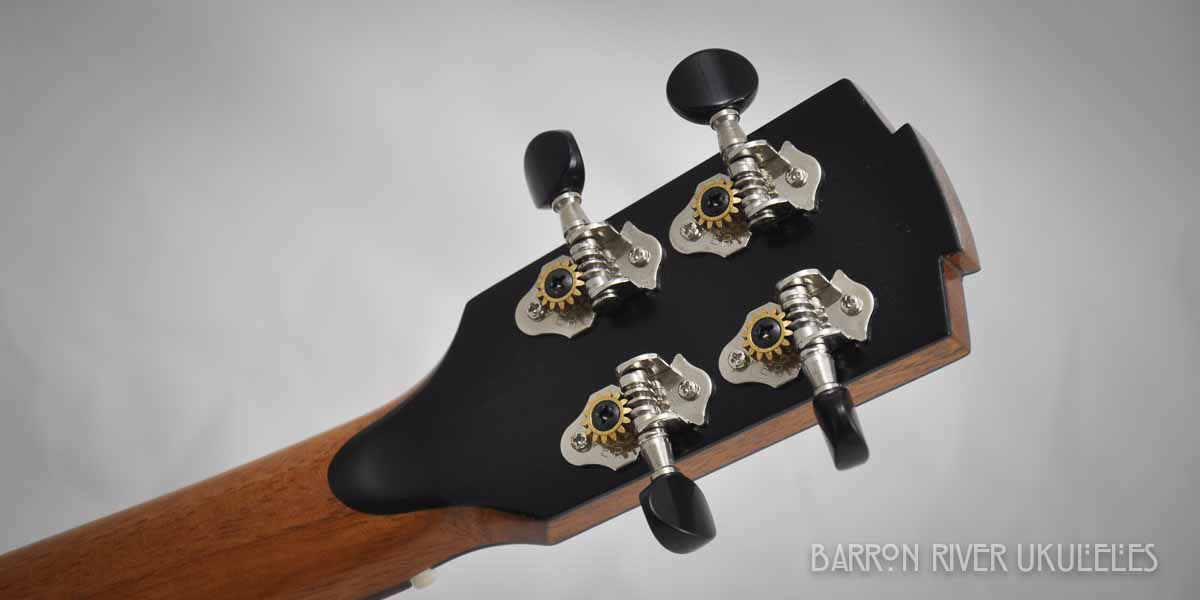

Post by Allen » Fri Oct 21, 2016 7:20 am
I'm getting a lot more requests for Baritones in the last year. This one features some really nice Tiger Myrtle with a super stiff Western Red Cedar soundboard. Fret board in Honduran Rosewood and bindings in some really dark Tiger Myrtle. Finished in 60% gloss Microtone and tuned two DGBE with Worth Browns.
