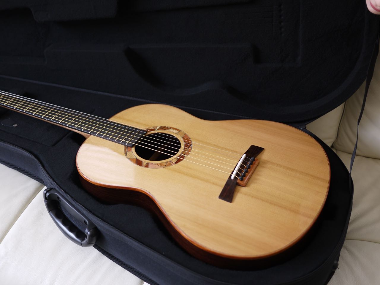

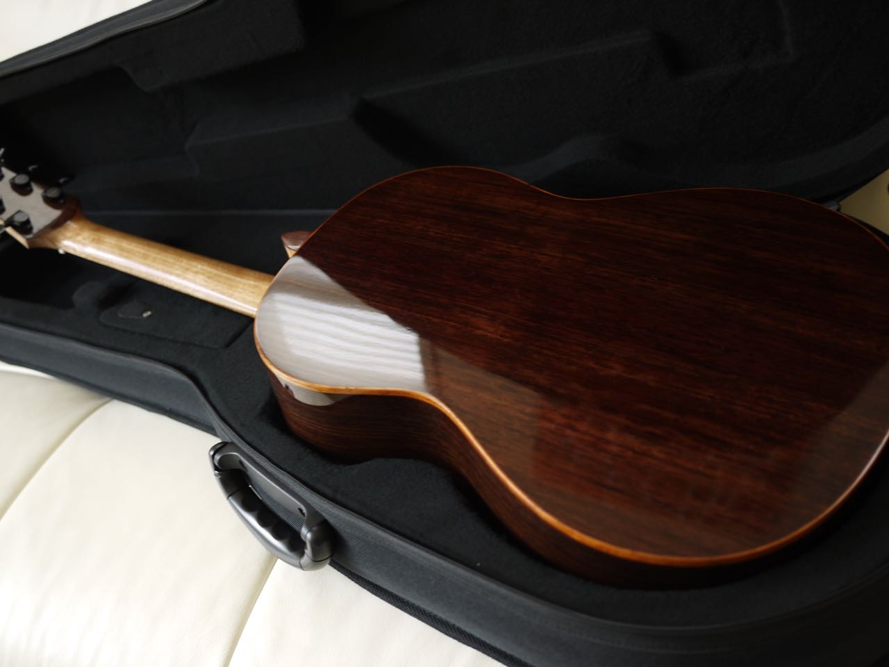

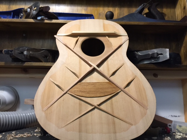

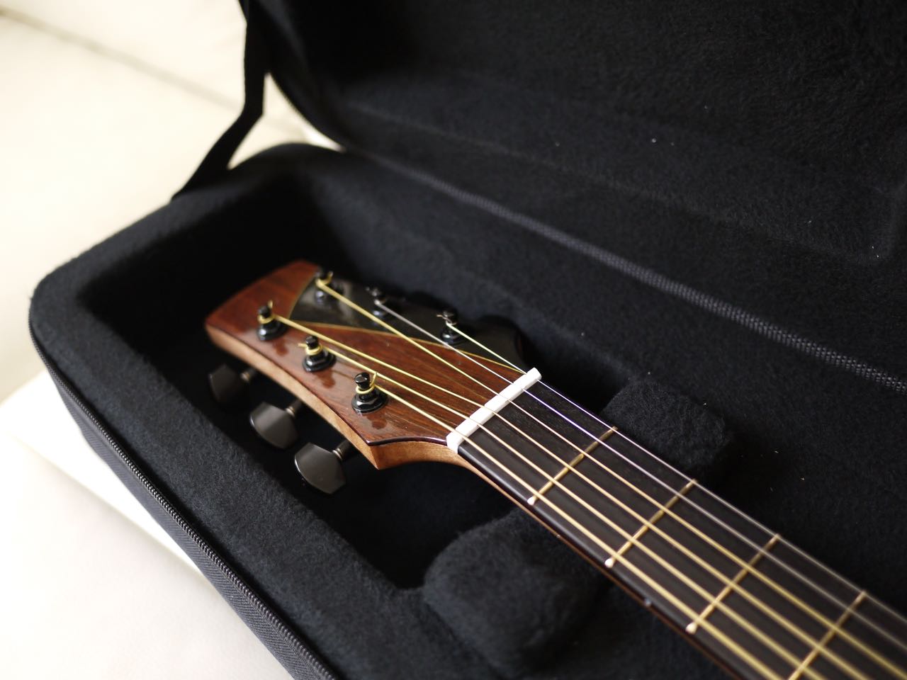

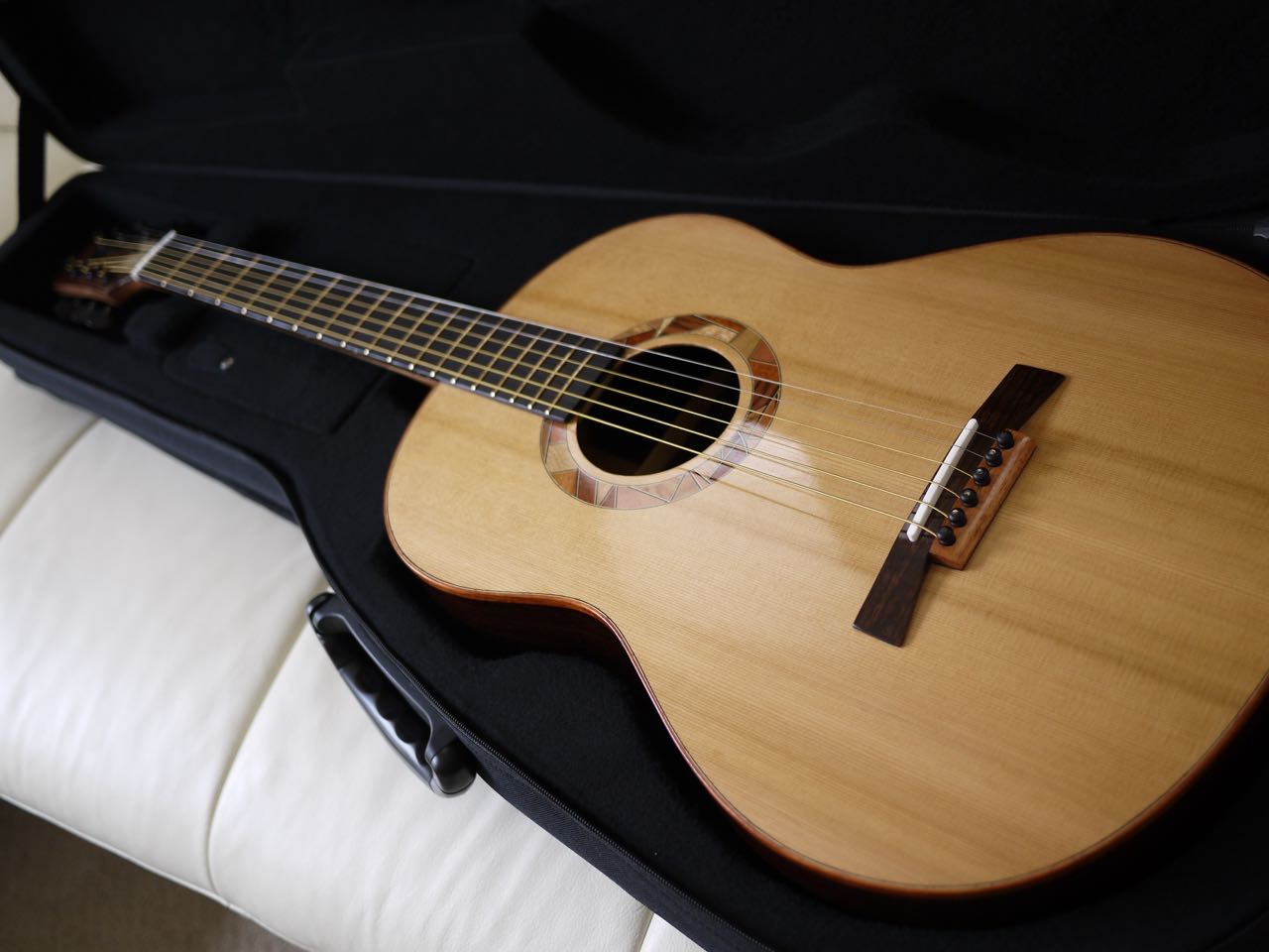

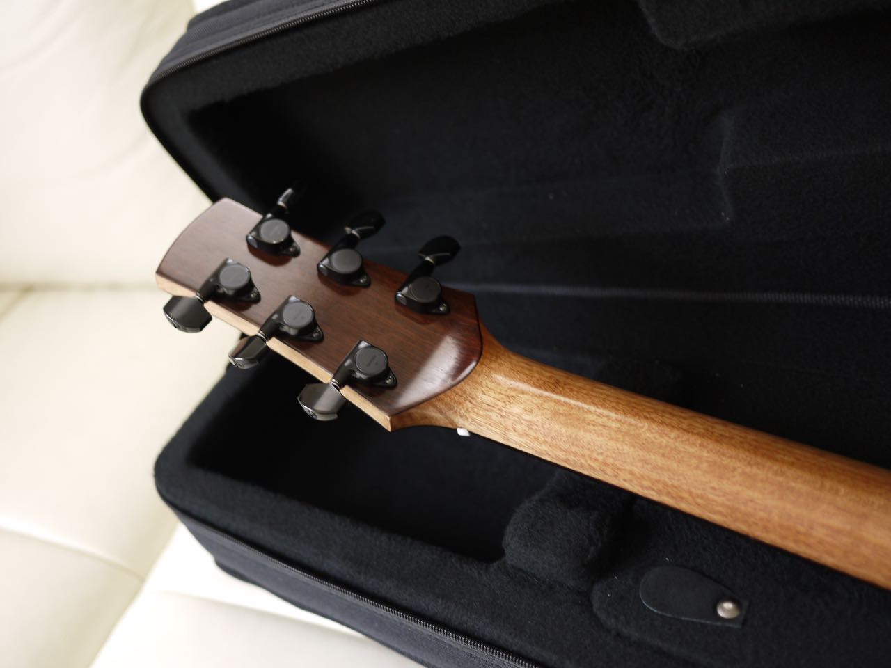

Post by Fisherman » Sun Feb 12, 2017 8:58 pm
Acoustic guitar built to a classical shape (I just like that shape...)
Indian rosewood back and sides, cedar top, all Australian woods mosaic rosette.
New Guinea rosewood bindings. New guinea RW/IRW bridge, Gotoh tuners. X braced, fully french polished.
Super clean sounding and very responsive - it was built for fingerstyle playing.
It's light years better than the first guitar I built as this one was built under the guidance of local guru Jens Ploesser. While it was great to finally put strings on the guitar and to hear it I have mixed feelings about finishing the guitar and the course as it was a great way to spend Saturday afternoons. Whether we were building, planning out the next step or just chatting I was always learning something new and I reckon my skills improved from an L plater to a P plater.

Post by lamanoditrento » Mon Feb 13, 2017 8:24 am
Very nice. I like the rosette and also the bridge design, which reminds me a little of Allen's ukes :cl :cl :cl :cl

Post by Jim » Mon Feb 13, 2017 9:38 am
Beautiful work, love the design elements, really makes it stand out. How did you find the french polishing process?

Post by Fisherman » Mon Feb 13, 2017 3:45 pm
lamanoditrento wrote:Very nice. I like the rosette and also the bridge design, which reminds me a little of Allen's ukes :cl :cl :cl :cl
Thanks! It was inspired by the bridge pictured in this thread: viewtopic.php?f=25&t=7605
Although their bridge smiles and my bridge frowns! It just seemed to look better that way to my eye on this guitar. I laminated a layer of indian underneath to strengthen it.

Post by routout » Mon Feb 13, 2017 3:53 pm
It's a nice package for sure ,yes the bridge reminds me somewhat of the Japanese building style that uke is nuts :D .The guitar fits together as a package it's hard to design elements that come together ,I have many a scrap paper scribbling. :lol:
