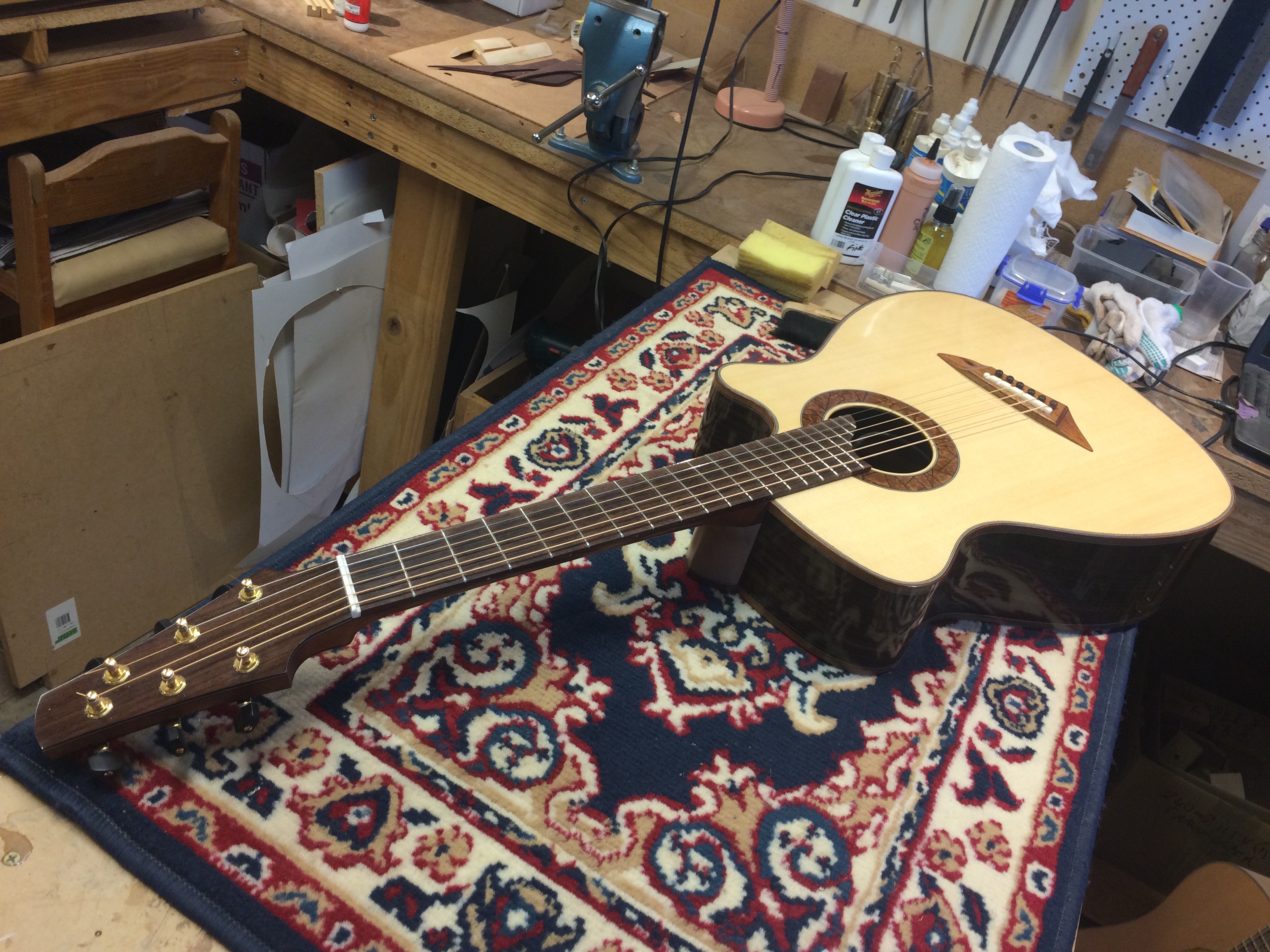

Post by kiwigeo » Fri May 26, 2017 6:31 pm

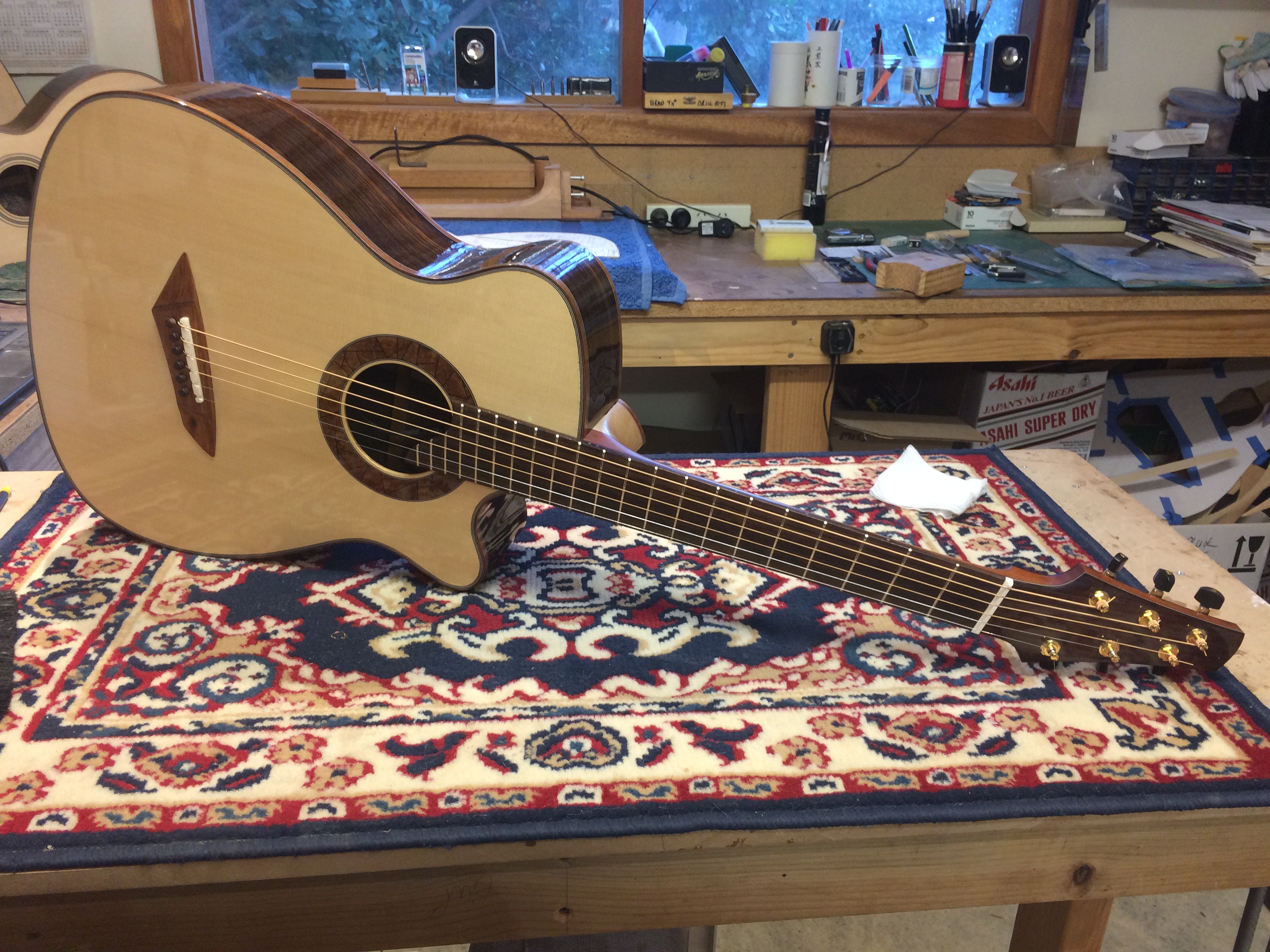

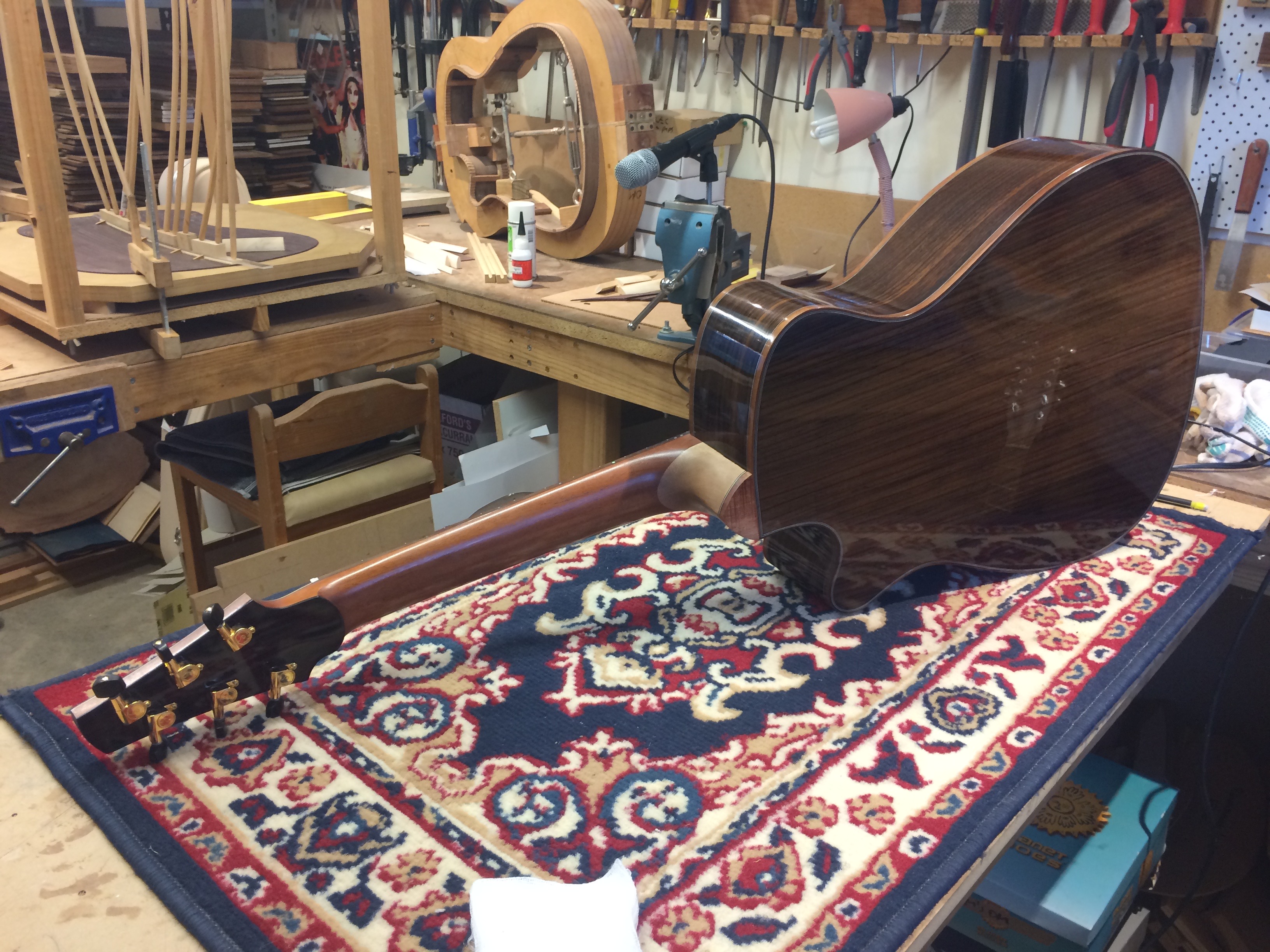

Don't think Ive ever posted in this sub-forum. Anyway today I finished the multiscale Gore OM after 2 years of slog. Tomorrow Kym it's new owner picks up the guitar.
Specs:
Top: Swiss Spruce
Back and Sides: Indian Rosewood
Neck: Queensland Maple
Fretboard: Indian Rosewood
Bridge: Tasmanian Blackwood (with CF, second CF layer between top and bridge patch)

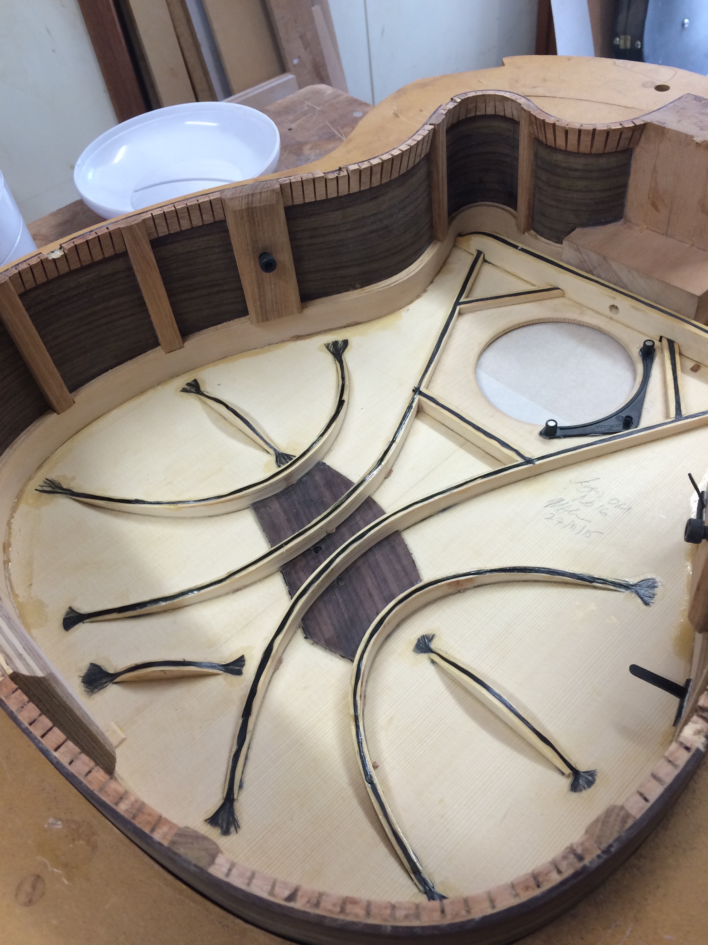

Bracing: Falcate made from triple laninated sitka spruce.
Rosette: Jason Kostal inspired "stained glass" design using Coobah burl.
Finish: French Polish (Shines hard shellac)
Scale Length: 658 to 638mm
Bias Fret: 7th Fret

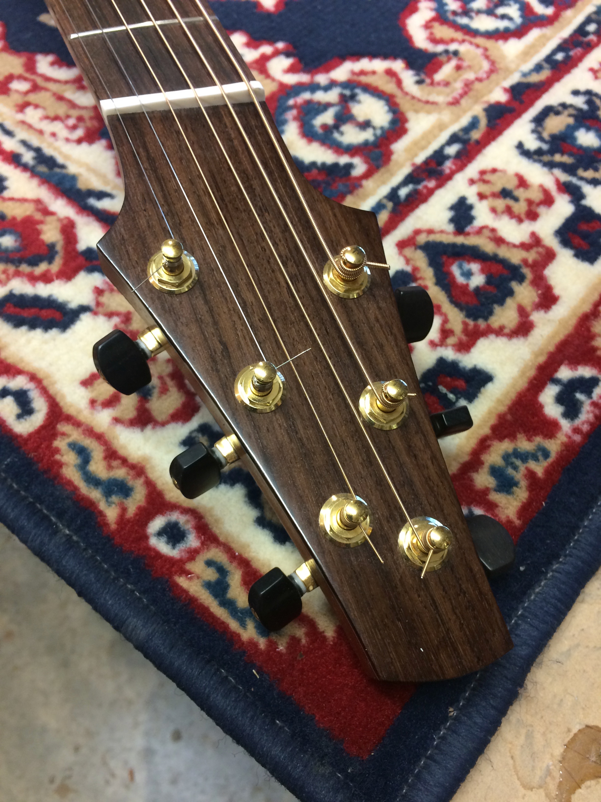

Tuners: Schaller M3 minis. Straigh string pull headstock with Indian Rosewood veneer.
Strings: D'addario medium guage.
Pick up System: Fishman Elipse mini mic/under saddle with on board preamp/mixer.

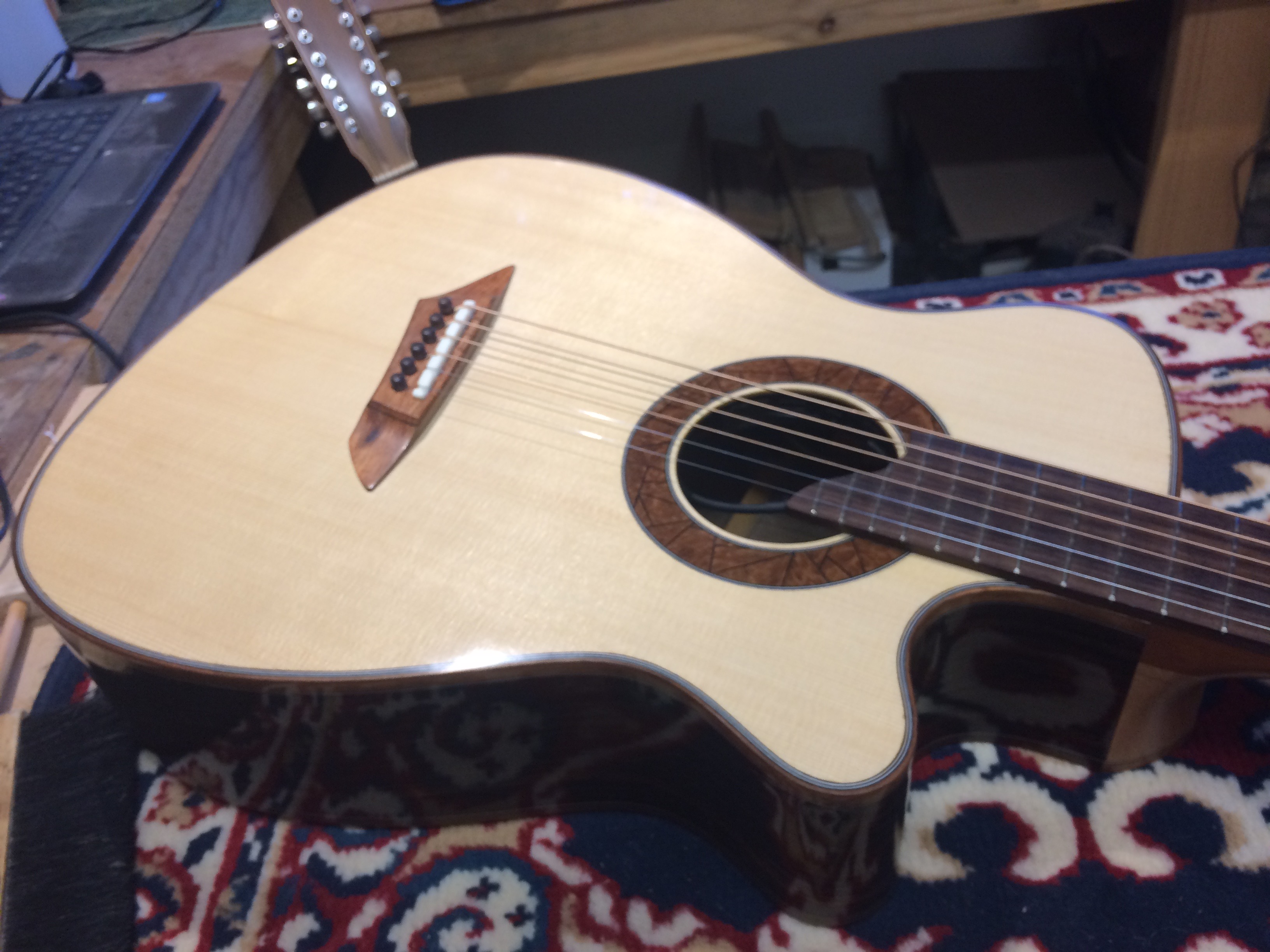

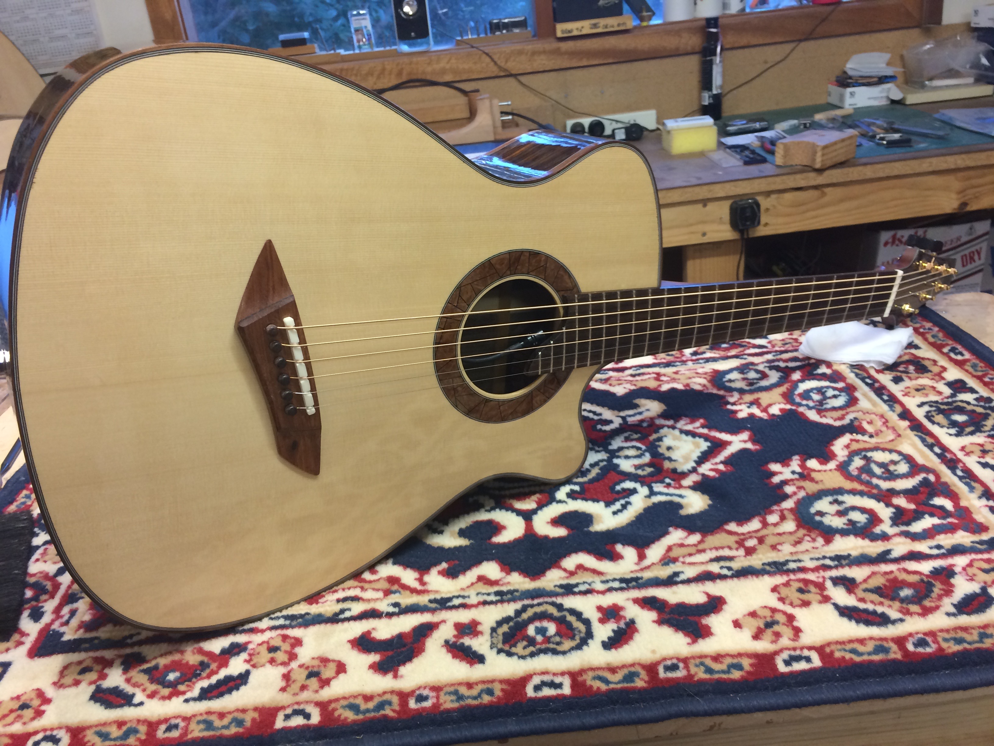

Beautiful work alright. You have really a great visual balance of the bridge which I often think look cockeyed on multiscales :cl :cl

Thanks Trent, I obsessed for weeks over the bridge design. I basically trawled the internet for every picture of a multiscale bridge I could find and found one that worked for me. I find the curves of the design I arrived at go well with the curves of the guitar body.

Here's Kym the guitar's new owner (also a forum member) playing his new baby for the first time. I also did some final tap testing on the instrument. T(1,1) = 97Hz, T(1,2) = 182Hz and T(1,3) at 232Hz. The back appears to be coupling with the top giving a decent peak on the top spectrum. With Kym playing the instrument I got a decent chance to listen to the guitar..she's got alot of volume but she's evenly balanced. Plugged in she sounded great on just the under saddle pickup but with the in-body mic mixed in she starts to sound a bit too alive....

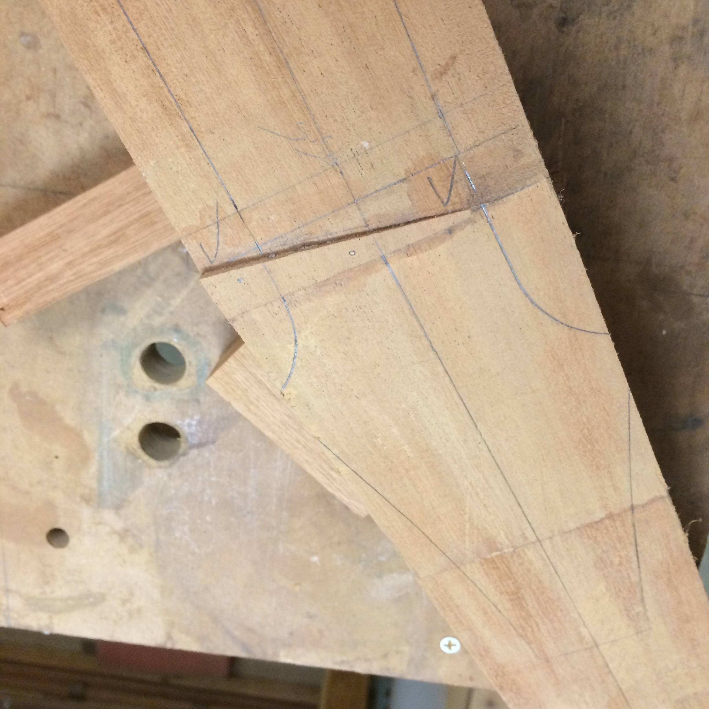

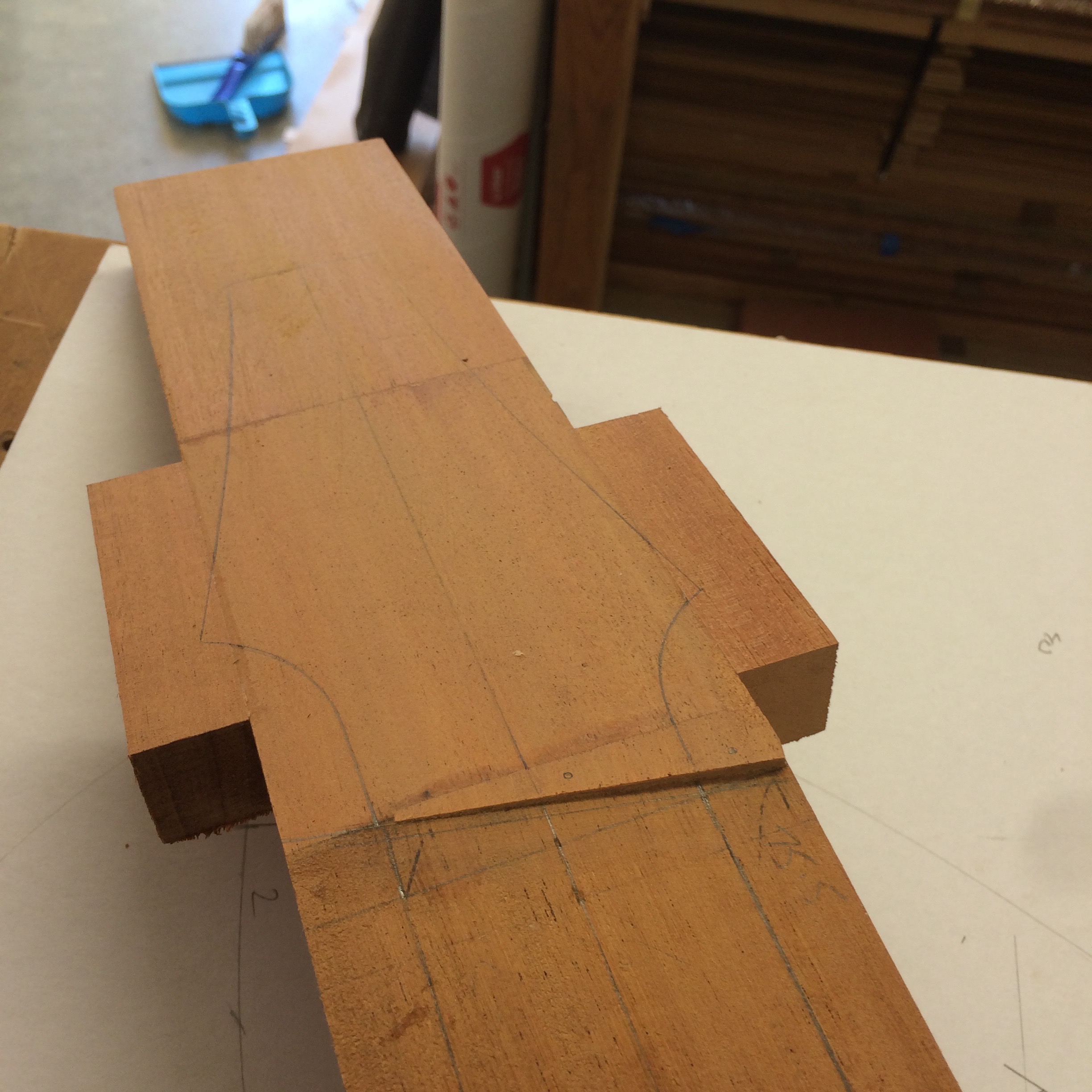

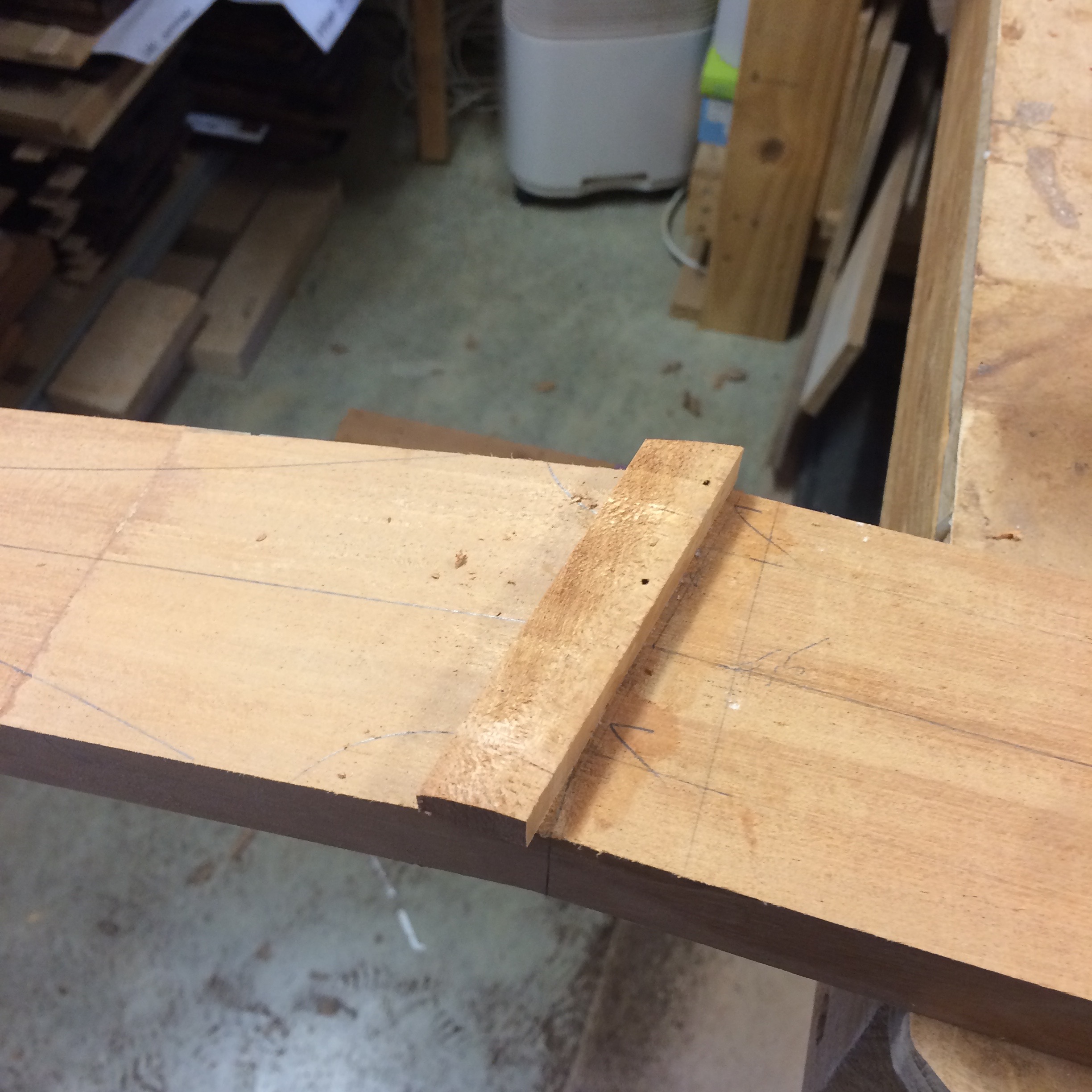

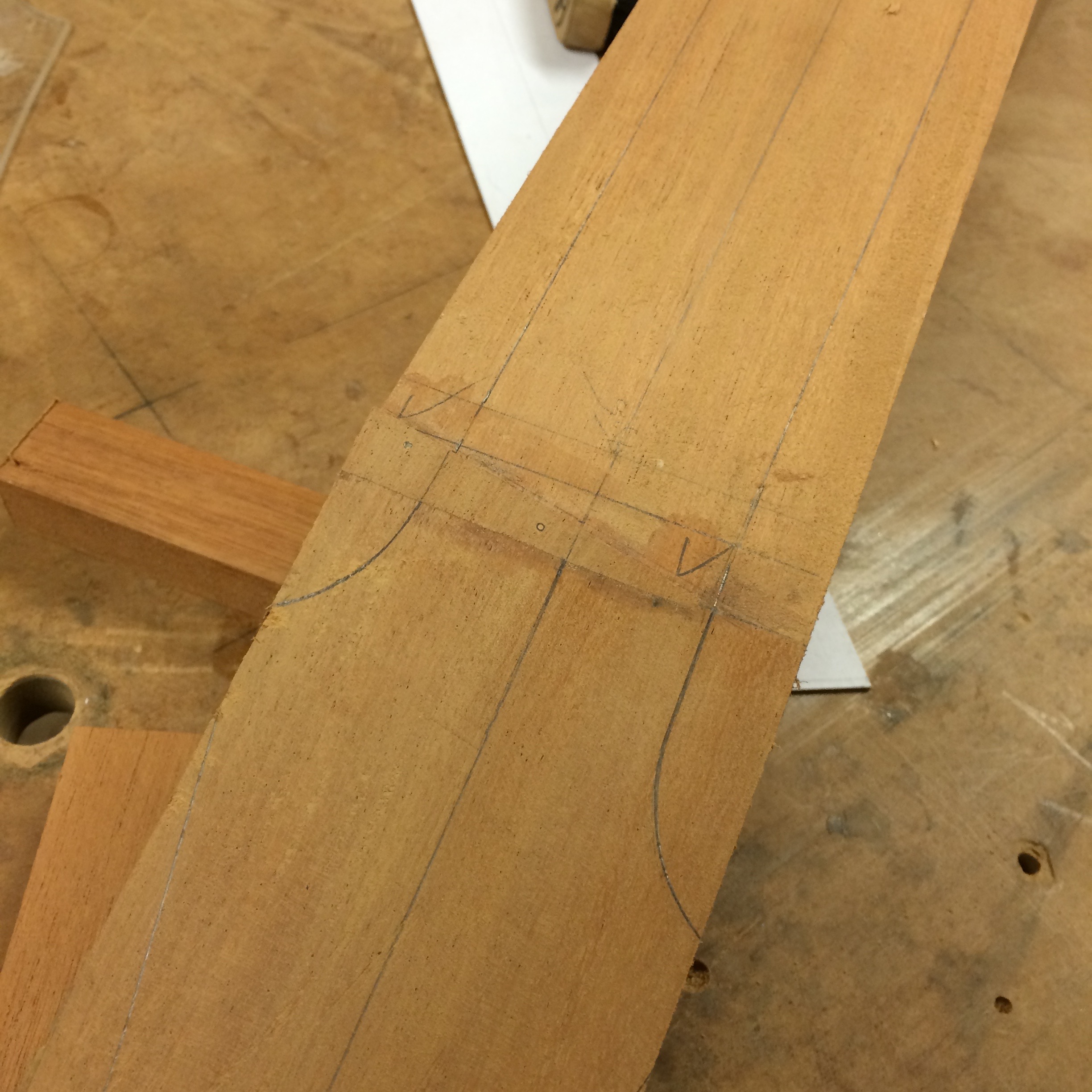

Hi Ross,

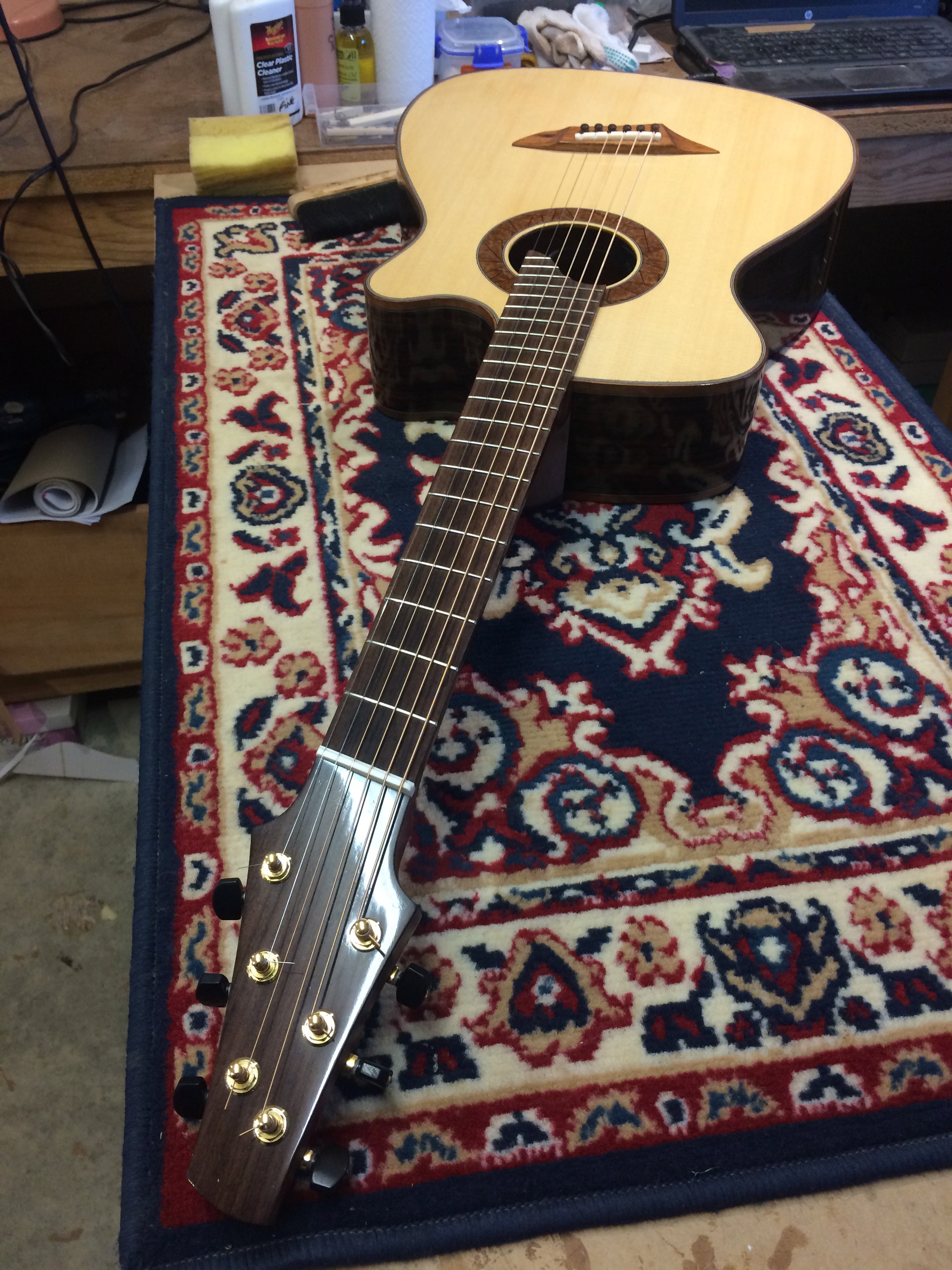

Braces themselves haven't been modified apart from being a tad higher (9mm) than on Trevors plans. Because the bridge is angled the braces have been positioned to maintain equal area between each brace...this means the braces aren't symmetrical and means individual primary and secondary braces have to be made up rather than making up one brace and slicing it in two as per Trevor's book.
I used Dave White's method for making up the nut end of the headstock.
