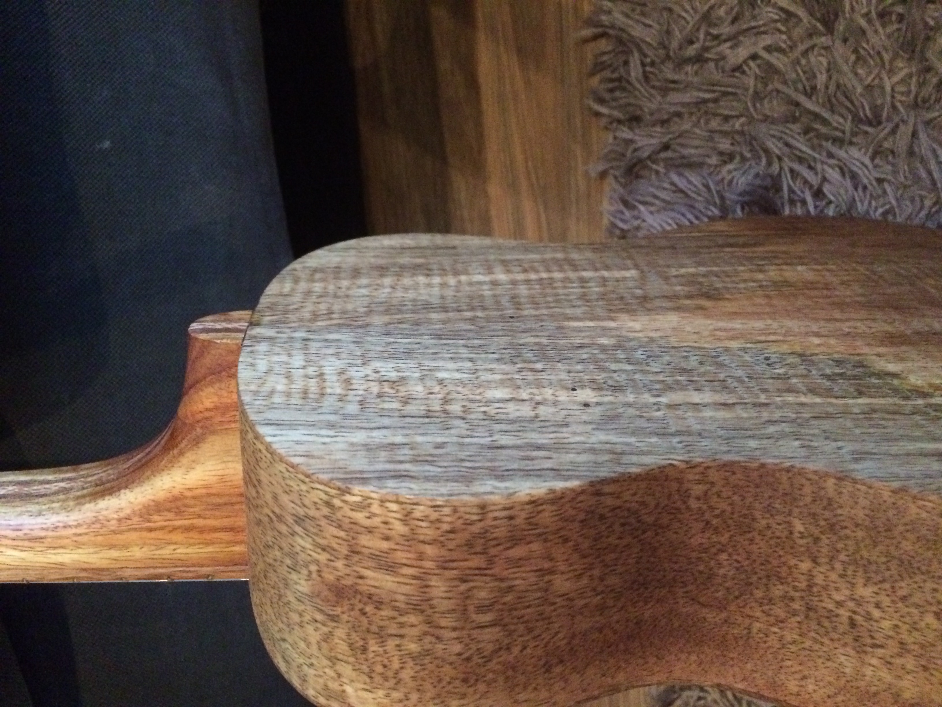

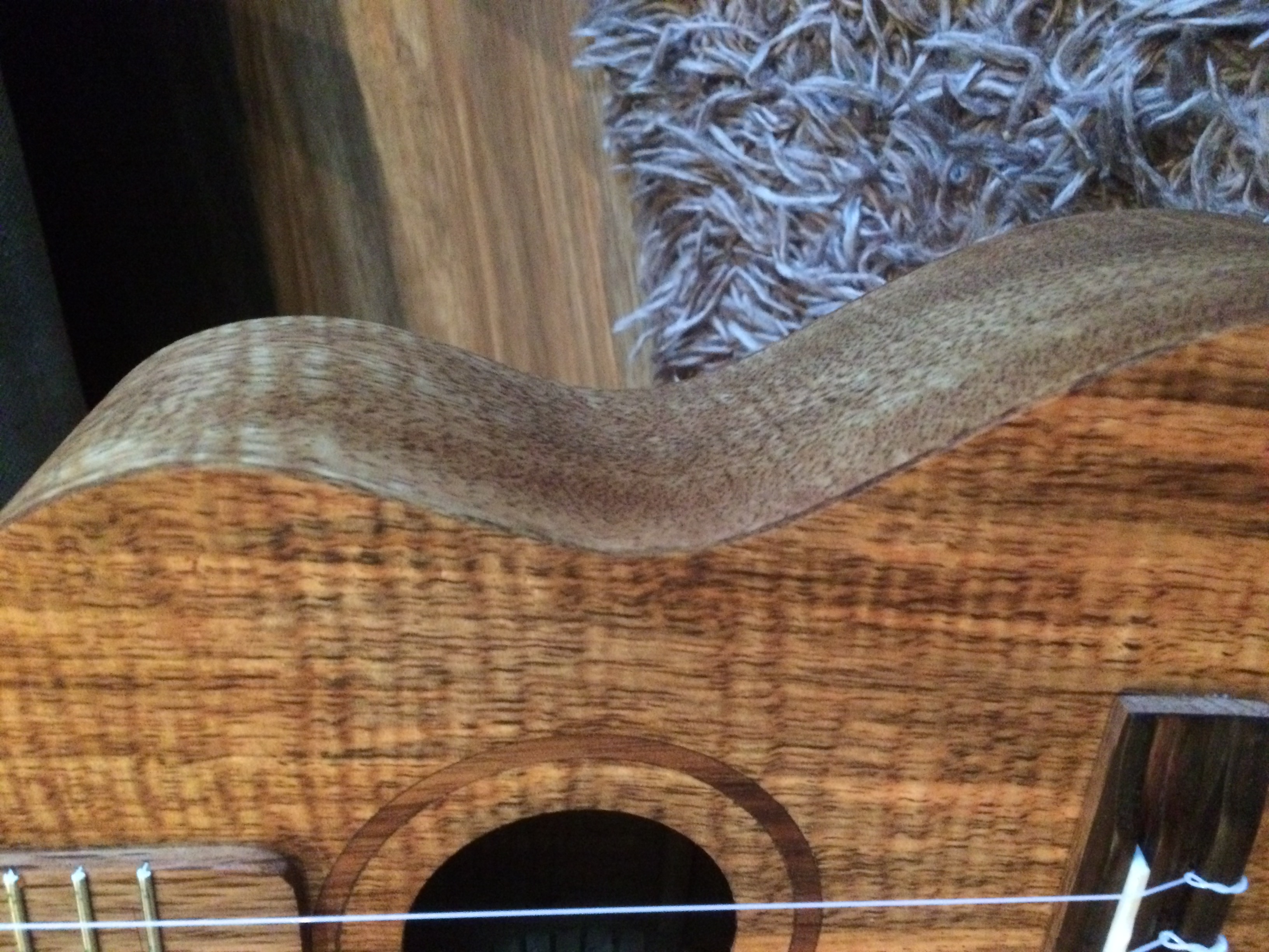

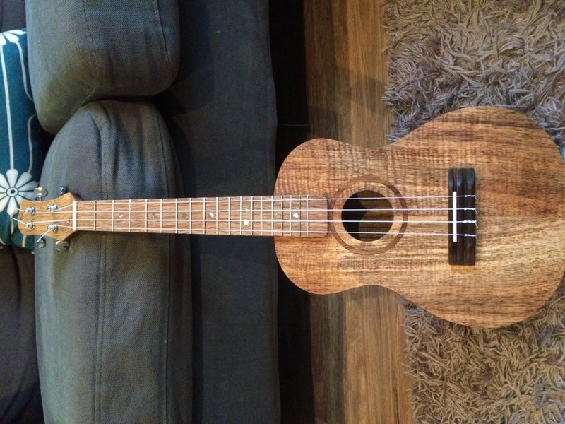

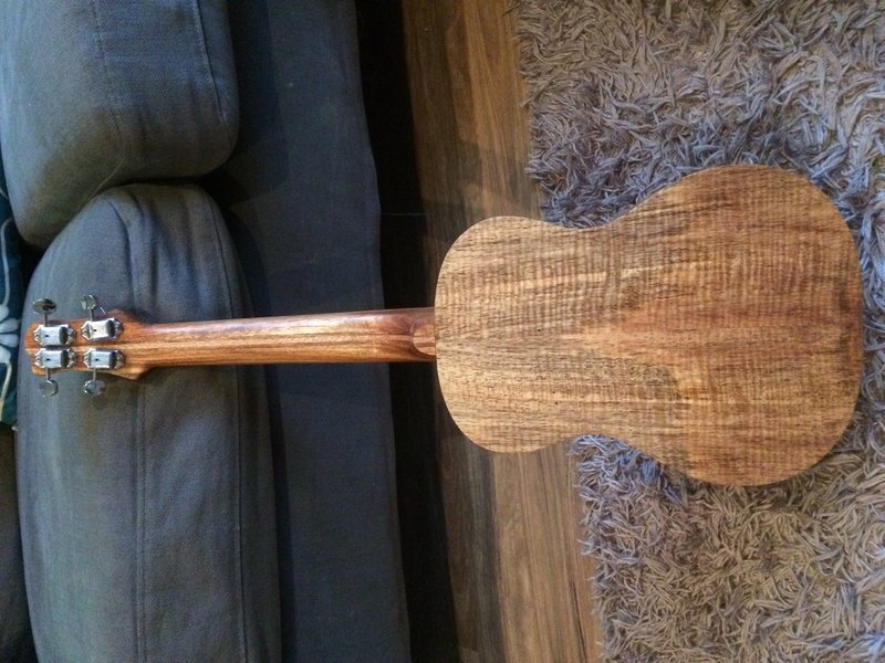

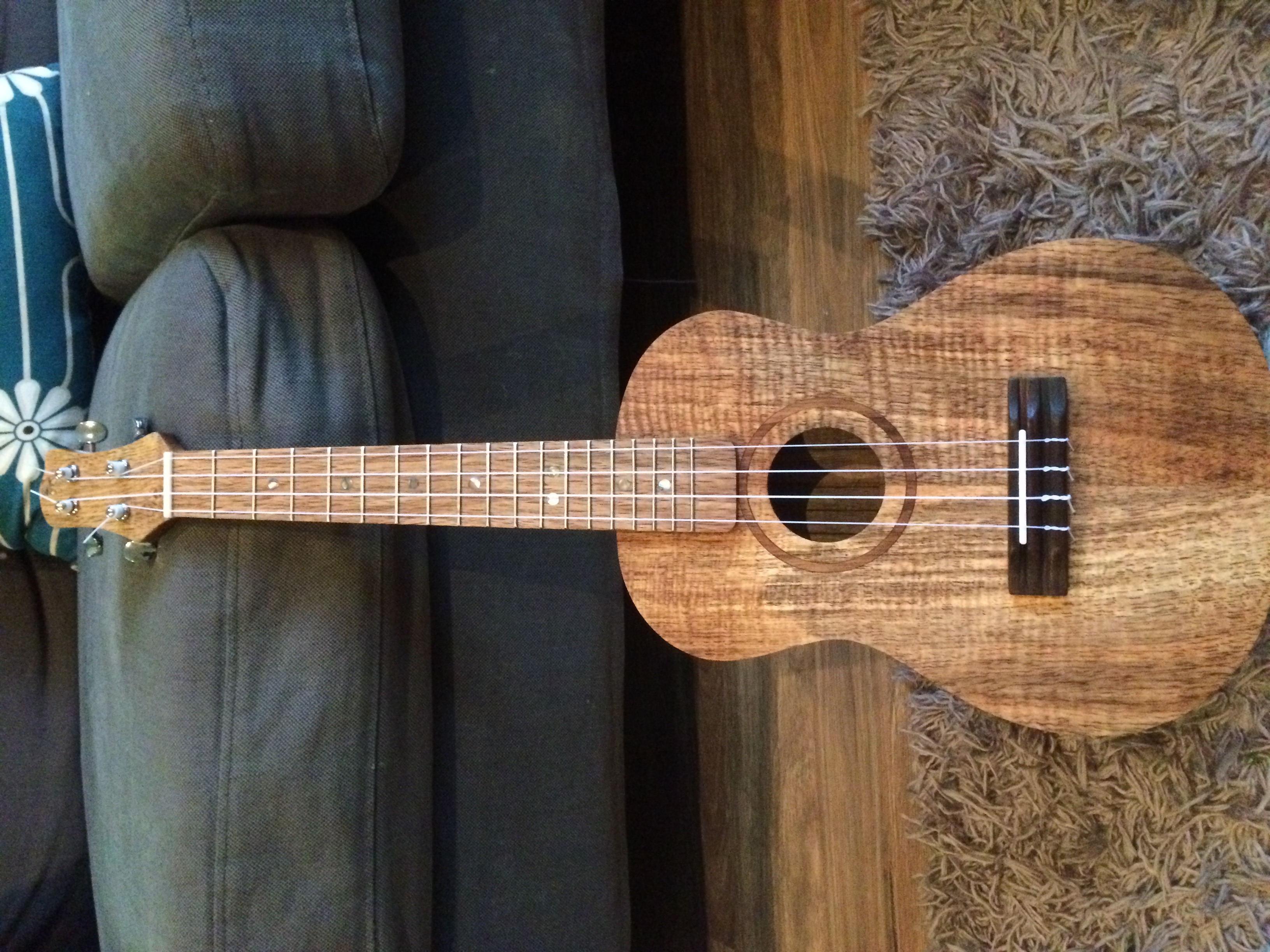

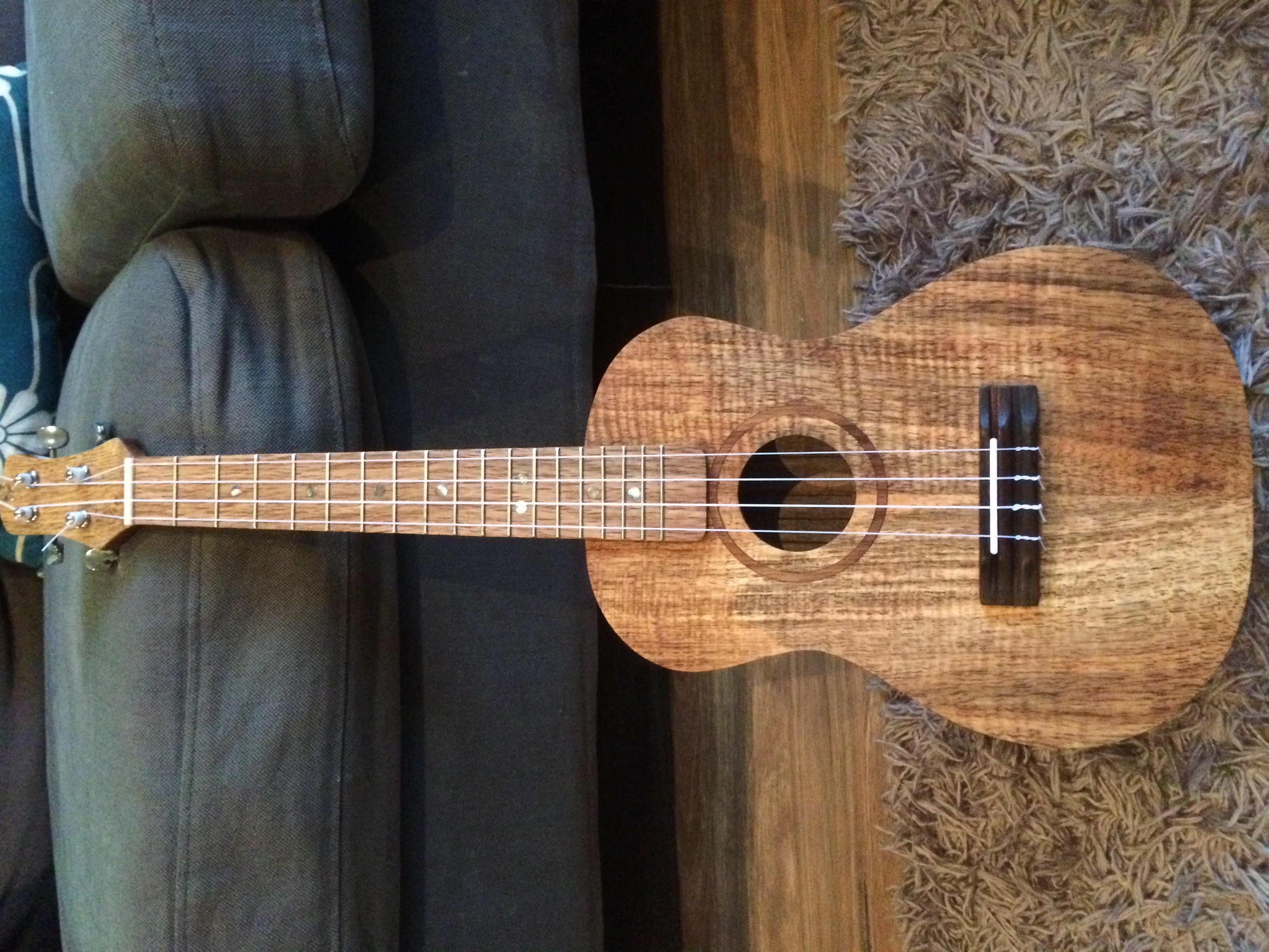

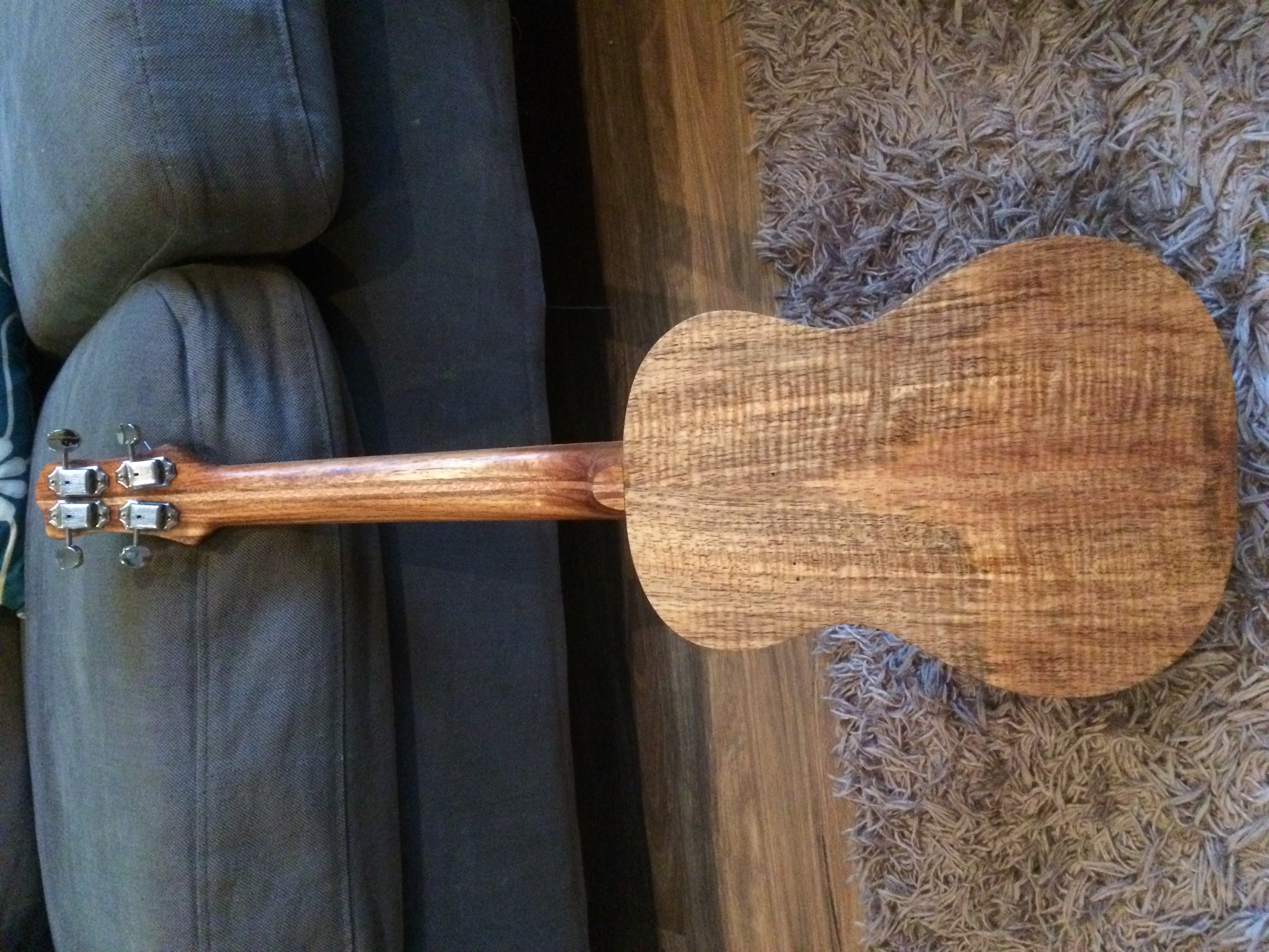

Just finished this tenor ukulele.
Mango body
5 piece Silky, Vic ash and mystery wood I had lying around neck
Casurina fretboard
Casurina and Macassar ebony bridge
Pretty happy with the sound, it's only been strung up a day though so we'll see how it settles in.

Nice looking build Jim
Did you keep the mango on the thick side?
Did it seem a little soft?Would mango work on a flat top guitar?
Jonny
Posts: 120
Re: Mango Tenor
Post by Jim » Tue Jul 18, 2017 3:16 pm
Thanks Jonny,
No, I kept it to my usual thickness but changed the bracing as it wasn't as stiff as the bunya I usually use. Apparently it does make a really nice guitar too. I'm really happy with the sound- I'd definitely use it again for uke.
