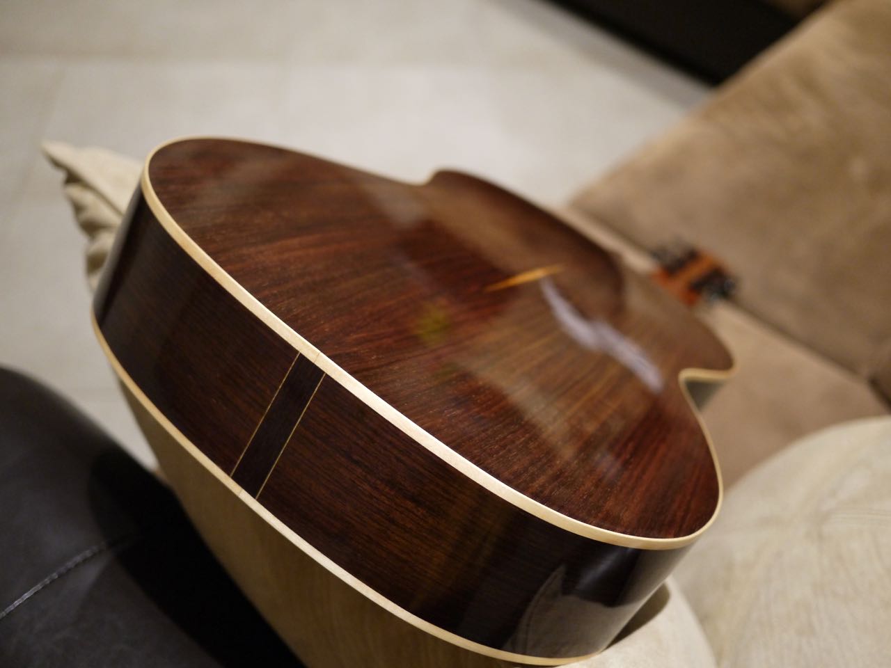

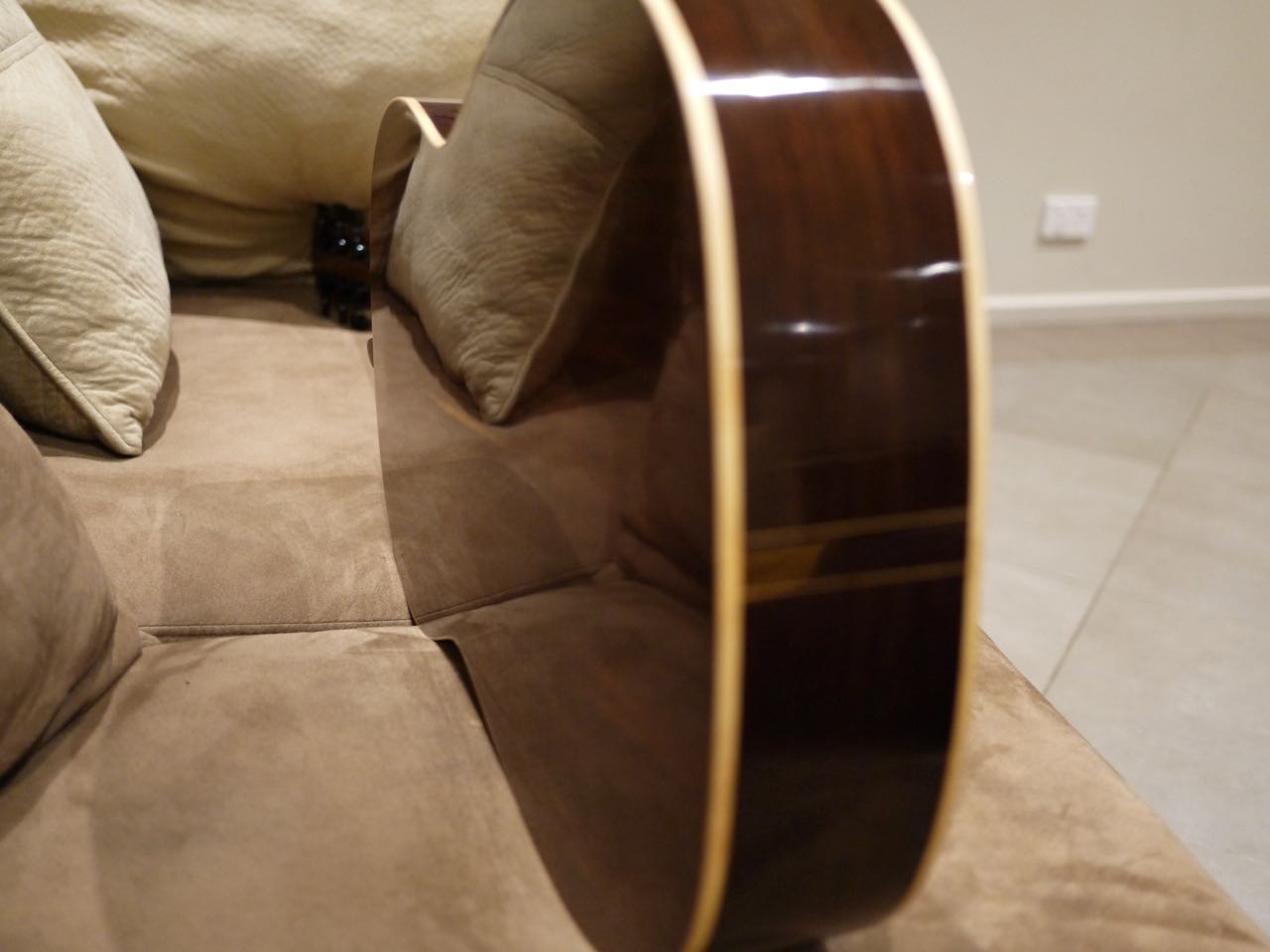

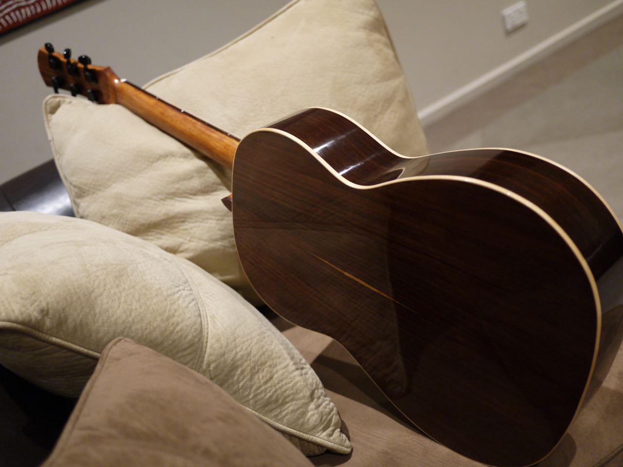

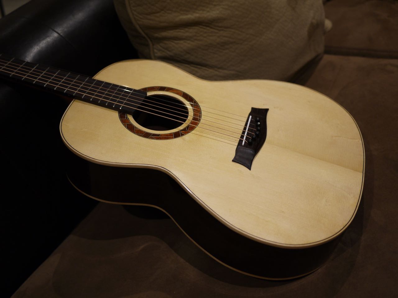

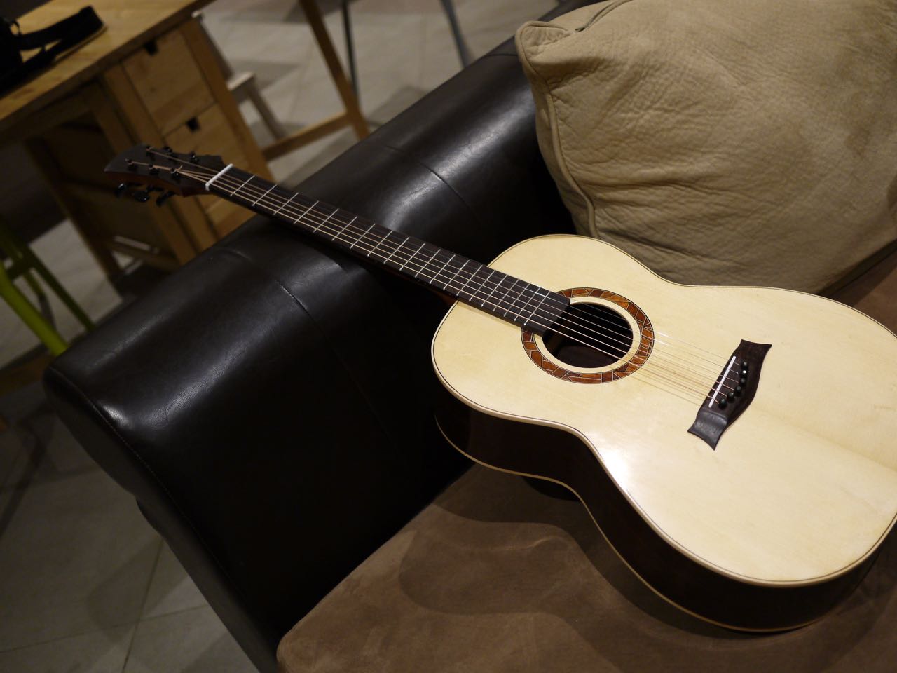

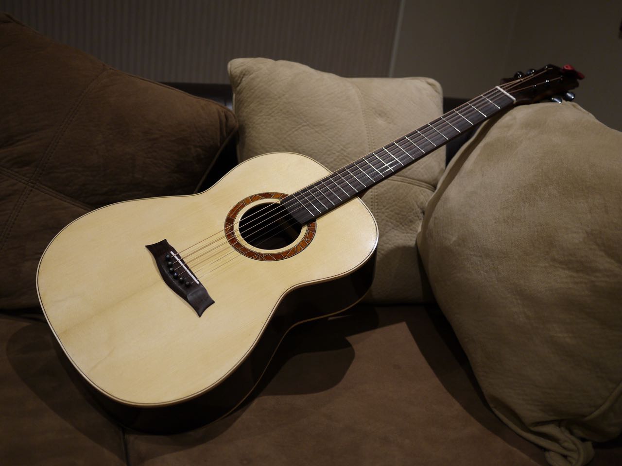

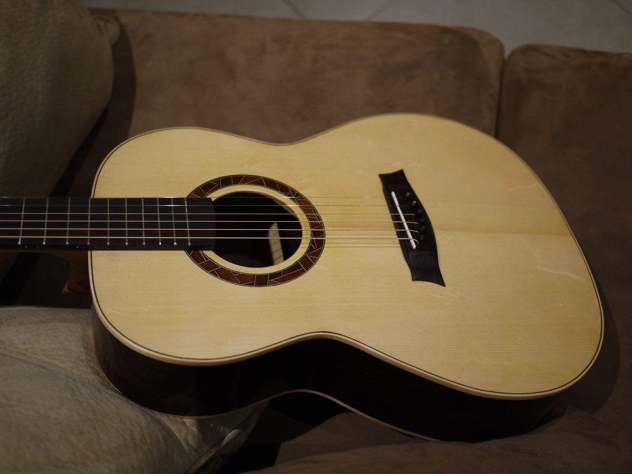

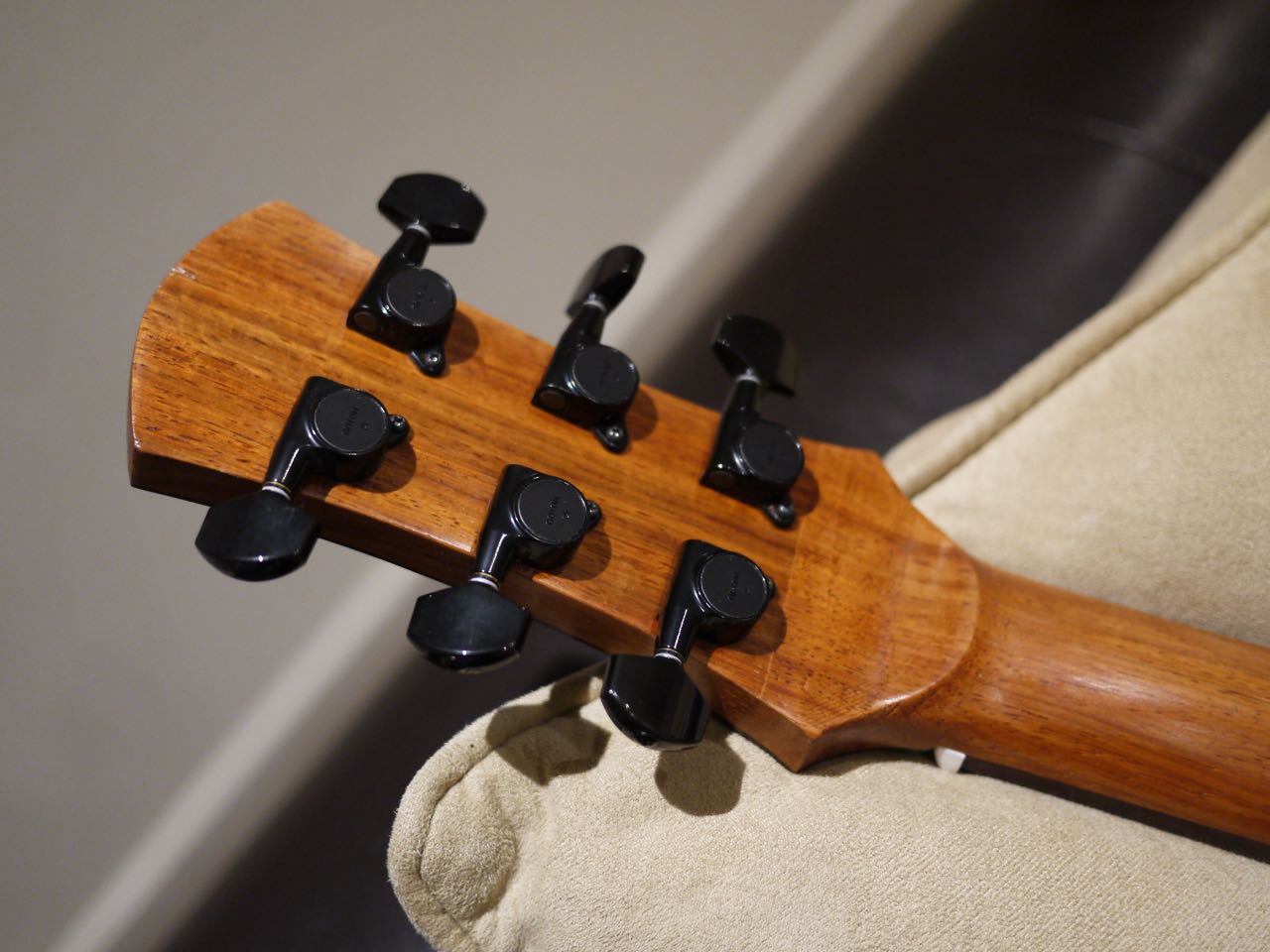

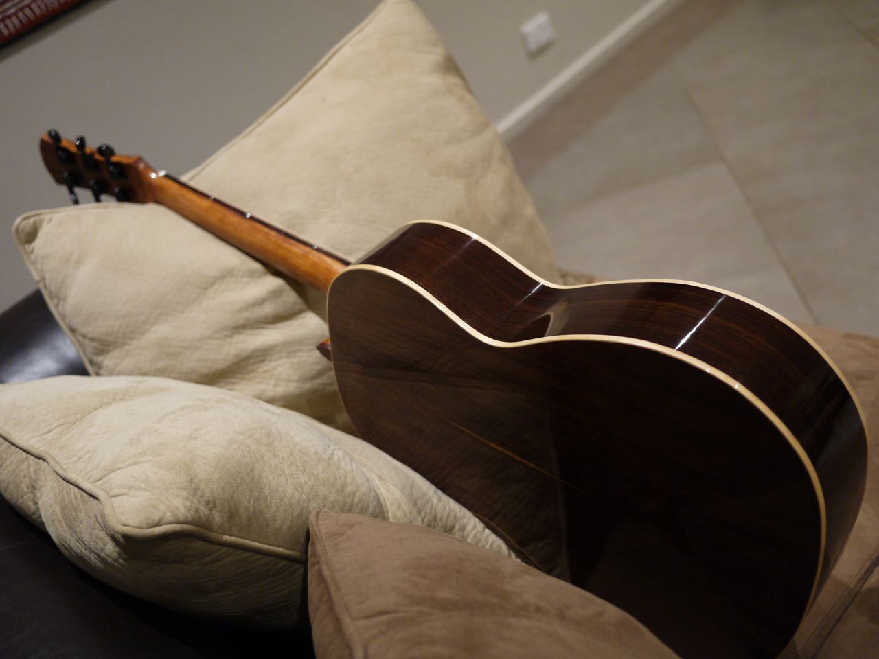

Tonight I finally finished my 4th build (2nd steel string). This one has a euro spruce soundboard (with a touch of bear claw) and indian rosewood back and sides. The mosaic rosette is Australian red cedar. The finish is shellac over superglue. The neck is new guinea rosewood with a 14 fret body join. The tuners are gotohs and the strings are Elixir bronze.
I'm quite happy with how it sounds - clean, loud and even right across the fretboard and quite a bright sounding guitar. I still need to intonate it at the saddle a touch as it is a touch sharp at the 12th.

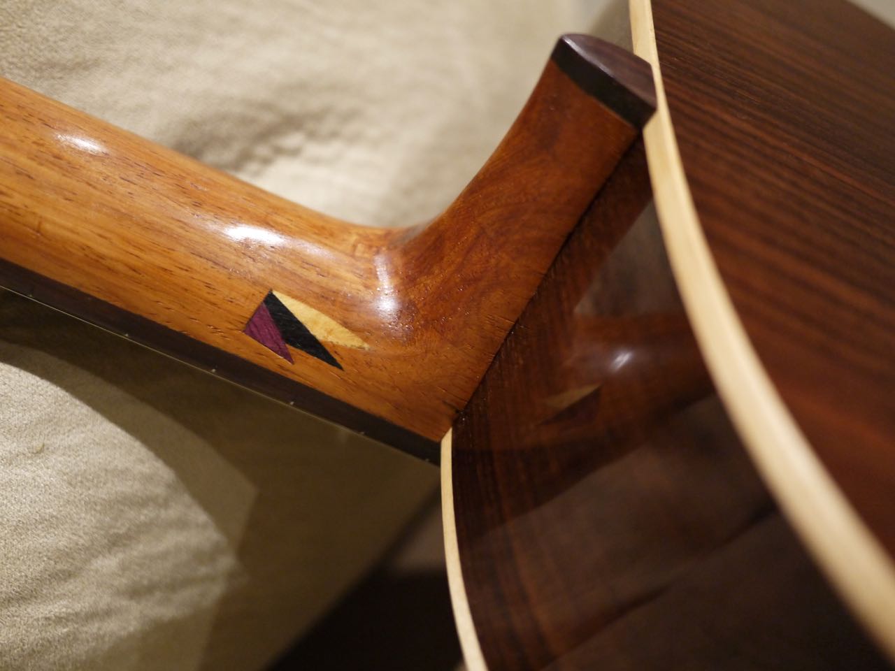

I did have several muck ups on this one... more so than my first 3 guitars for whatever reason. I'll probably build a new neck sometime (with an elevated FB) as I got the angle wrong even after measuring twice (bugger!). To get the action to 2.2mm I had to take the top of the saddle to just 11.5mm and there's only a couple of mm clearance left above the bridge. I also made my support block under the fingerboard too large, hence the decorative inlay on the neck after I sanded through (the hoop pine should not be showing! oh well... after scratching my head a bit I tried to hide it by creating a feature). But for now it plays ok, so I'll move on to the next build and park it as a "someday" project. It's just for the living room anyway...

There is plenty to smile about there. Looks like a great instrument. Especially like the mosaic rosette. I tried one of those on my last build but it ended up a bit "rustic" - yours is very elegant. I think it is important to be able to live with imperfections that do not matter in a functional sense. I am up to guitar number 6 and have certainly not produced one yet which is free of stuff-ups - but at least I make a new mistake each time. This week I discovered that the bridge is lifting off my number 3, so that one is going to require some more adjustments.
Enjoy your new creation - it is a great achievement.

Very nice :cl :cl :cl . I think the decorative neck feature is a very clever way of hiding the sand through. I had to look and read your description a couple of times before I understood what had happened.

Looks great from here and sounds ok. You worry too much.
