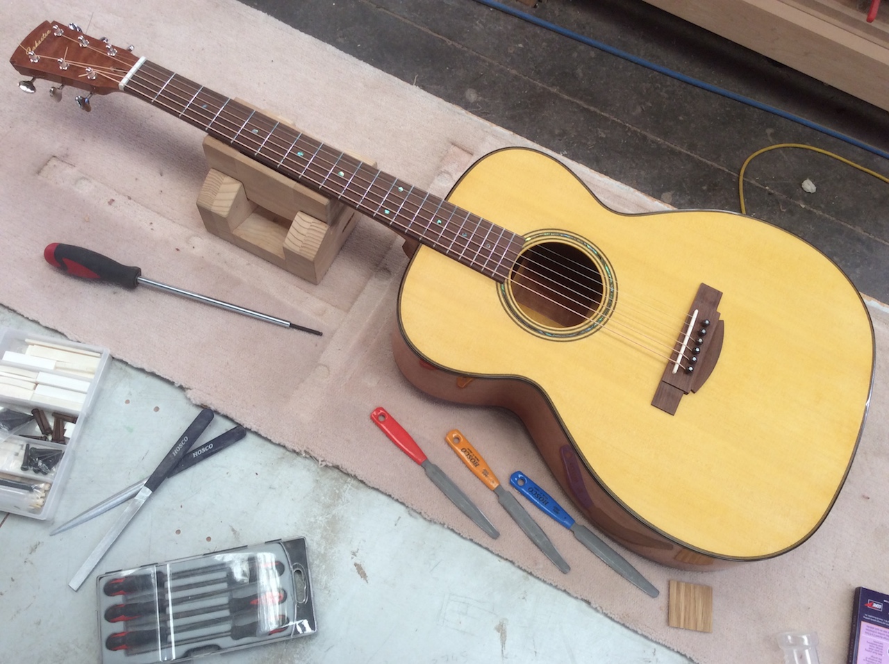

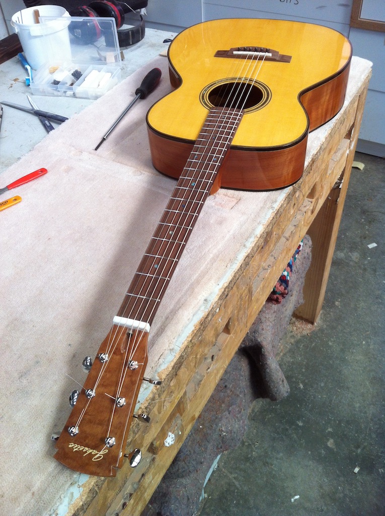

Hi Guys
It's been a while between posts, this is Number 5
Tasmanian Myrtle back and sides
Engelmann Top
Mahogany neck
Gidgee Head plate, Bridge and fretboard
Cheers Frank

Lovely color to that top Hank. Is it shellac?

Thanks Allen, yeah i think i did a couple of coats of shellac and then Mirotone NC.

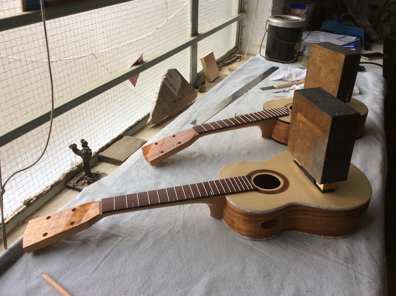

Hey Allen got a question for ya, I'm finishing up a couple of Concert Ukuleles, whats the norm for string height at the 14th?

The measure is always at the 12th fret, and norm will be 0.090 - 0.100". I think that translates to 2.0 to 2.2mm

Post by Hank » Sun Jul 23, 2017 3:01 pm
thanks Allen, i just glued the bridges, bit scary

0.040 to 1mm
0.090 = 2.25mm
0.100 = 2.5mm

Classy looking guitar!

Nice looking guitar, congratulations. I like the clean looking headstock design especially.
The Tas myrtle in my stash is quite pink...which i quite like, but good to know it can go golden too

Lovely work mate.
Simple and elegant.
Was the Myrtle a pinkie colour before the shellac?
I have a set of high figure myrtle and it is very pink.
Thanks for posting

Beautiful Frank,
How does it play and sound?

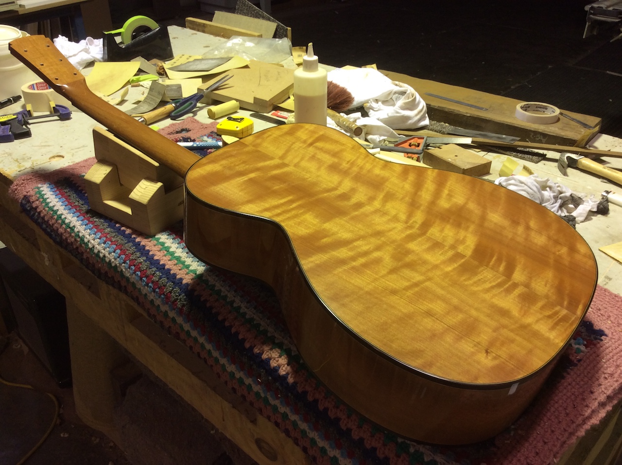

Love those golden tones, especially the shimmer on the myrtle back.

I do have a soft spot for Tas Myrtle and have used it for bodies and necks
I've found it varies in colour from Deep Reds to pale pink and even some green washes, but haven't seen a piece i didn't like
The shellac does warm it up, that and UV, reminds me of American Cherry in that it darkens fairly quickly
How does it sound? OK i guess, I made 2 using the same stick of timber for backs and sides, same top and neck timber.
I think the first one (mine) sounds better, think i was nervous about making the top too thin on this one.
Left it a bit chunky at 2.8 and i think lost some bottom end
Thanks again for the positive comments
