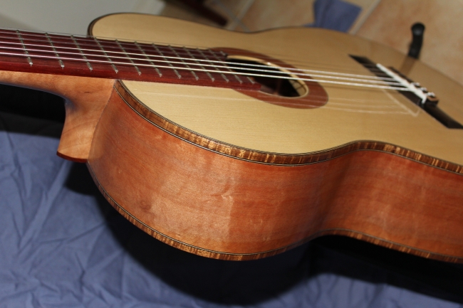

Thought I'd show off one of my more recent builds - another concert classical.
Top: Spruce
B&S: Tassie Myrtle
Neck: QLD Maple
Fretboard: Padauk
Bindings: Tassie Blackwood
Bracing: Traditional Fan braced, with my mods.
Finish: Full body french polish

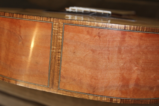

Side
Toscano Guitars Concert Classical Gutiar

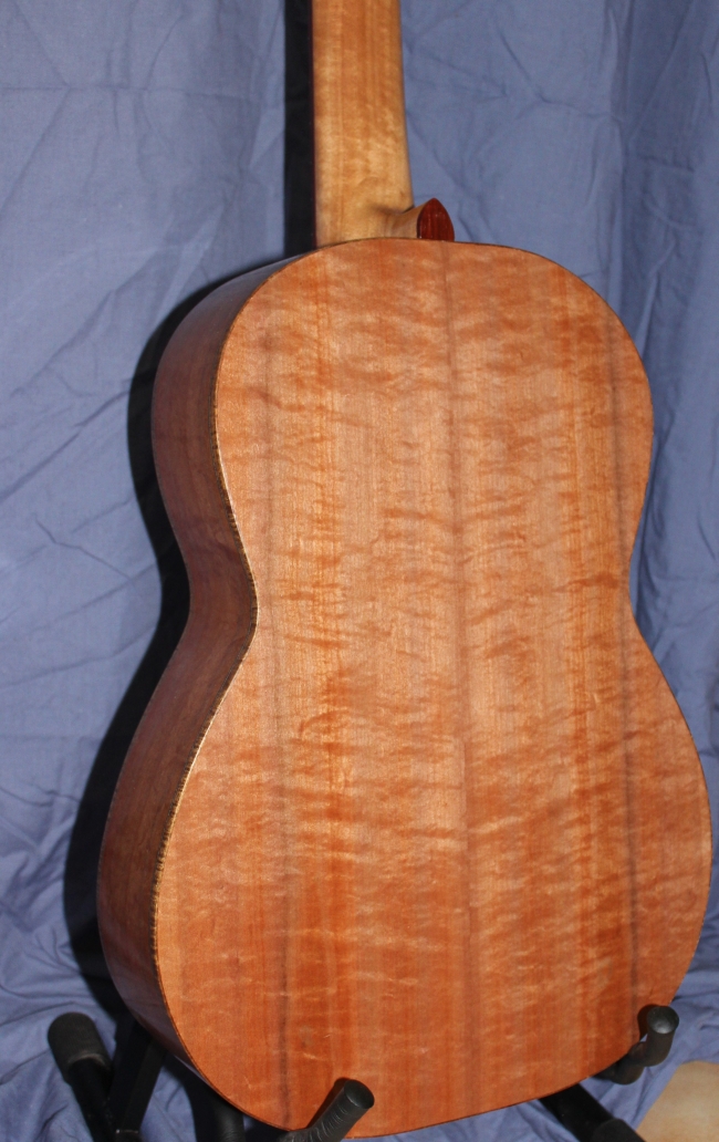

Back
Back
Tail
Side 'dot'

This was my first attempt at a french polish finish. I put way more hours in that finish then i did in the rest of the build :oops: :oops: .
The shellac is Ubeaut hard shellac diluted down, as far as 8:1 for the sealing and finishing sessions, 4:1 for the bodying.
I didn't go the oil method, as in practice i found that too difficult and wasnt as happy with the results. Instead as soon as the pad started to stick i stopped and went again the next day.
I got a reasonably good finish off the pad, and then hit it with abrasives (Micro mesh), which i found left fine scratches even after a good hour of the 12000 pad.
I was able to eventually get these out by applying more bodying and waiting to really harden up then hitting it with the liquid micro mesh polishing stuff - in hindsight a good automotive polish probably would have done the same job at a quarter of the price.
This guitar was 10 months from start to finish, 1 month of build, 9 months of finishing, waiting to harden etc. :(
