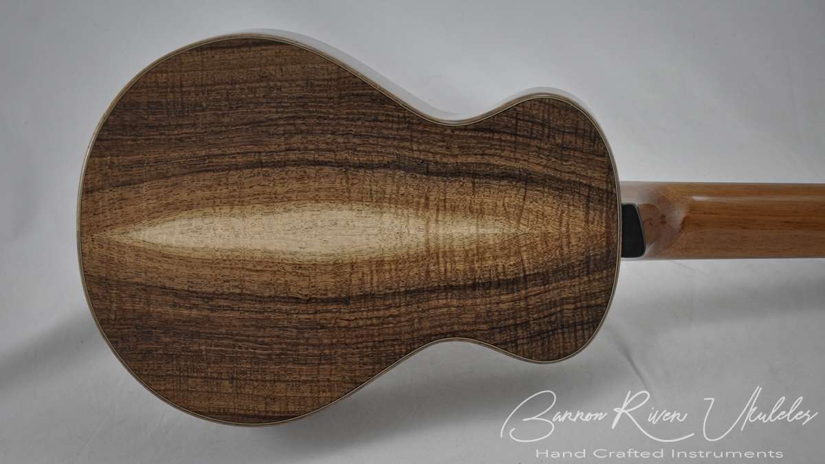

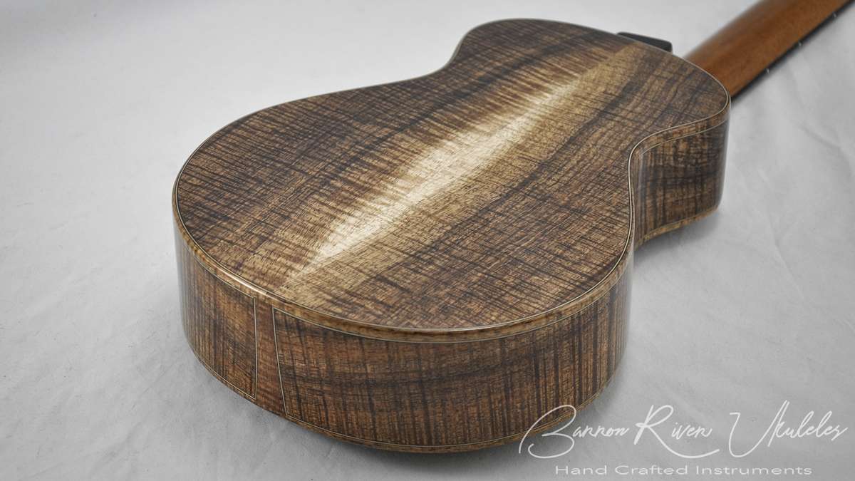

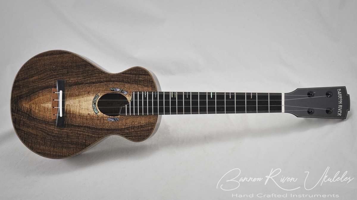

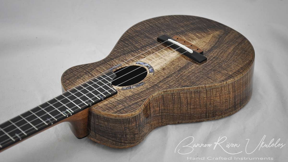

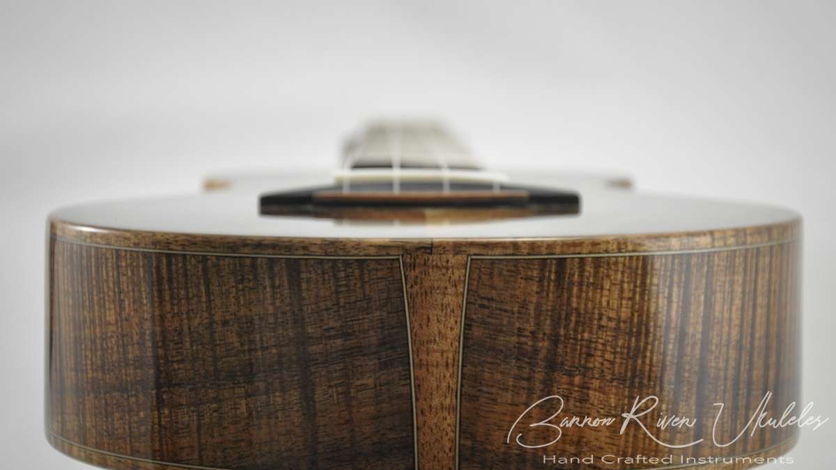

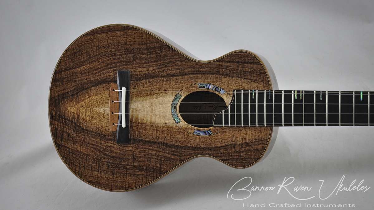

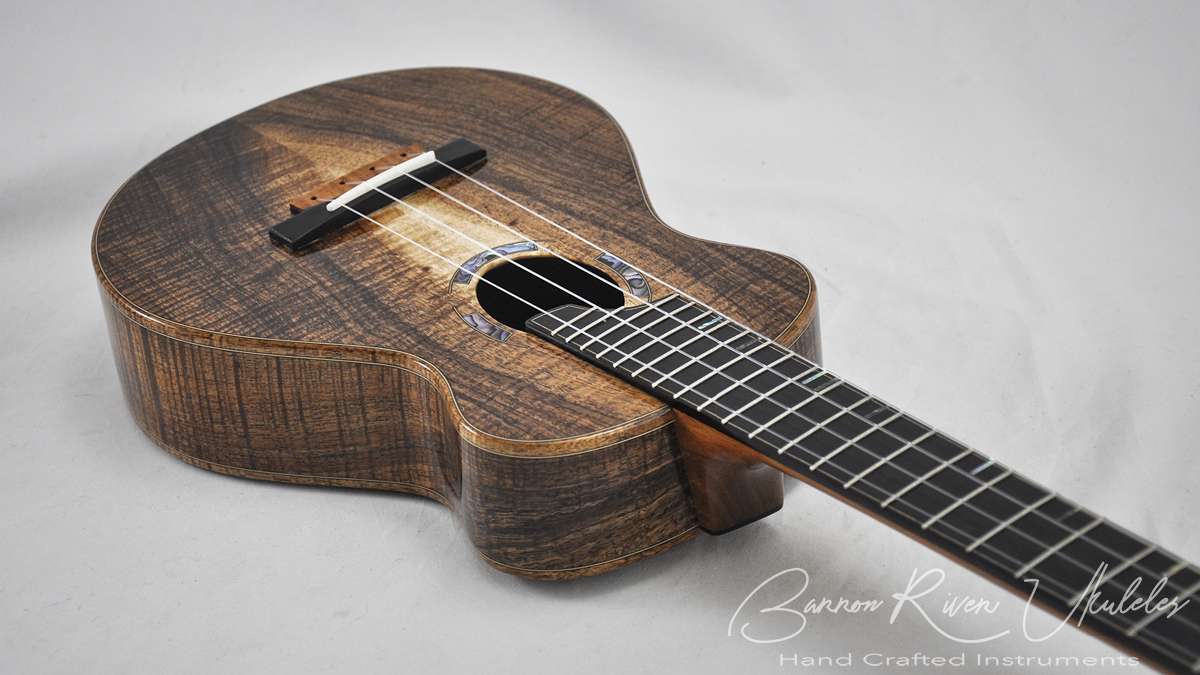

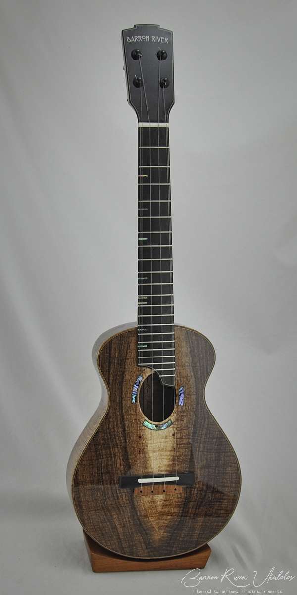

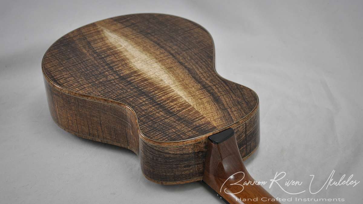

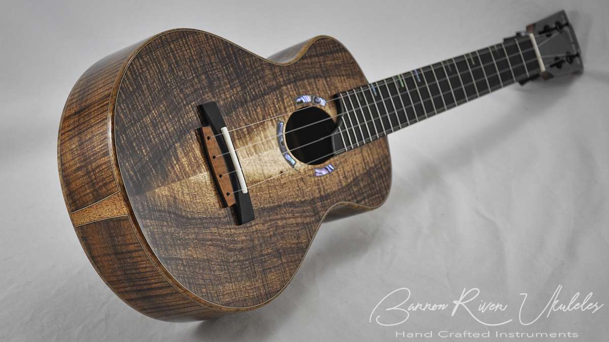

I've had some really amazing Blackwood put away for a spec build where I didn't have a client placing expectations or restrictions on what I wanted to create. It's impossible to capture in photos the way that this timber shimmers much like an opal under the light.
It's a 16" long neck concert with a 12" - 16" compound radius on the fret board. Australian Blackwood body and bindings. Finished in high gloss polyurethane.

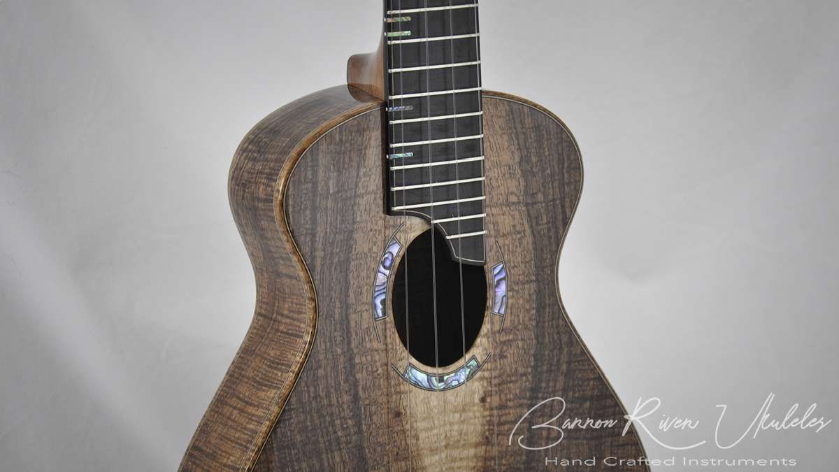

Beautiful! :cl :cl :cl I like the new asymmetrical heel. How are you liking the change to a bolt on neck?
Posts: 5257
Re: Curly Blackwood Long Neck Concert Uke
Post by Allen » Thu Dec 07, 2017 1:56 pm
The bolt on neck certainly helps with the streamlining of production.
