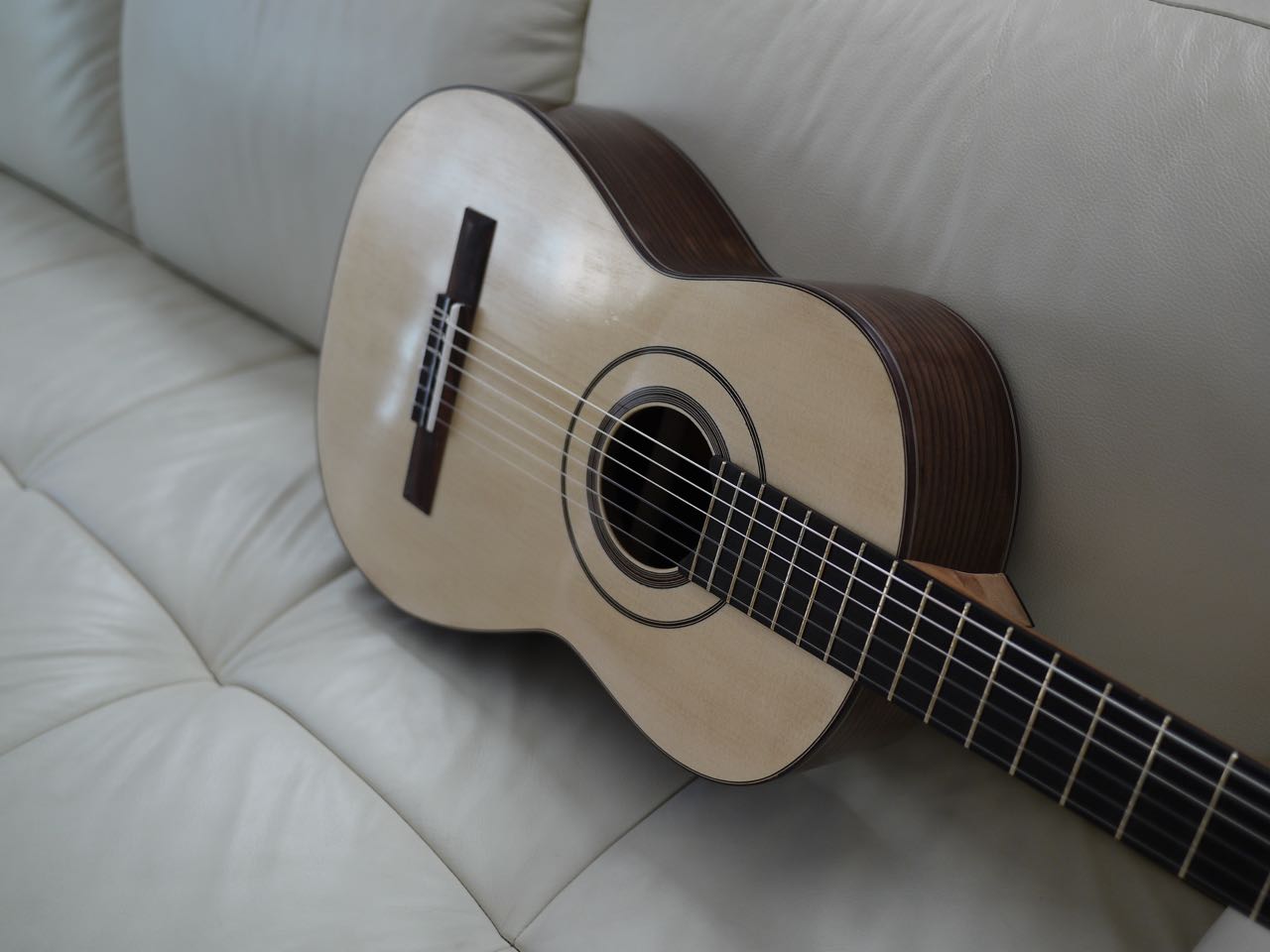

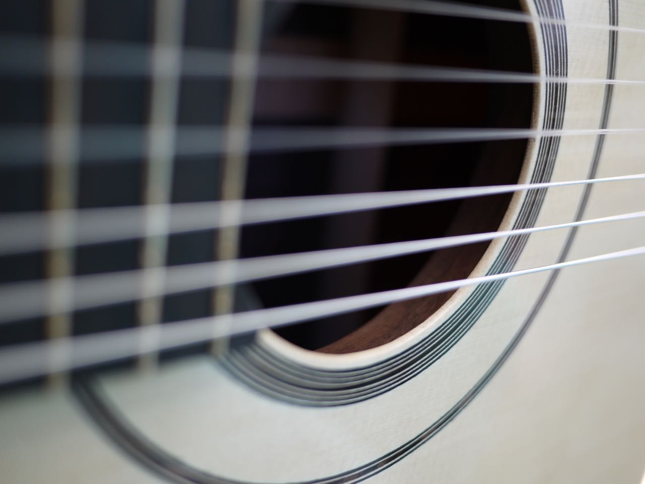

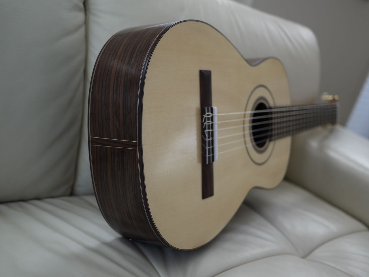

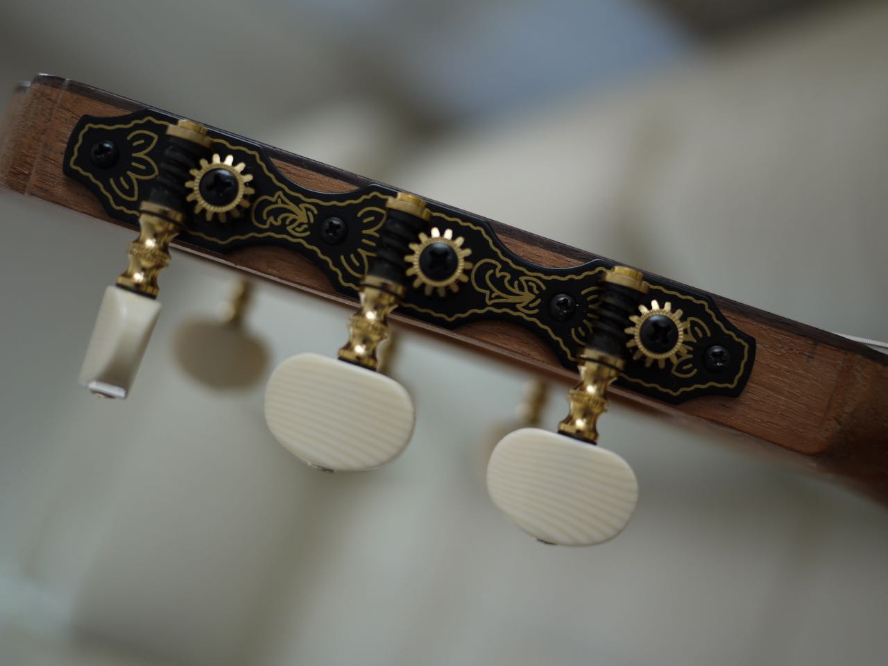

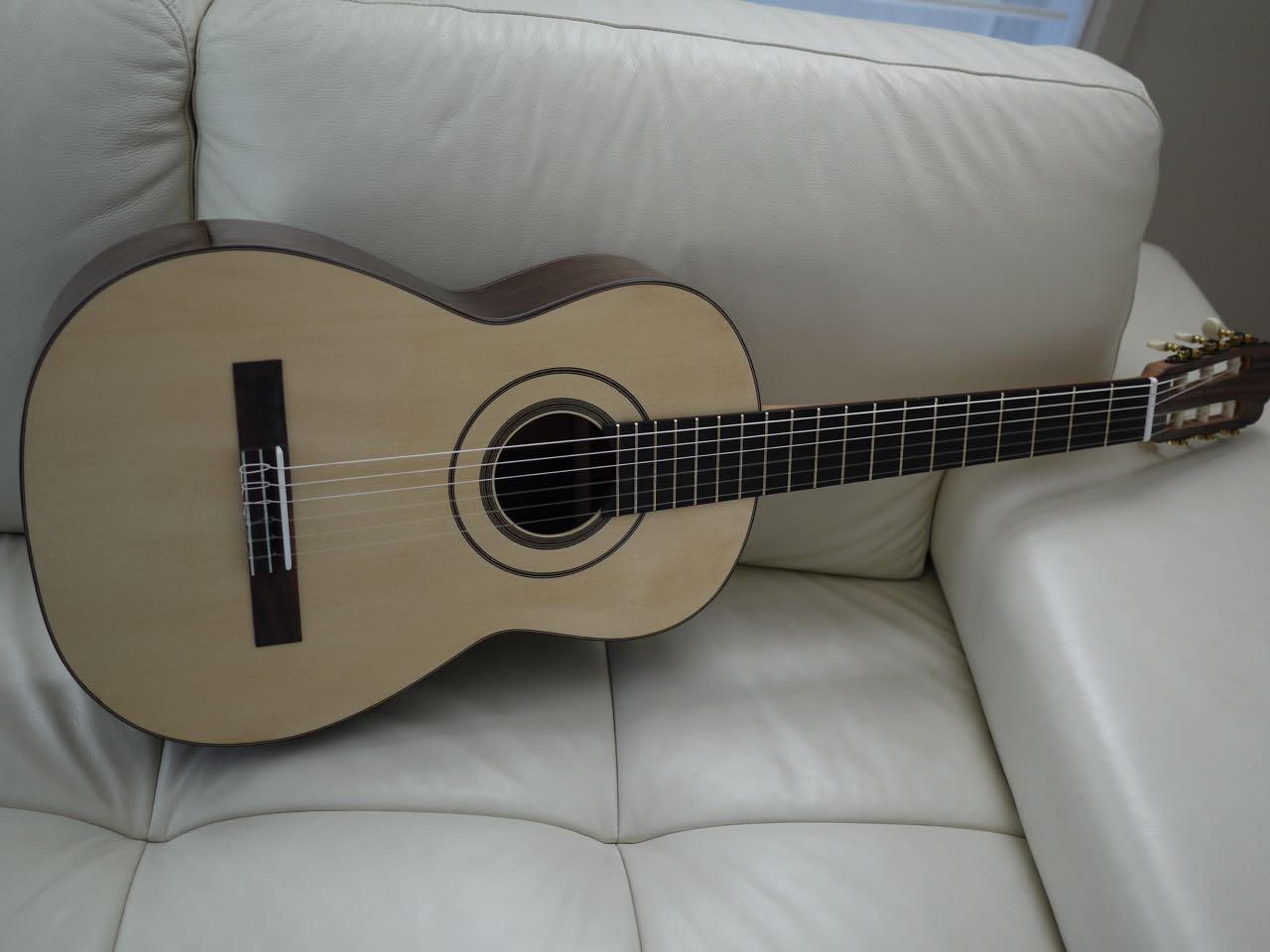

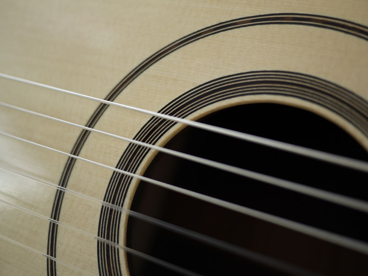

My third classical guitar build (5th overall). Torres FE17 inspired shape but a touch wider at the waist, 7 fan braces with an mini-tornavoz (18mm).

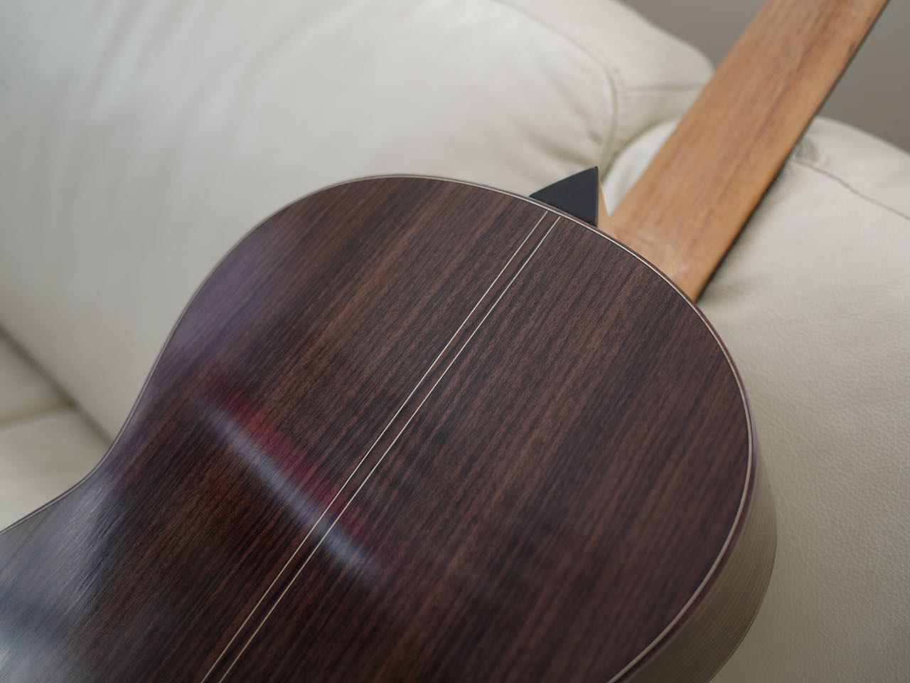

Indian/Engelmann with an Australian red cedar neck. I still need to finish it properly (have just put on the first couple of coats of shellac on the body so far and a sealer coat on the neck). I'm trying out aqua-clear wood grain filler for the first time, which I quite like.

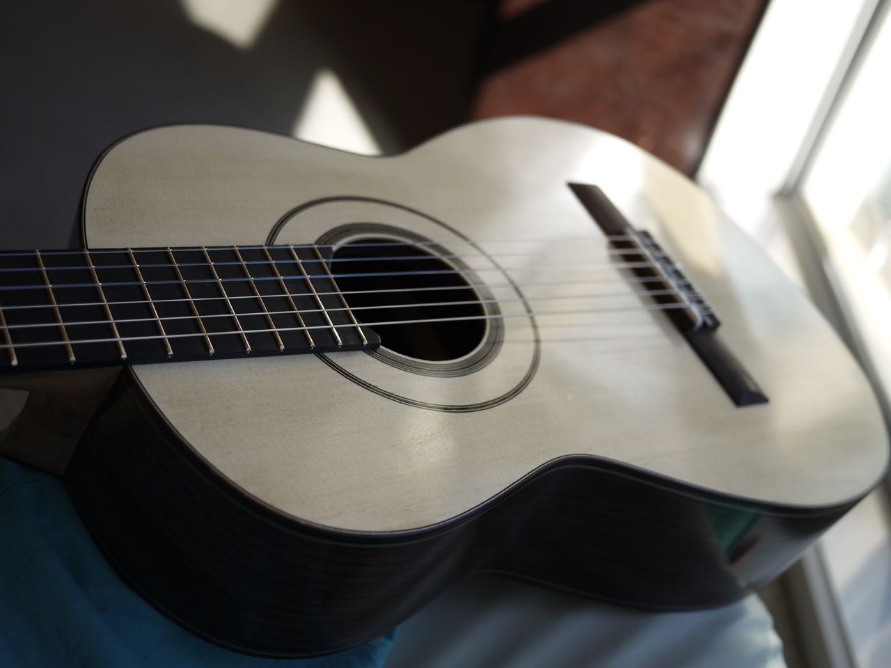

I've been getting to know the guitar before final tinkering with the frets and neck (it has a truss rod and a detachable neck). I'm really happy with the sound - my best guitar so far. On the first few days it had a bit of a wolf note on the G# but that seems to have mostly disappeared. The body resonance is somewhere between G and G#.

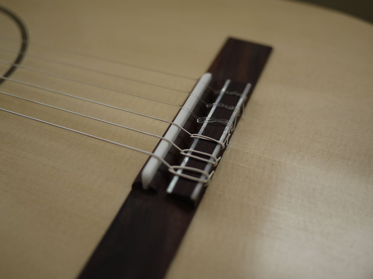

It has a particularly powerful first string, which might be related to the tornavoz (I don't know.... first time I've built one). The mini-tornavoz stiffens the upper bout a lot and I can still get the bridge clamps in (same height as the transverse braces). I'm keen to use it on my next builds too. It's a loud guitar.

Looking good Peter, very inspiring. Was the tornavoz fitted before assembly
or was it a retro fit after the top was glued down?
Bruce Mc.
Re: FE17 inspired classical
Thanks Bruce, all assembled during construction. It is glued straight onto the soundboard and the transverse braces/soundhole braces then butted up against it with some more glue. Let me know when suits and I'll bring it round sometime ...
