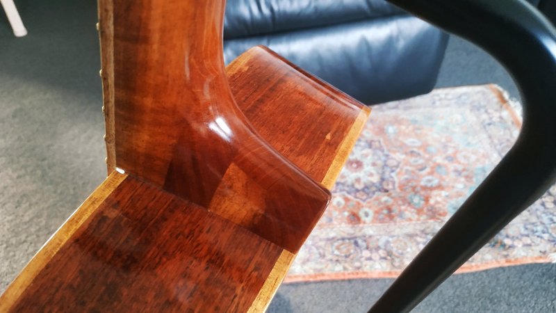

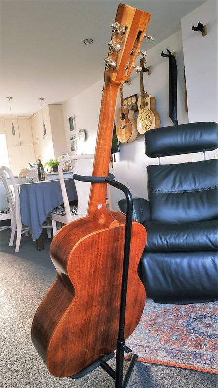

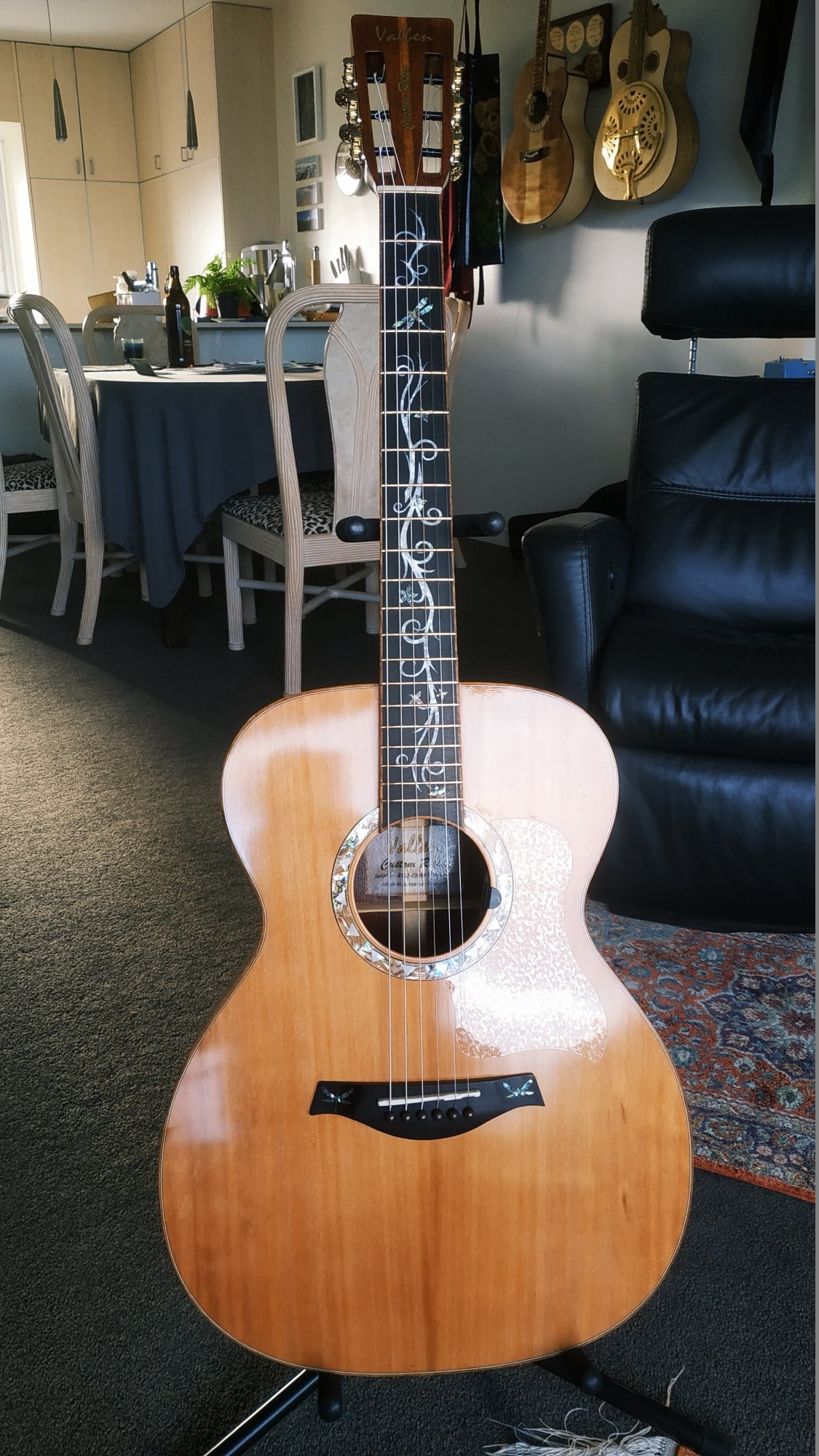

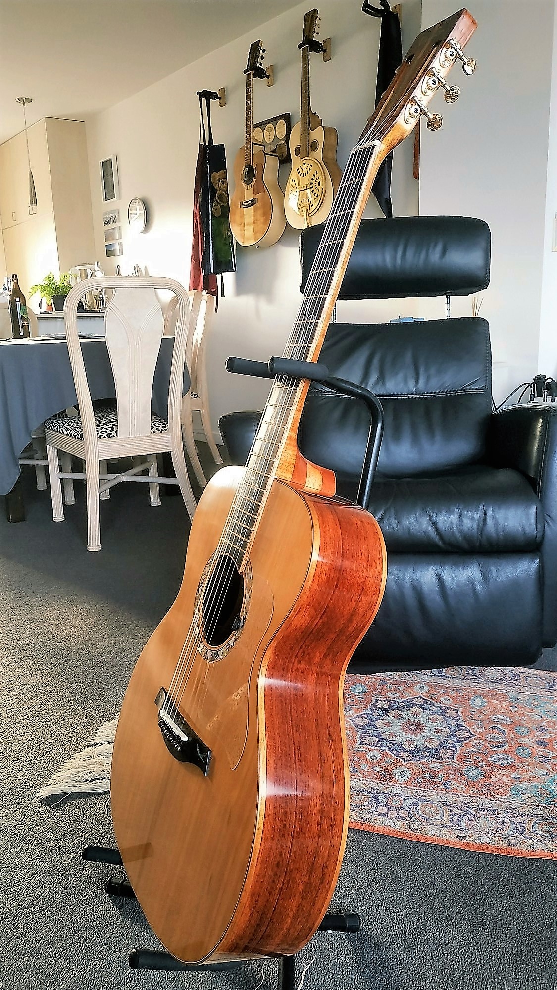

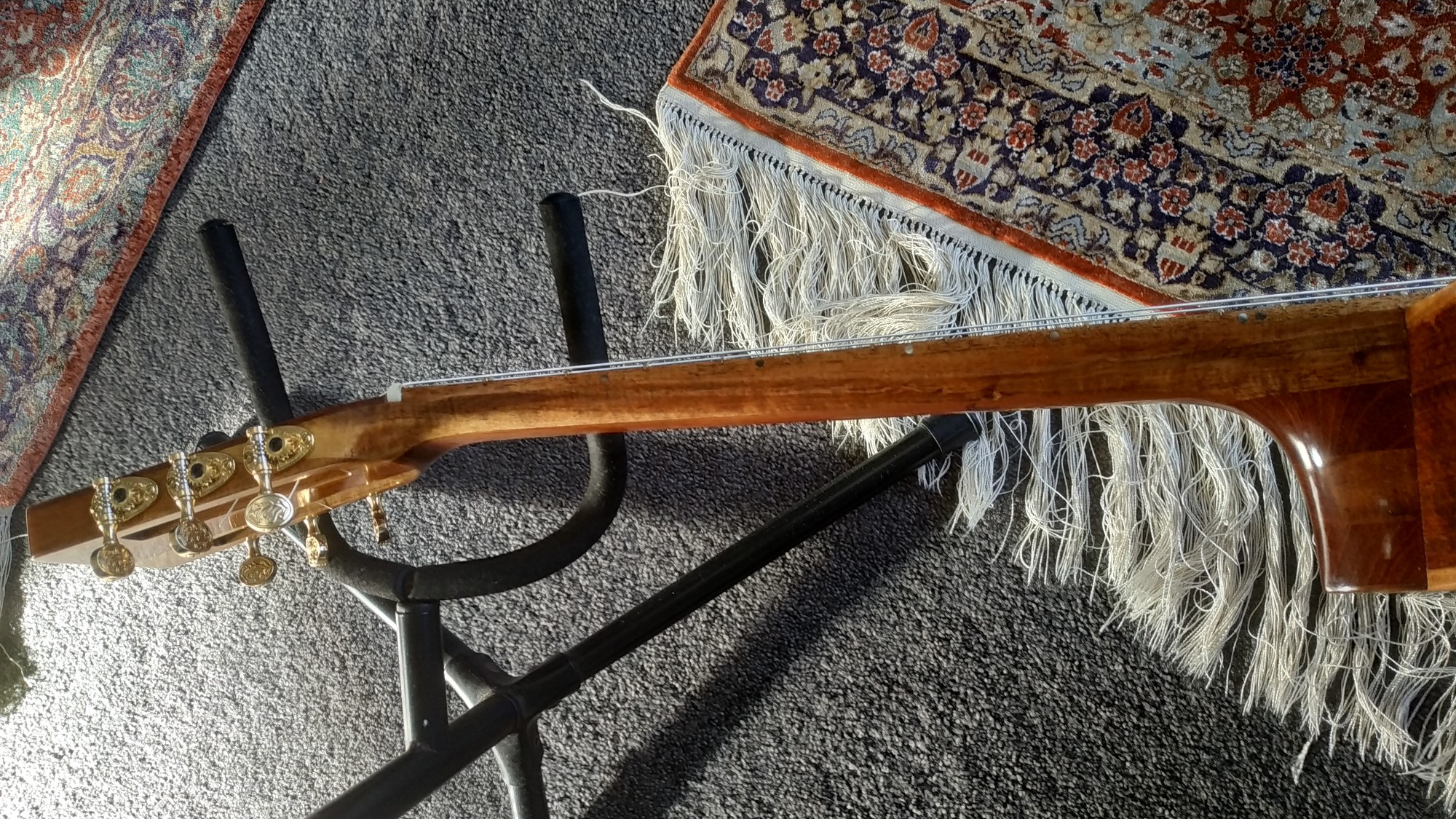

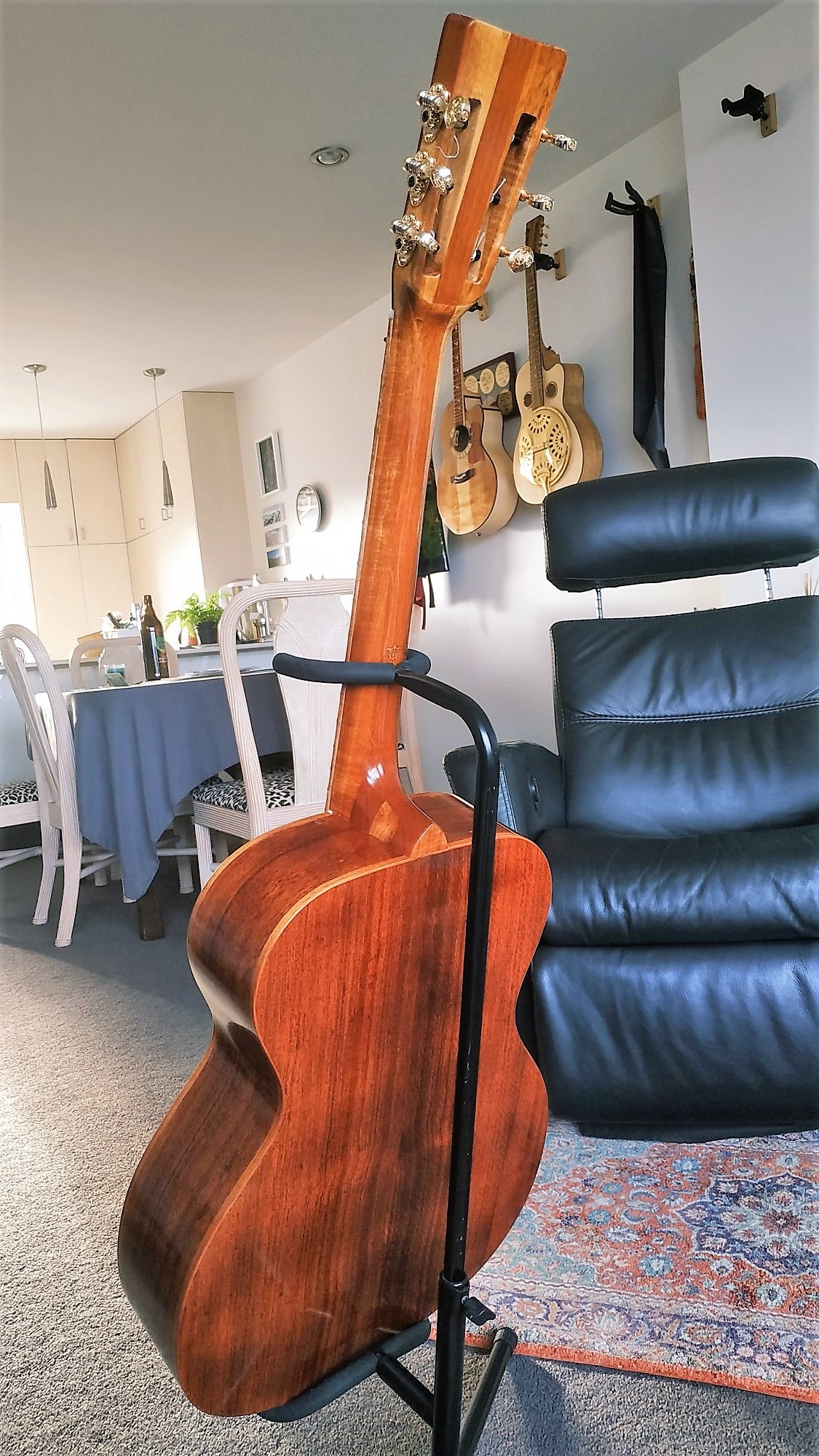

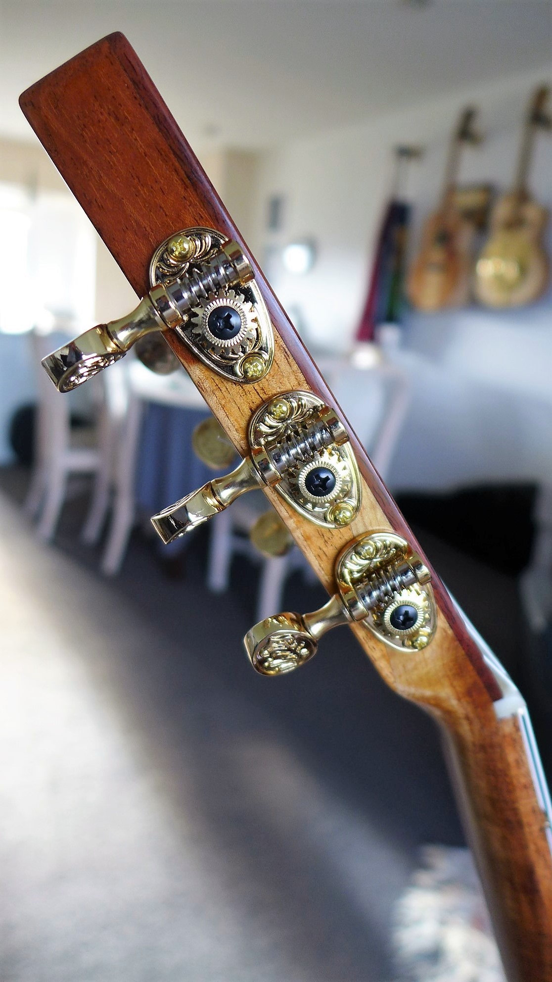

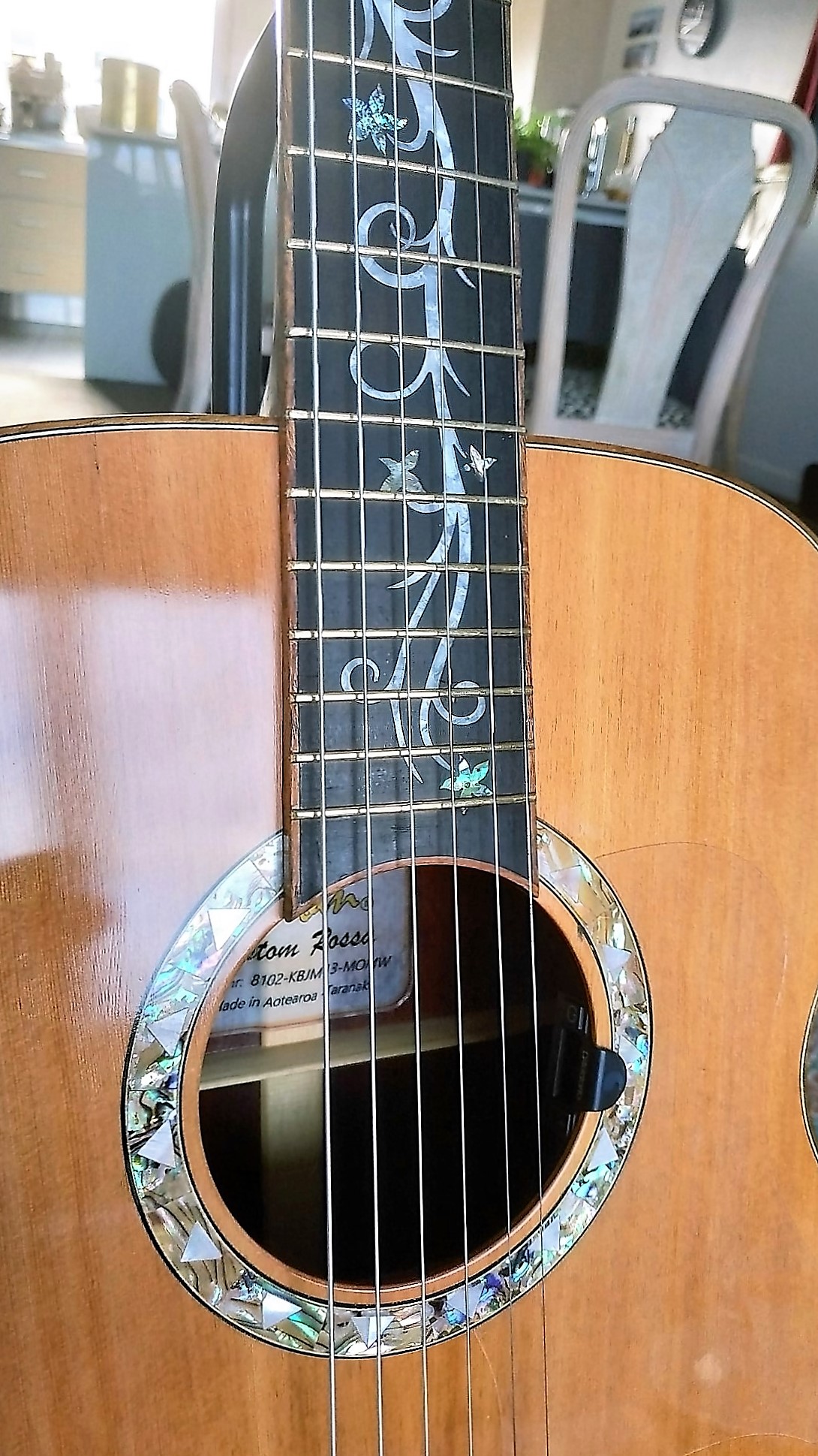

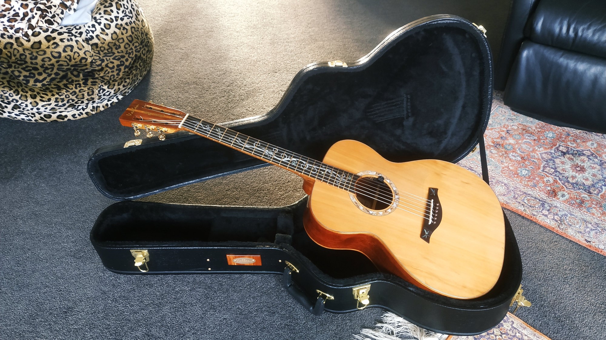

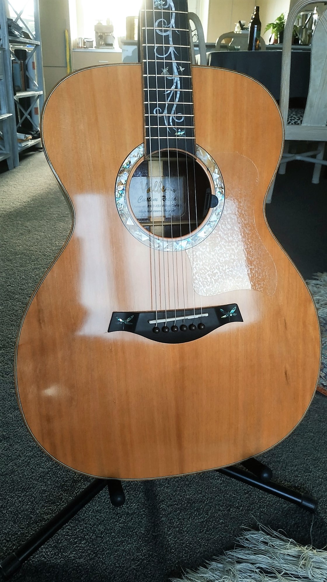

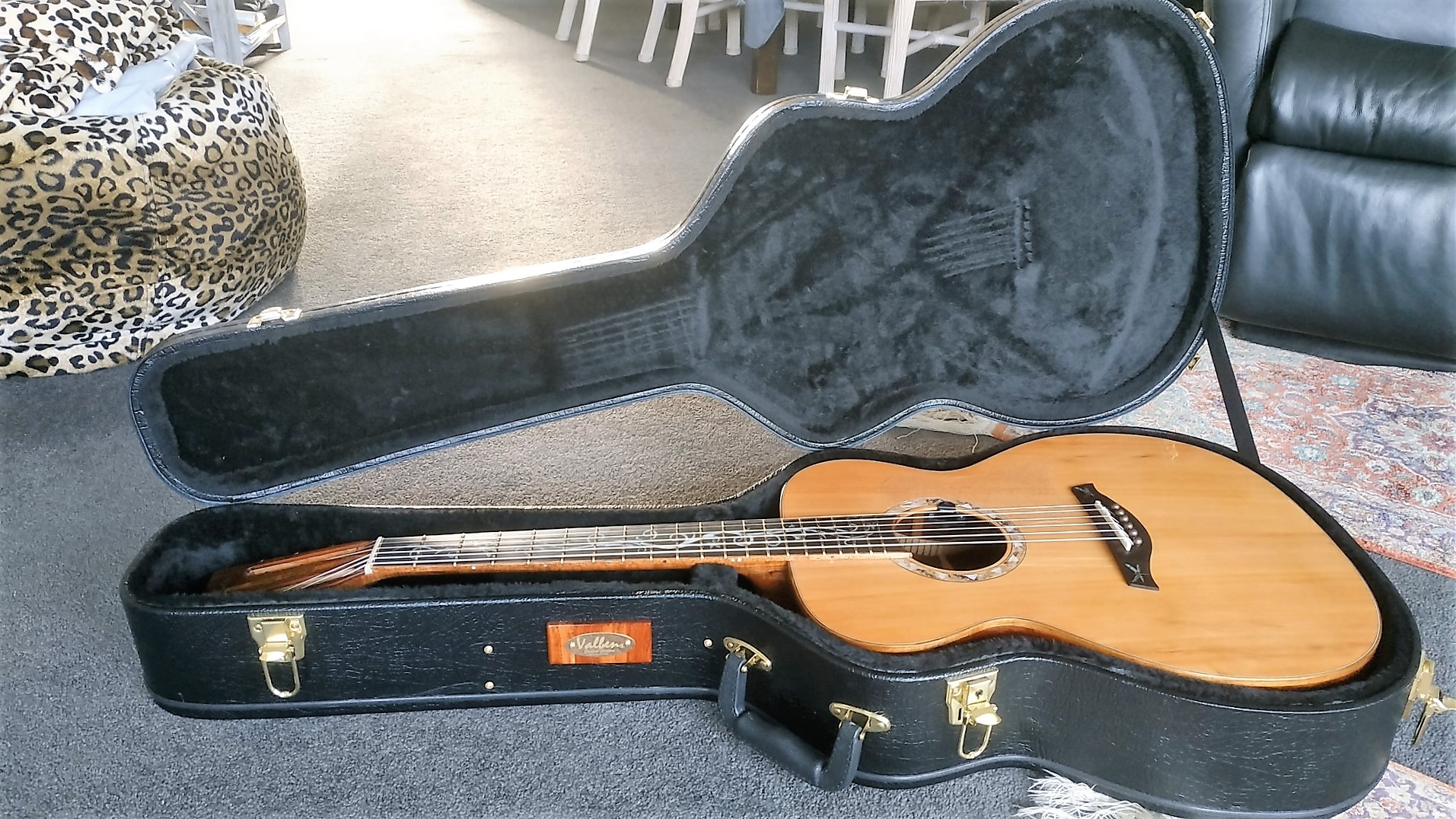

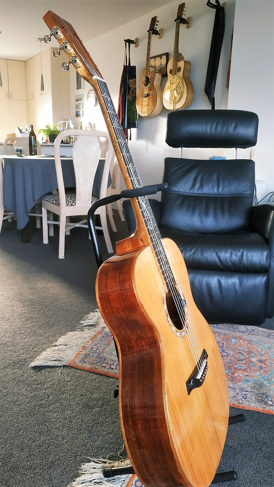

This an OM style just completed:
Type : OM like shape
Top : King Billy Pine (double thanks Pete)

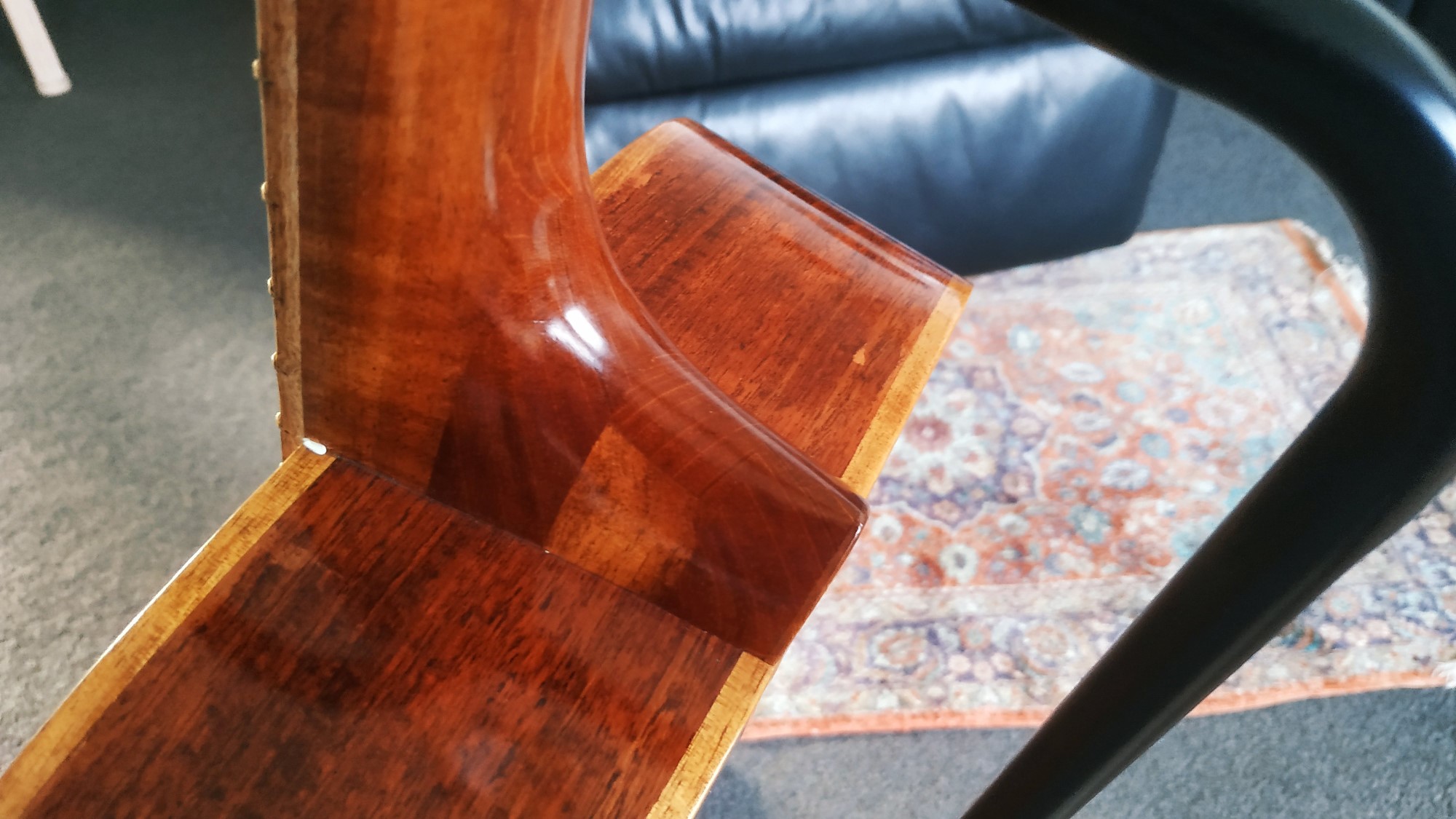

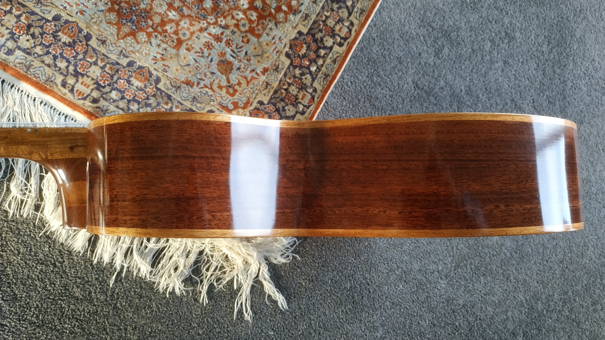

Back & Sides : Jarrah (thanks Pete)

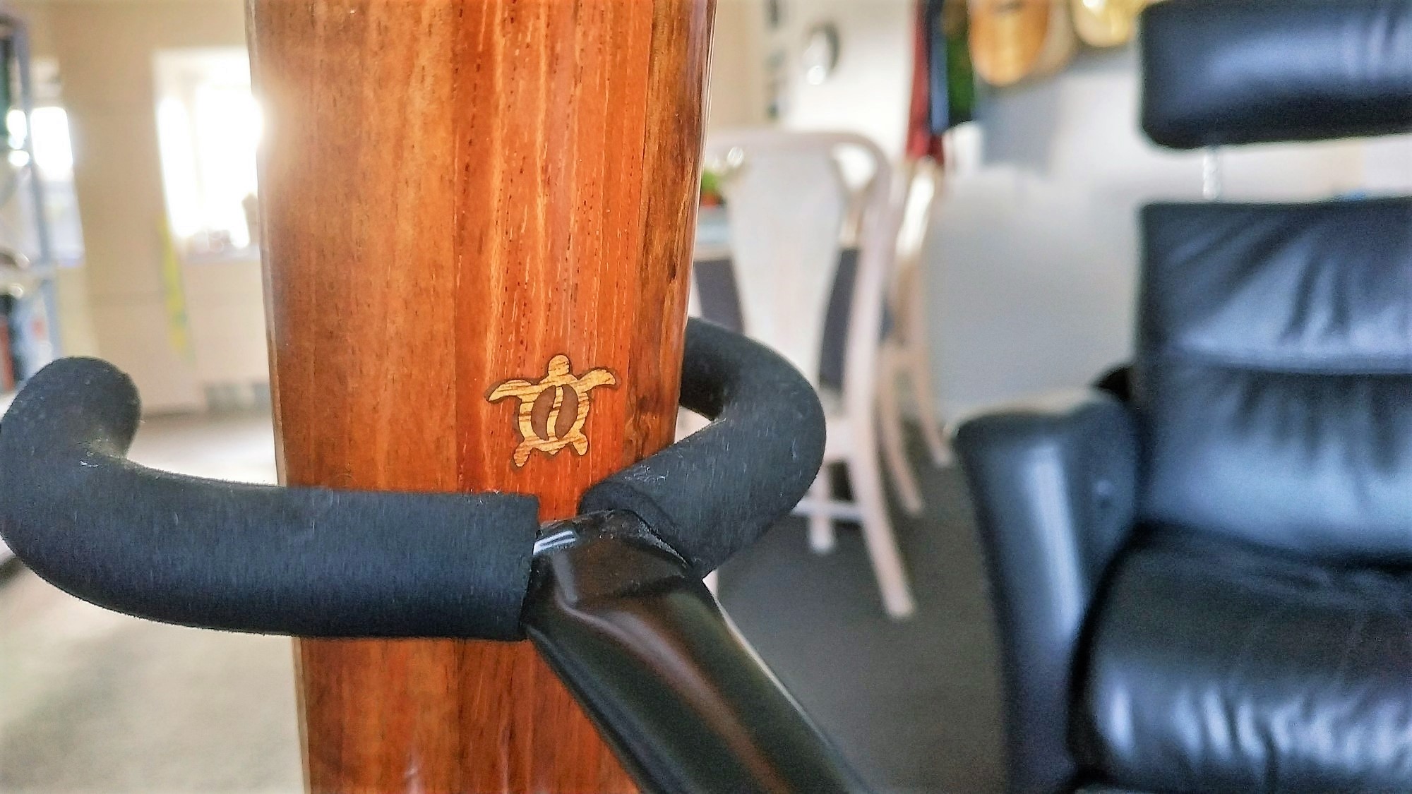

Neck : 3 pieces laminated Blackwood with Jatoba core.
Fretboard & Bridge : Ebony with dragonfly theme inlays (bit of a team work here), width at nut 45mm with zero fret and 56mm e to E at the bridge.
Koa turtle (present from Hawaii) inlaid on the back of the neck.
Strings: Martin silk & steel
Finishing: Platina shellac.
Very balanced sound with an incredible sustain, definitely another fingerstyle instrument.

Beautiful! Do you like the King Billy?

What a nice looking guitar... Love the inlay
Great work!!

Very interesting inlay styling. I'd expect that the Jarrah has given the sustain character. Great result.

Jarrah is a good wood for big bodied steel string guitars

I really like King Billy but very difficult to procure :!:

Hi Wayne, my conclusion is that the sustain characteristic is coming with the 3 pieces neck with the Jatoba core. It is an incredibly stiff timber but heavy, hence the 3 piece laminate with a lighter wood.

Very nice and wonderful inlay work!
