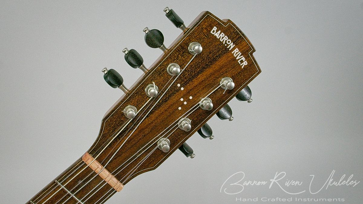

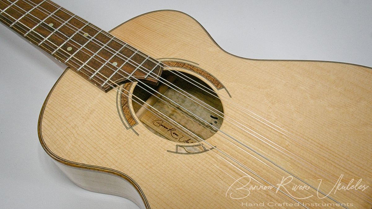

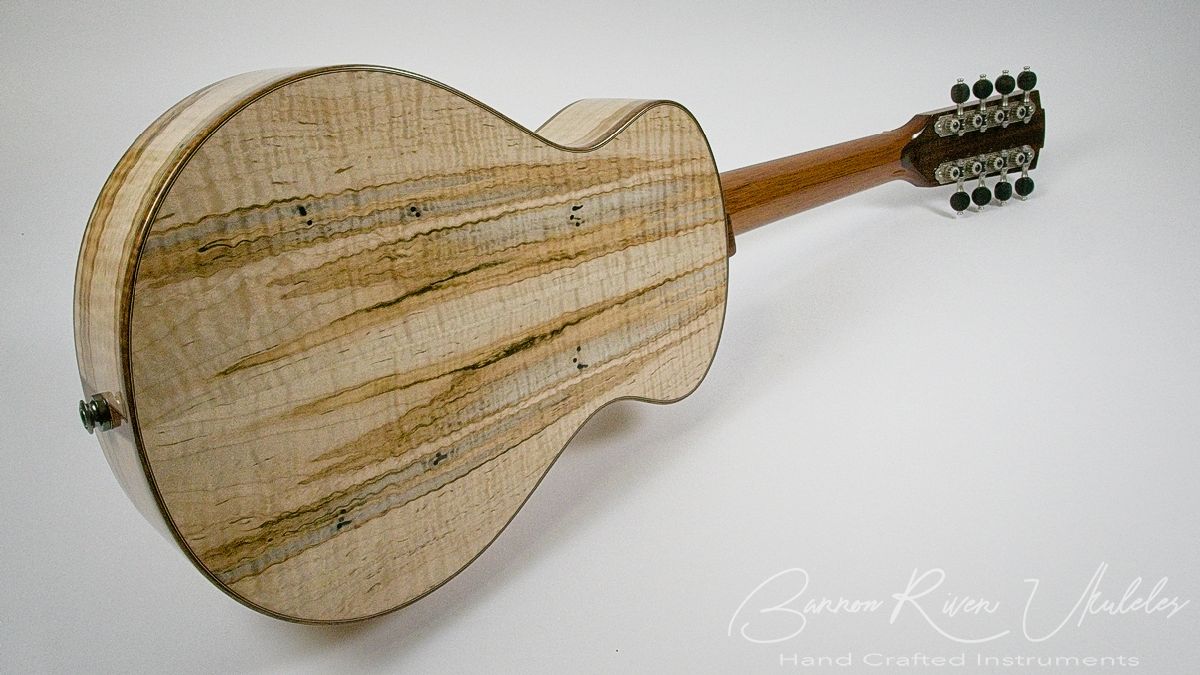

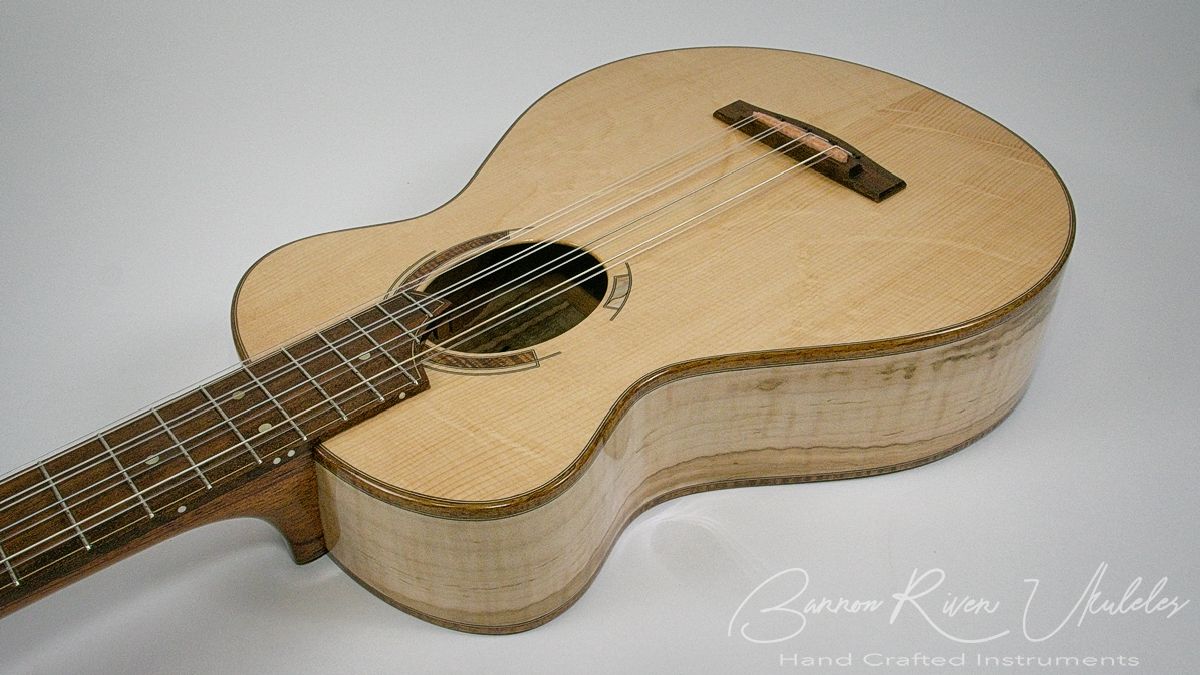

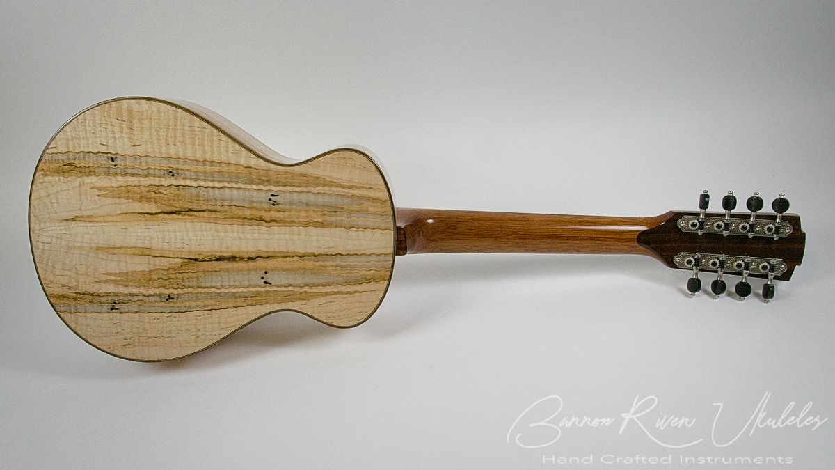

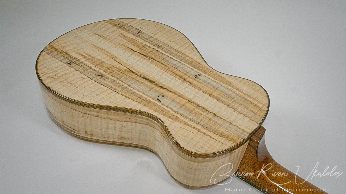

Post by Allen » Thu Feb 21, 2019 4:25 pm

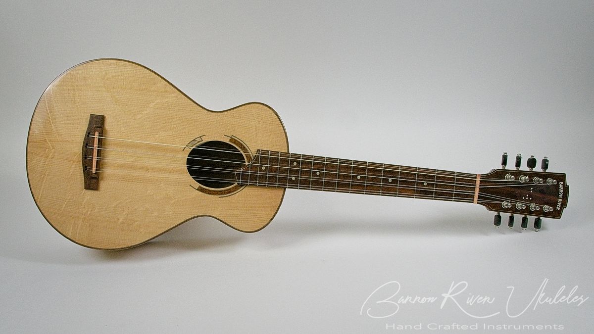

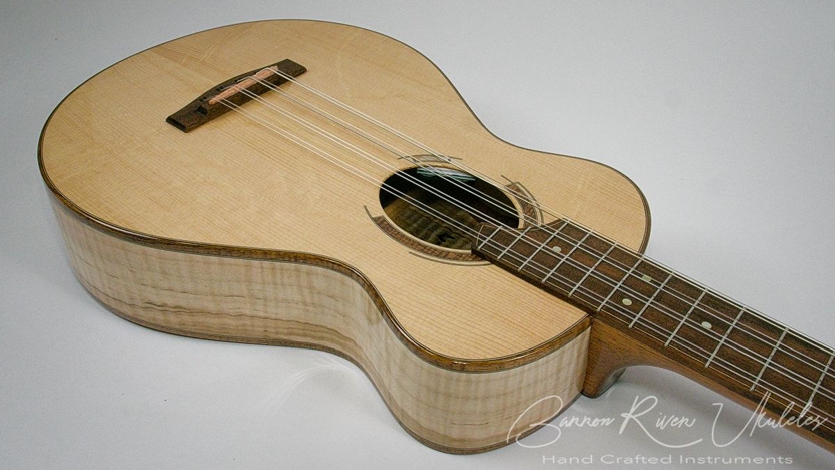

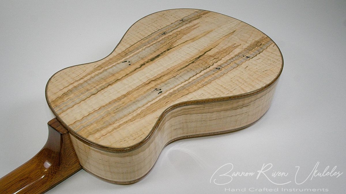

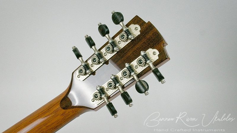

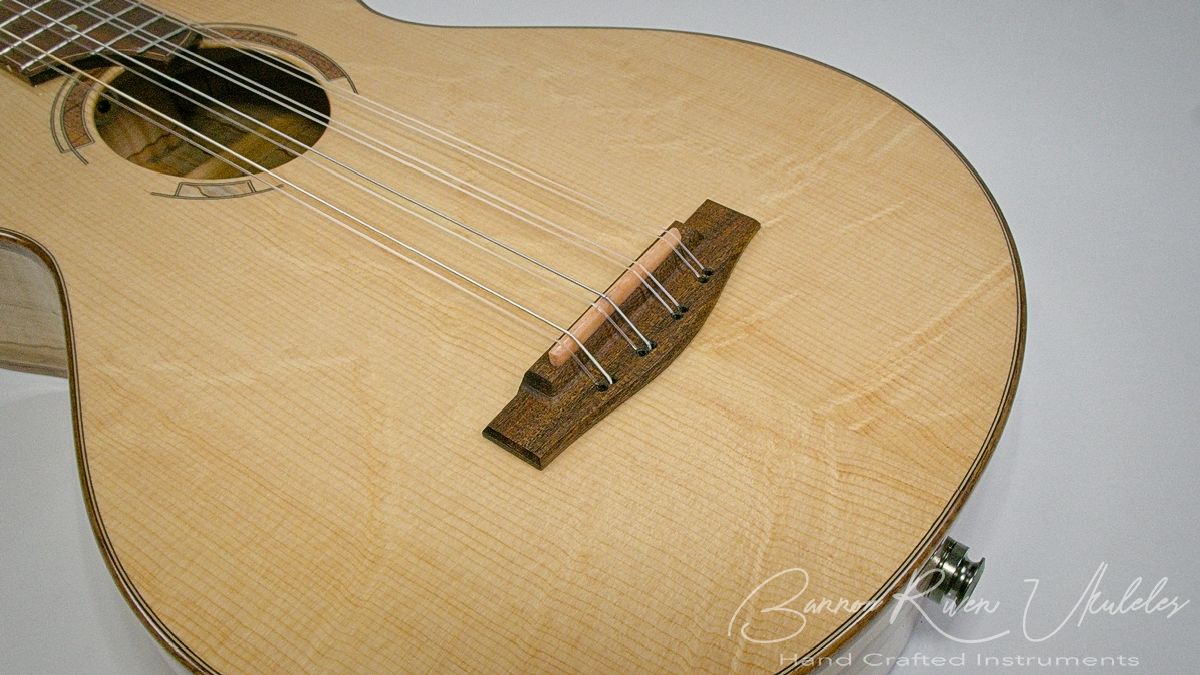

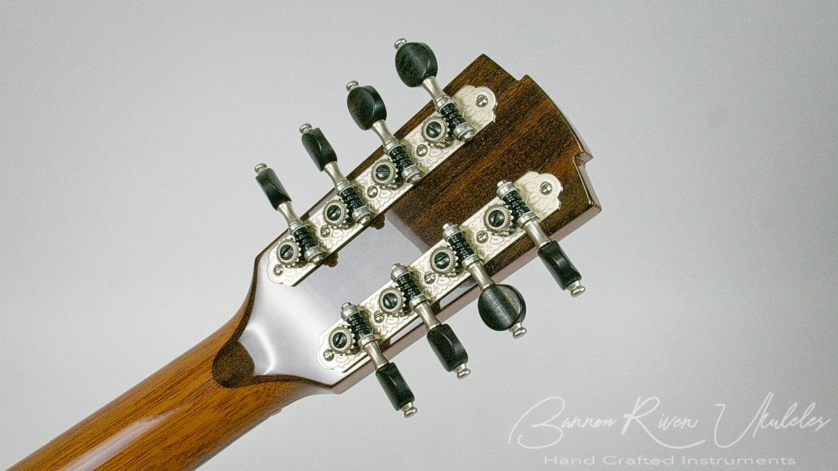

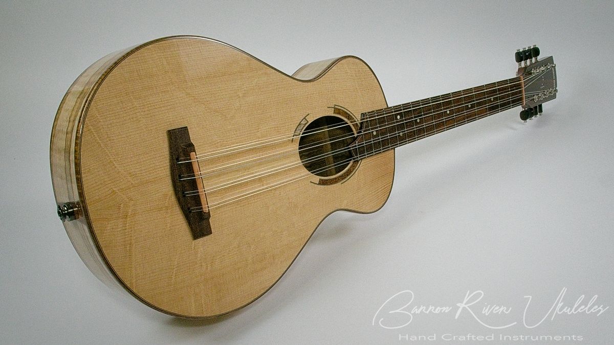

This was a commision for a young fellow as his first custom instrument. 20" Scale length and tuned to dD, gG, bb, ee.
Ambrosia Maple with a Sitka soundboard. Blackwood bindings and Supple Jack fret board, peg head veneers and bridge. Rubner tuners, MISI air pickup and high gloss polyurethane.

This is a very beautiful instrument :cl :cl :cl
