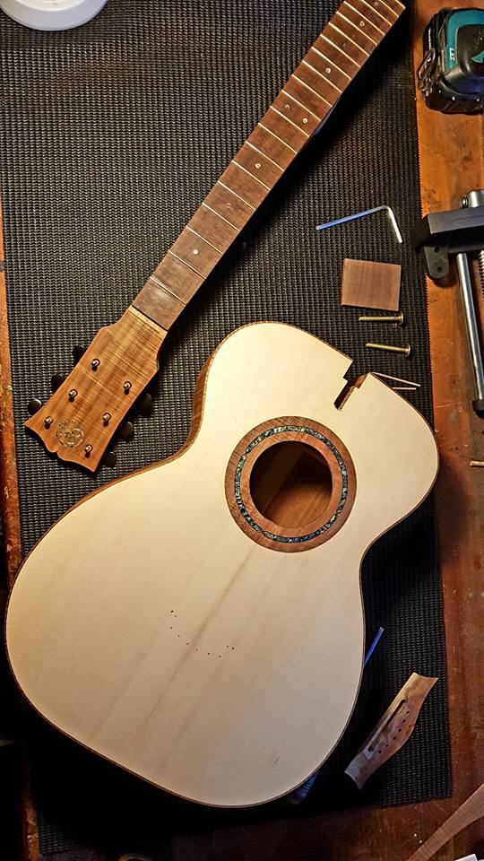

This baby was built with Trevor Gore's guitar course in mind - finished a few weeks before Trevor arrived in Newcastle and was hanging up in Phil Dawson's shed being sprayed when the course was on... bit of a shame but oh well :D

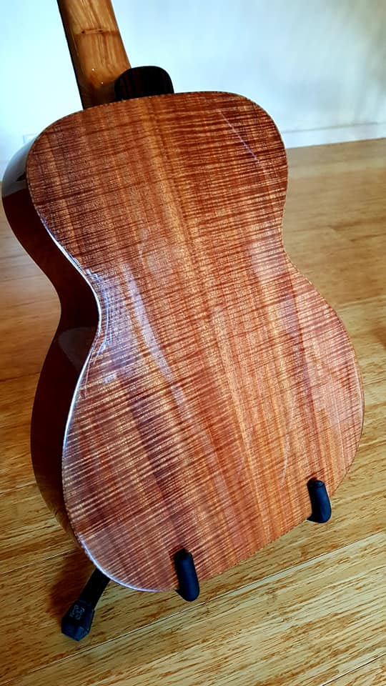

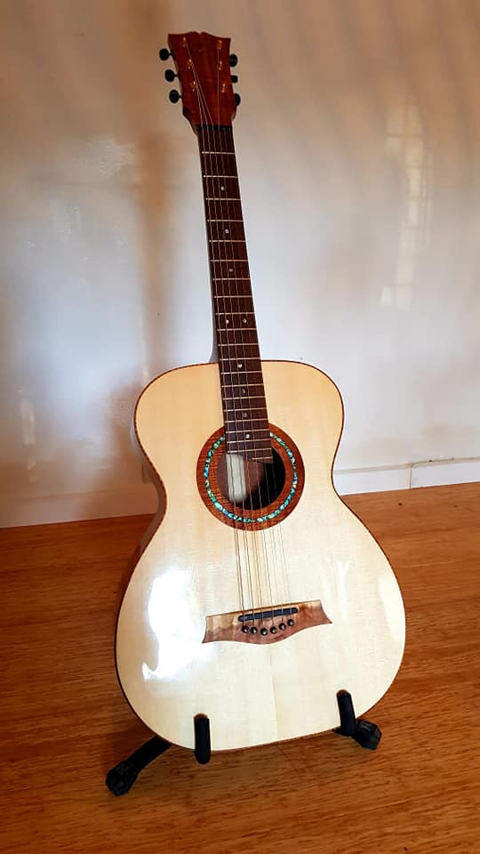

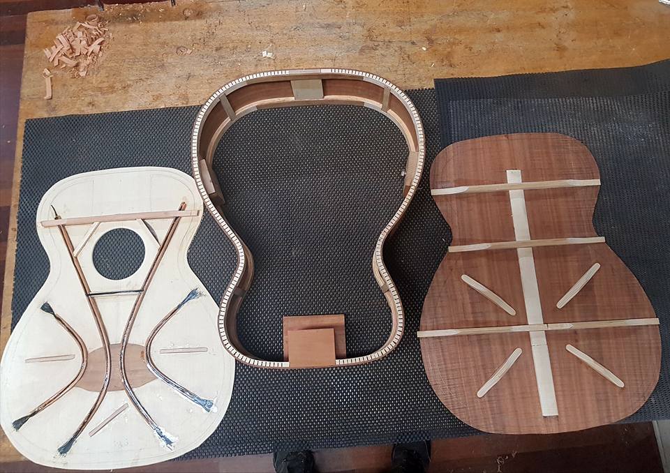

Top: Engelmann with Falcate Bracing
B&S: Blackwood, Live Back. Sides have weights bolted in for tone adjustments...
Neck: Qld Maple
Fretboard: mmm.. Gidgee i think..
Bridge & Headplate: Blackwood
Saddle & Nut: Tusq

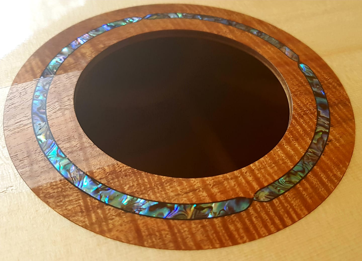

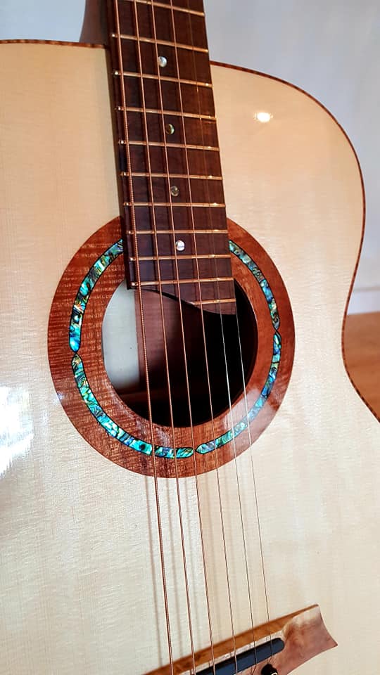

Rosette: Paua Shell (designed in Adobe Illustrator, cut using an engraving machine)
Pickup: K&K
Finish: Gloss Nitro
if you spot them, there's no need to remind me ;) - There are some awesome cosmetic mistakes with this build but I'm going with the Japanese concept of Wabi Sabi and appreciating the beauty of imperfection :D

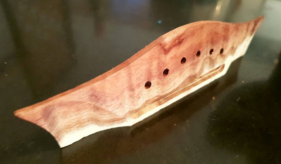

Post by lamanoditrento » Fri May 17, 2019 8:02 am
I love the grain and colour on that bridge
