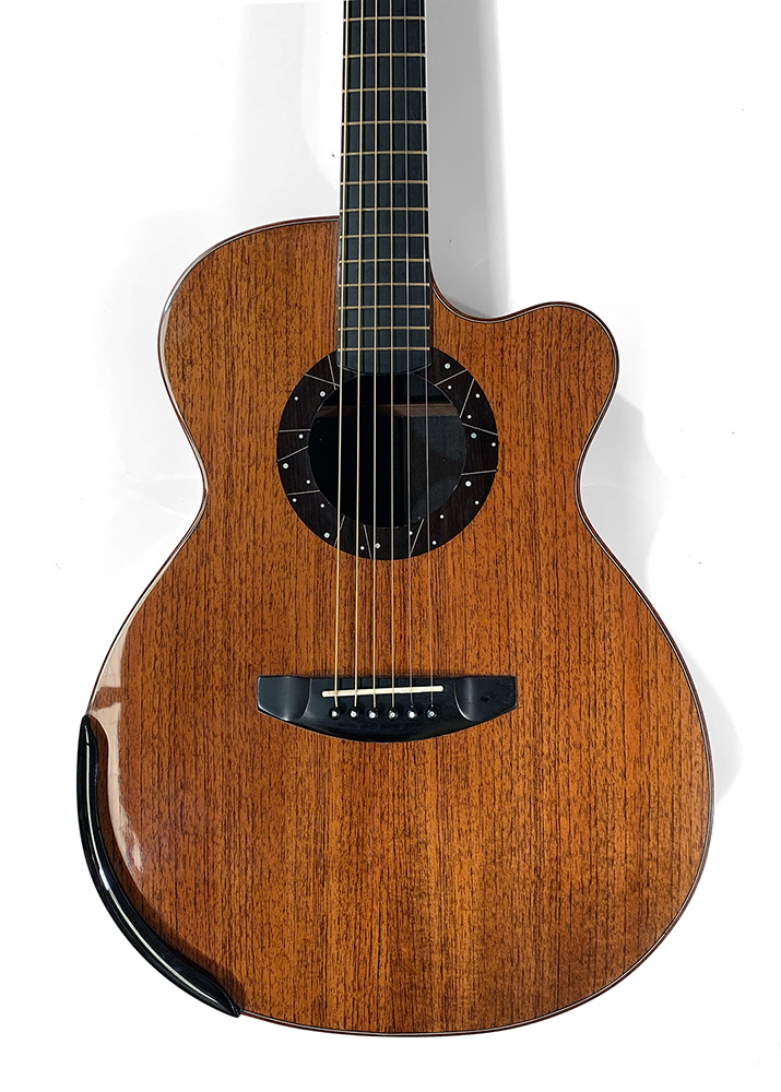

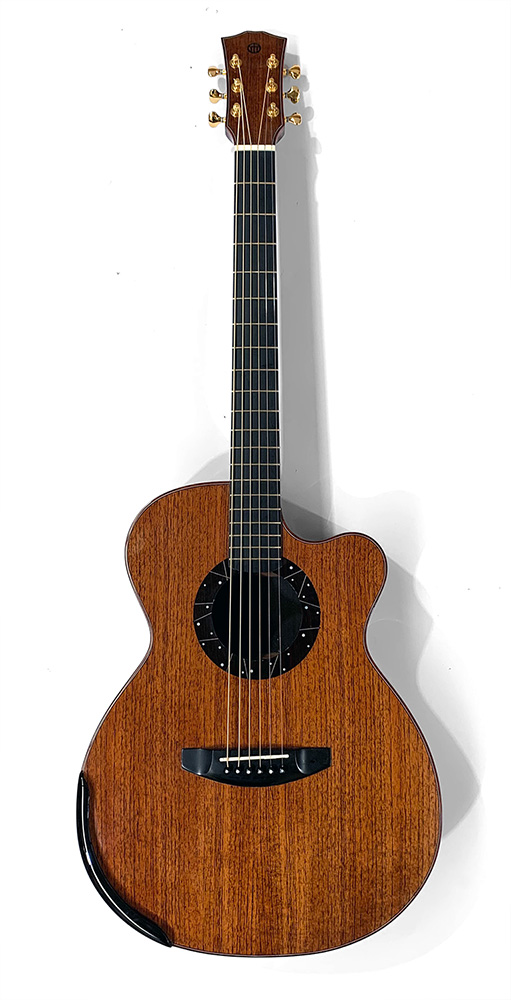

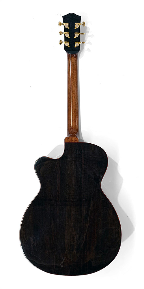

Ebony and Australian Red Cedar 000 Acoustic guitar. This one is a keeper! Sounds beautiful and warm. I love it. Ebony back and sides, Australian Red Cedar Soundboard and neck, Ebony fretboard, Gold Jescar frets, Gold Gotoh 510 machine heads, Bloodwood bindings, Falcate Braced.

A great looking guitar!
I like the timber combinations. Did you have any issues working with the Australian Red Cedar timber being very soft? What was the final thickness of the Top? Like here a sound sample if possible.

Thanks Wayne, the Red Cedar slab I used for this was from Mal at Boutique Timbers and it was considerably more dense than the recently milled timber currently available. It was from a very old growth tree and is dense enough to do back and sides from it too I think. I may do a Flamenco with it on the back and sides.WJ Guitars wrote: ↑Sat Nov 23, 2019 4:43 pmA great looking guitar!

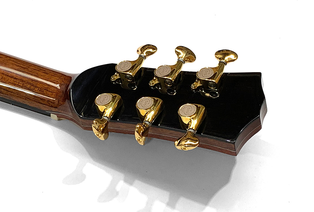

Can I ask: is the headstock-front "veneer" quite thick? With a nice bwb line around the outside - fibre sheets? What glue did you use on the headstock veneer and lines?

The front veneer is only 2mm thick but then I bound the headstock with Bloodwood bindings that have BWB on them which is why it looks so thick I think. I used Titebond for the veneer and bindings. Also the back veneer is Ebony.
