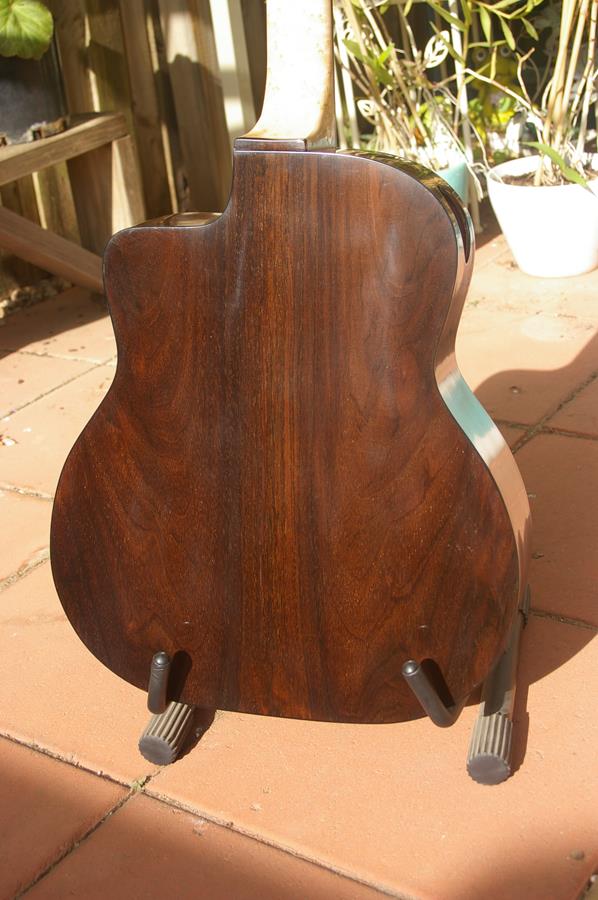

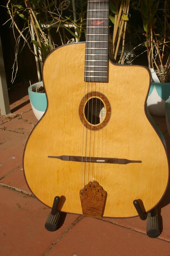

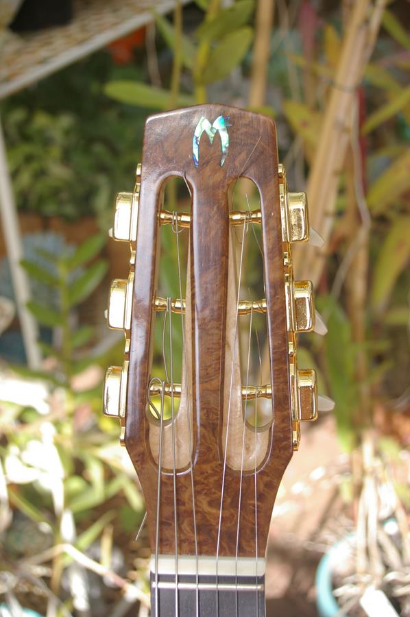

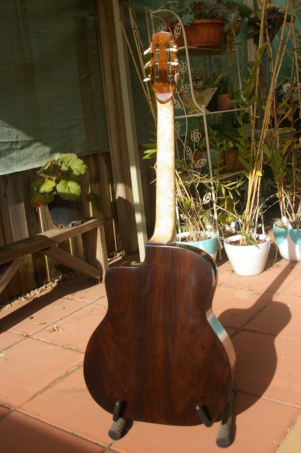

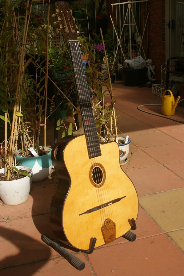

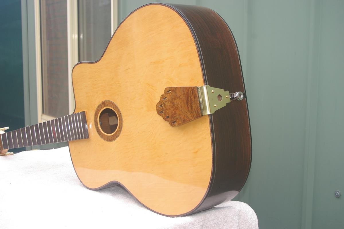

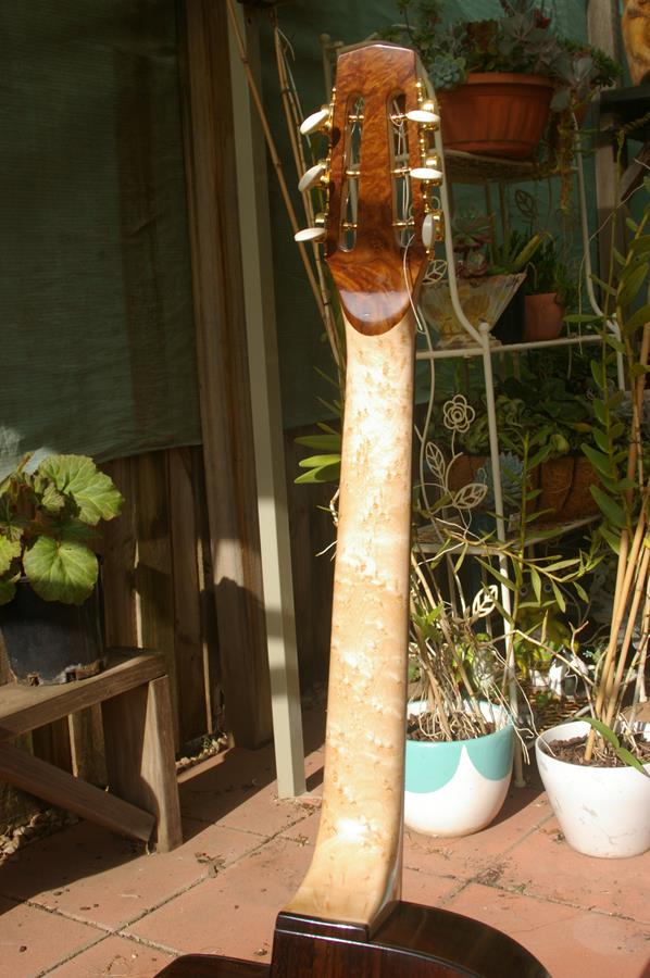

Almost finished after about 14 months just a p/up to install at the f/b end. I have to say this was the most difficult guitar I've built so far, had quite a few problems early on especially getting a nice top joint after bending the pliage. I have to thank Ross from our forum for a lot of good advice that really helped. At the owners request the last brace was left off the top and replaced with lattice, I didn't want to do that but I have to say it worked out great. Not sure why but the photos of the top look a bit yellow I've included an earlier one which is what it looks like. Sounds great by the way, I had a friend have a play on it.
BRW b/s
Huon top
EIRE bridge
ABW f/b
Selmer tuners
Birds eye maple neck
Burl veneers on the headstock and tail piece ( from Tim )
FP top, lacquer b/s

Very fine work there.
Love the Birds Eye neck.
Congratulations on your patience.
