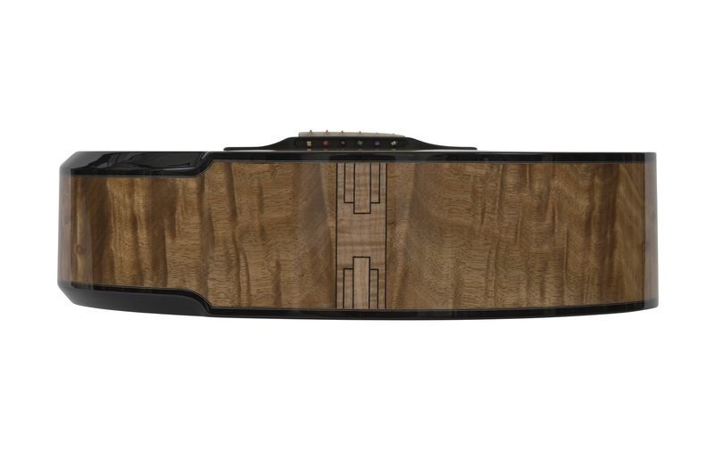

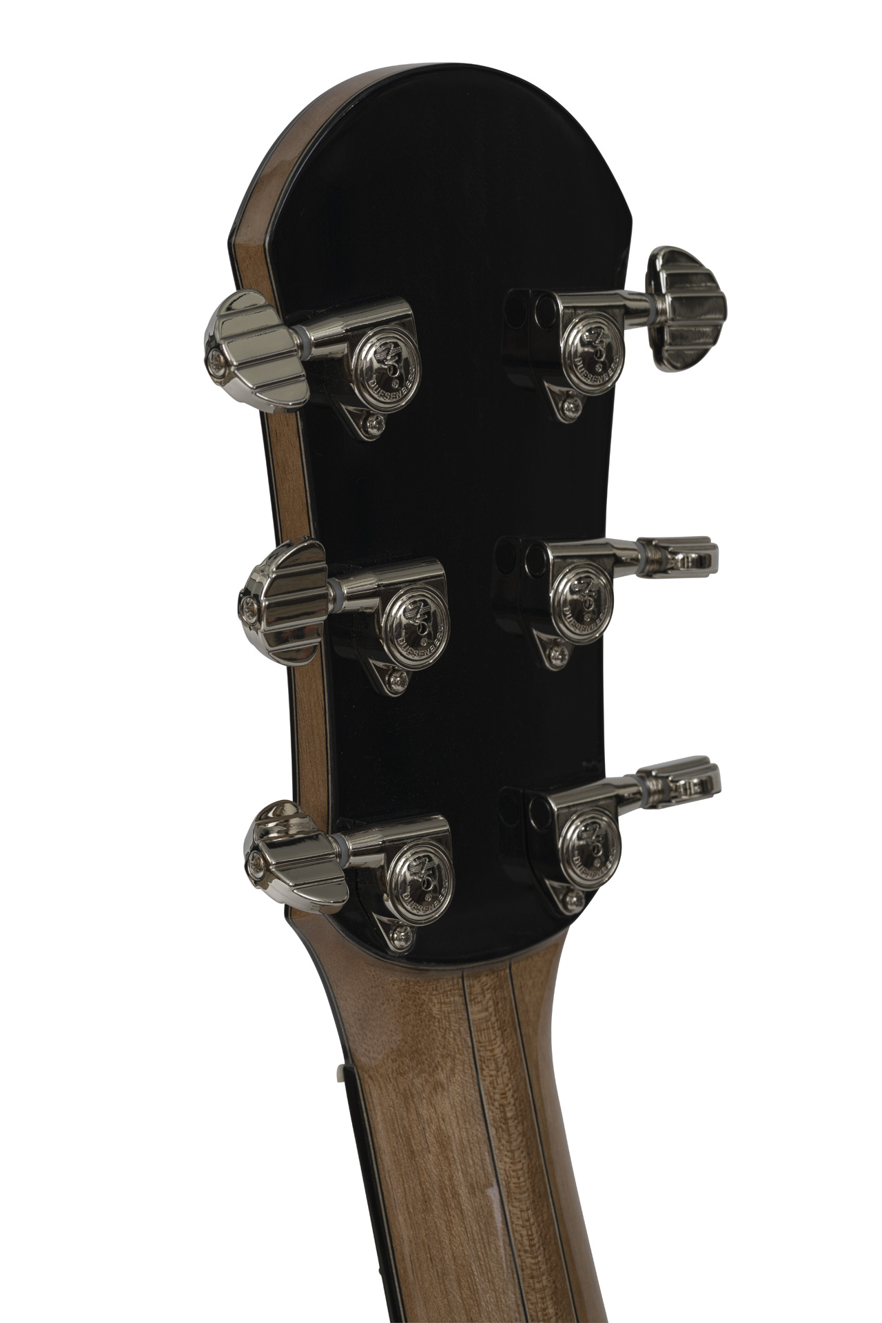

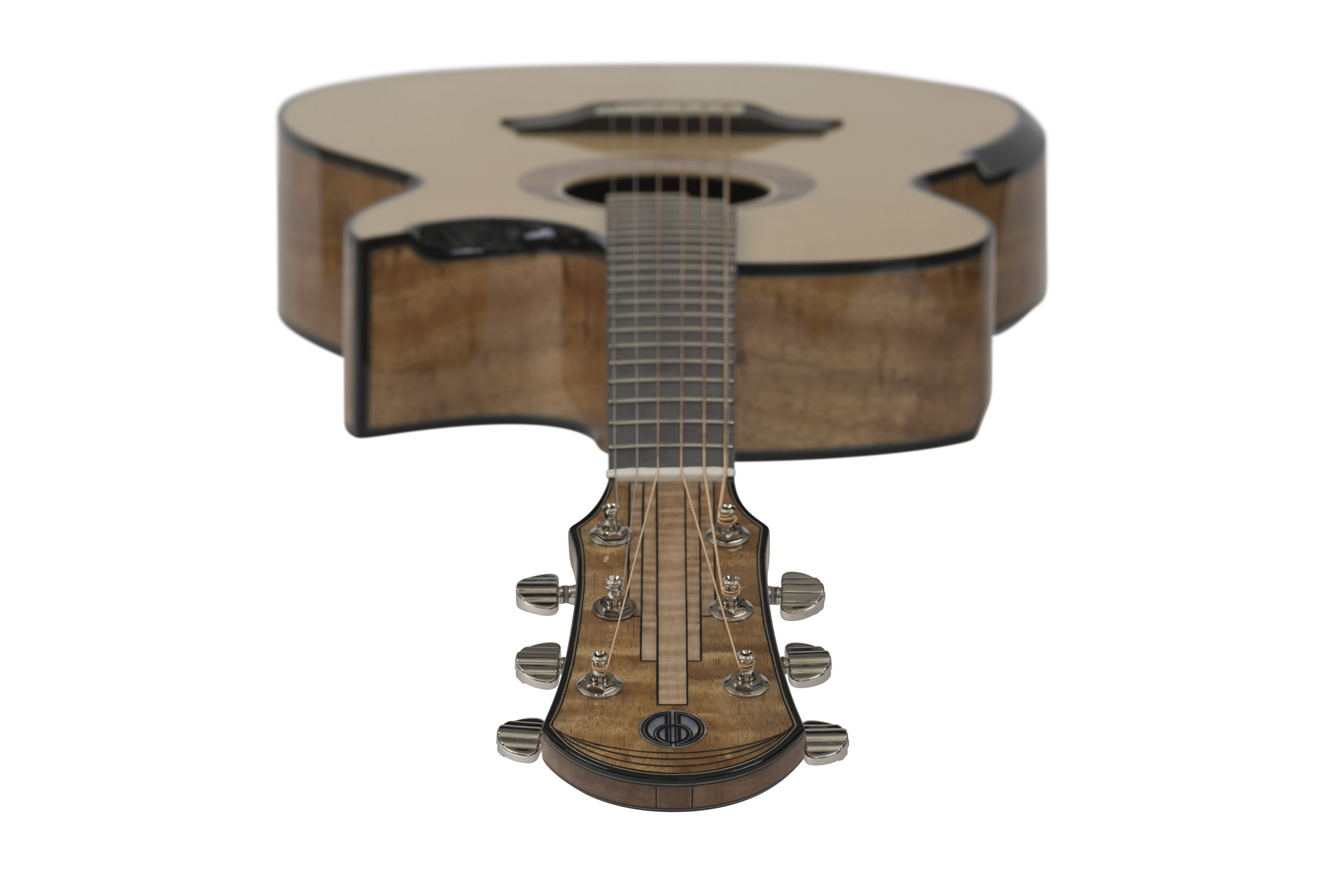

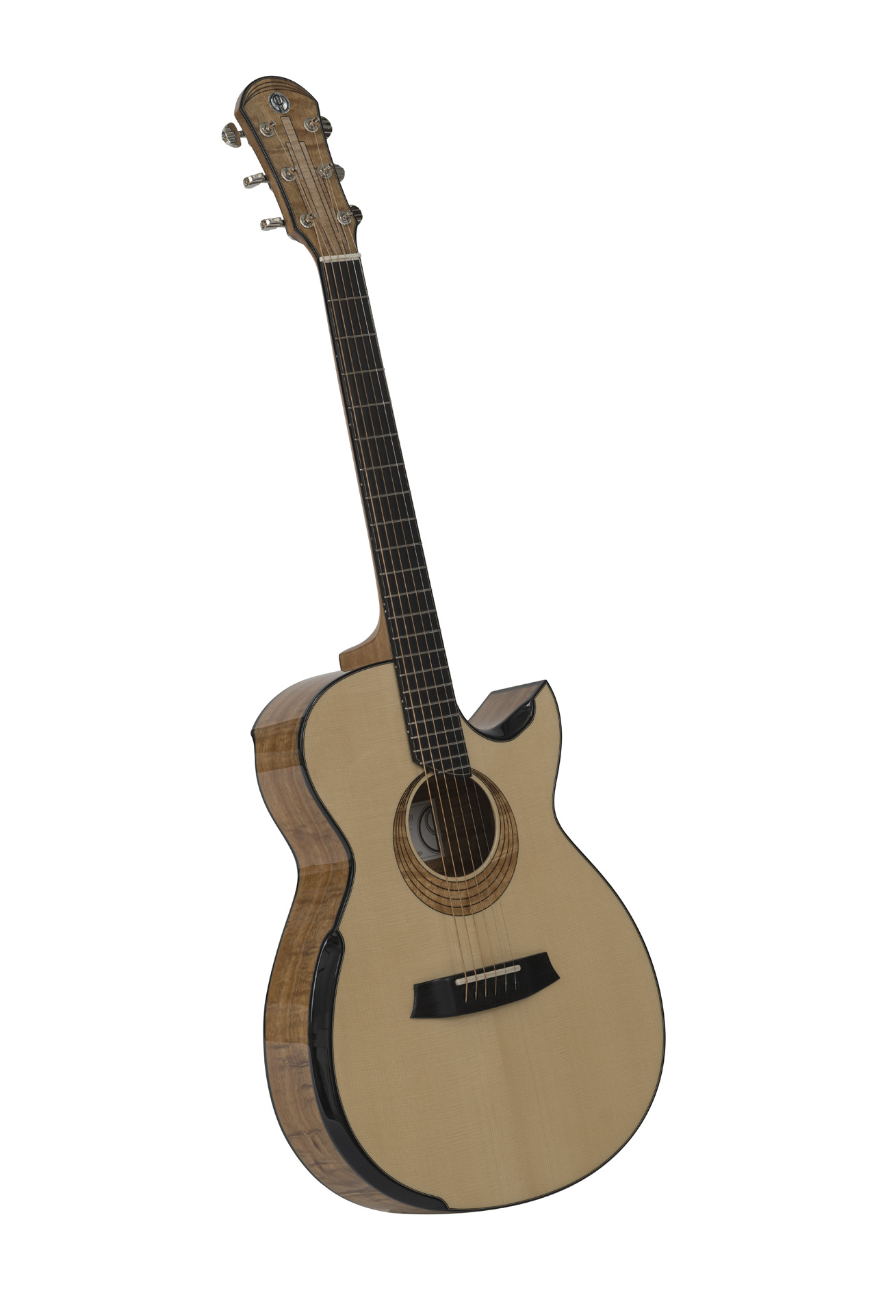

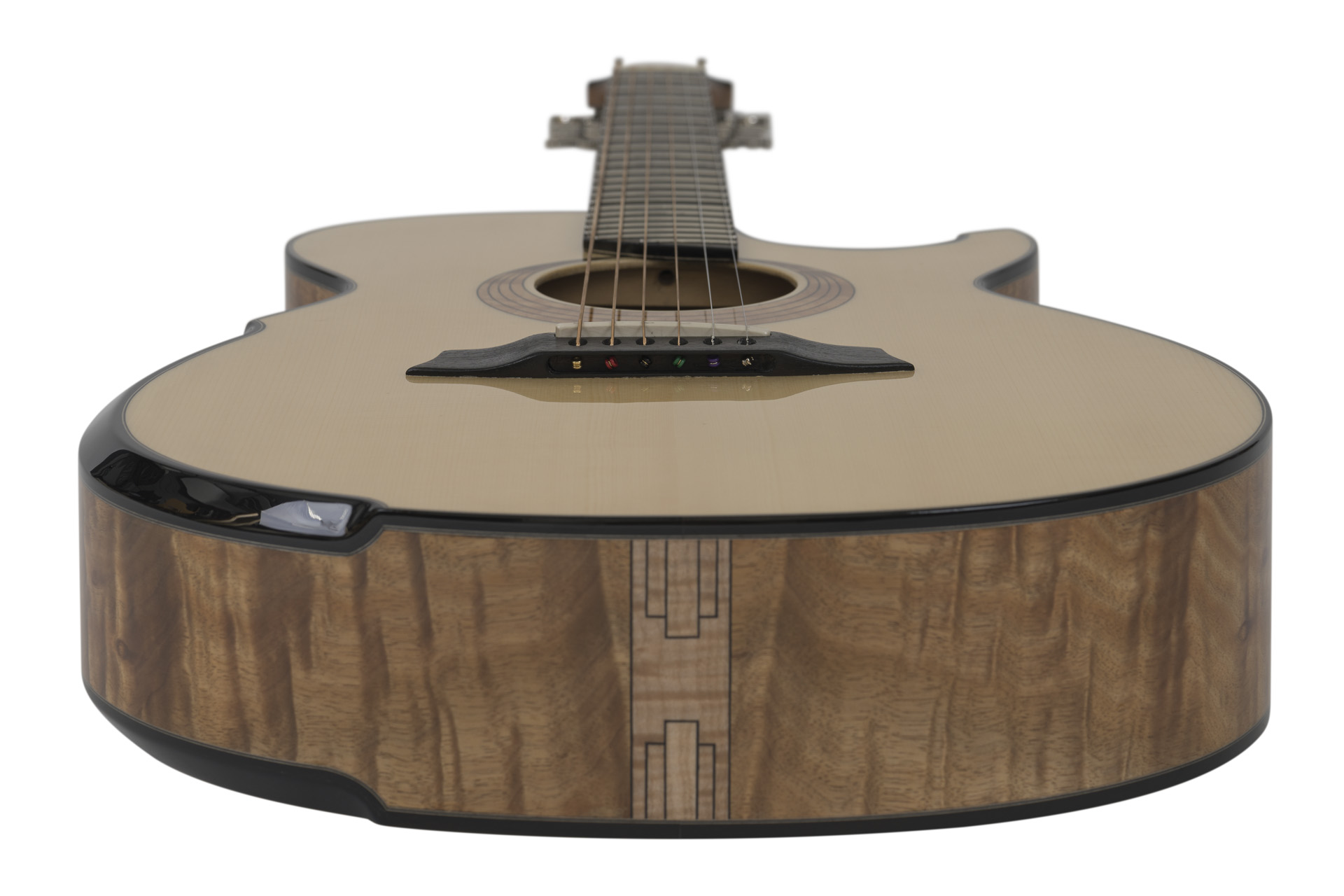

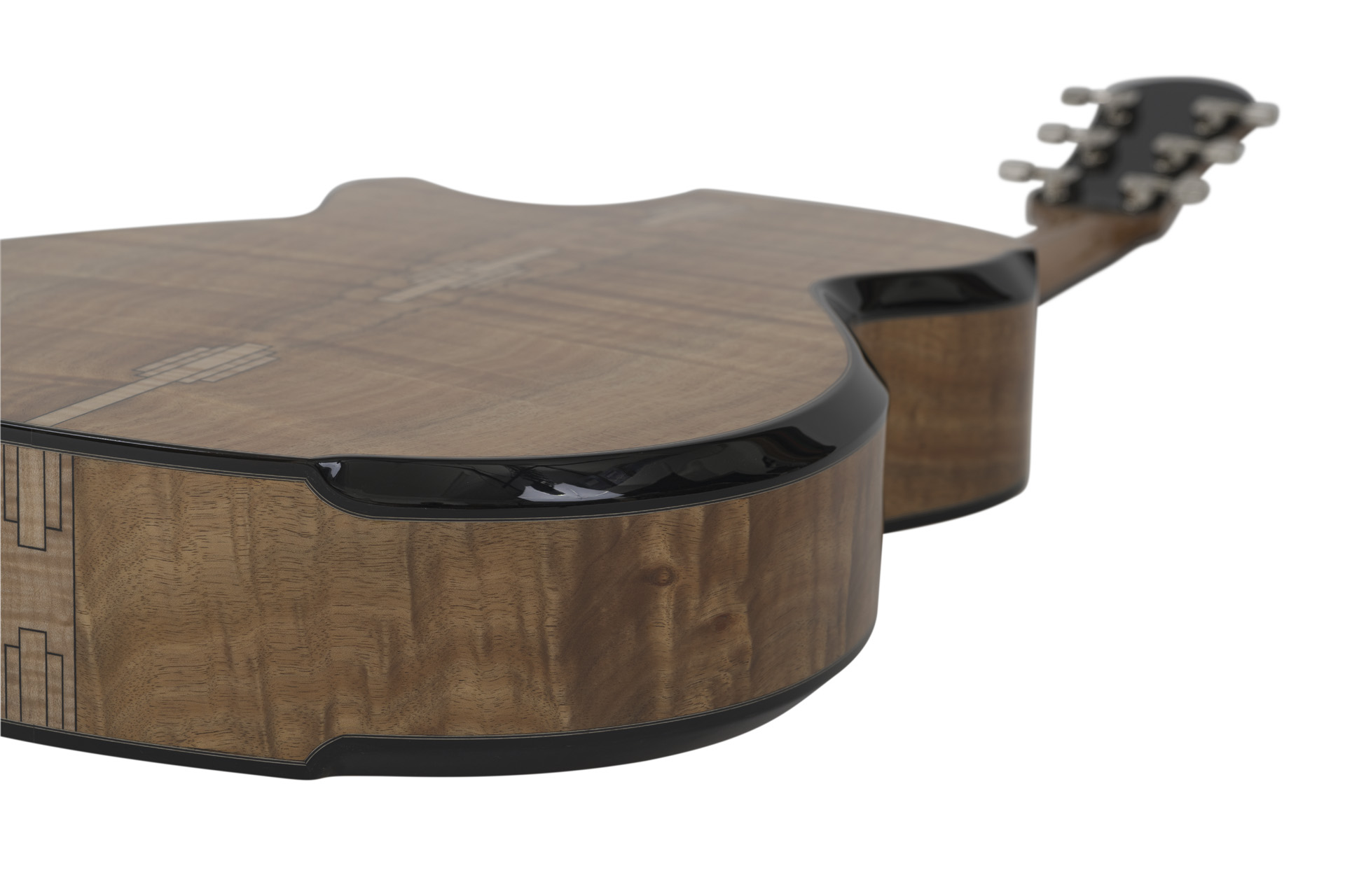

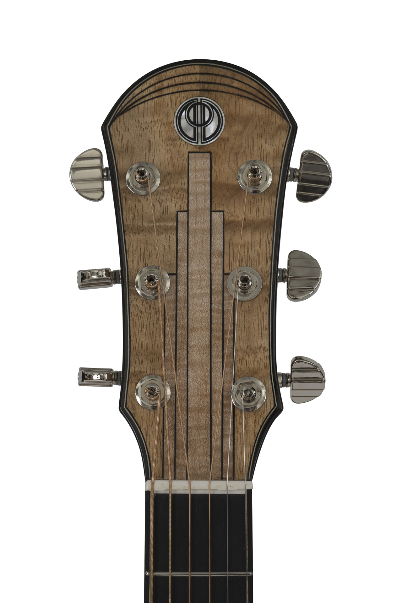

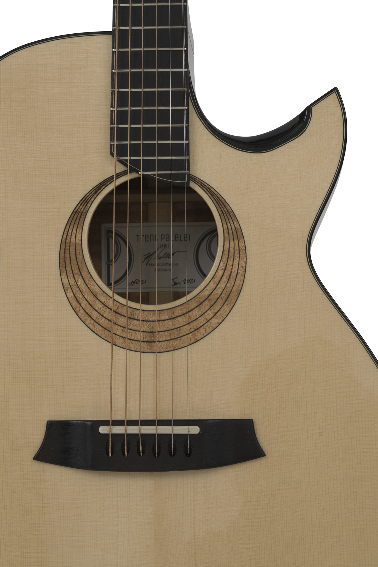

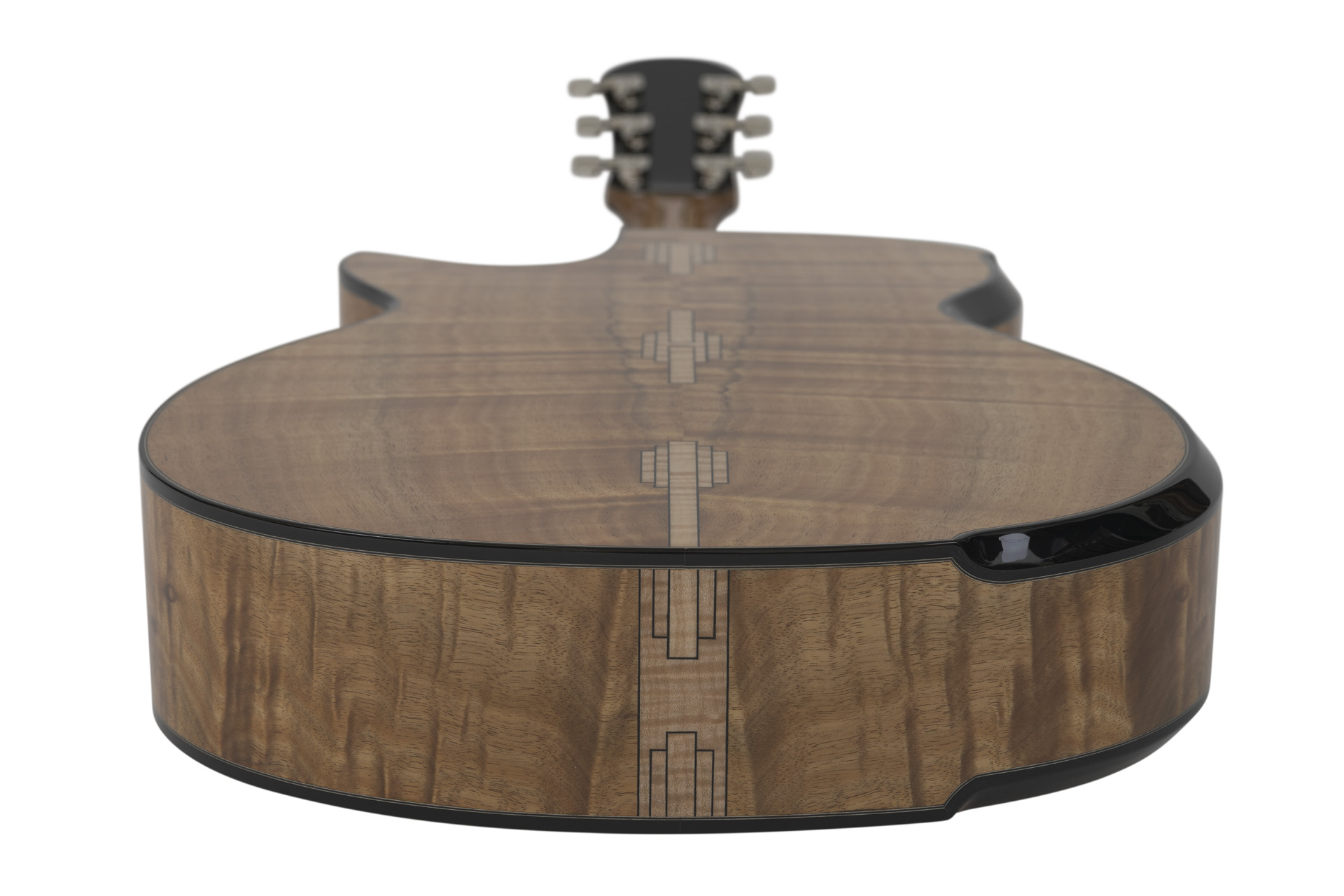

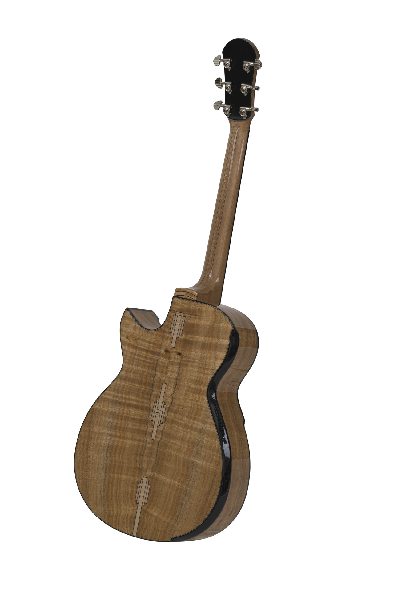

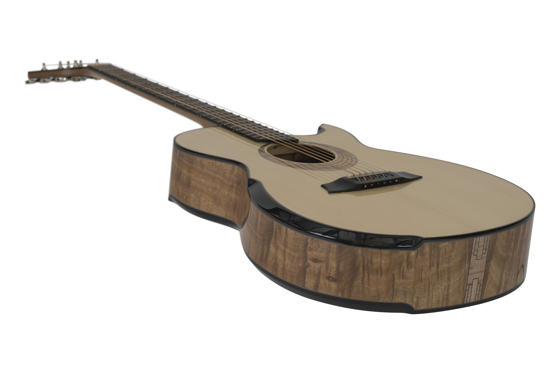

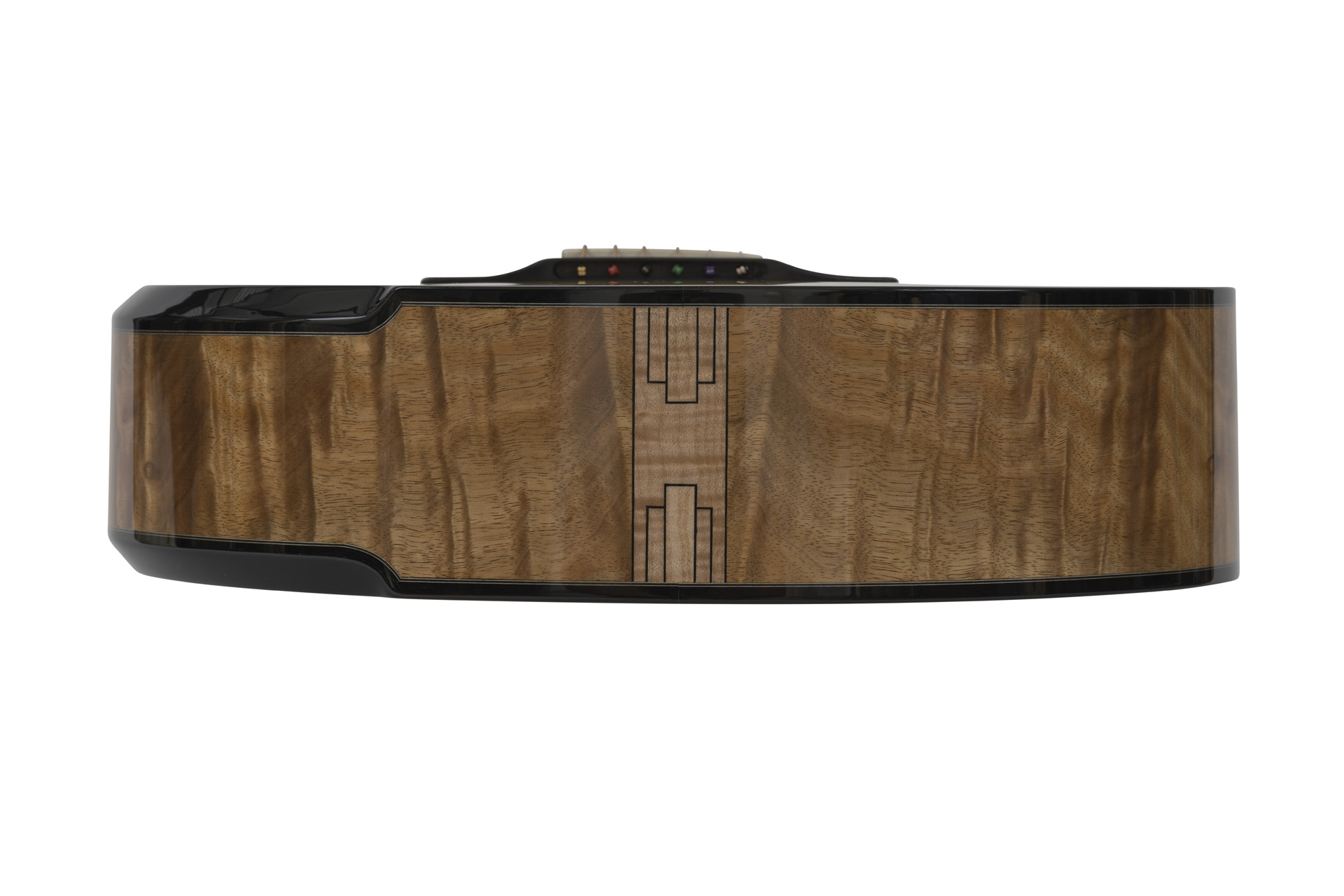

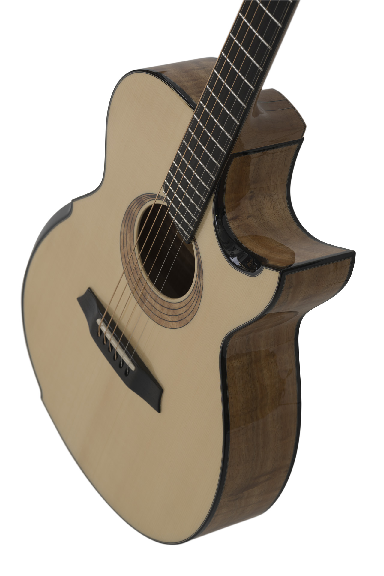

Recently finished this 14 fret falacate braced OM. Bit of kitchen sink build with arm bevel, rib rest and what I am calling a Siena cutaway. I should have some sound sample in a couple of weeks to add but thought I would throw up the pics now. My first use of stainless steel frets and attempt at semi-hemispherical fret ends which I quite enjoyed but having played them, I am not sure it worth the bother. Good to have it as an option I suppose.

Pushing the boundaries there Trent. That's one classy looking guitar....not bad for a "kitchen sink" build.

That is a very finely crafted package. You really have the aesthetic theme well worked out in all of the different elements.
I notice how the nut compensation means that you can eliminate the need to slope the saddle. It is a subtle thing but it actually changes the appearance of the guitar a lot to have that symmetrical look at the bridge. It looks so much more “classical” than most steel string acoustics. And now I know what you meant by “all about the pinless bridge”. V. Nice.
The timber art deco style inlays are really cool and nicely recreated in many different places to get a whole theme going (I assume that is CNC, please don’t tell me you can cut that by hand?). And you sent me off on a search to check out those Duesenberg tuners with the fancy buttons, they just complete the whole package.
Nice work, Sir. How are you doing your finishing these days?

There is a tiny bit of cnc on this guitar: the nut. I decided I can't be bothered cutting them anymore, so fiddly, and got a friend to cut five of them at once. So yes all inlay by hand mostly with a scalpel, chisel and dremel to hog the bulk out.
Andrew has the duesenbergs here here if you want some.
The finish is precat poly Mirotone 3242

Looking nice, love the execution of the bevels.

I like the style and character created. All those bevels are amazing.

Really nice lines on that guitar.

Beautiful work Trent- been meaning to have a go at some bevels but must admit I find it a bit intimidating- these look superb!

Ken Everett's course is a really good place to start. I couldn't get my head around it until I went through his course.

Love the design elements and the whole look of the "kitchen sink" - It has the works! Inlay work looks like it took ages of patience to execute perfectly.
I have a couple of questions about the pinless bridge. First is the bridge laminated with CF? Secondly, is there any additional securing of the bridge to the plate beyond the glue (what glue?)?

Hi Bernie, no the bridge doesn't have CF, it is a nice light piece of blackwood that I ebonized with steelwool and vinegar. It also has a hidden bit of bone inlaid for the ball ends to hold against. I ummm and ahhh'ed over whether or not to put a bridge patch in, seeing as there will be no ball ends to damage the underside of the SB. In the end, I justified putting one in because of the neutral axis, but honestly it was really just a gut call. I always use HHG vacuum clamped for bridges these days. I can't imagine doing it any other way now. Having personally experienced trying to remove a bridge glued with HHG and a vacuum clamp (it was put on upside down) only after a couple of days, I am convinced there will be no issue.
