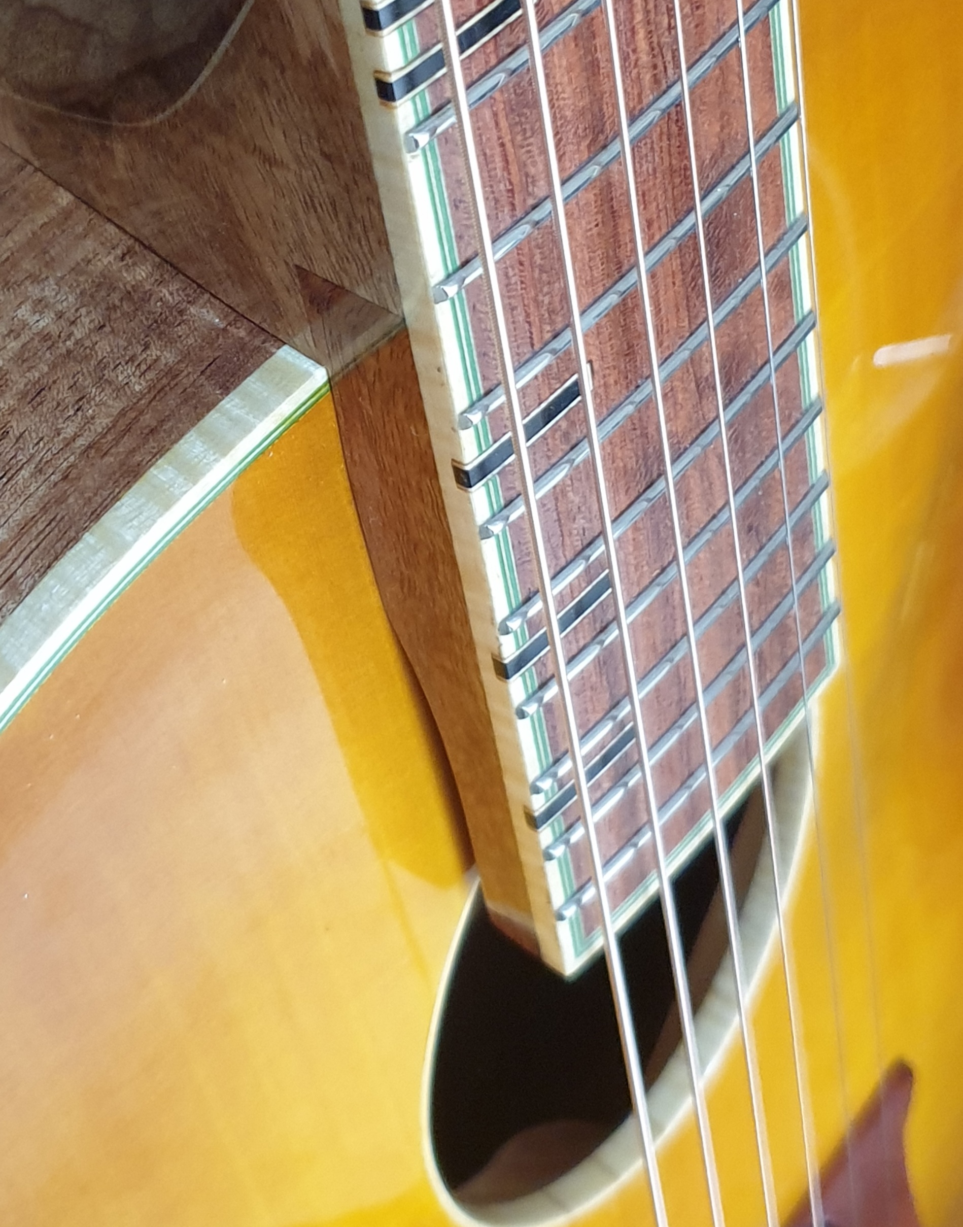

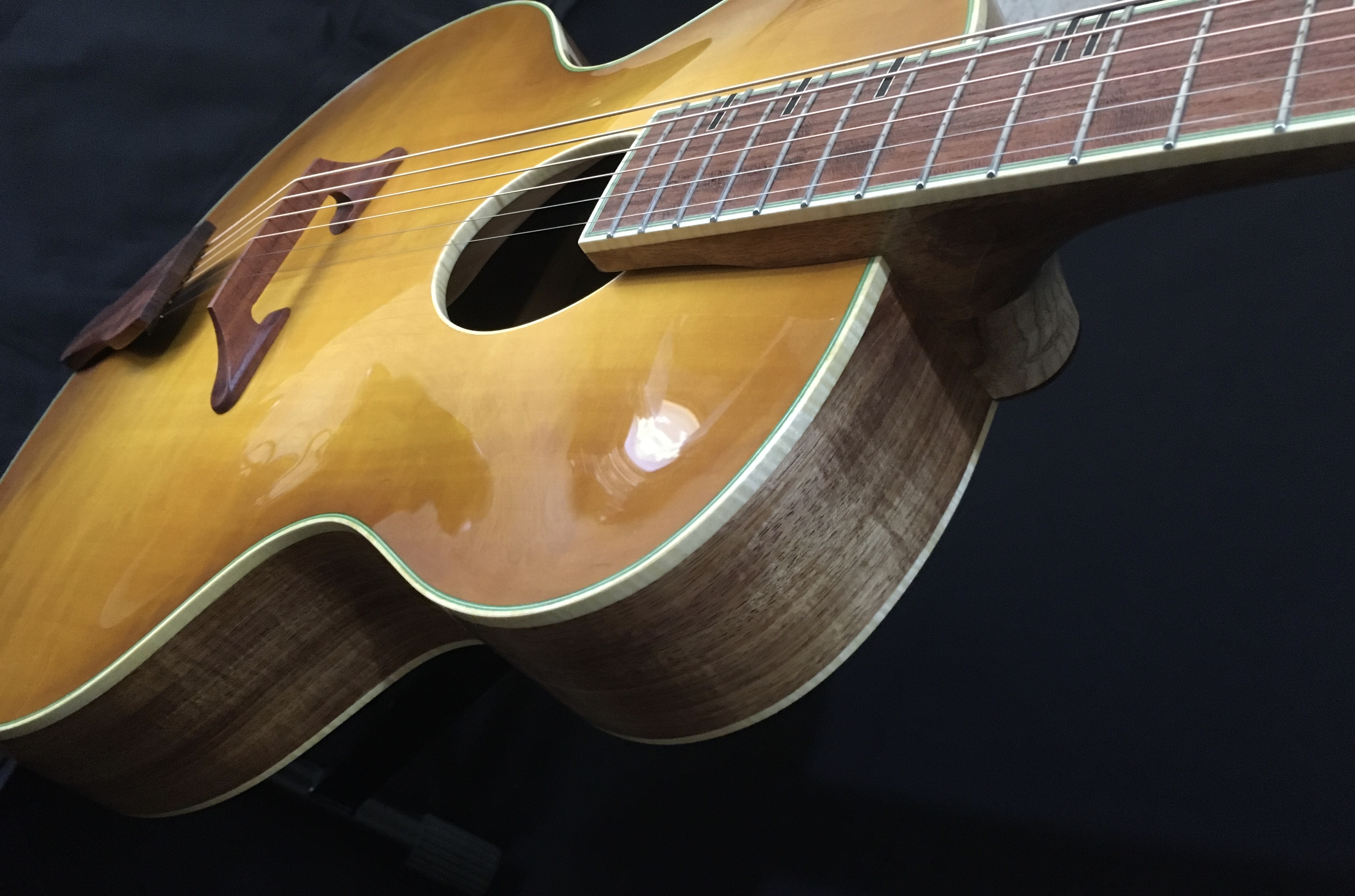

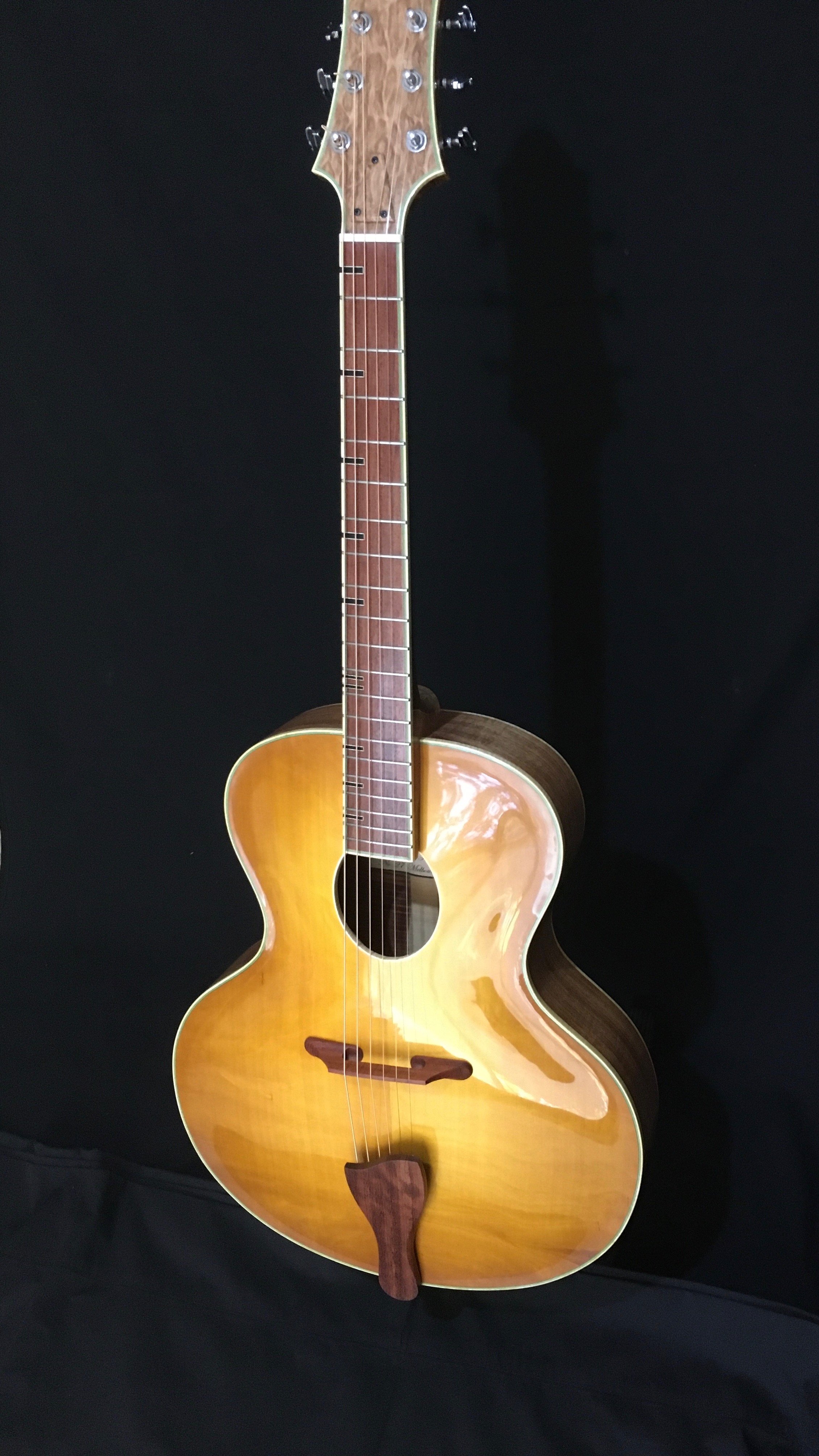

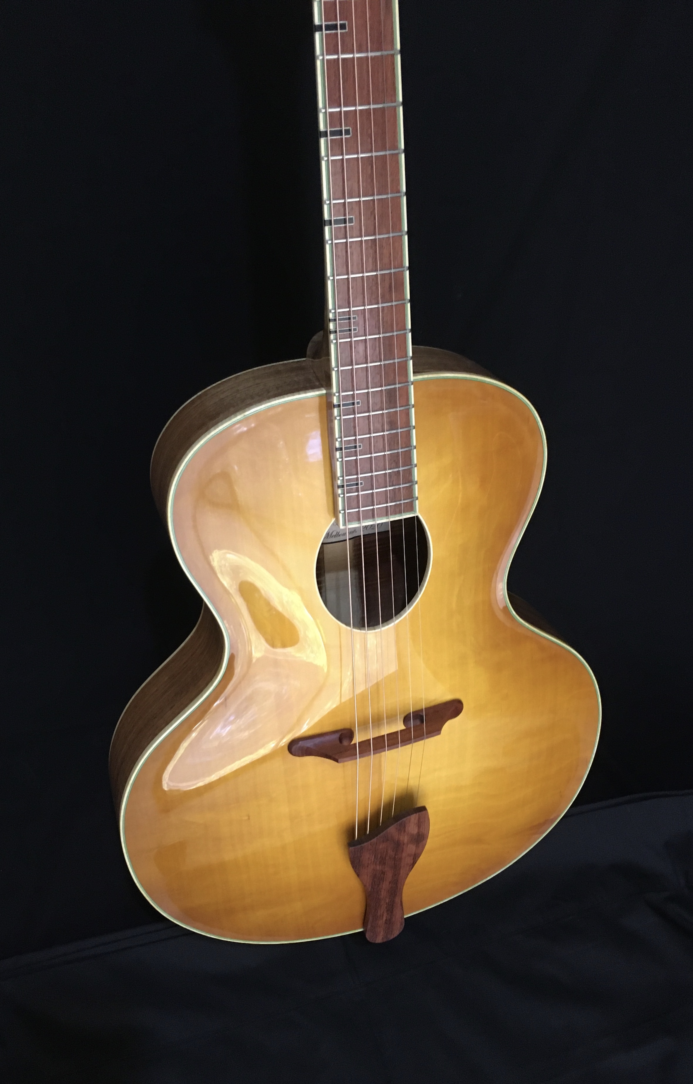

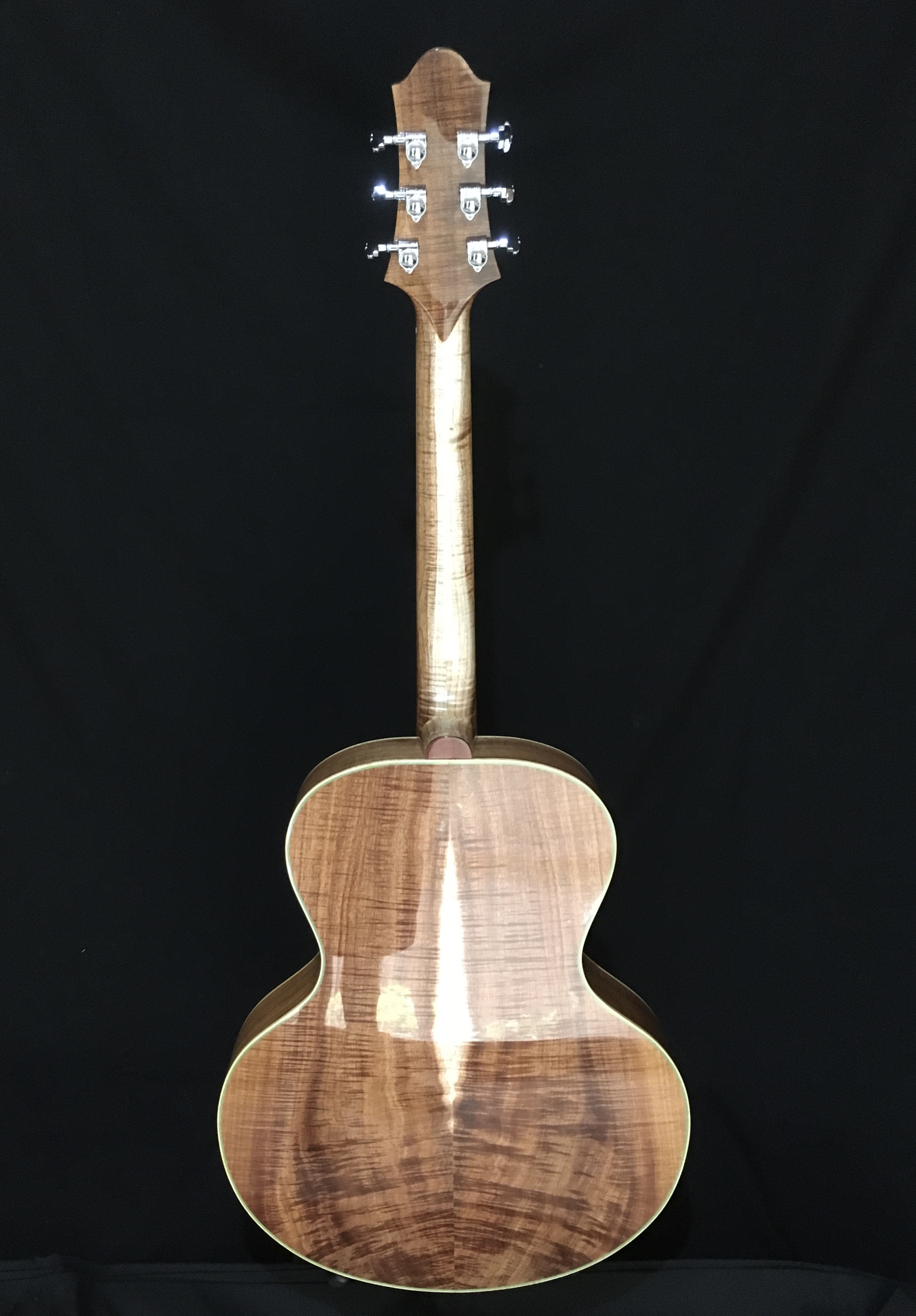

Post by rocket » Tue Apr 13, 2021 8:06 pm
Built this one a couple of months back
Enjoy!!

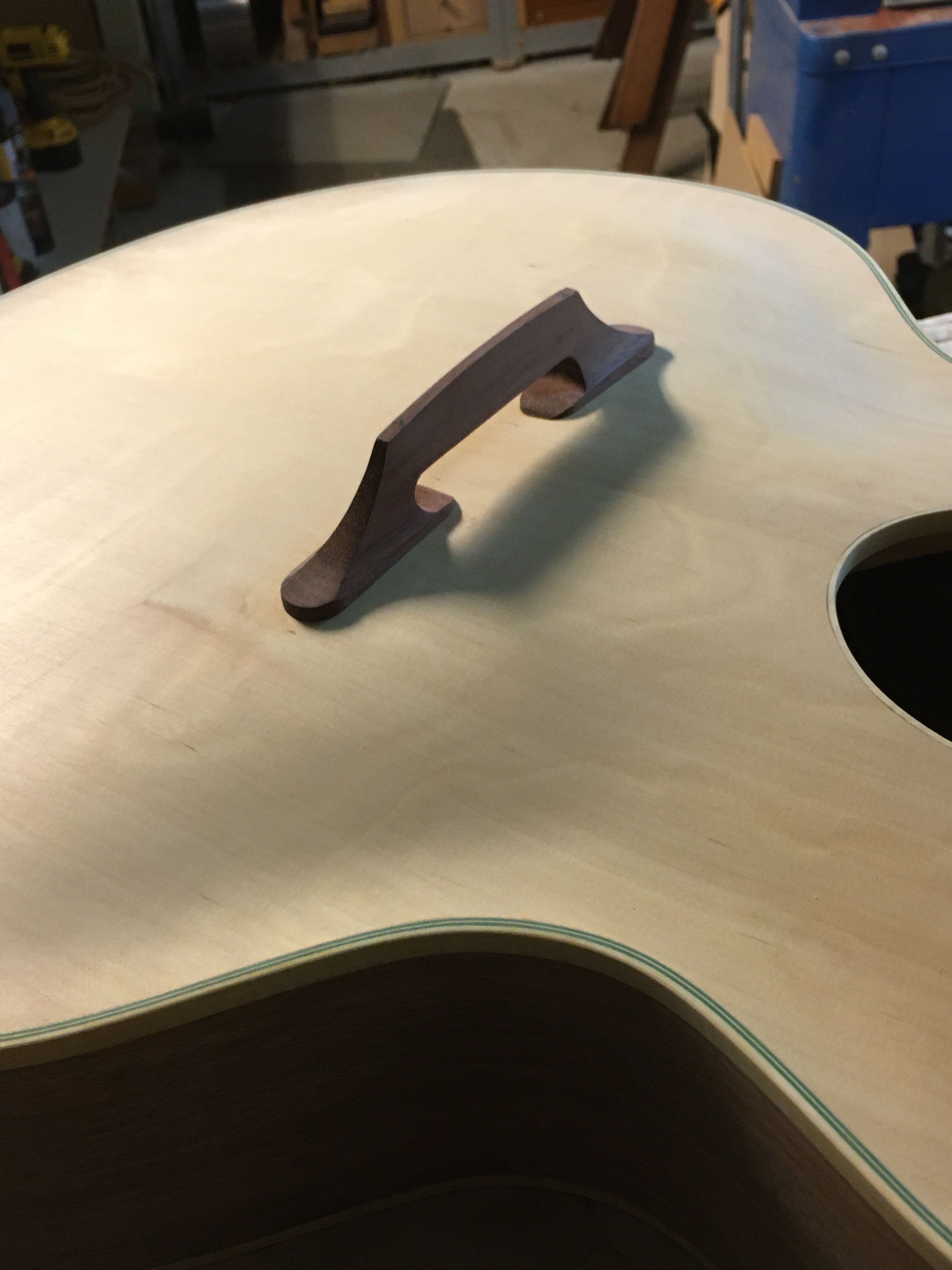

Post by rocket » Thu Apr 15, 2021 8:21 pm
The guitar has Otways Blackwood back and sides, the sides are double sides, the back has a 3 meter radius and ladder bracing, the carved top is X braced Huon pine with Schaller Oyster piezo installed. Blackwood neck with Bubinga fretboard, Bubinga bridge and tailpiece.
Very happy with the performance of this, the huge volume is partly due to the radius back and i think also to the careful graduating of the Huon Pine
Thanks for looking!
