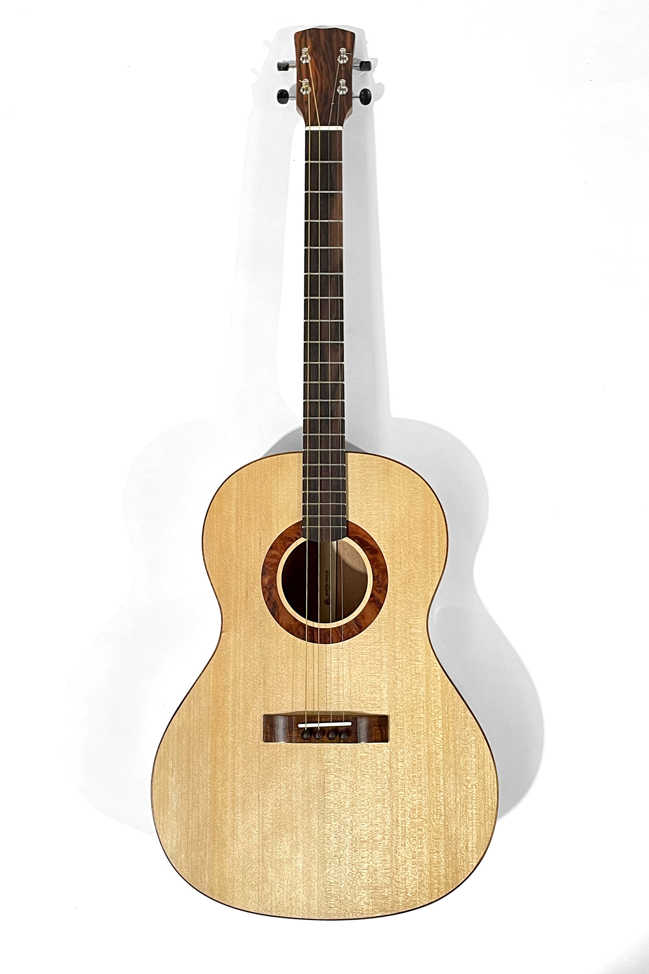

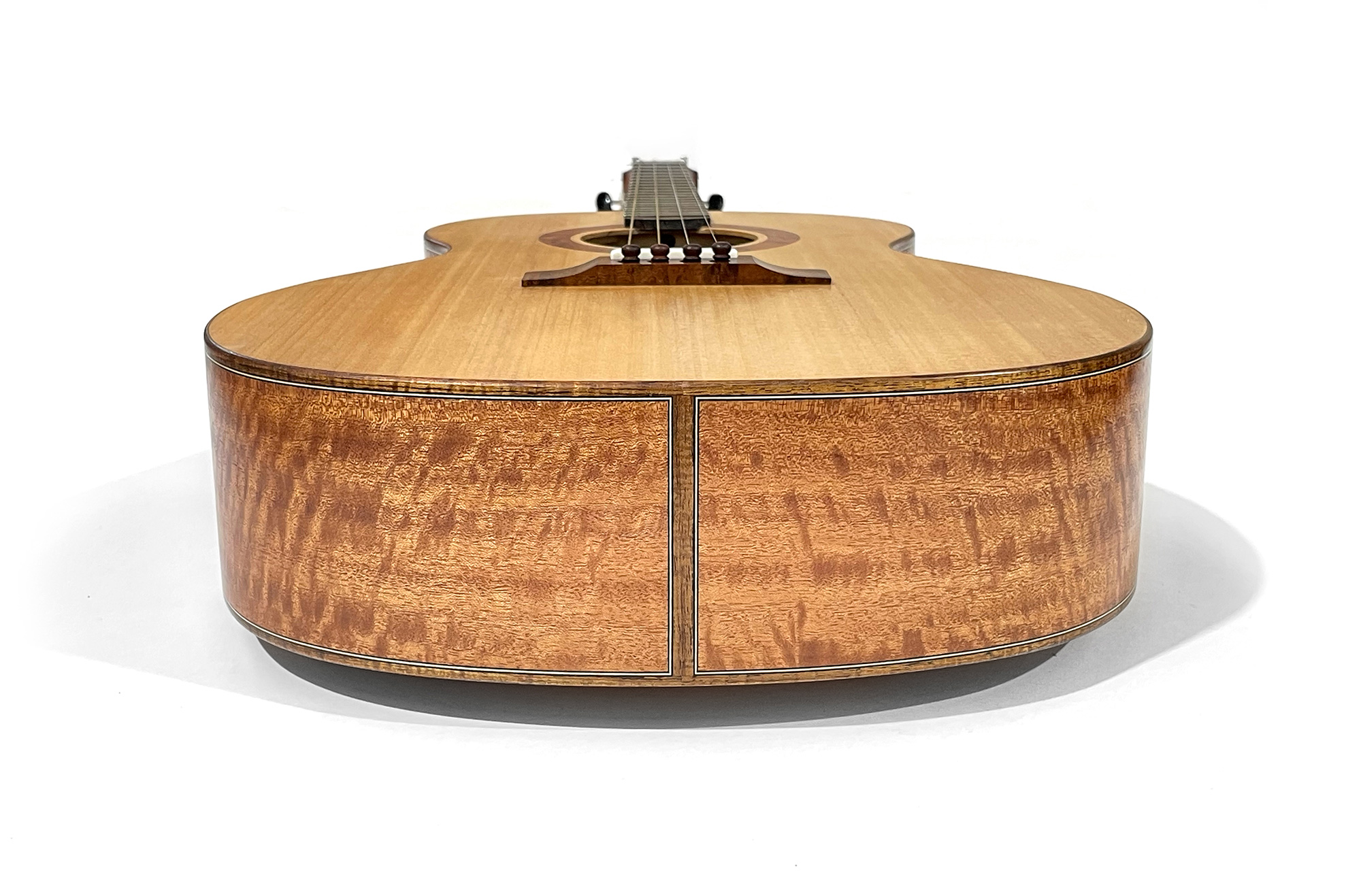

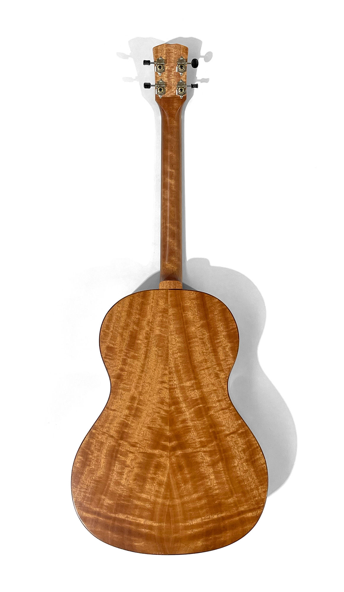

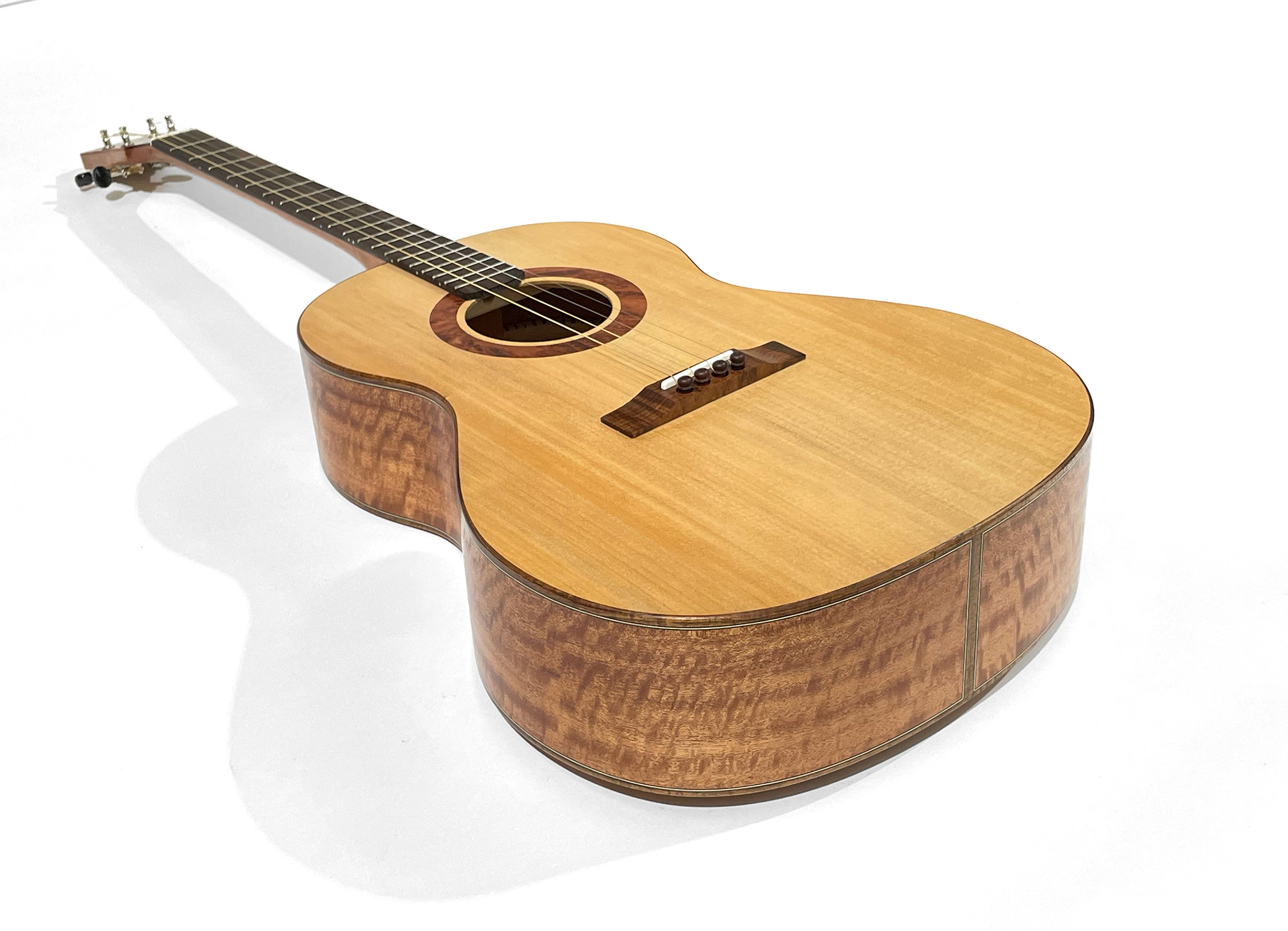

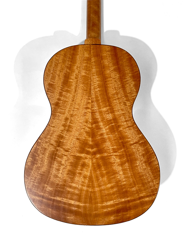

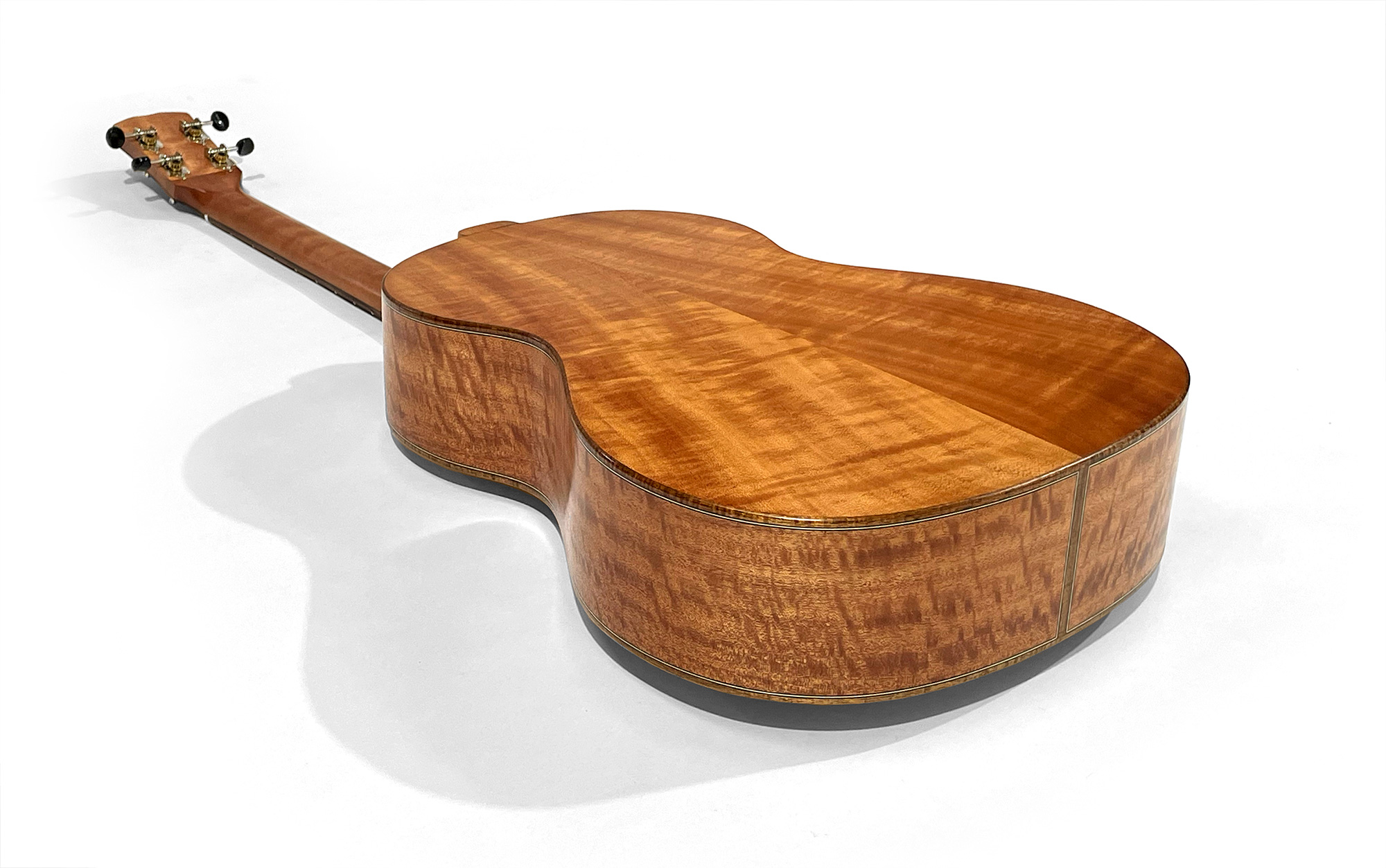

Hi all luthiery lovers,
Here's another Tenor guitar build. I love these small builds. The Tenor guitar is a lovely instrument that offers an additional voice to any group of instruments. It complements regular guitars so well. This one is mainly Aussie timbers with QLD Maple back and sides and neck, Soundboard is QLD Kauri, rosette is a random eucalypt burl that is recycled from the base of an old lamp, the bridge is ringed Gidgee, bindings are Tassie Blackwood. The only non Aussie timber is the fretboard which came from an old scrap of Ebony that was too small for a guitar. I have it tuned to CGDA which is "standard" tenor tuning and the scale length is 23". Finish is Rustin's Danish Oil.
