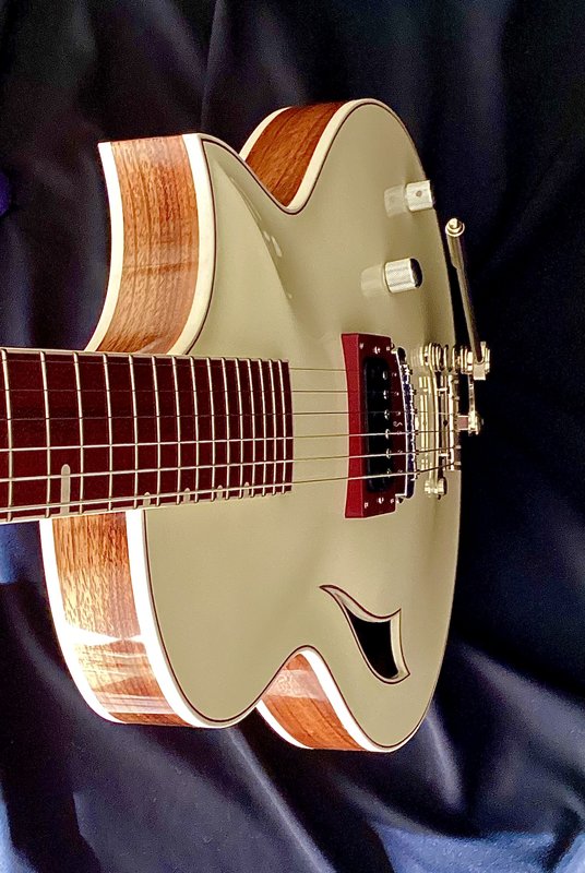

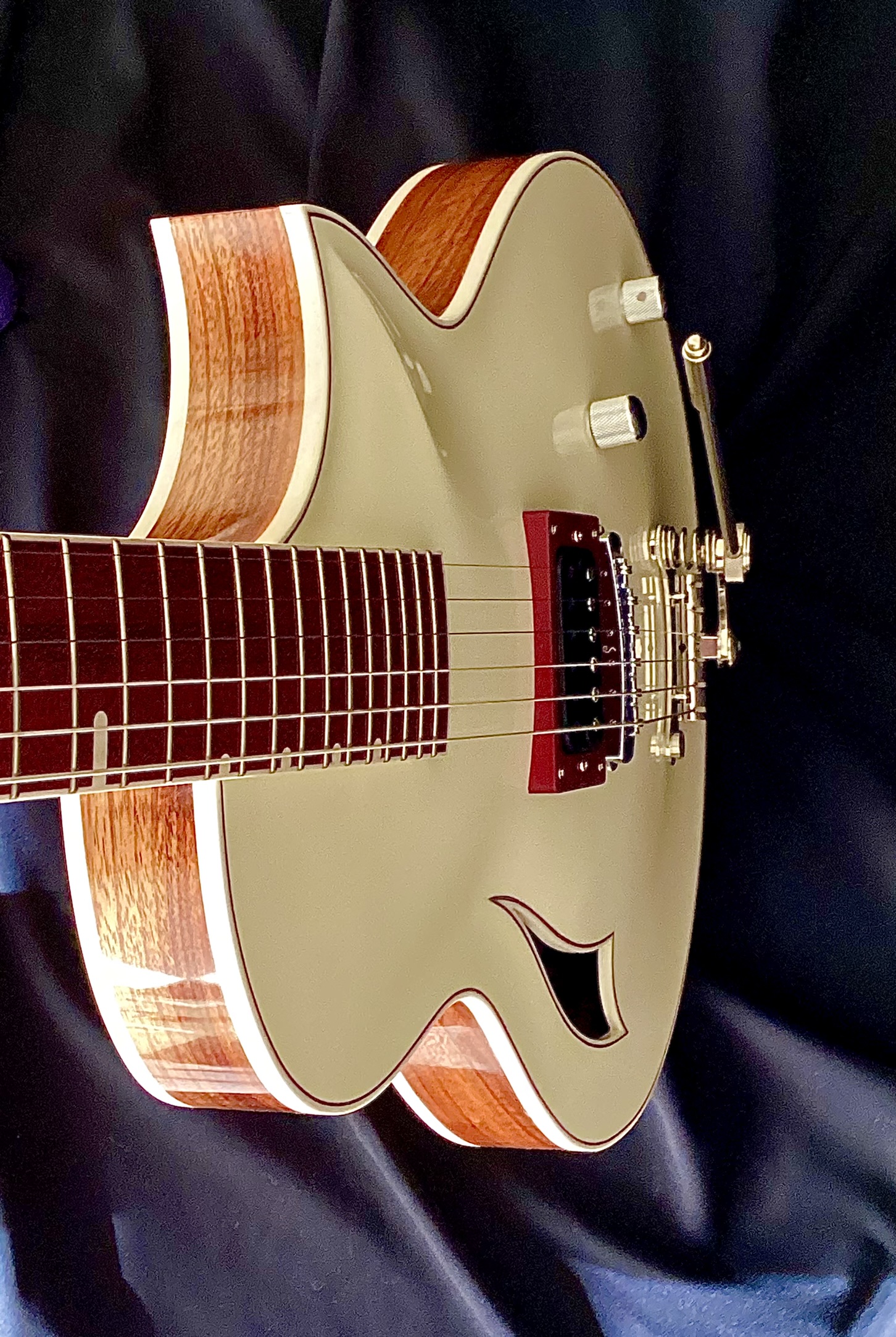

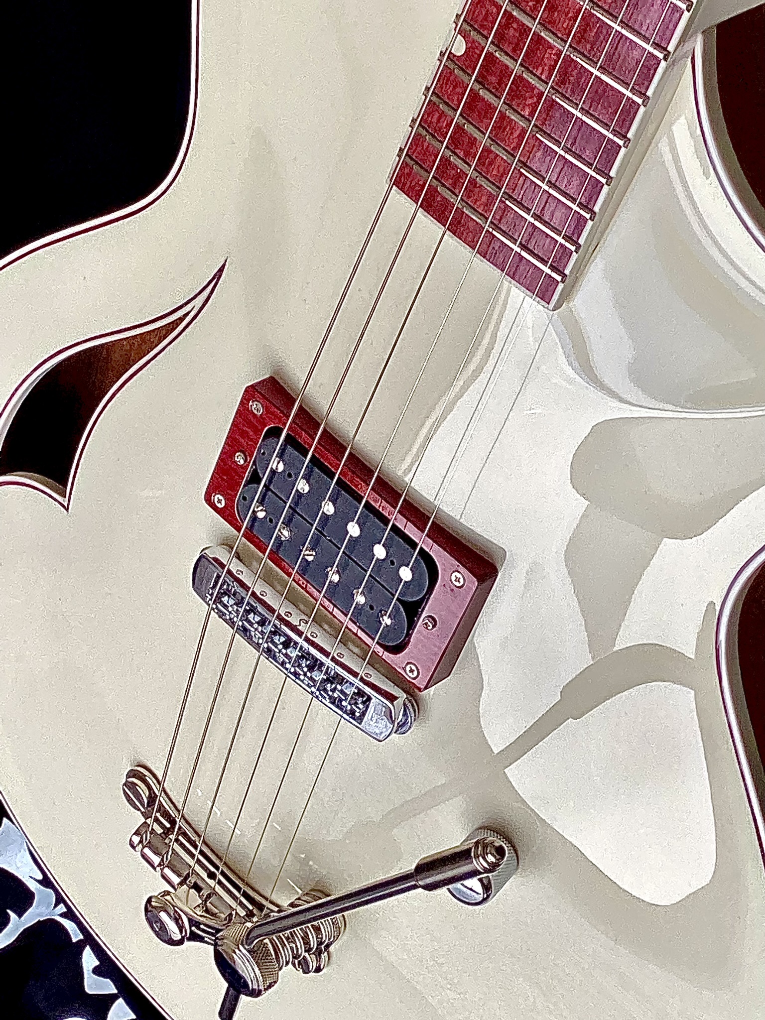

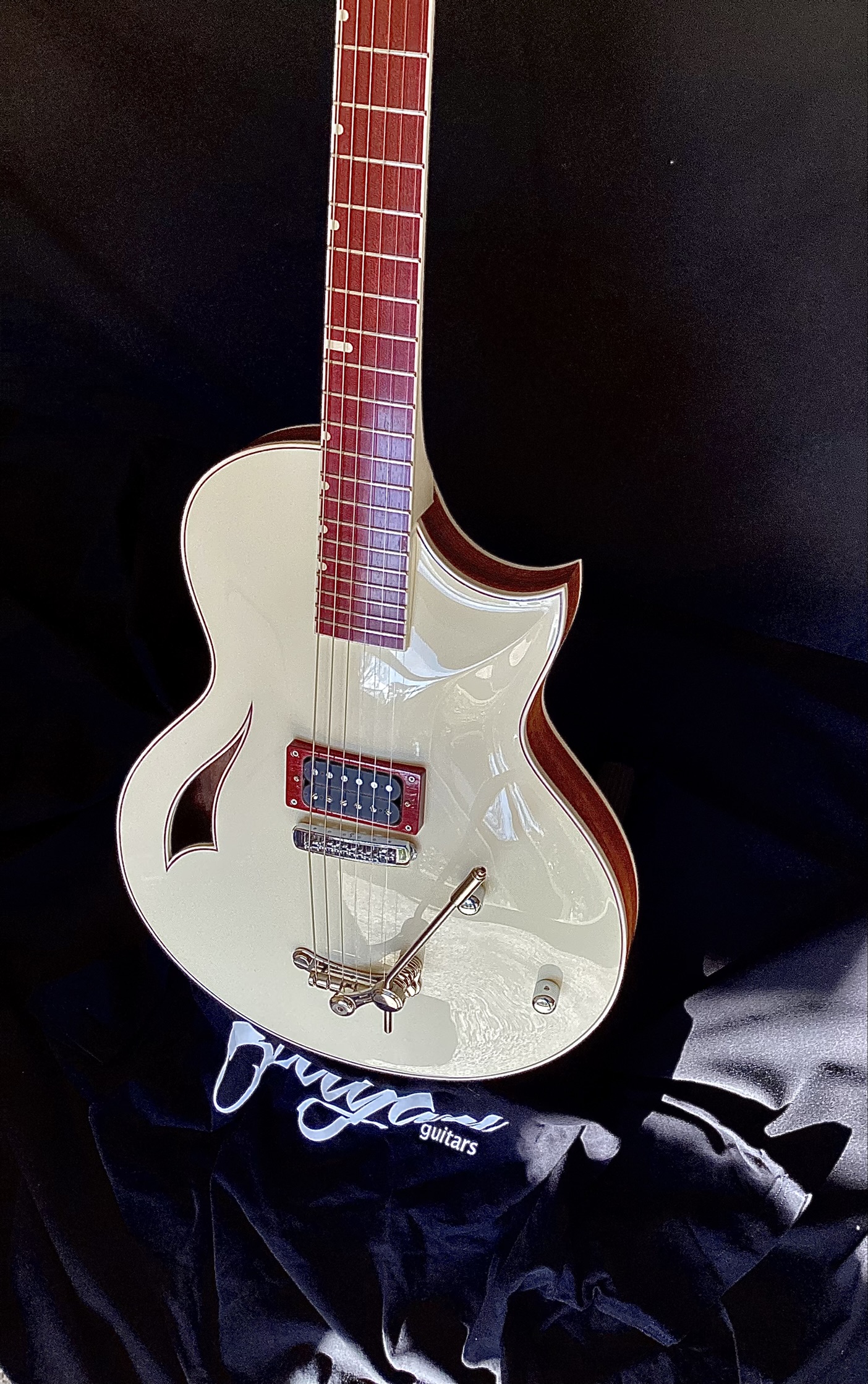

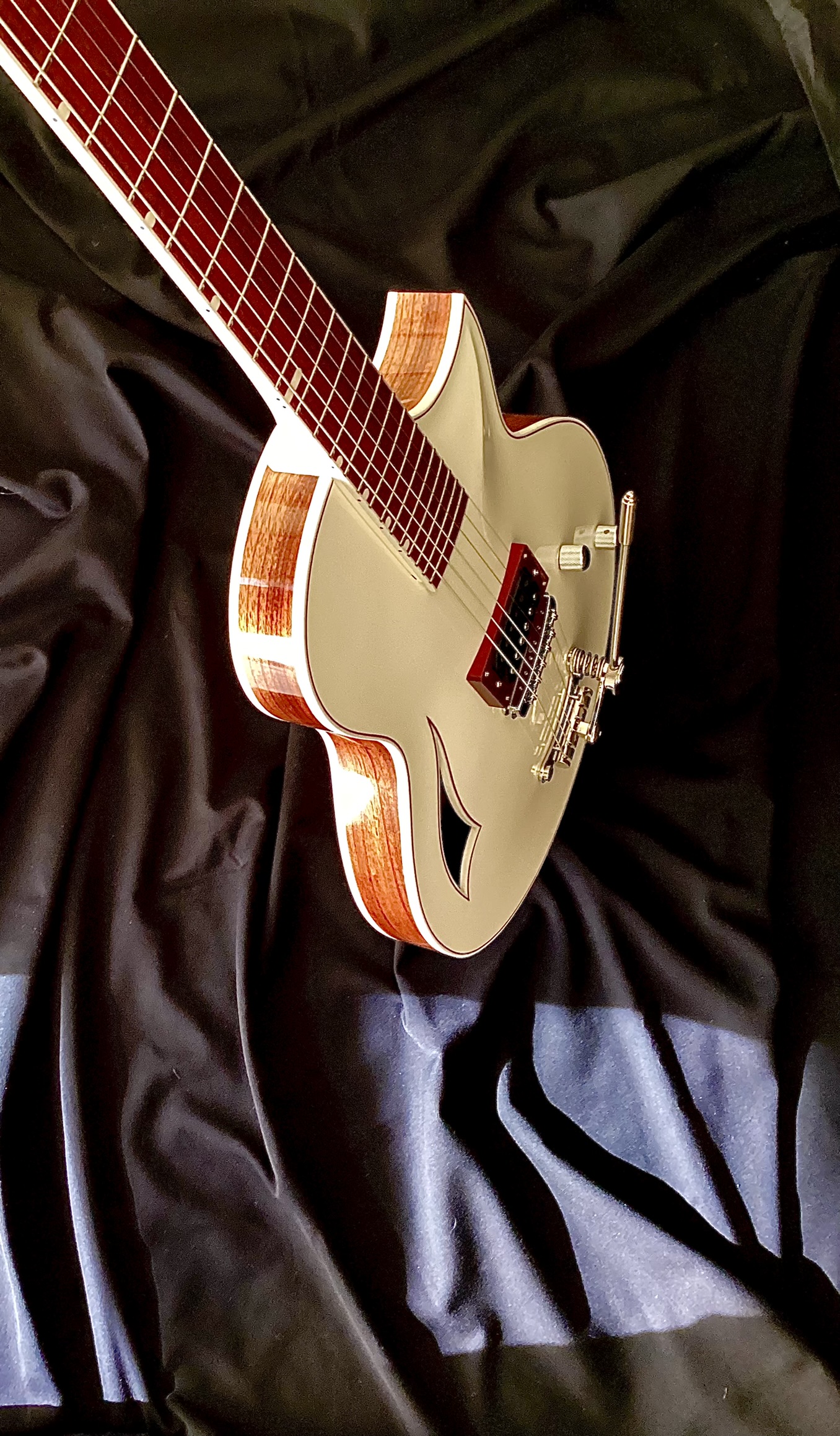

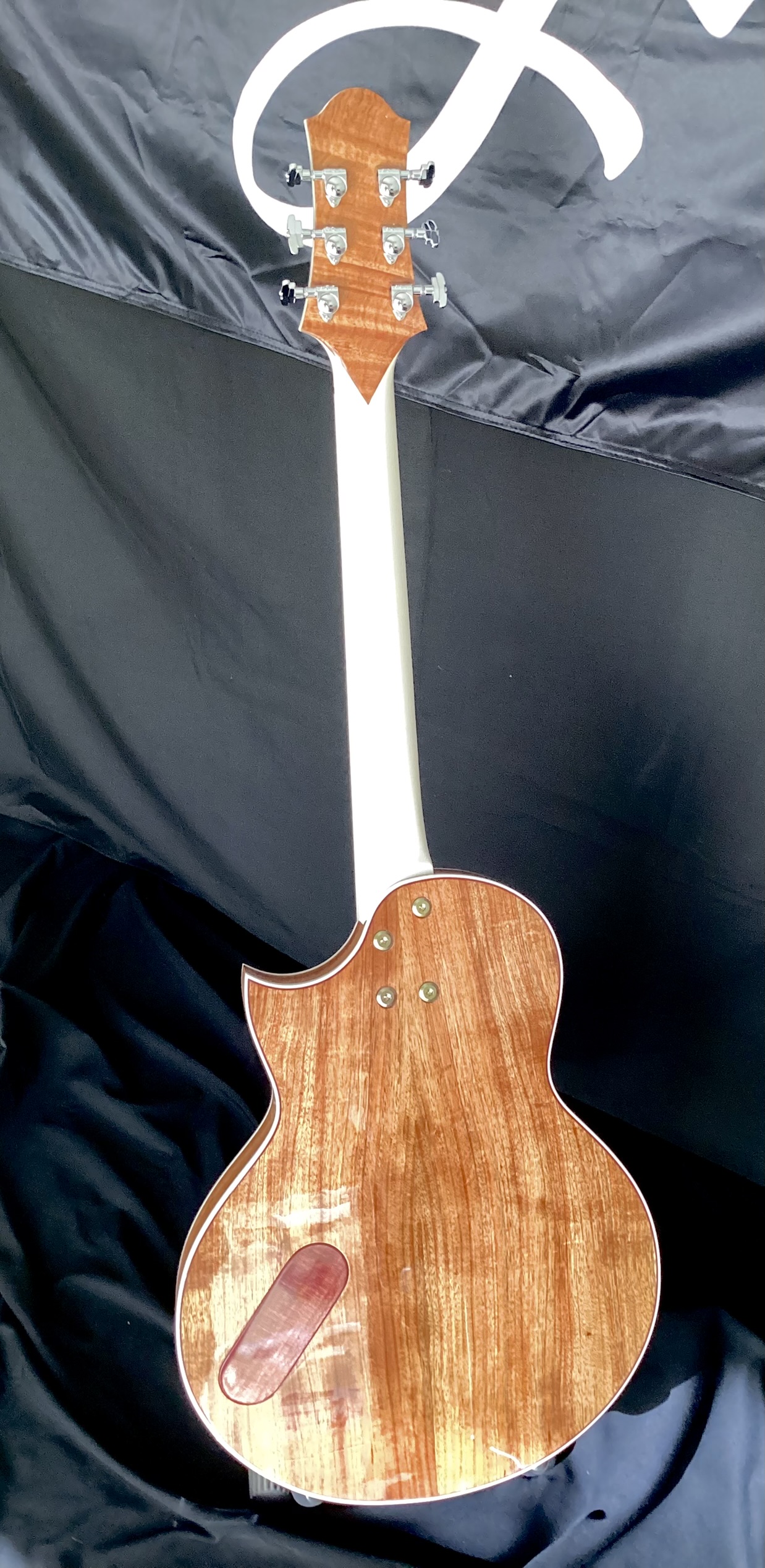

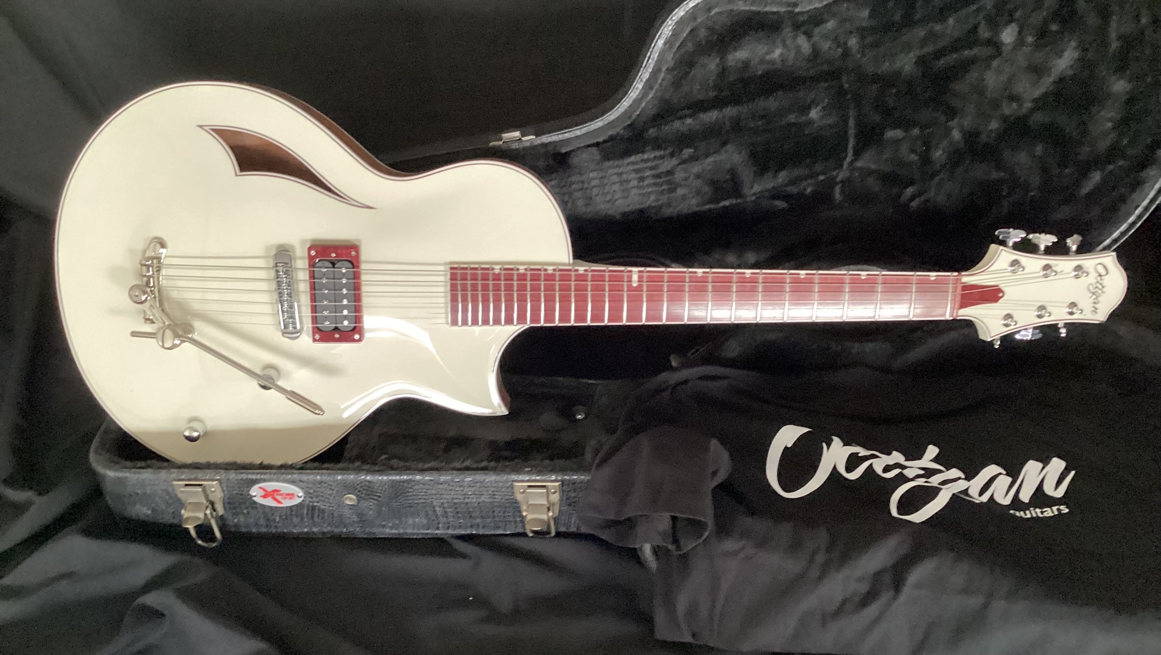

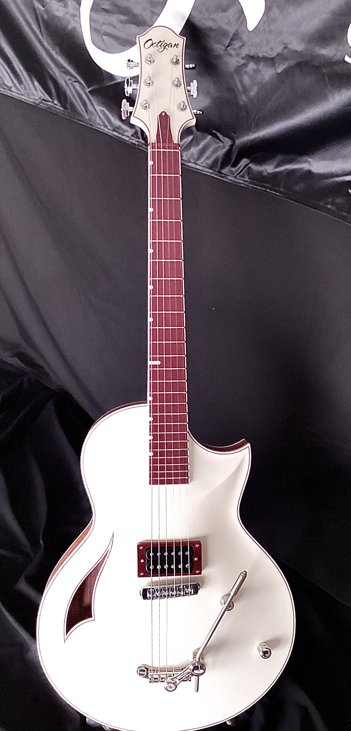

A fifteen inch lower, semi hollow , 10 foot radius back and bent sides in Blackwood, carved Sitka top, ABS binding and as is obvious, Purple heart everywhere else. 25 scale , Schaller roller bridge, Duesenberg Les Trem tailpiece, Microtone Nitro on the top, neck and headstock and 3220 on the blackwood

Very elegant atheistic :cl

Thant's a beautiful guitar Rod in every way.
Thanks for sharing the pictures.

Beautiful work, that solid colour top works so well.

I Like the colour combination. Beautiful finish.

The flared shapes of the top and the way the finish shows them makes this instrument so sensual.
Beautiful work.

WOW!! I'll bet that beauty didn't sit on the show stand for long !!!
Is the Purple, Acacia Carnei ?
Well done Rod.

Thanks Gaz , no it"s Purple Heart

Amazing skill, love it.
