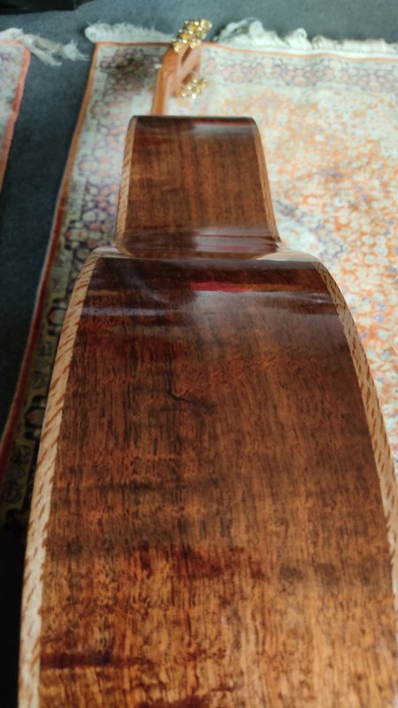

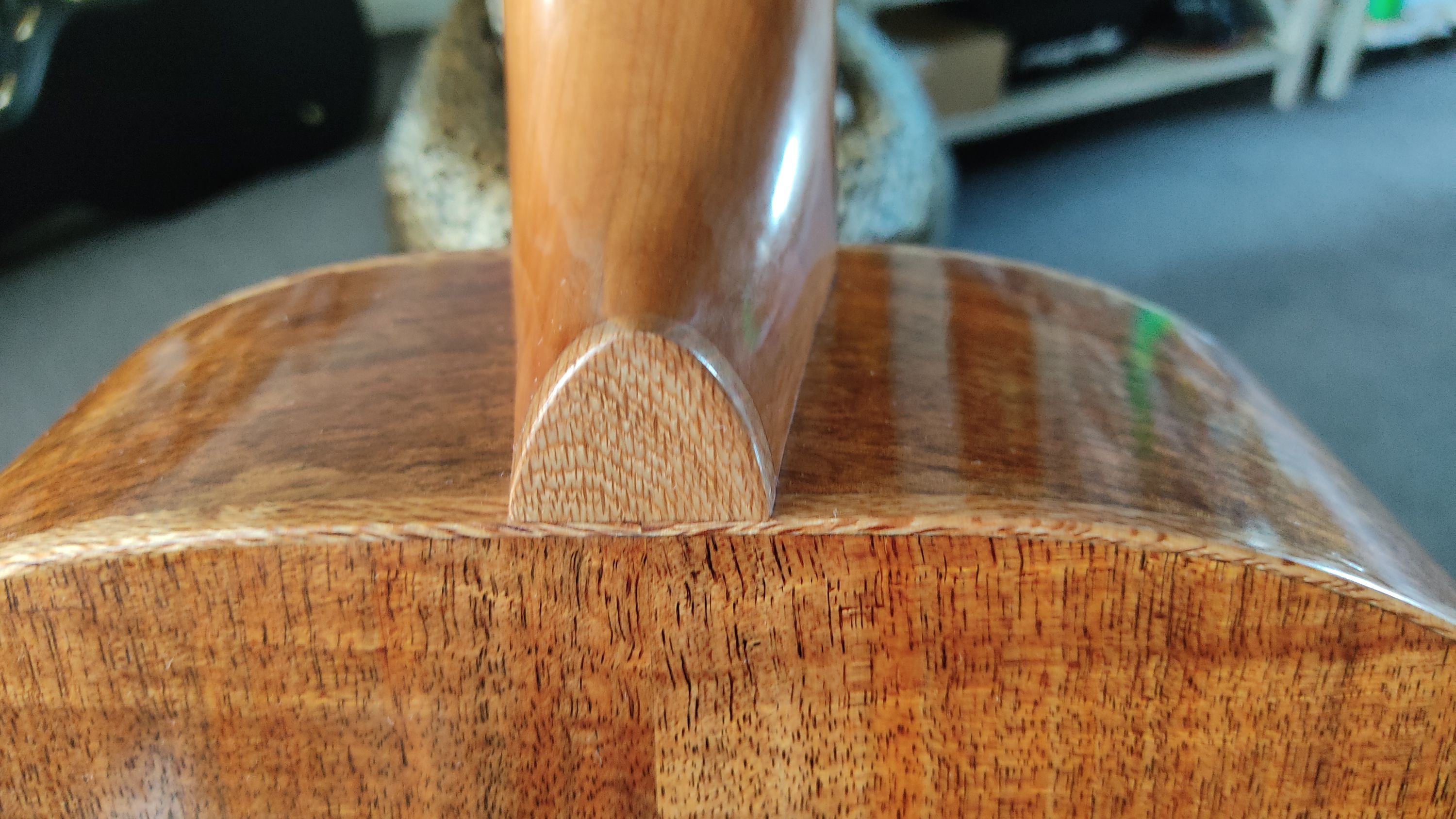

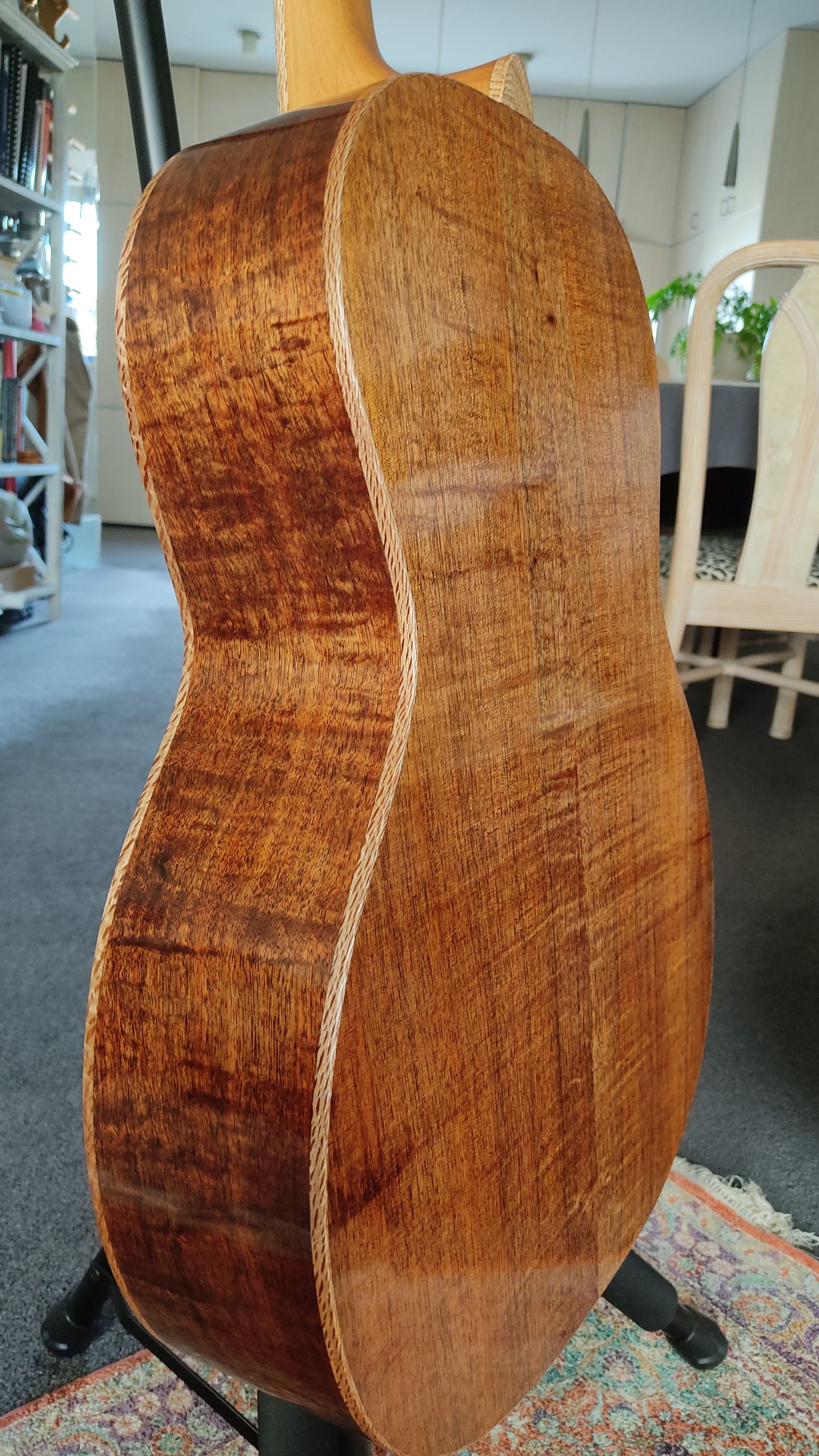

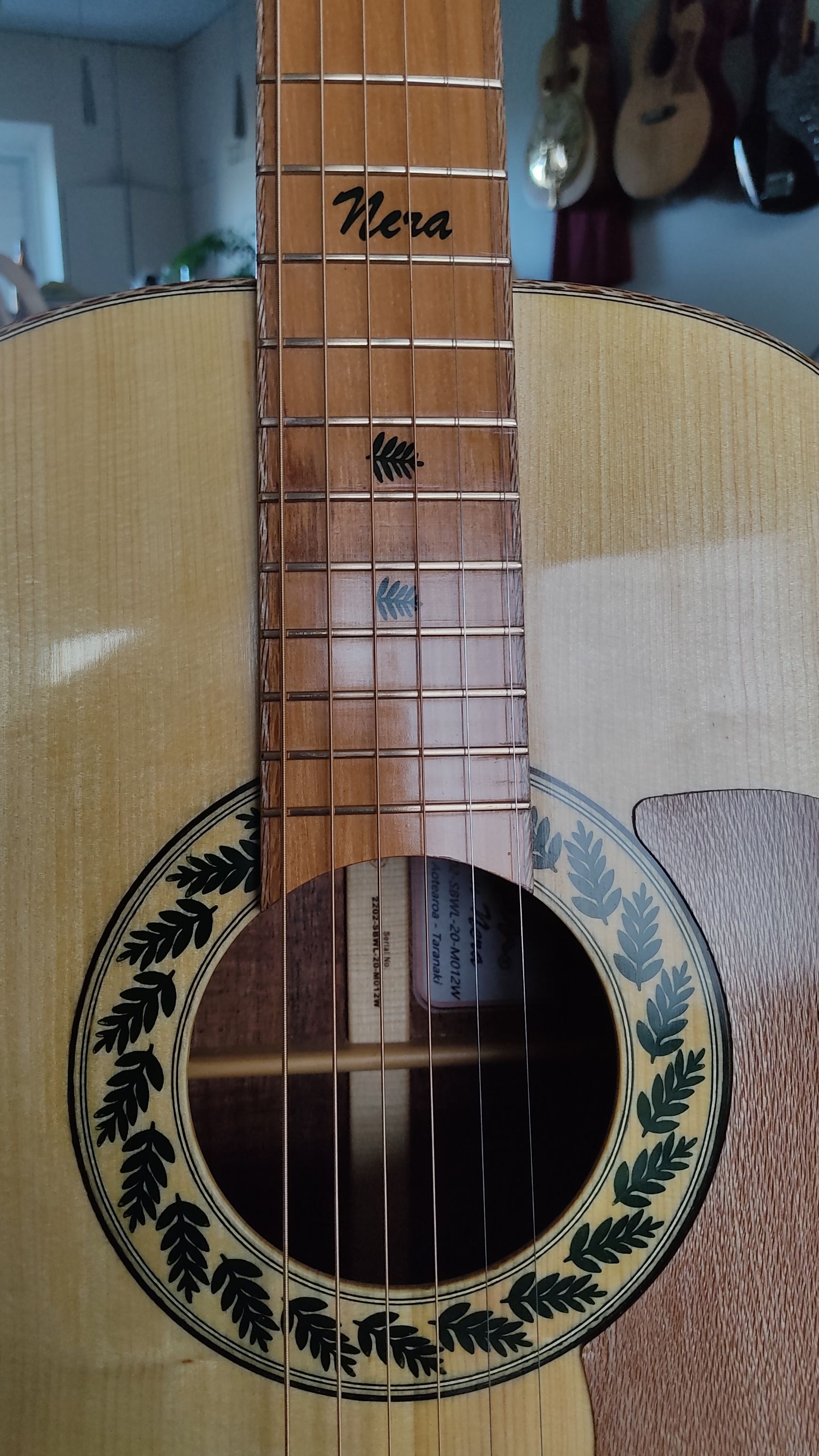

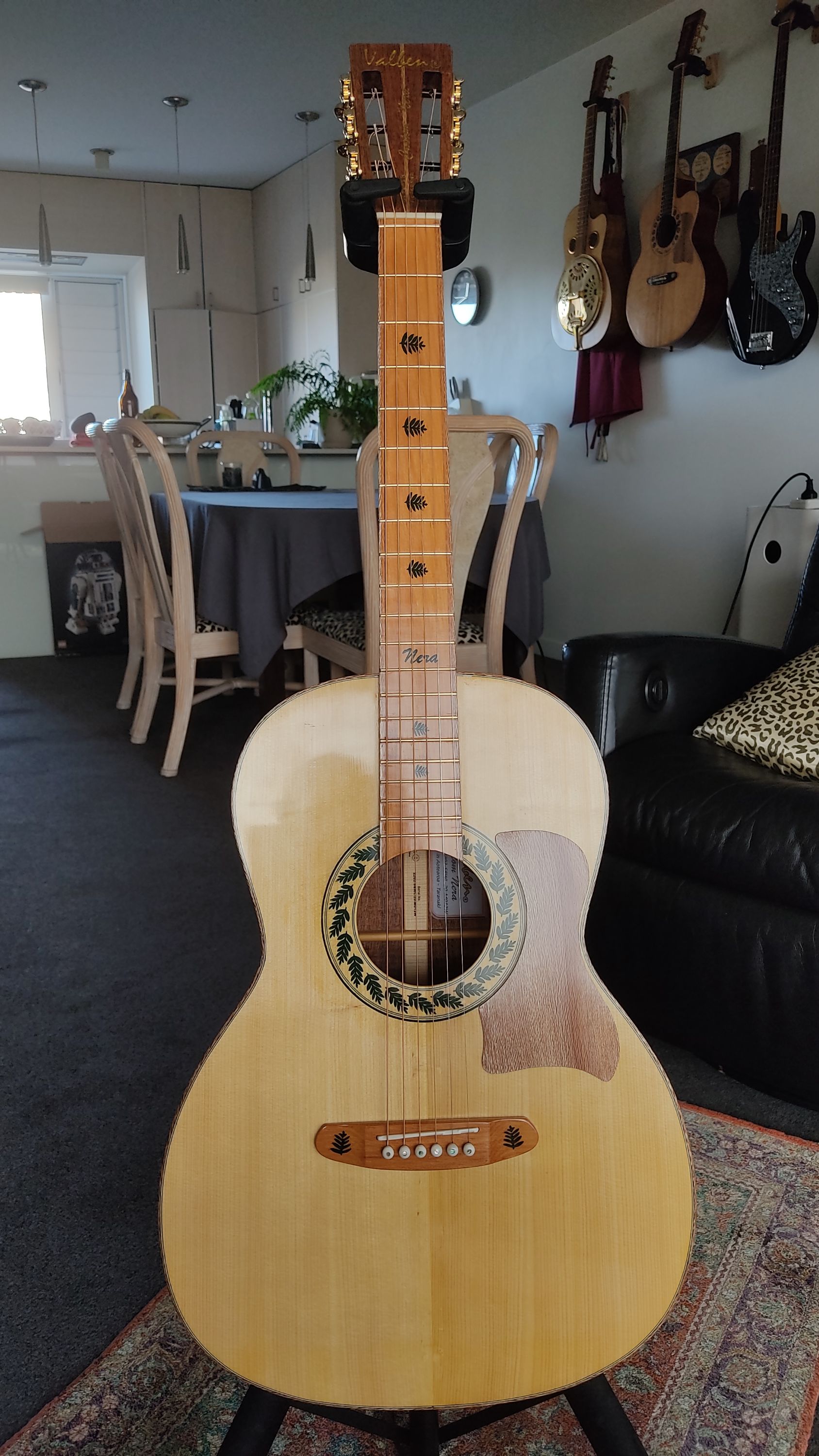

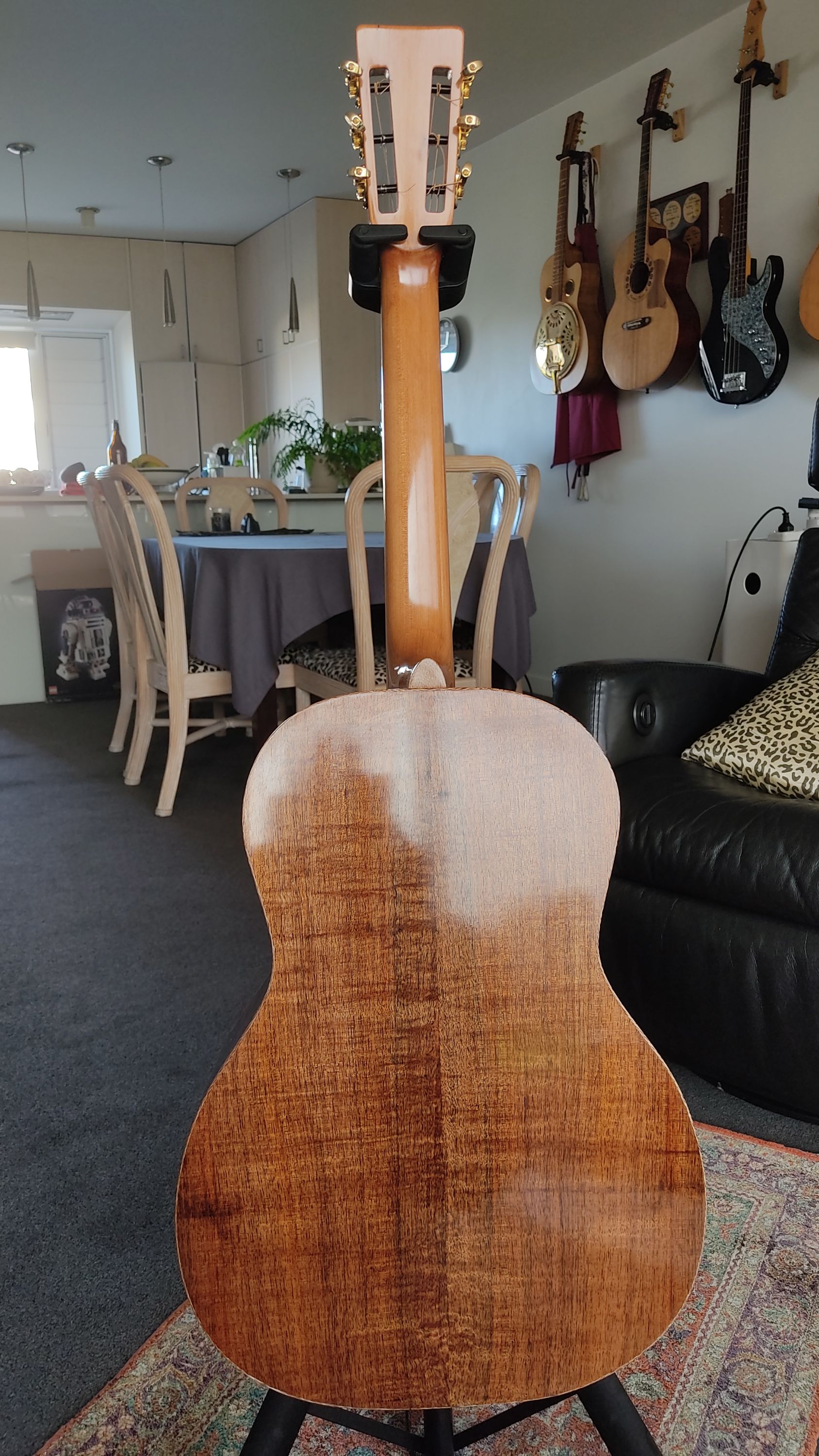

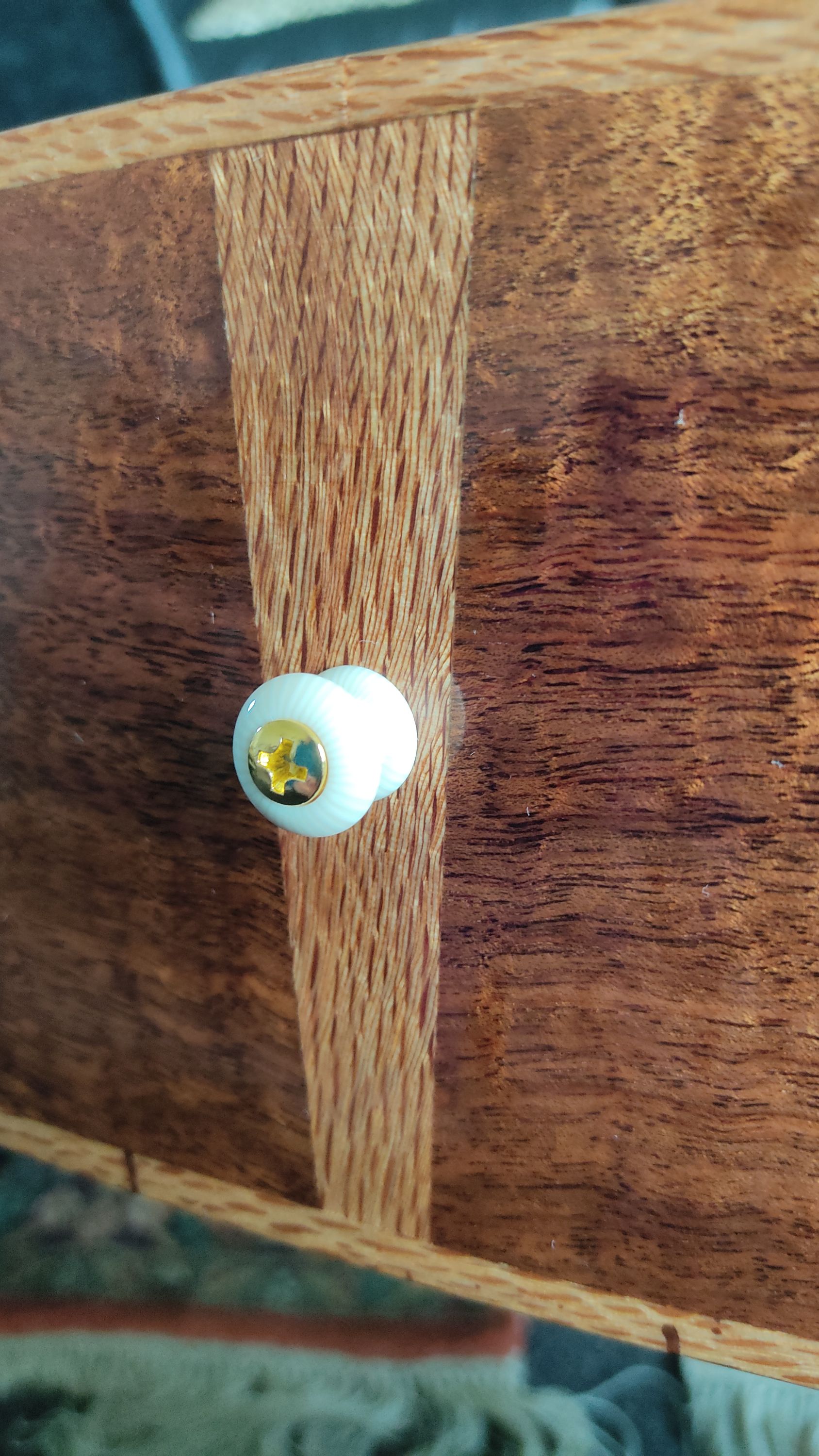

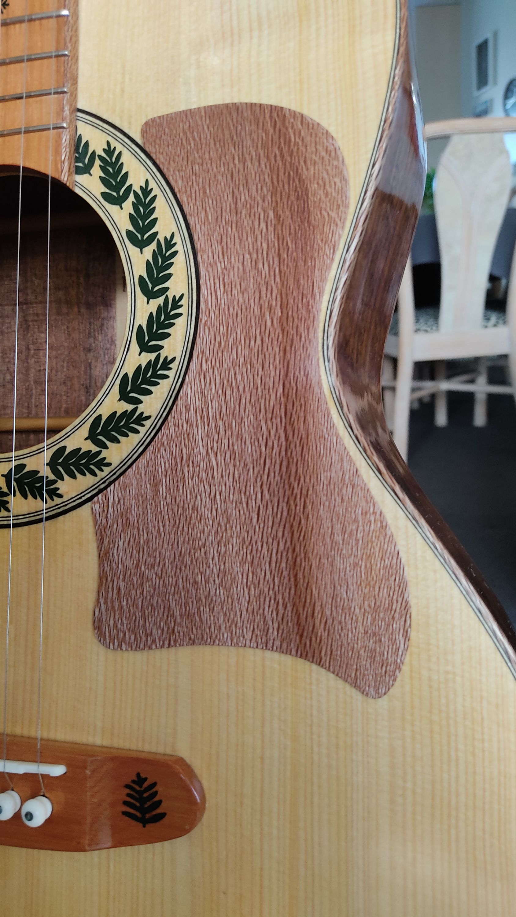

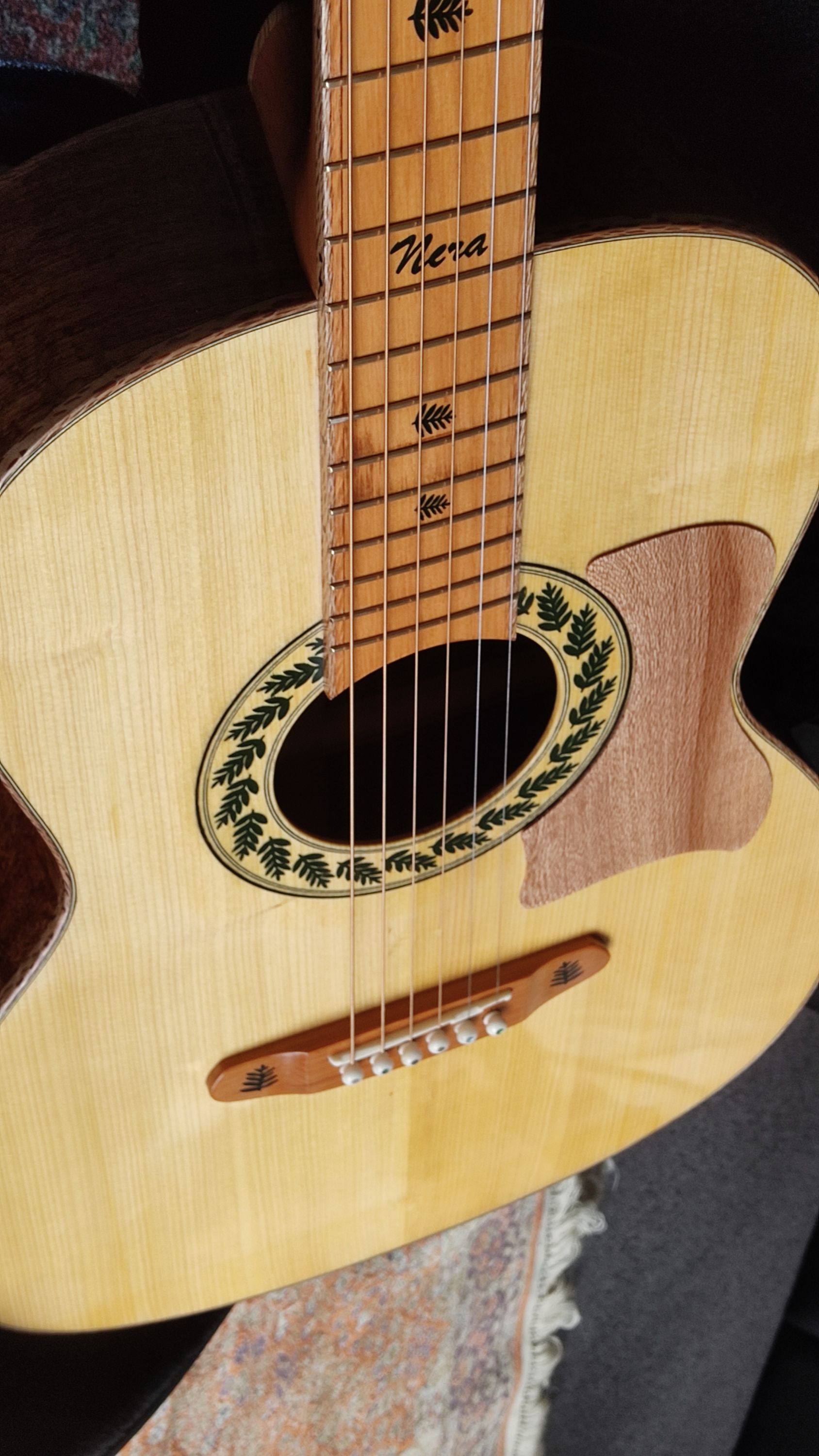

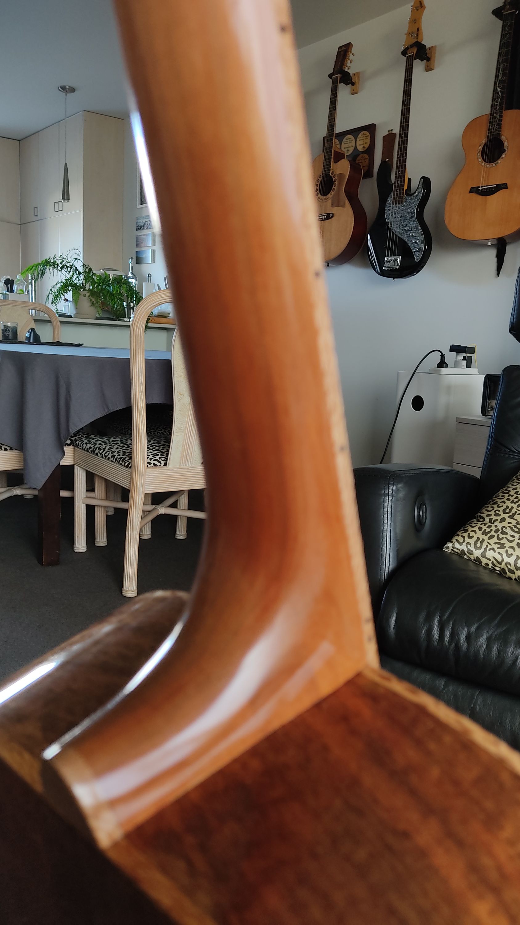

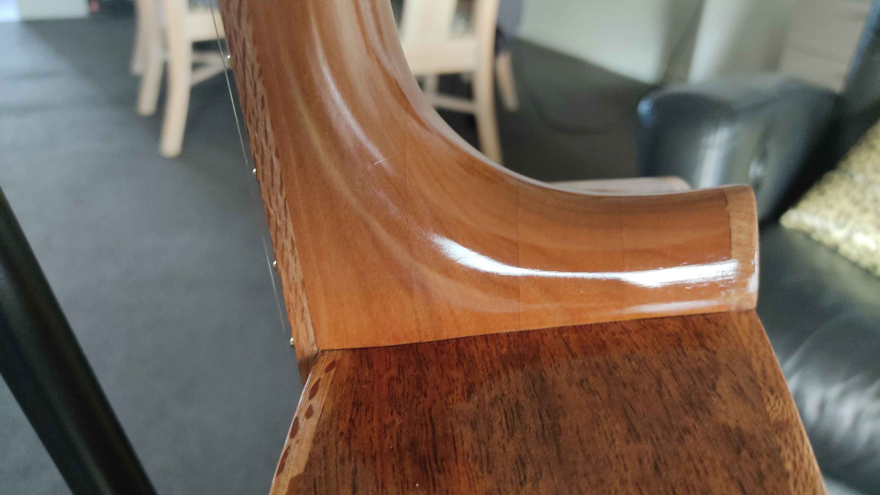

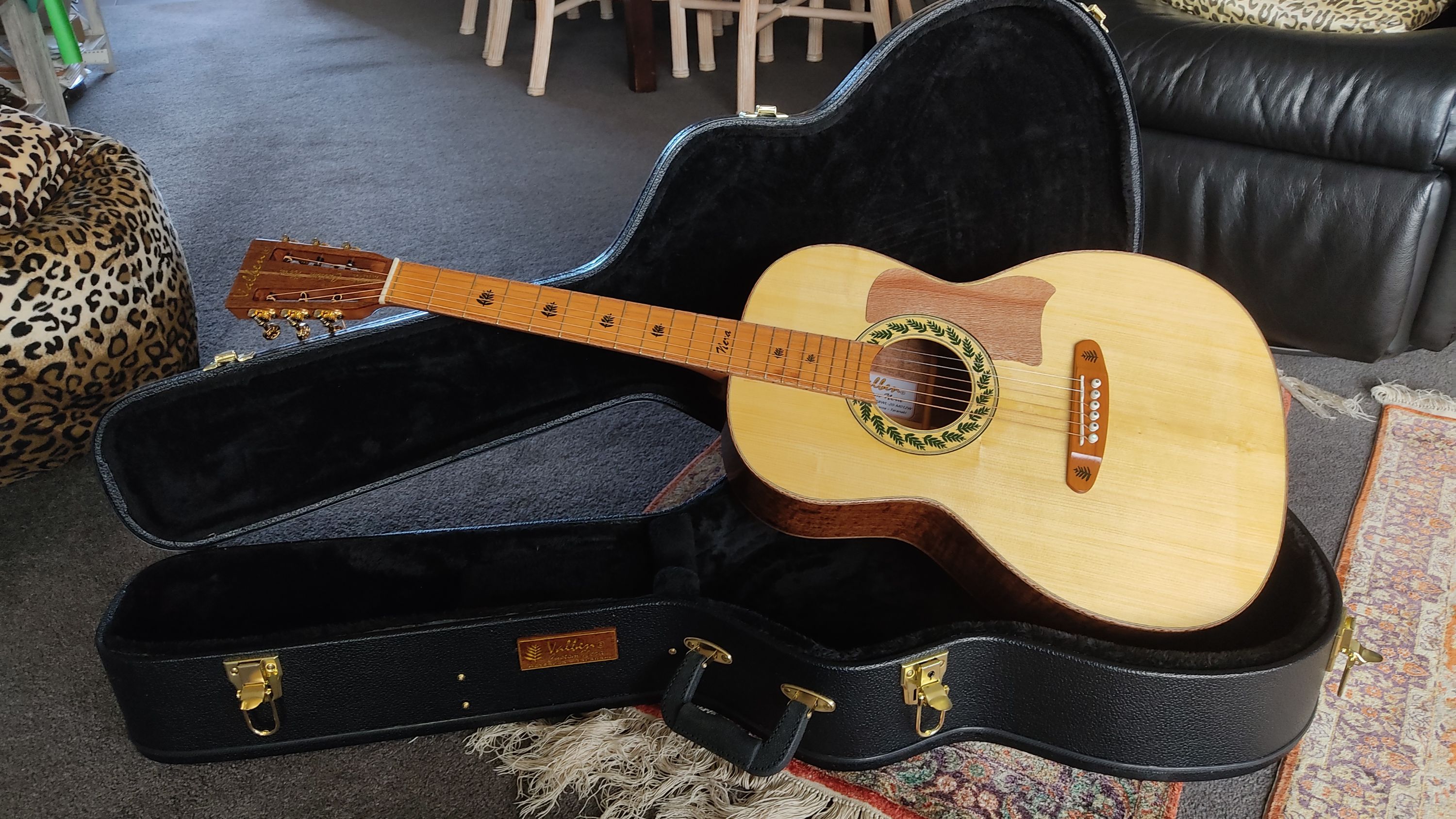

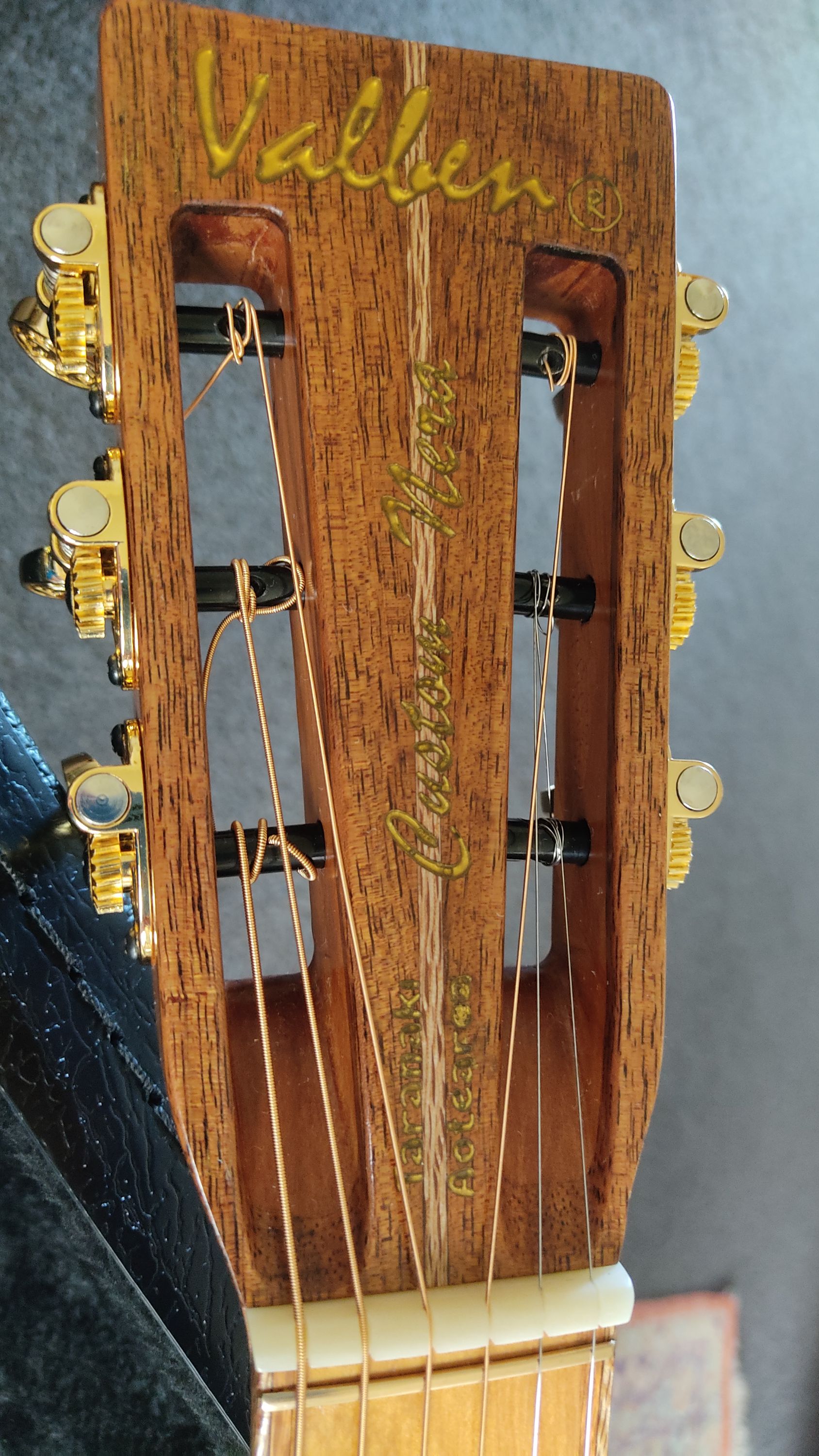

Hi everyone, sorry for the long absence from the forum. It has been quite some time since the last guitar built as I have been distracted with other projects (mainly Native American flutes and a drum .. yes a drum with an hairy deerskin :D ).
Anyhow, here we are with the last build, the Custom Nera:
Details:
- Near 000 size with 12 frets at the body.
- Scale length 25.4".
- Width at nut 46mm with zero fret.
- Brass strings counter plate
- Super Blonde Shellac finish
- Set-up with 11-gauge silk & steel strings
Woods:
- Soundboard: German Spruce

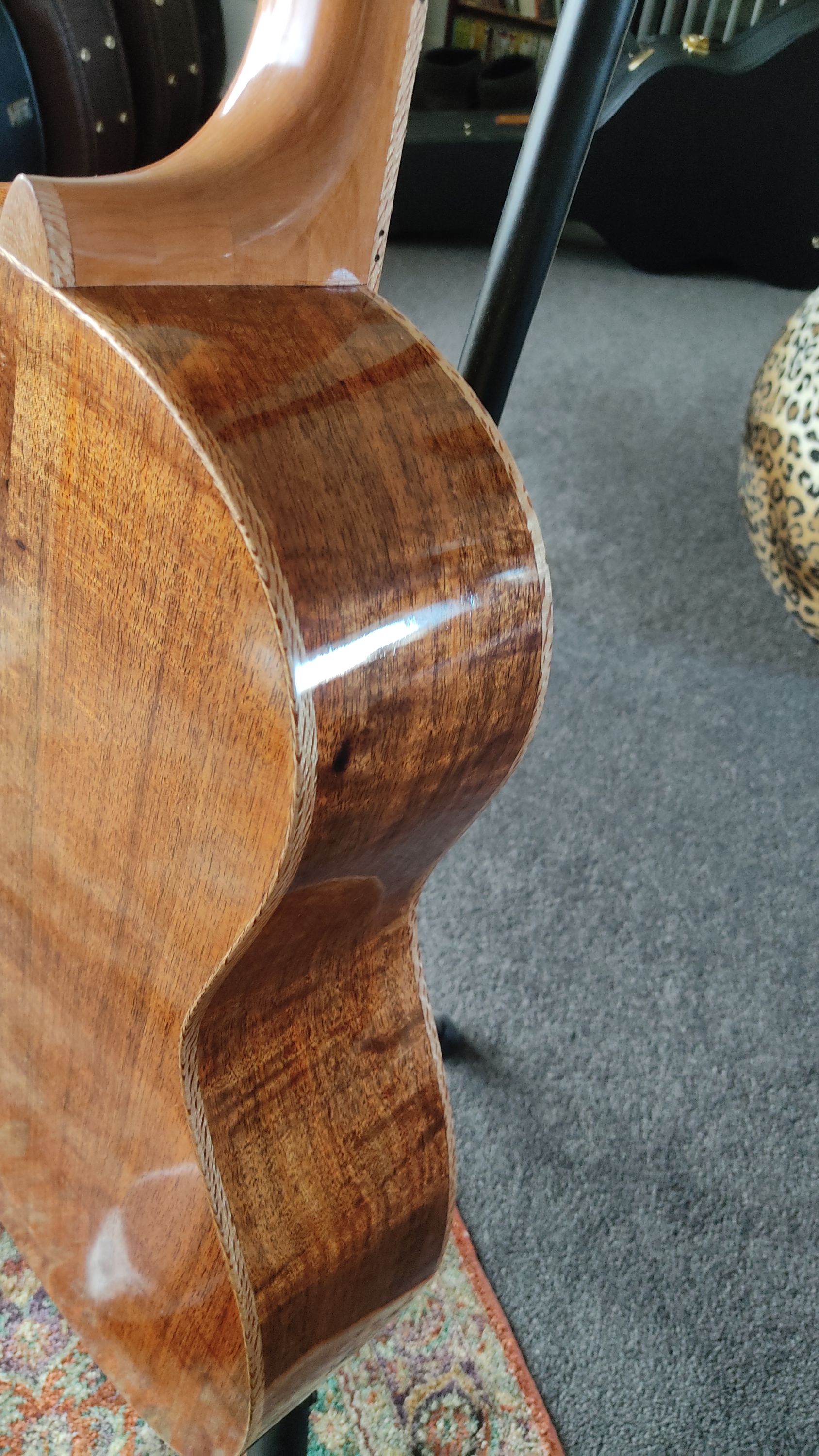

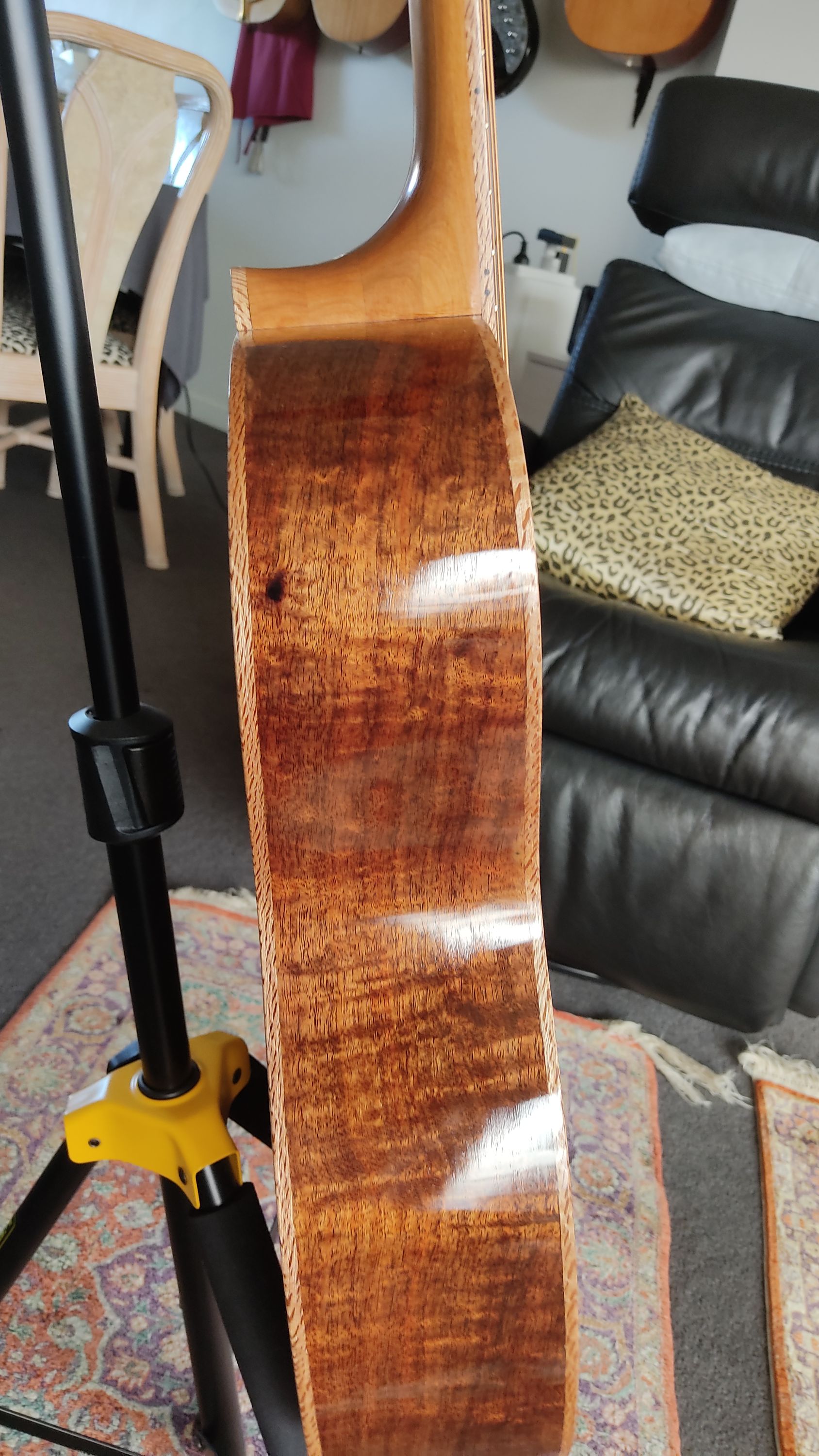

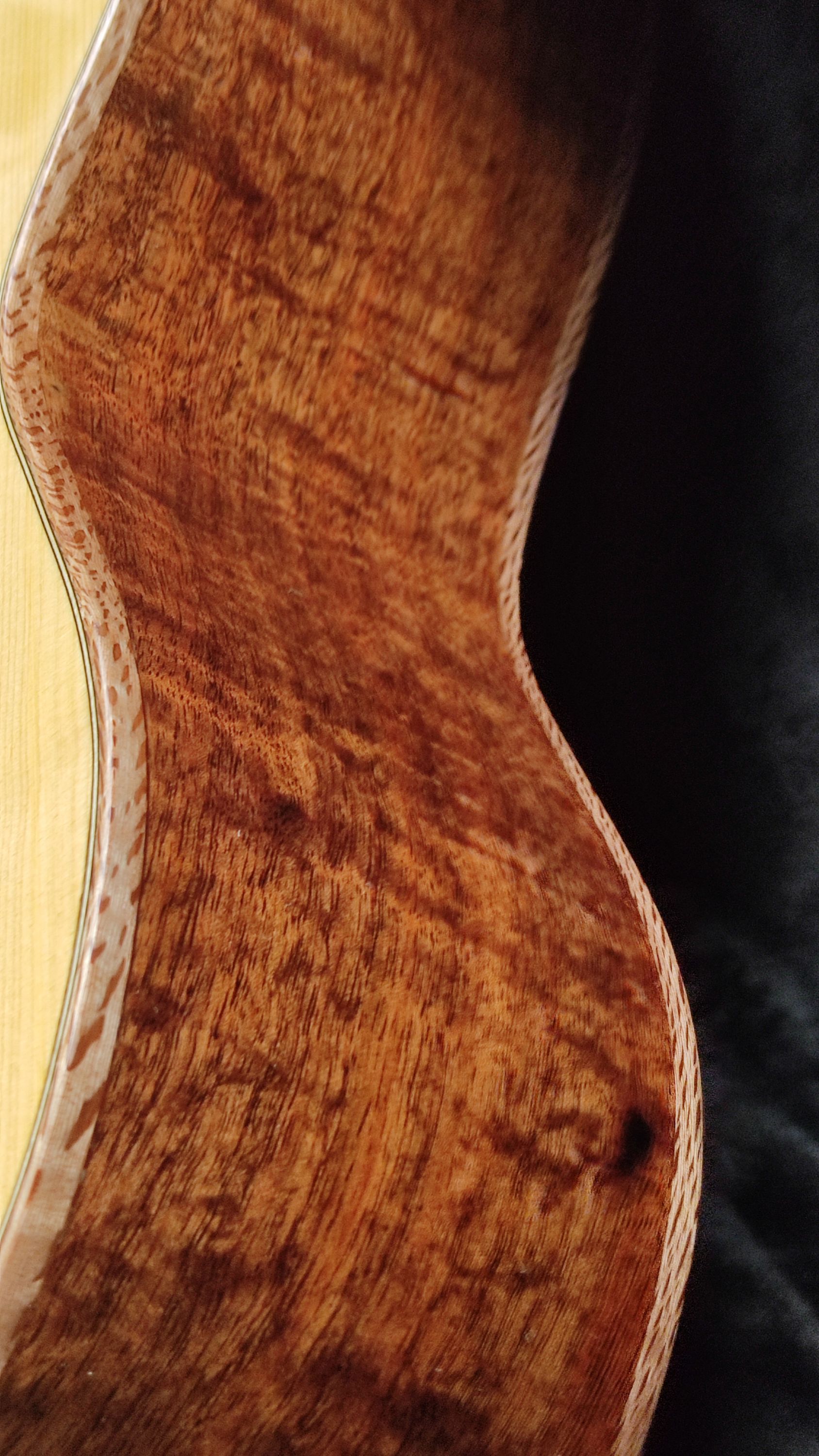

- Back & Sides: Blackwood

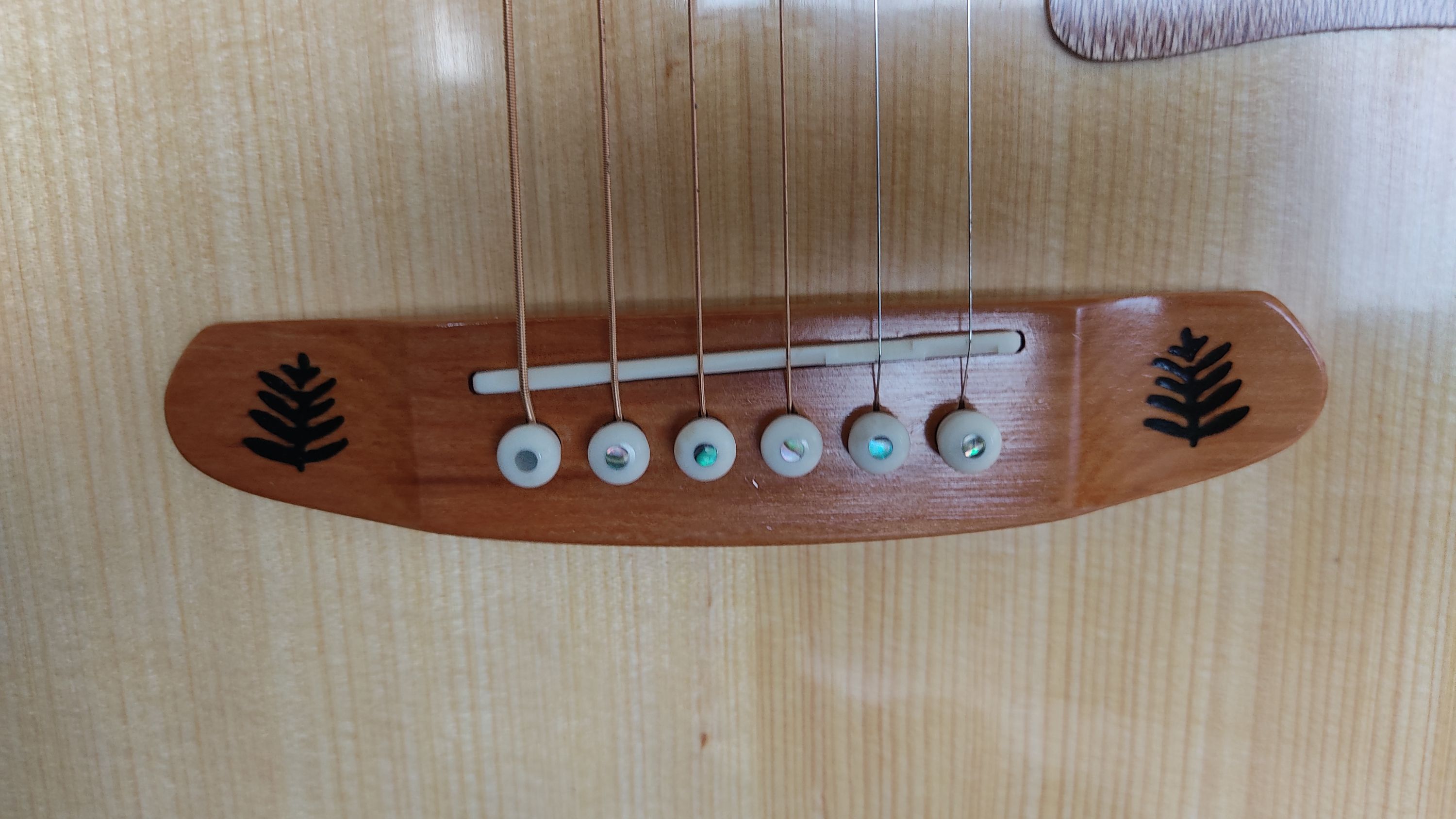

- Totara neck with Matai fretboard & bridge

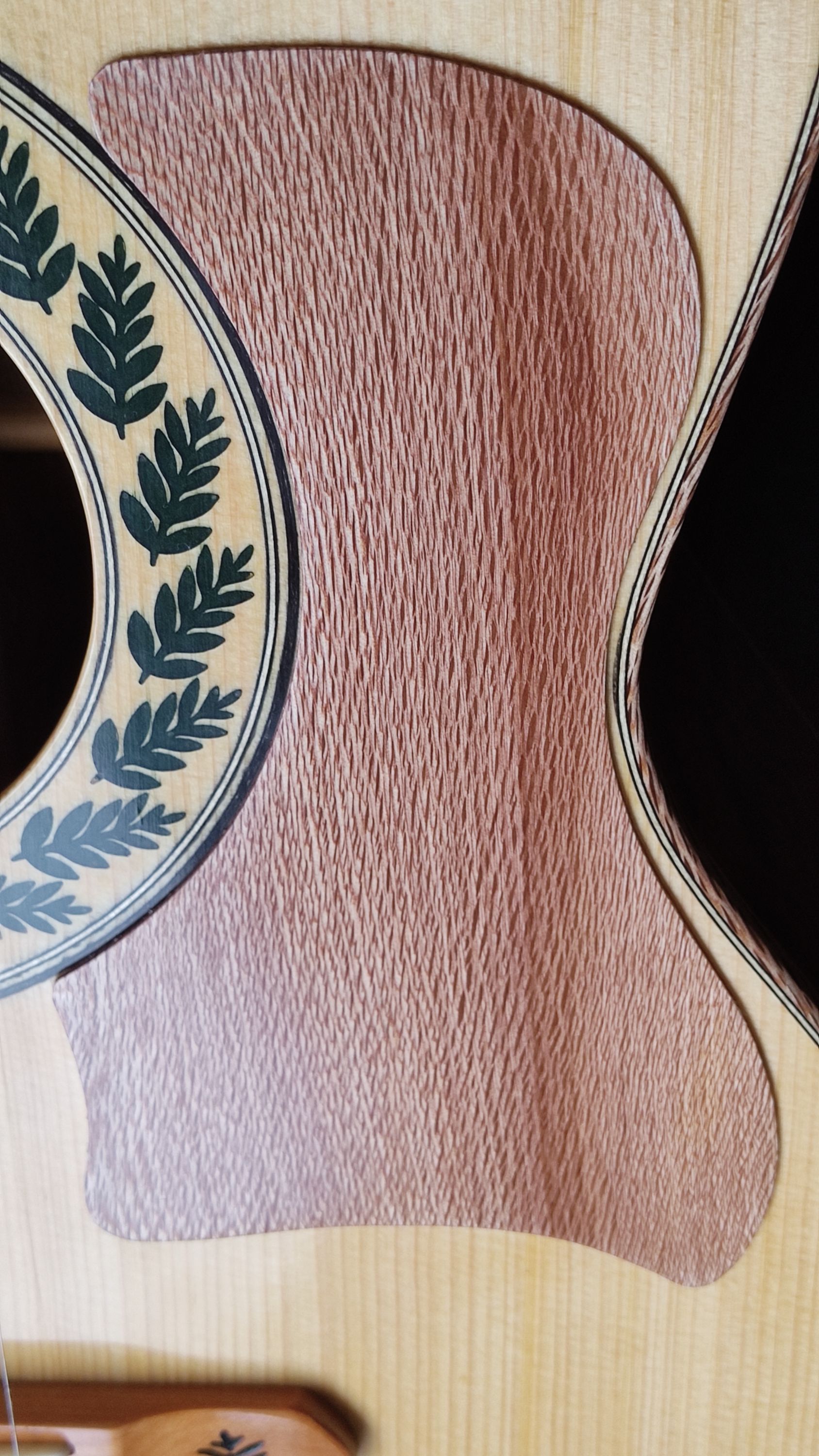

- fern style soundhole and fretboard inlays
- Rewarewa pickguard
- Rewarewa binding job

Hi Valben,
You may have been absent from the forum for a while but you certainly have produced a stunning guitar.
Thanks for sharing.

Good to see you in action again with another great guitar build.

Post by lamanoditrento » Thu Jul 28, 2022 12:19 pm
Nice Wayne. That rosette inlay looks tricky but very crisp.

Hi Trent
Valter here :-)
that the sharpness given by a 0.6mm router bit mounted on a little cnc :wink:
