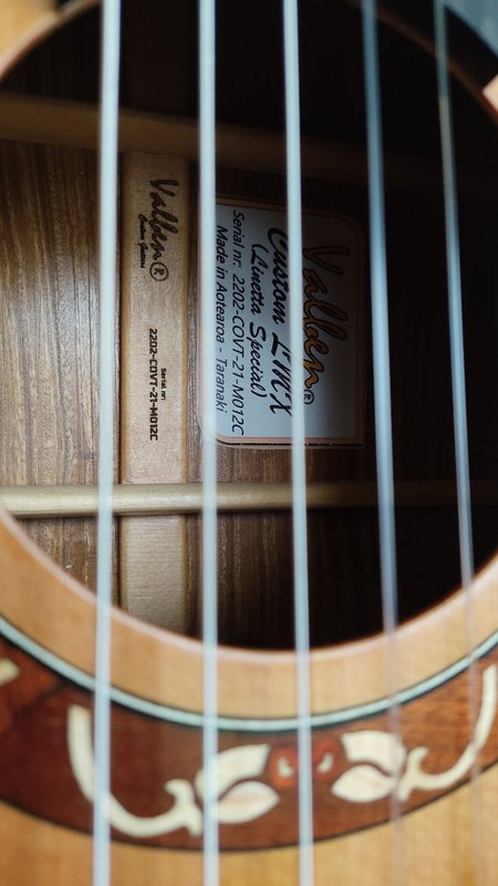

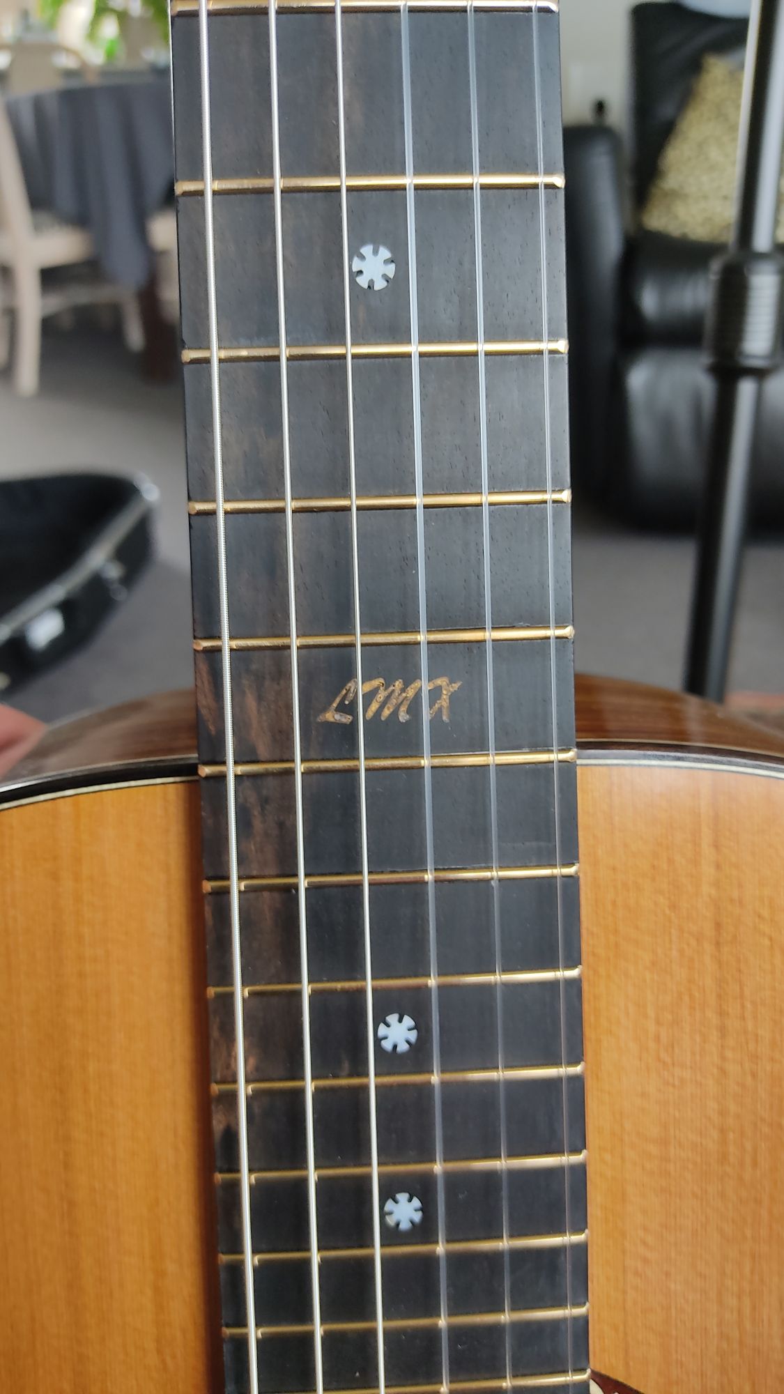

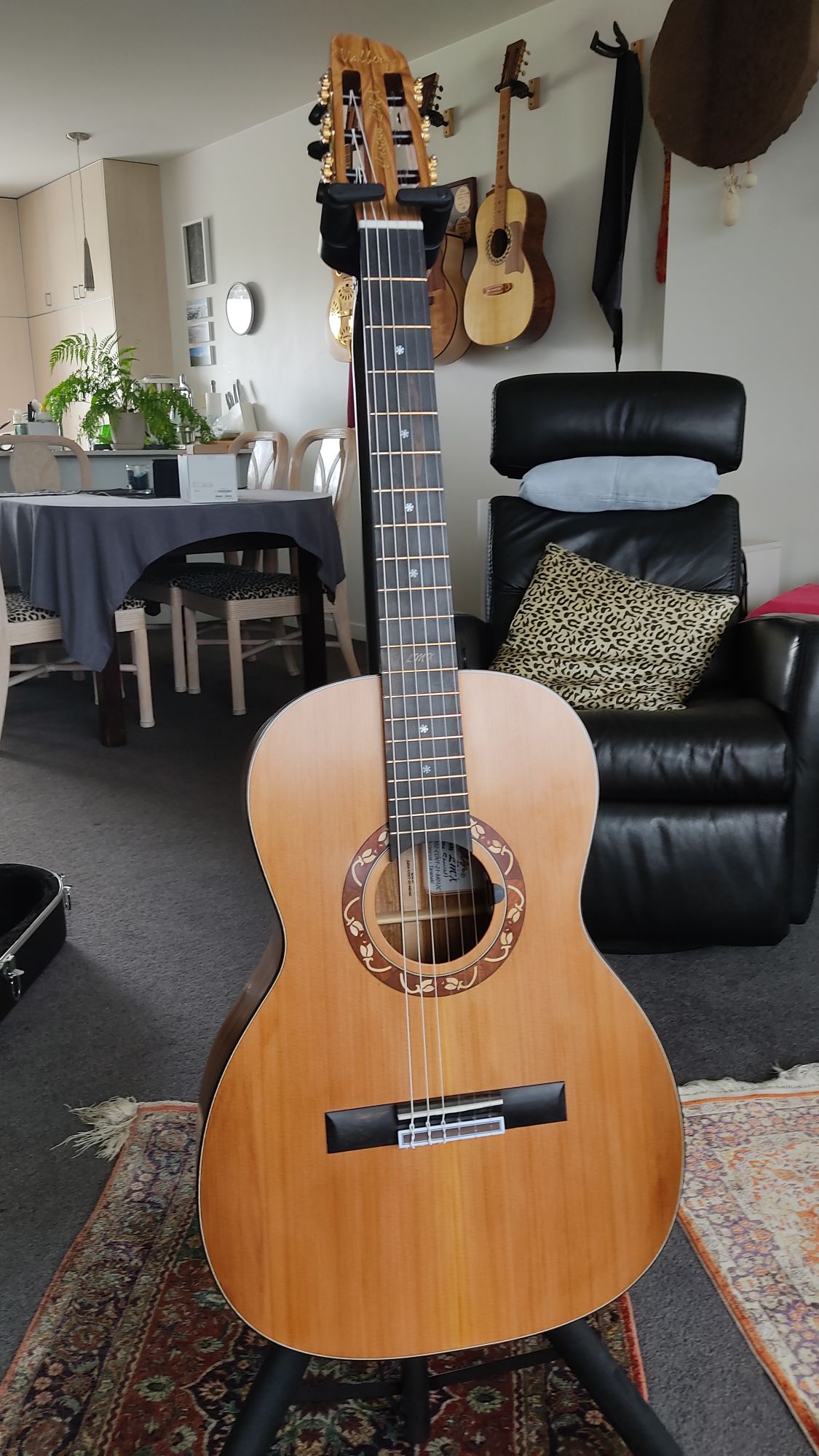

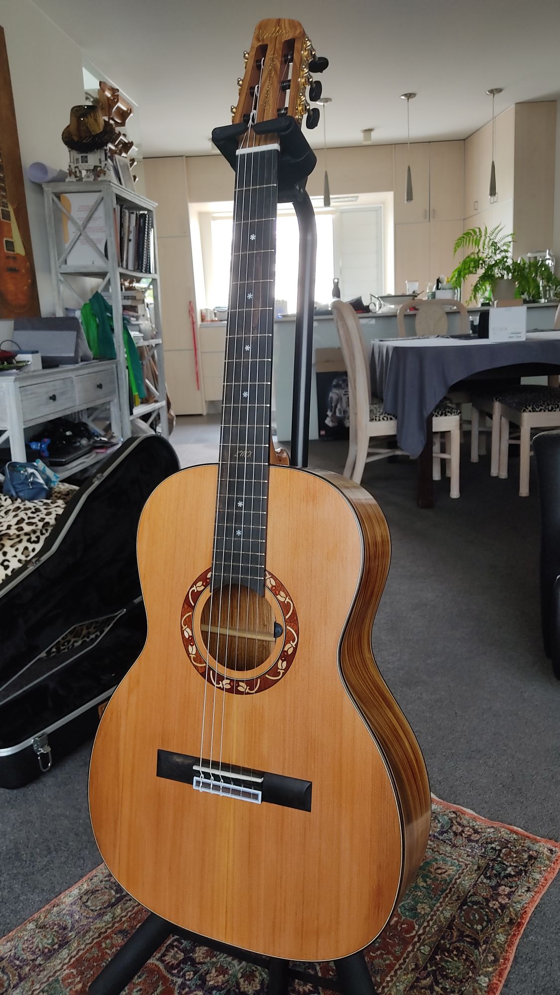

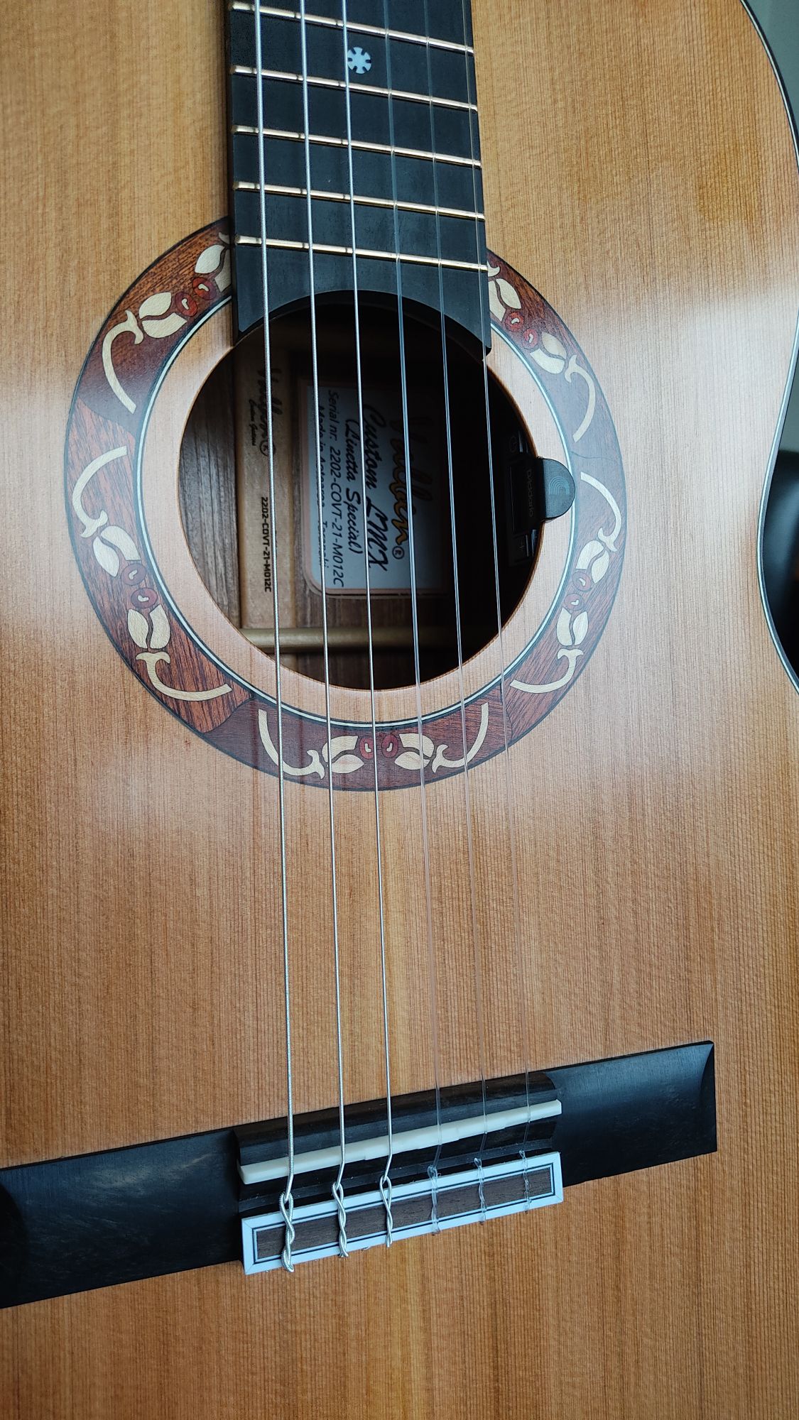

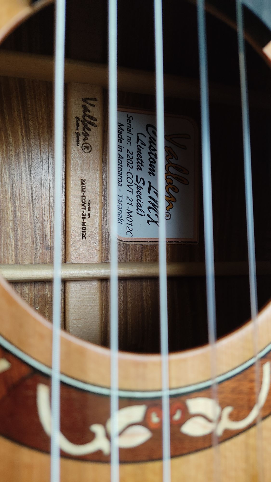

Some details and pics of my my last built completed just before Christmas
Details:
- Near 000 size with 12 frets at the body.
- Fan bracing
- Scale length 650mm
- Width at nut 48mm.
- Brass strings counter plate
- Platina Shellac finish
- Set-up with normal tension Oasis nylon/silver
- bearing DJ tuners with ebony buttons (awesome)
Woods:
- Soundboard: 100Y old Red Cedar
- Back & Sides: Ovangkol
- Totara neck with ebony fretboard & bridge
- EIR binding with maple purfling

Great looking guitar and craftsmanship. I like the rosette design. How does that 100 year old red cedar top sound? I expect that it would have some warmth qualities.

the guitar sounds awesome (not my words :) ) powerful with clear and balanced trebles, I went to the lower limit of thickness with this soundboard, unfortunately I only have another set of this quality.
The rosette was pre-made, owner choice. I had other engraved design in mind but I have to say is pretty cool as is.
