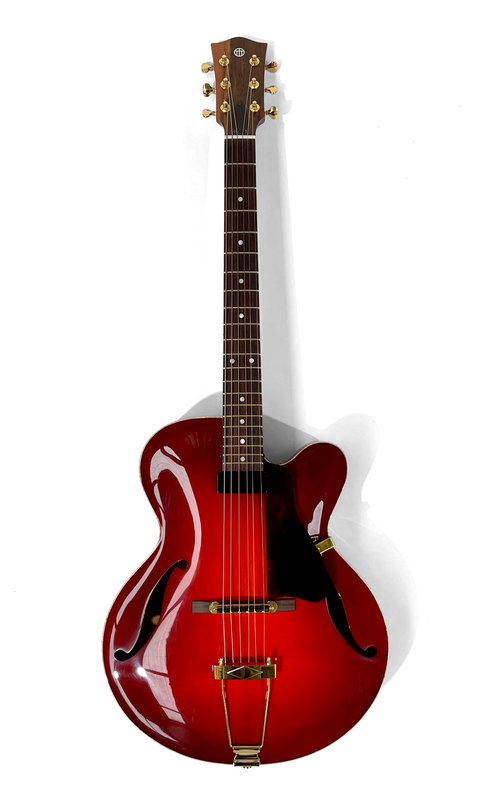

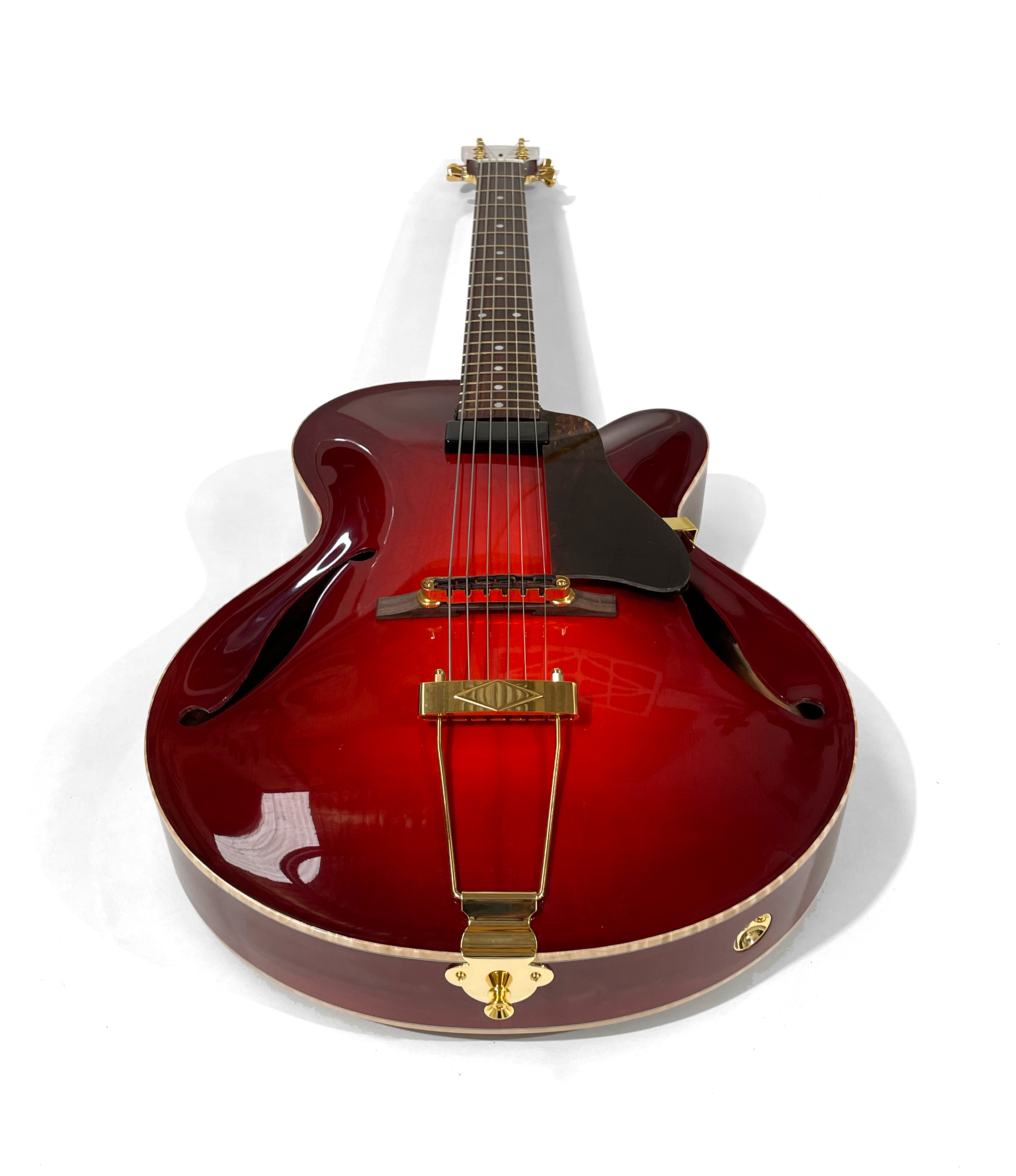

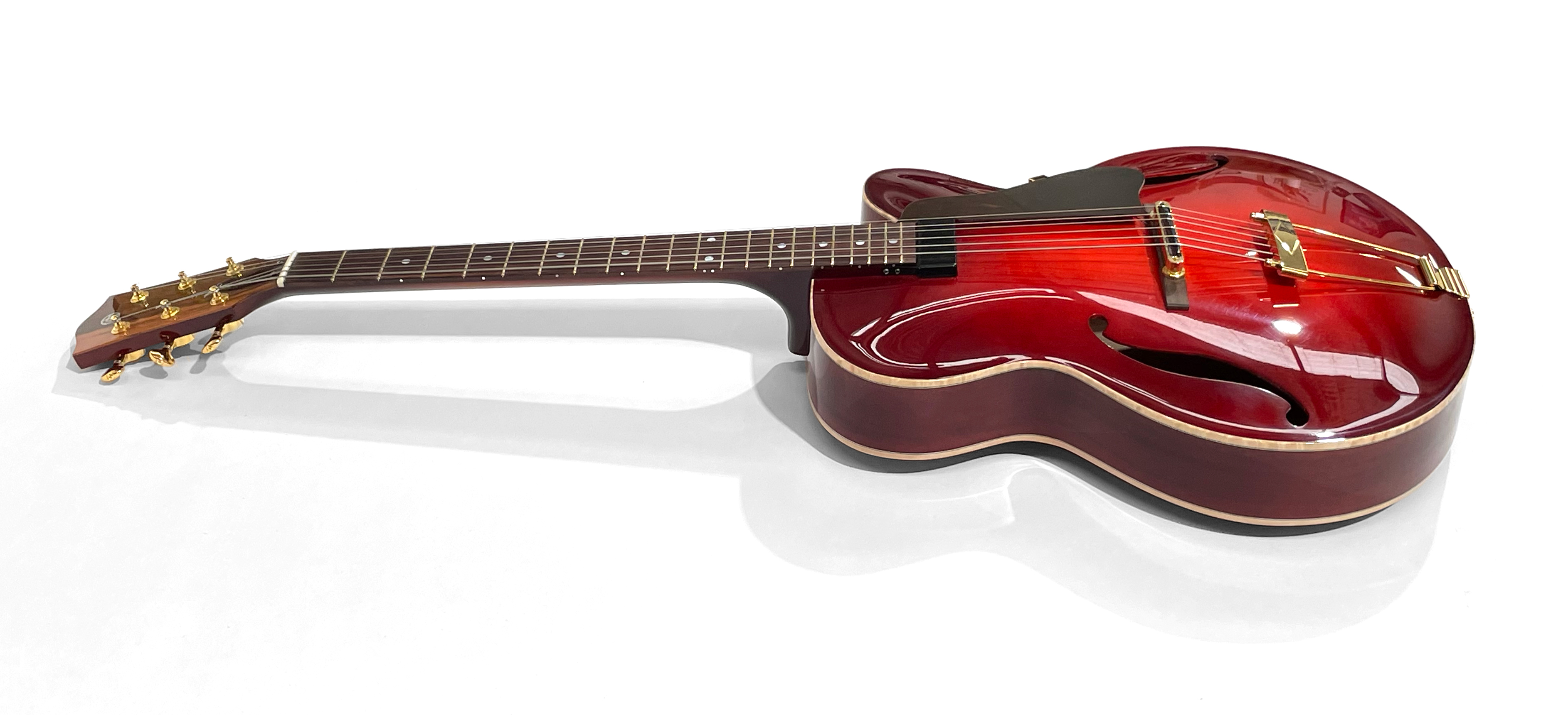

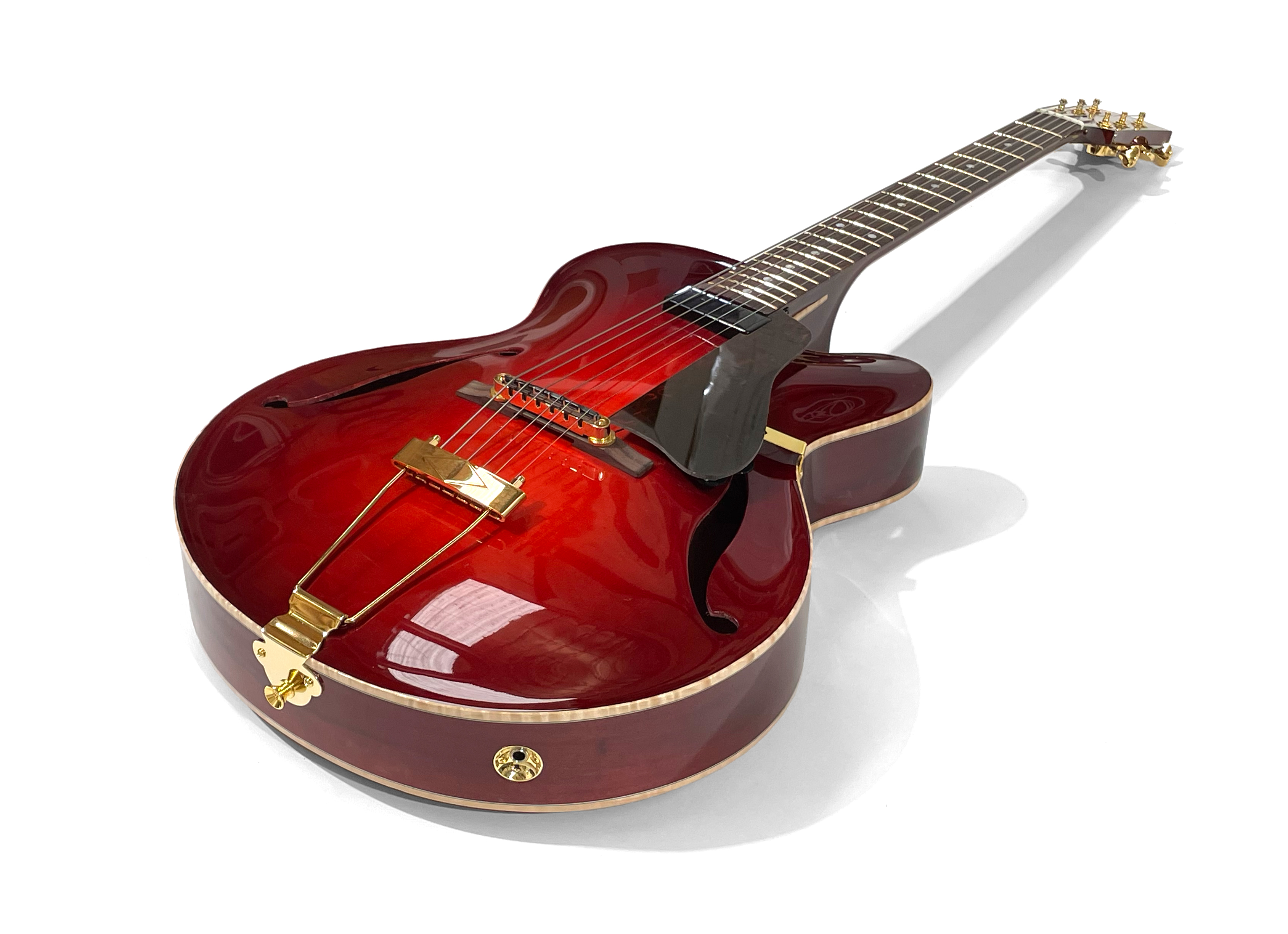

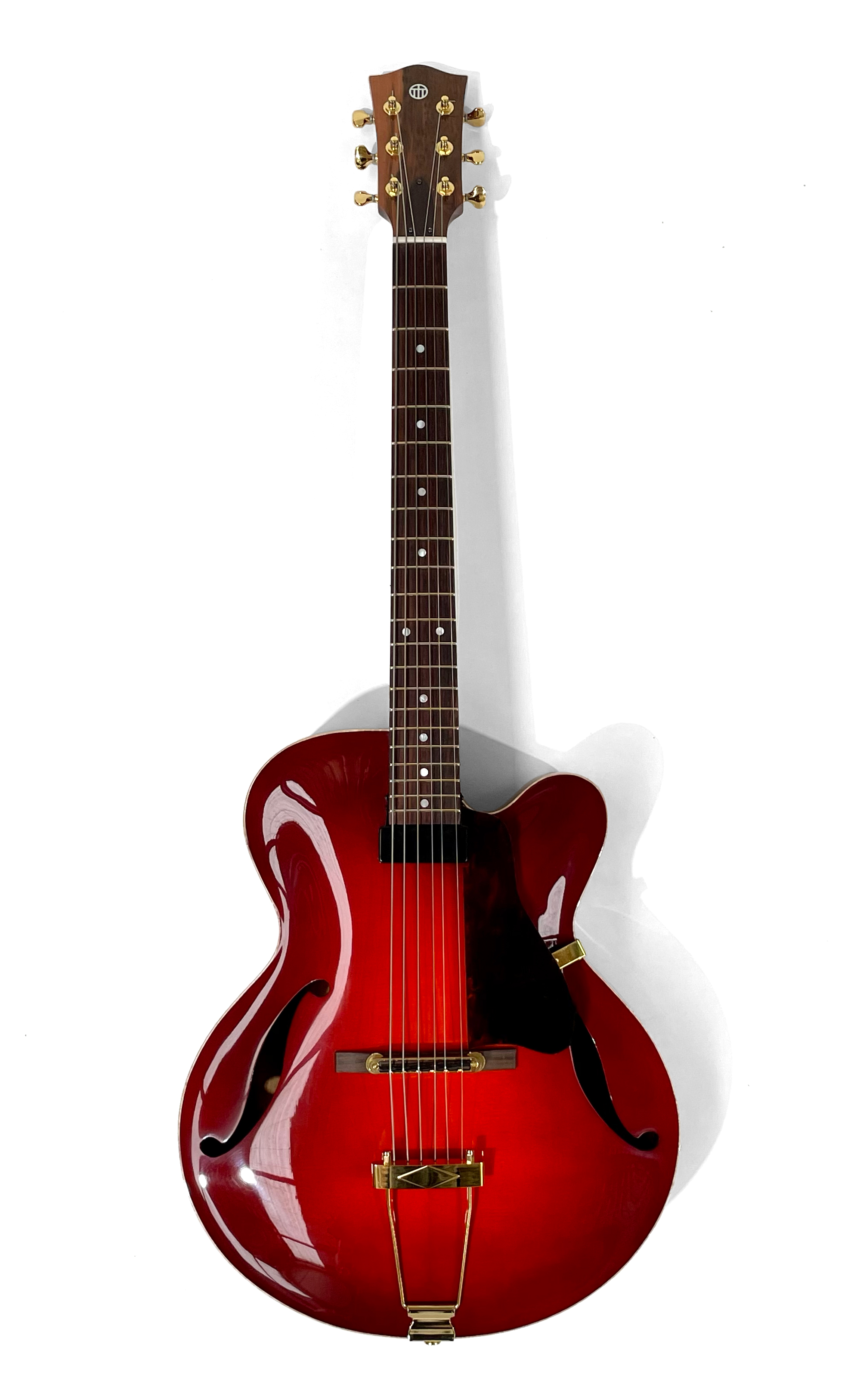

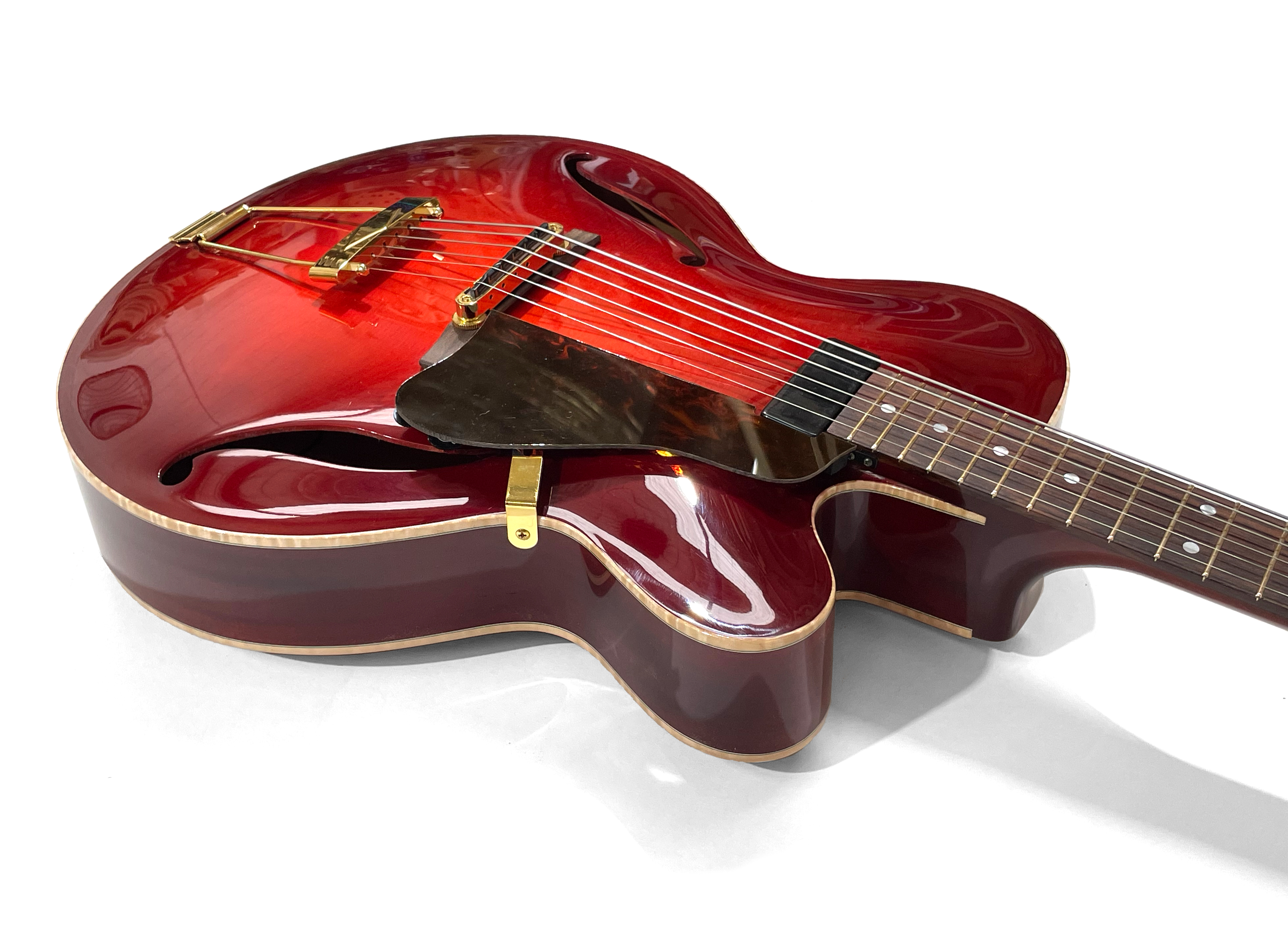

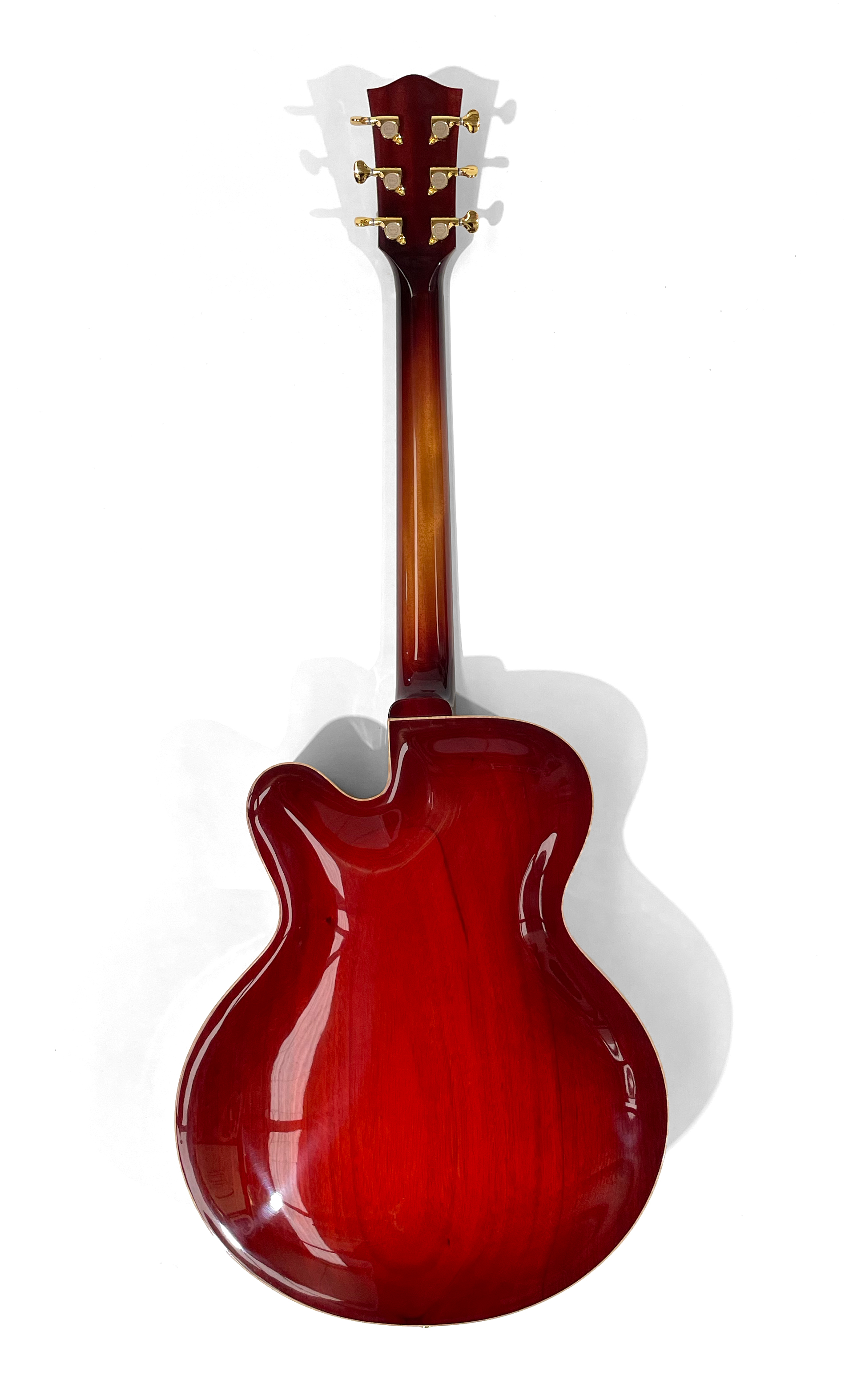

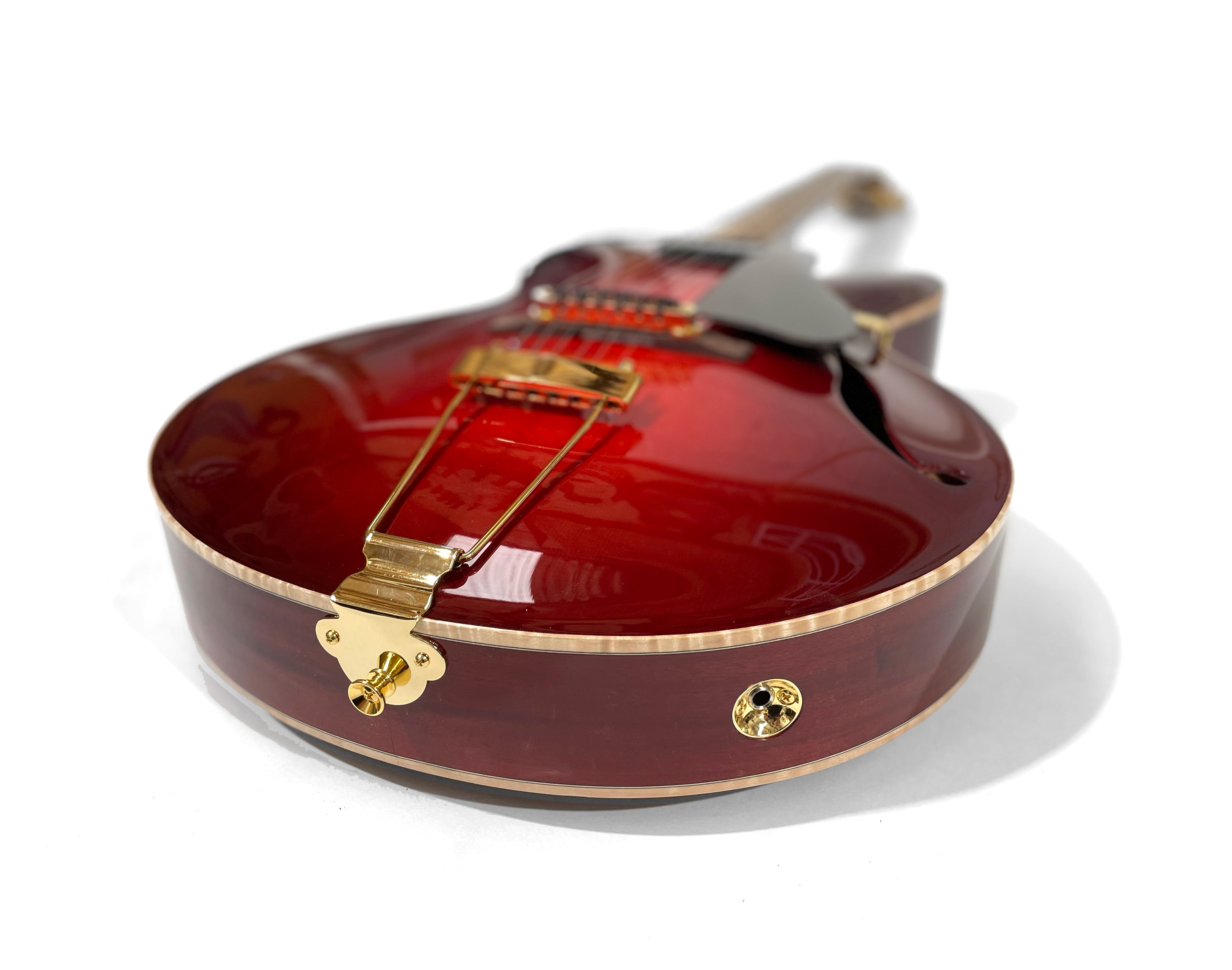

Hi everyone. This is my latest build. It’s a 15” archtop with Sitka Spruce top, Mahogany back and sides (one piece back), flame Maple bindings, Rosewood fretboard, Mahogany neck. There are two pickups, the neck pickup is a Kent Armstrong Slimbucker and the modified bridge has a Rich Barbera transducer saddle. The Barbera produces an amazing acoustic guitar sound and the Armstrong a great jazz through to blues sound. It is wired with two volumes only. The Barbera has such good output you can blend the two without the need of a preamp driving it. I used the Schaller thumb wheels for the pots. Spray is Nitro. I’m calling the colour a blood burst.
