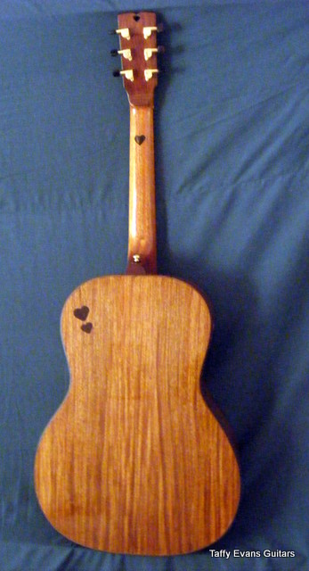

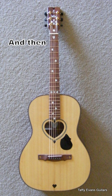

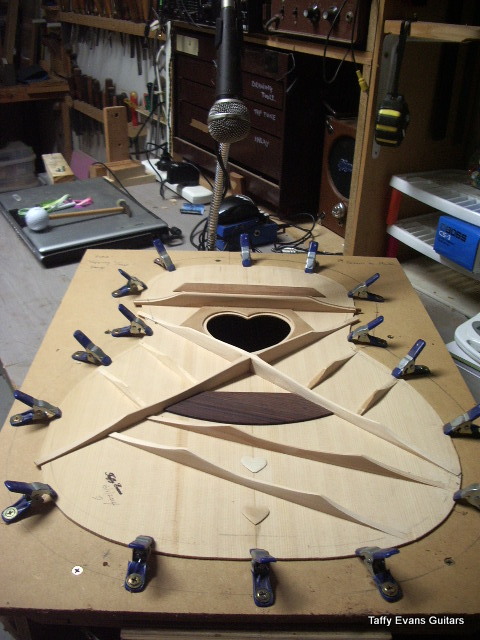

Prior to starting the build of this guitar, I had to give a lot of thought to changing the soundhole size and shape. As you can see it's heart-shaped. I finally settled on a design and the build began.

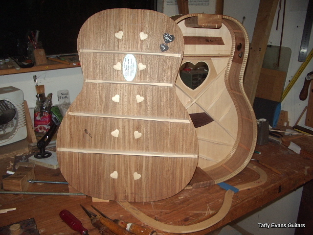

It was to be a special guitar in a couple of ways, 1- to be part of an exhibition and 2- to celebrate being married fifty years. I planned to have fifty hearts in and on the guitar. Soundhole, sound ports in the side, MOP, maple and ebony, inlays, and reinforcing cleats inside.
The back and sides are NGR, the top is Engelman spruce, a Qld maple and NGR neck, and a rosewood fingerboard. It has a 12-fret to the body 25” scale neck.
My plans about soundhole size and positioning worked out well as it turned out to be the best-sounding guitar I had built up to that time. The person that bought it thought so too, I had only played two chords as part of my demo, and they said I’ll have it.

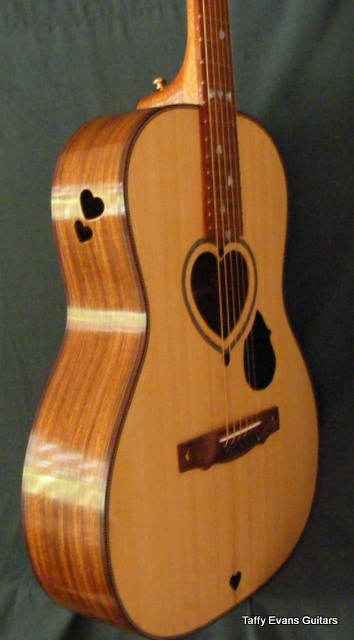

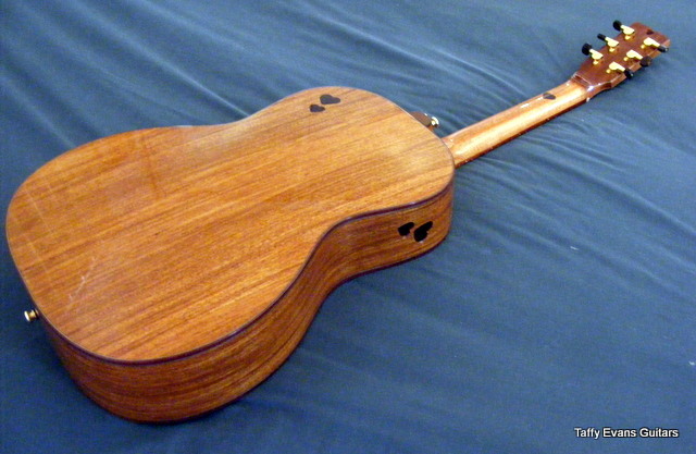

Dave, I got the inspiration from a guitar that was built for Eric Clapton by Zamaitis Guitars, years ago, and one played by Pete Seeger. Clapton's guitar was called Ivan The Terrible. In mid-1960 I asked Maton to build me a guitar with a heart-shaped soundhole, their reply was that they could not take the chance on such an expensive instrument.
Here are photos of more hearts. The guitar was exhibited for 3 months, and I often got a phone call from somebody asking where all the hearts were located and they would tell me how many they counted.
