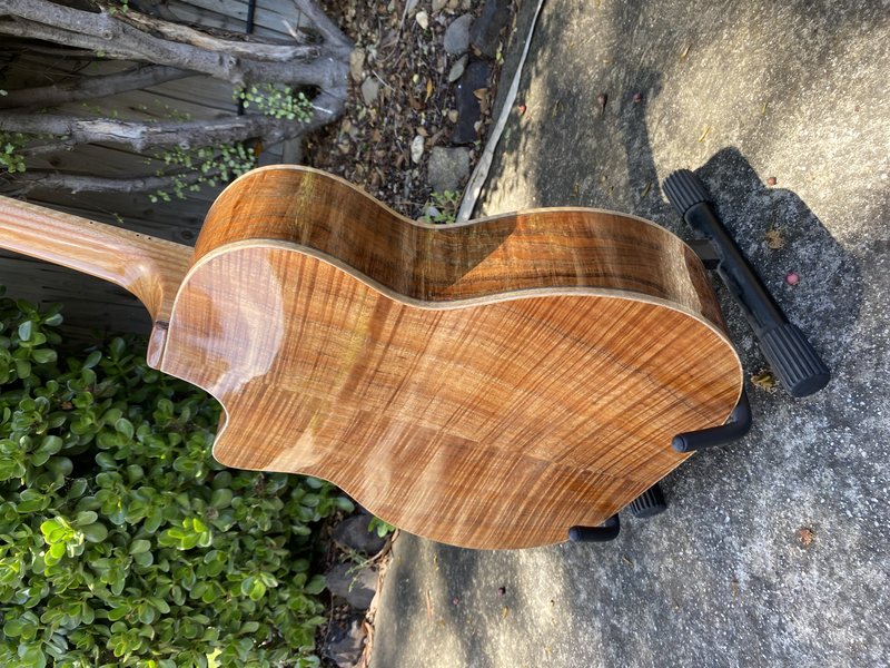

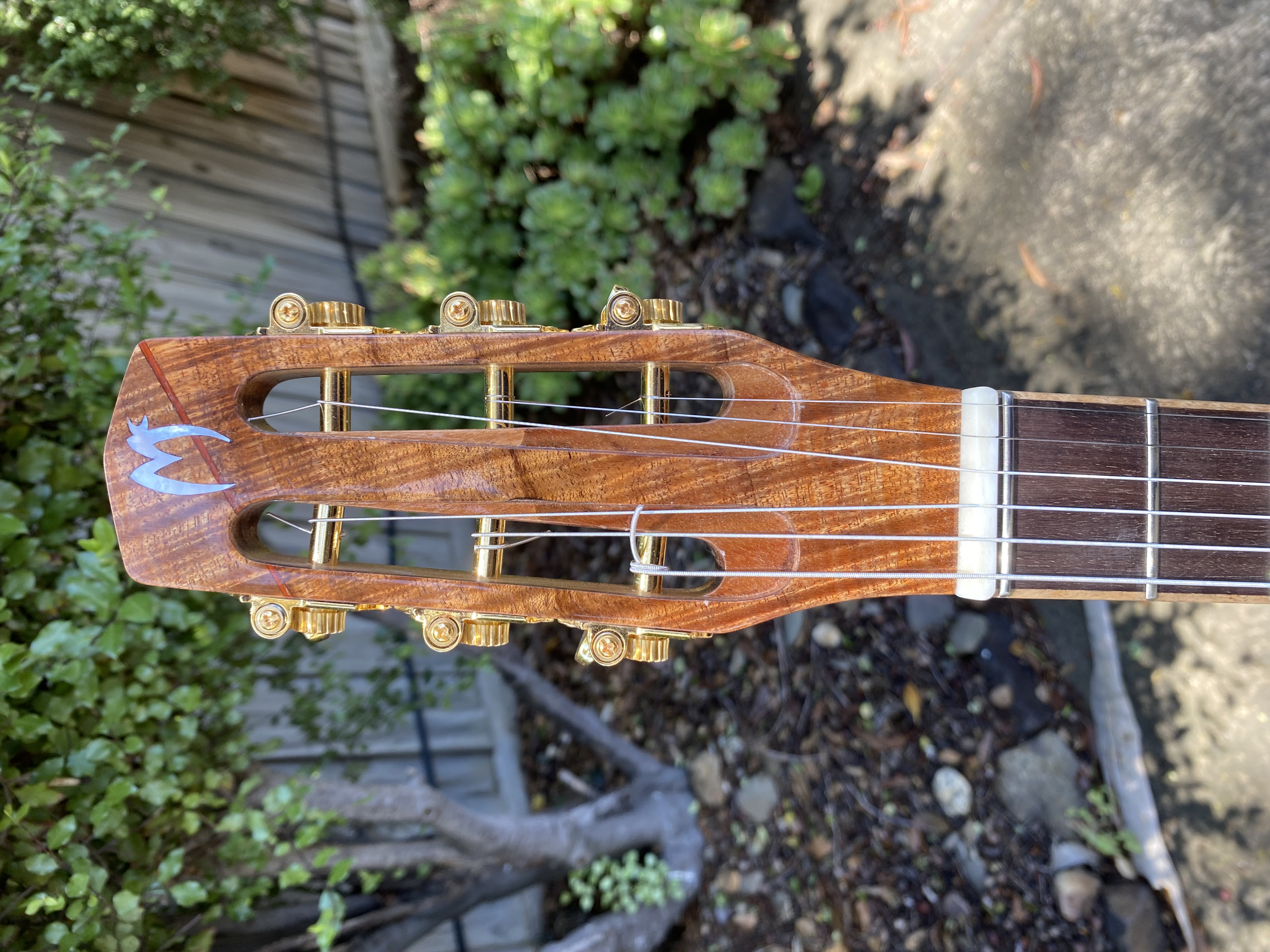

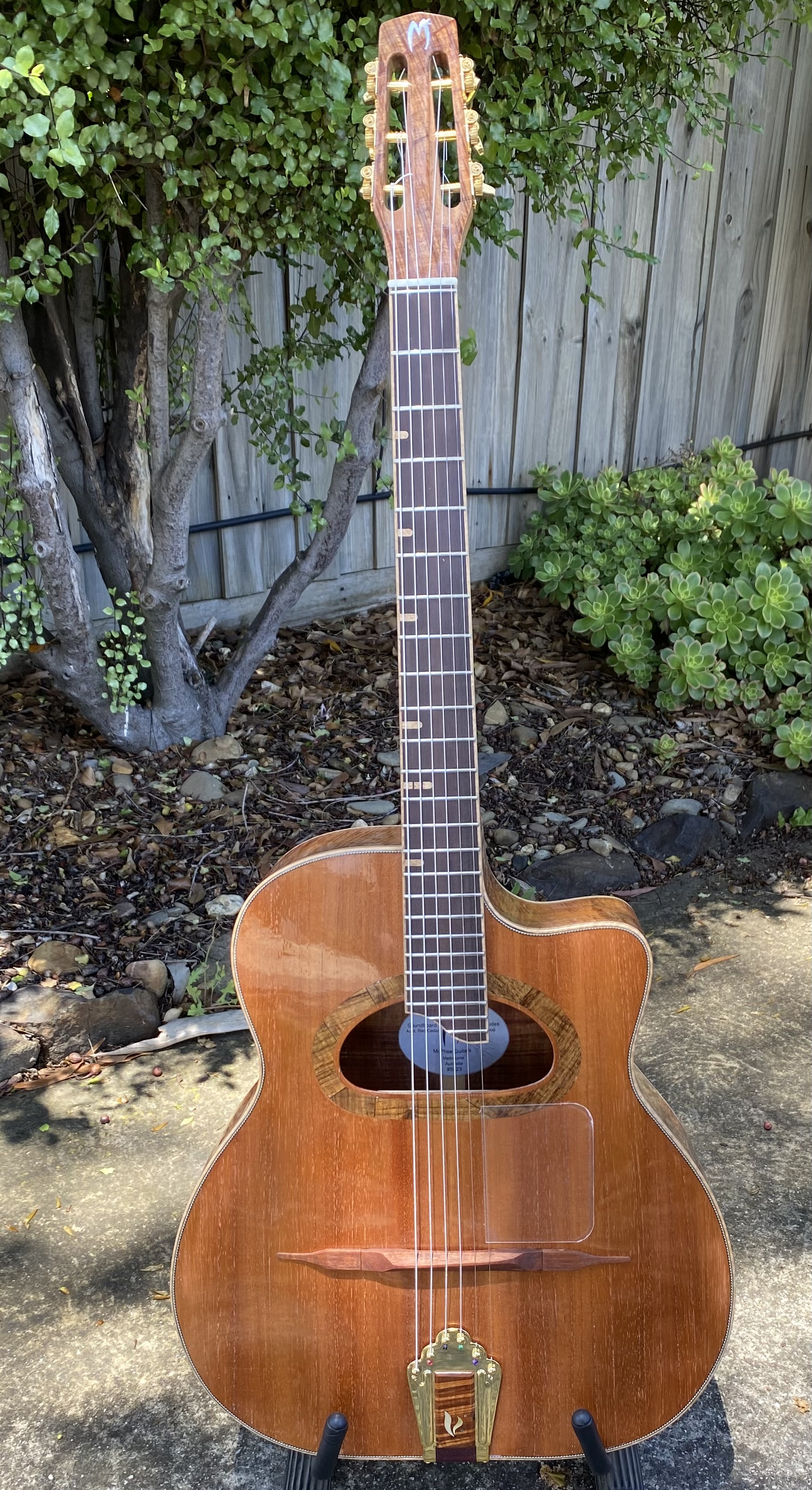

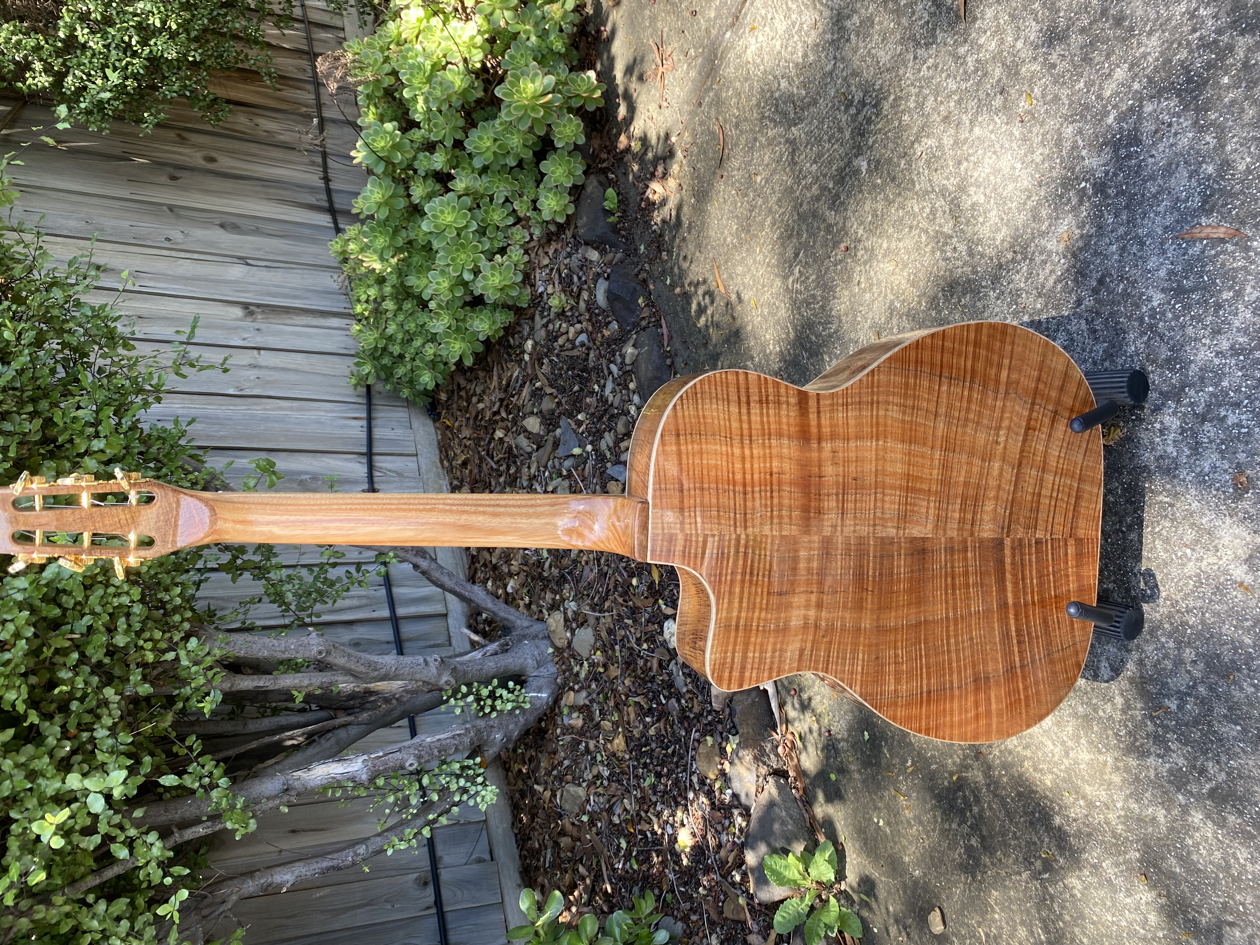

Another Selmer finished, this is number 6. I have an oval hole about 50% finished and I have a left handed d hole started.
This one is Blackwood b/s from Tim.
Australia red cedar top
Blackwood neck and bridge and veneers
Katalox fretboard
Marri bindings

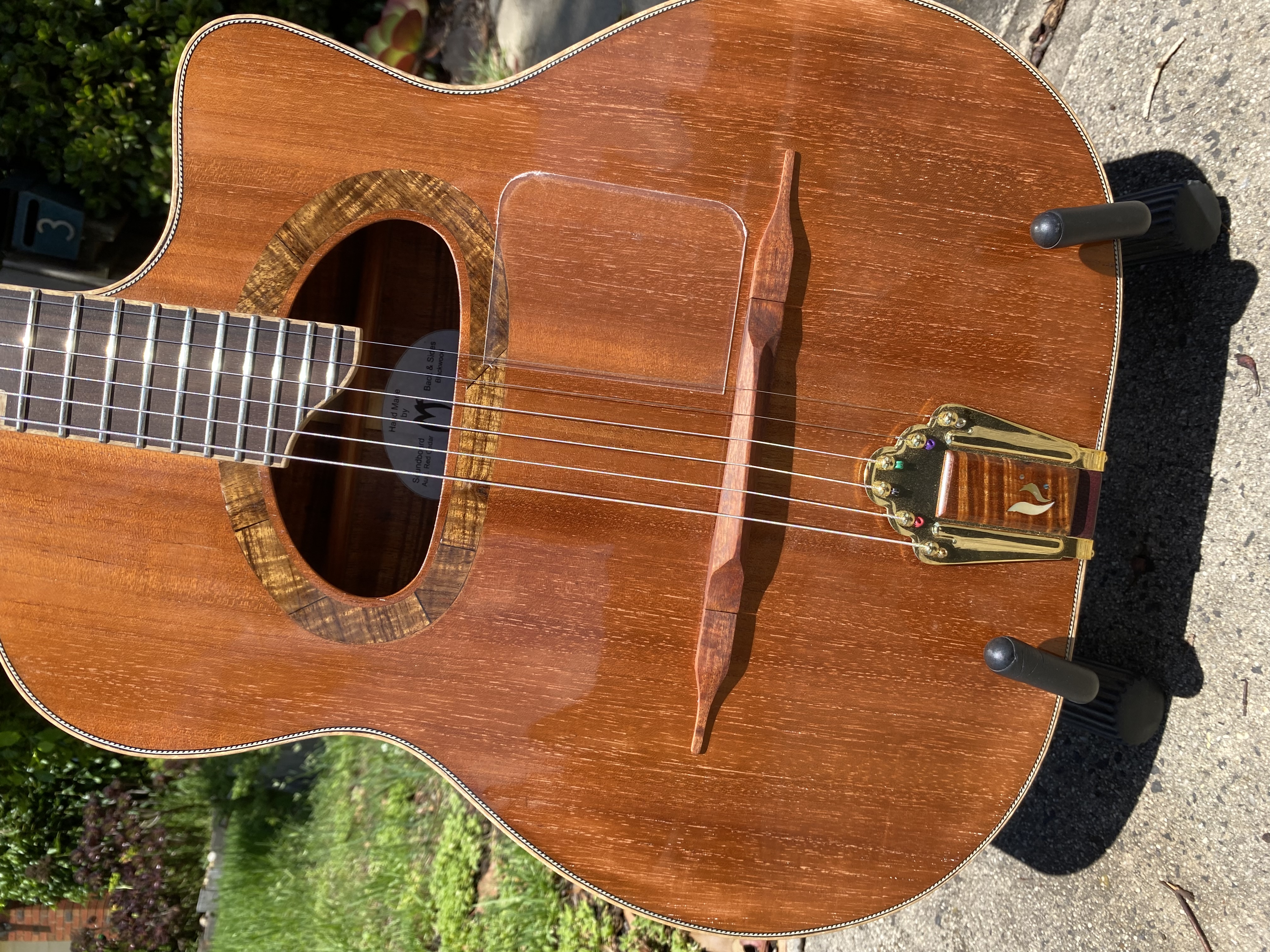

Great aesthetic. Am interested in the bridge. Do you not use a removable saddle? Is the bridge material itself tough enough to carry the strings?

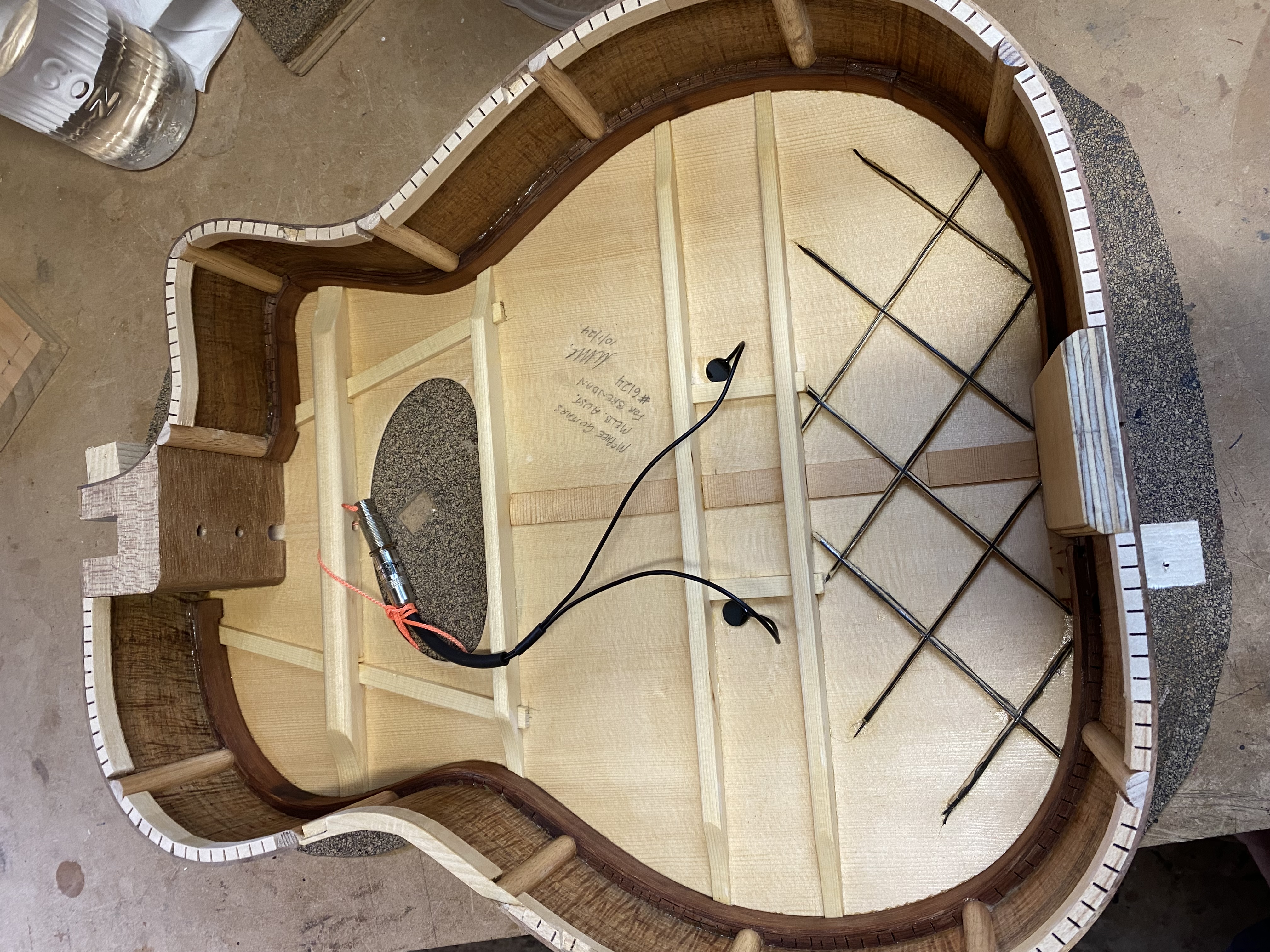

And don't I seem to remember that selmac used a form of ladder bracing? I wonder what you are using?
Didn't they use a crease to give a good break angle?

The bridge is just designed this way. As long as you use a decent timber then the saddle section is fine. This one is Blackwood, I normally use EIRW which is great.
The top has a crease ( pliage) just behind the bridge, it makes the top a lot stronger, so then it can be thinned more than a normal flat top. This top is about 2.1mm thick approx.
I have 4 ladder braces across the top, but from the last brace to the tail block I use lattice bracing reinforced with carbon fibre. The oval hole gypsy guitars have 5 ladder braces but a lot of builders leave the 5th brace off. I'll post a photo if you like. Wayne

This is the left handed guitar I’m working on. I closed the box today. Wayne

Does the guitar sound better only using two pickups sensor disks or would three sensor disks be better.

Thanks Wayne. I use the twin spot from K&K and they're really good and give a natural tone. 3 transducers could work fine but I've never used them and I like to stick with what I know.
