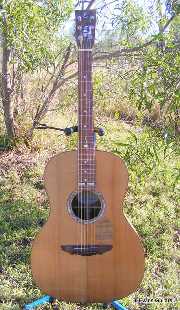

Hi, this guitar is not named after a gold mine on the Charters Towers goldfields as others usually are, but after a long-time mate, Tom, who passed away after a long illness.

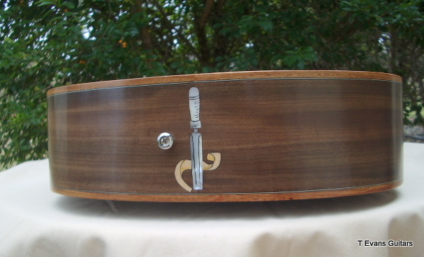

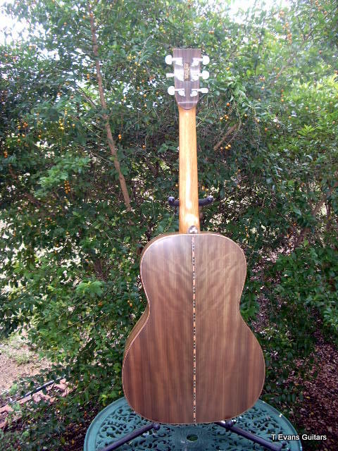

The back and sides are from a large slab of African Walnut Tom gave me before he passed, saying he will not get a chance to use it now.
A while after his passing I asked his wife if I could build a guitar in his memory, using the Walnut he had given me. I had sliced it up and got four sets out of the board. I also used cedar for the top that I had bought at the same time and at the same place he bought the Walnut, twenty-five years earlier.

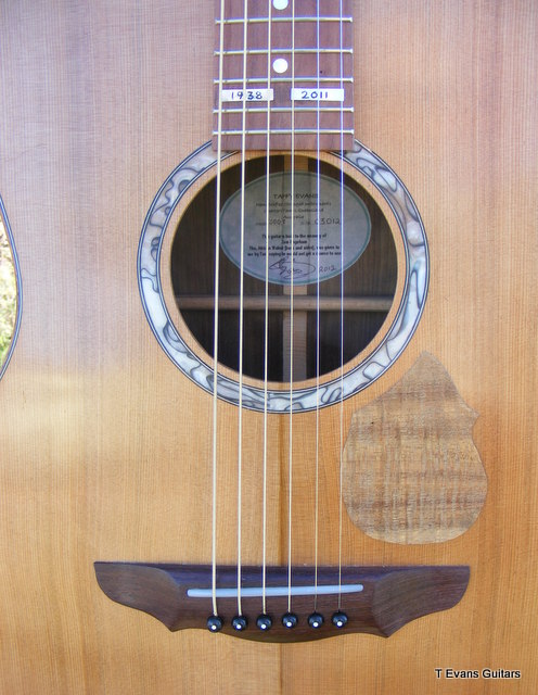

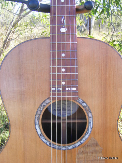

The guitar is a ‘000’ size and style, the inlays depict his interests, achievements, and quirks.

The 12th fret marker shows another passion, we could not travel too far without stopping for a cup of tea…

I presented the guitar to his wife on the first anniversary of his passing.

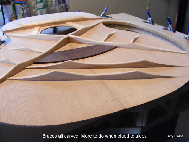

Mark, I have two tests left now, my next build will use one of them. I did not realise how well this guitar sounded until I played it for the family, and others, at a Budist-style remembrance ceremony under the palm trees on a beach north of Cairns. I had never played it in the open air before and sounded so much better.
The bracing is not as fancy as some shown here, but I'm a bit long in the tooth to start relearning.
