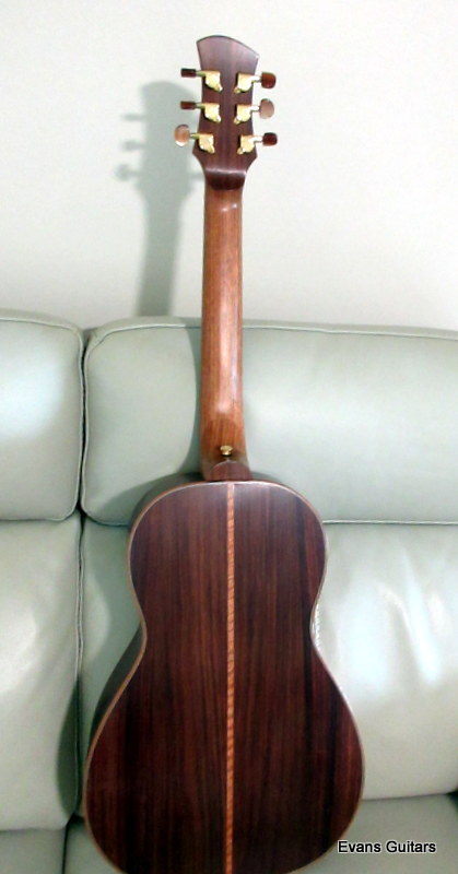

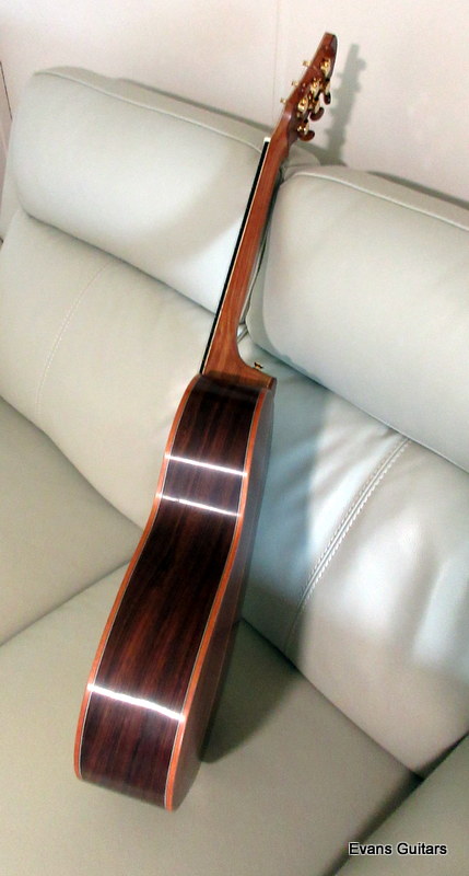

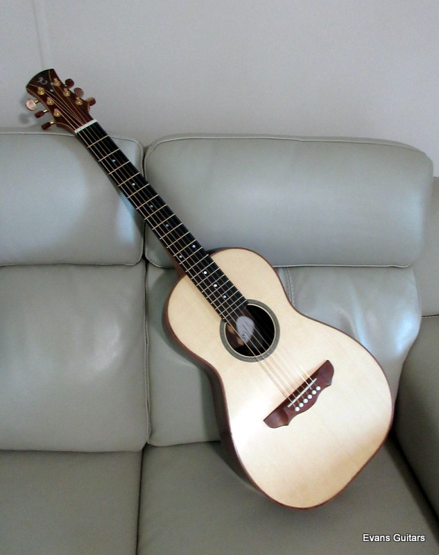

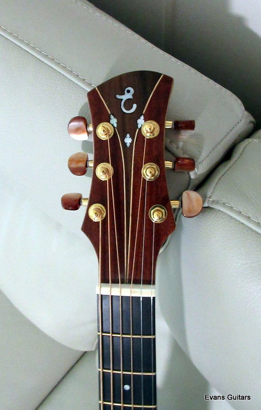

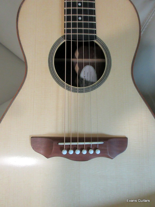

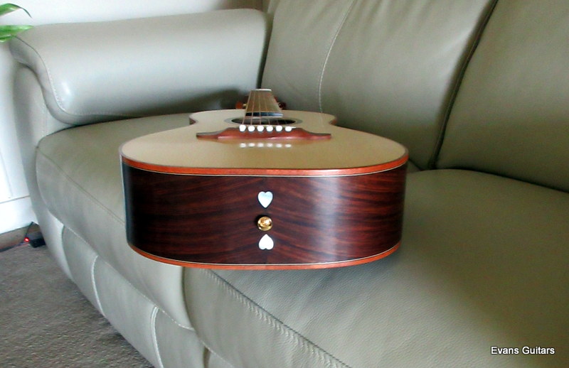

Hi, here is my latest build, a Parlor guitar using Englemann spruce and EI Rosewood, which I imported from India some years ago. The neck is new Guinee Rosewood, the fingerboard is Ebony, and the bridge is Cooktown Ironwood. I carved the bridge to make it close to the weight of Rosewood. The binding is a hard Meranti.
The finish is nitro, very thin and matt.
It has only been strung up for two weeks, but is noticeably gaining nice tones. It had great volume and sustain from the get-go. I’m happy with this build.
Cheers Taff
Rosewood & Englemann parlor.
