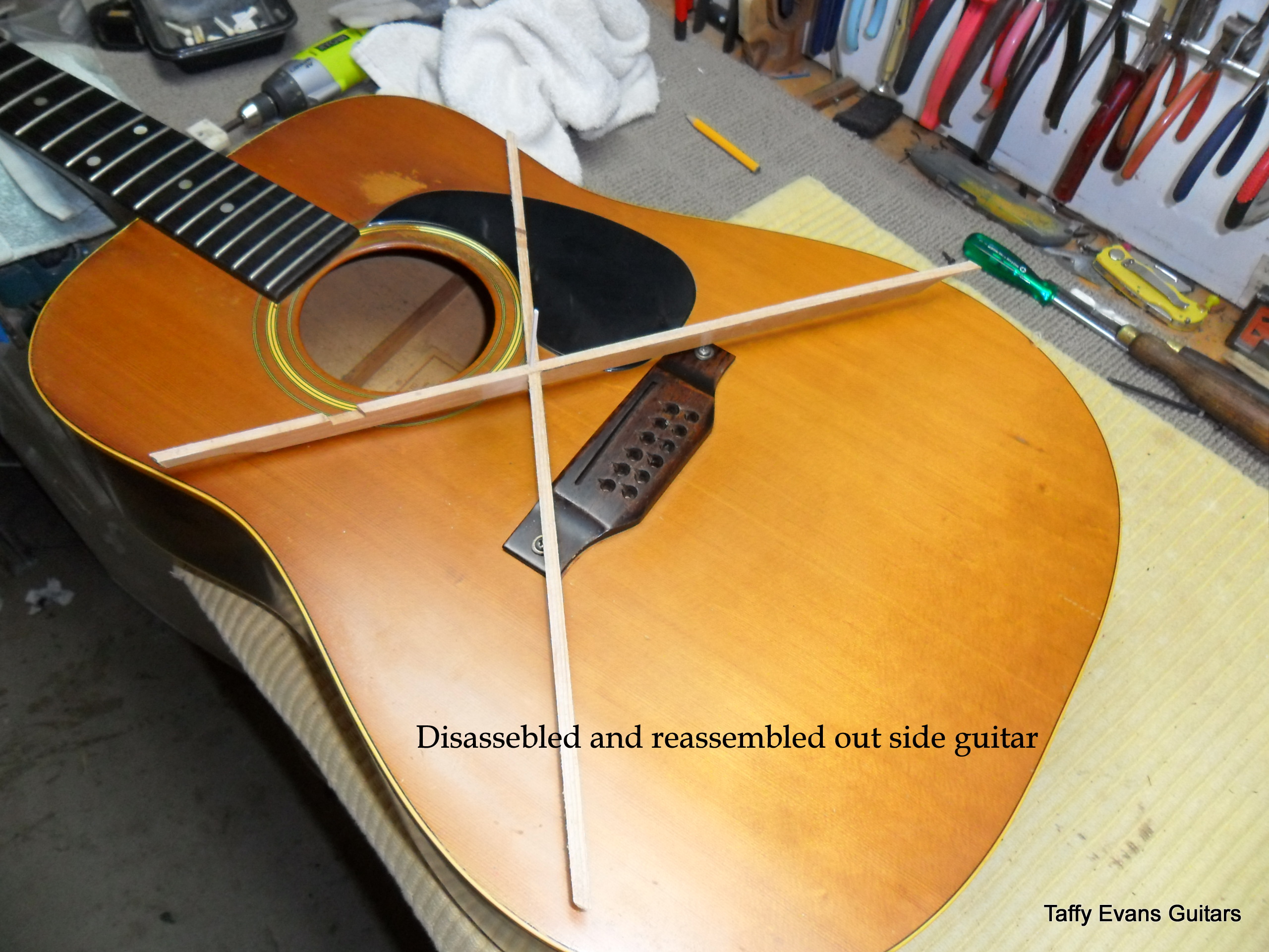

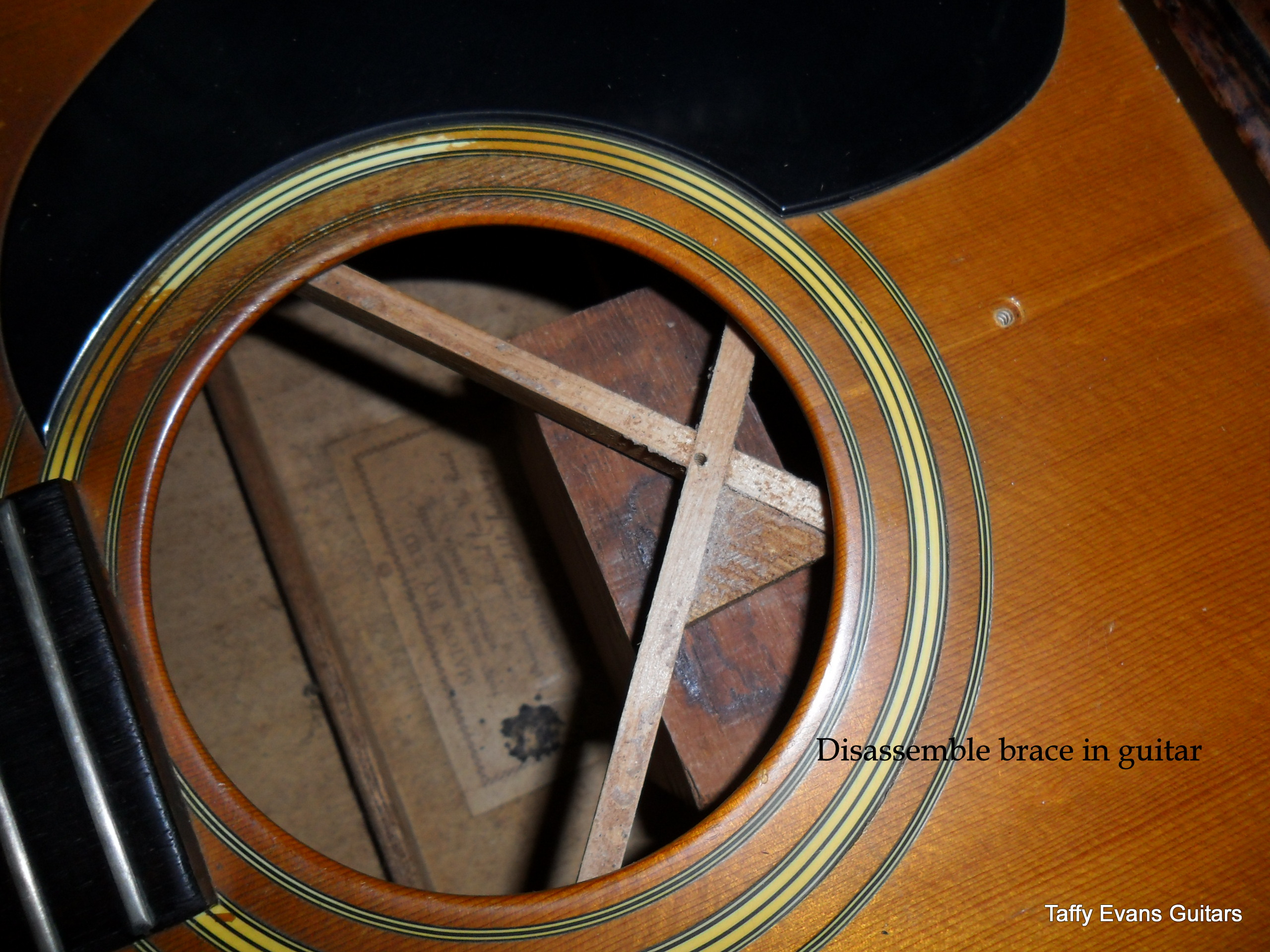

Hi again, not related to your present neck problem, but shown as a matter of interest.
This old Maton cross brace's glue let go and somebody tried to hold it with a screw. I undid the screw and the cross brace fell to the bottom of the guitar.

Wow,
Looks like heat and humidity took its toll on this 12 string.
The screws/bolts on the bridge look to be added - if that’s correct then it might have been someone’s answer to a lifting bridge.

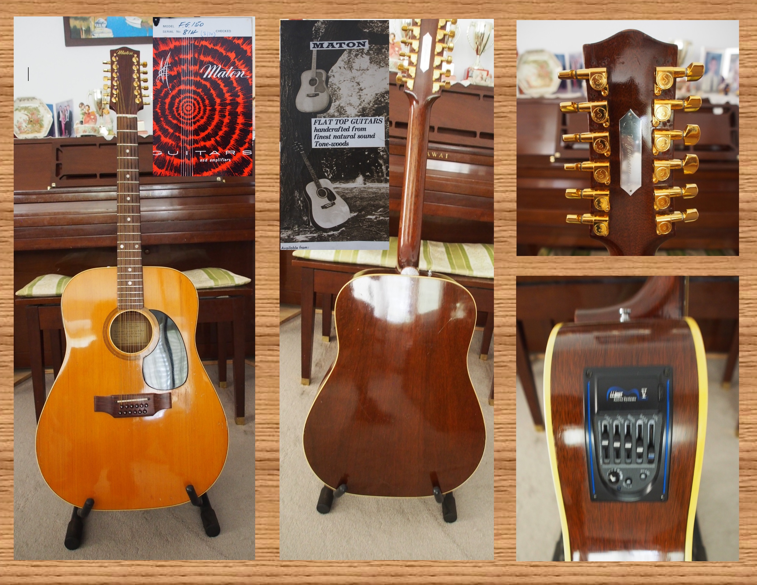

Post by WJ Guitars » Wed Apr 26, 2023 2:34 pm
On side my first guitar that I purchased was a Maton !2 String Guitar, Model No. FG150. It is now 52 years old and around 15 years ago all the frets were replaced, Schaller Mini Tuners, new rosewood bridge and West pickup installed. This work was undertaken by Jeff Mallia, (specialist guitar repairs and restoration). The guitar case fell apart and was replaced. This guitar sounds amazing and has a nice low action making it easy to play once you are use to playing a 12 string acoustic guitar. See Photos.

Post by Alan » Wed Apr 26, 2023 4:52 pm
Gday Wayne
Your 12 string looks fantastic - great restoration.
