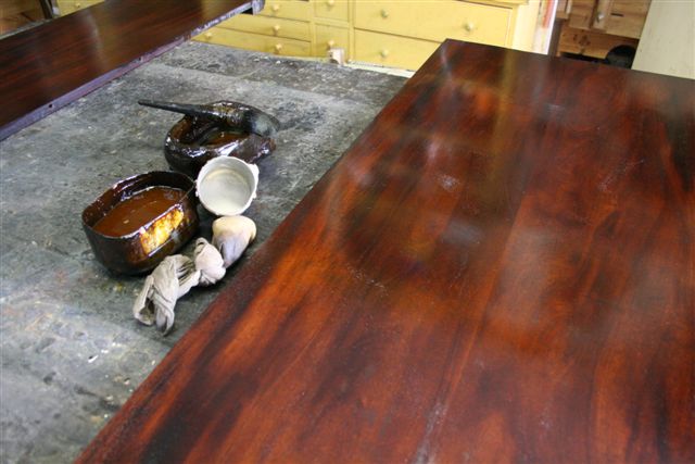

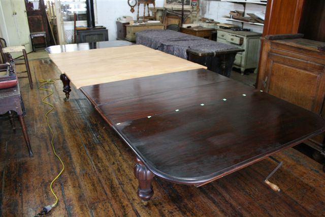

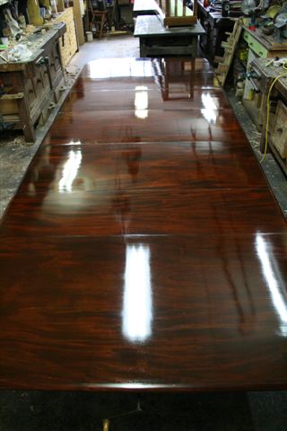

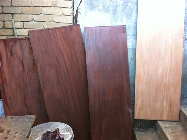

This is a job we have been working on lately , re make three missing leaves ,strip the spirit varnish later colour job,colour match the three leaves and re polish with shellac , some pumice ,elbow grease :lol:
Its a rare sight , a table this nice , solid Cuban Mahogany ,it has a double winding extension system, made between 1865 / 70 with a matching set of twelve chairs .at this stage it's 75 % through the polishing,needs to be finished in about a week.

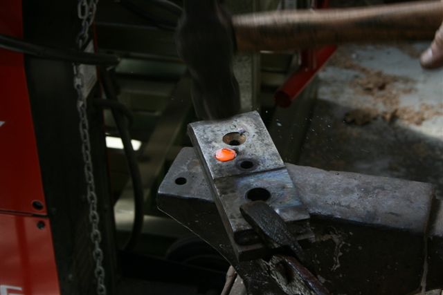

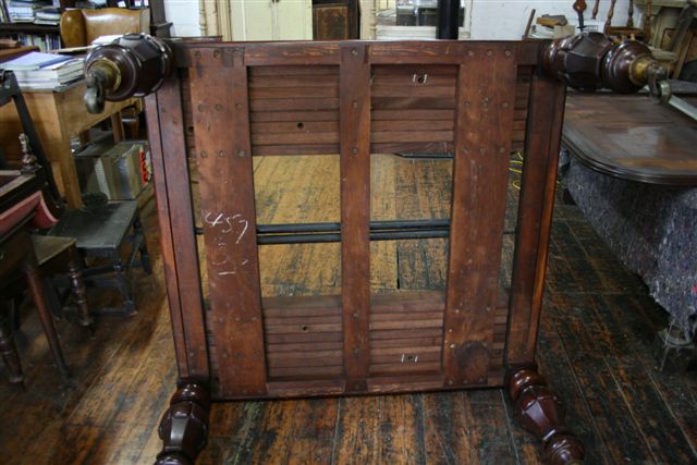

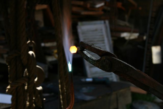

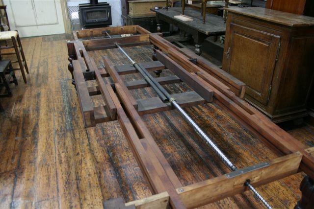

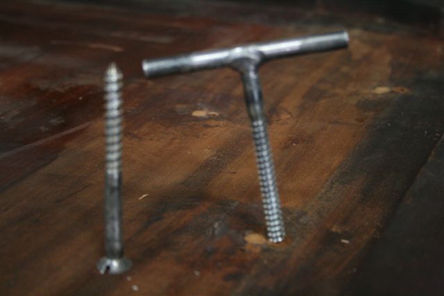

here are some more pictures,
We had to plug and re position the top ,so we positioned the top ,spiked it through the hole from the under side, flipped it up and then drilled and tapped it. Then with a rub of beeswax on each screw it's a pleasure putting them back in

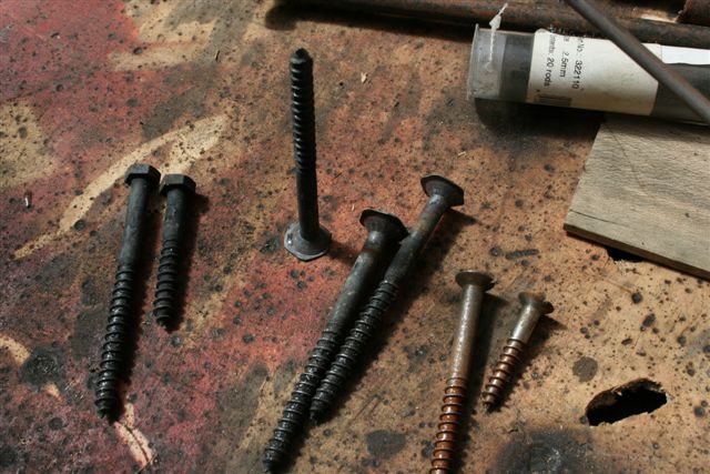

Missing screws have to be made,they are 16 or 18 g ? we re forge the Hex heads of screws with a heading plate. and saw the slots in by hand, we take off the zinc or Gal with acid first

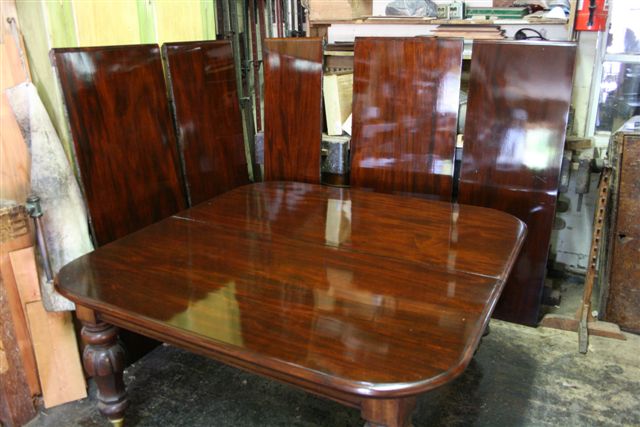

And some pictures of the extension mechanism.
