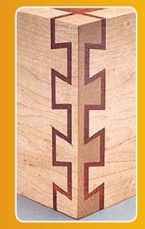

Yep they look mostly machine cut to me.
Dovetails use to hold me in awe, until I bought an incra jig, now dovetails are childs play, they are so simple people start making really complicated dovetails
Example.
dbl dbl.jpg (29.93 KiB) Viewed 7270 times

You can use the Incra Jig ??? You must be a savant !! :shock:
But seriously, in an exhibition or a comp. like this one, machine cut is a disadvantage to the maker. The judges usually look for the London pattern ( thin, thin pins ) or pins smaller than a router could cut. Hand cut dovetails in contempory work have been given sacred cow status. I've done a bit of repro and would over saw or over chop the odd ones to make it look real. This was usually work done by apprentices under the gun.
