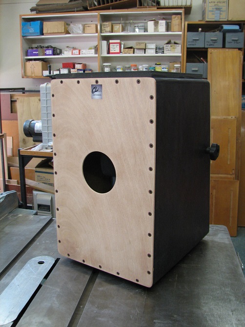

Latest build from the 'shed' is this deep bodied instrument, it's a radical departure from normal luthiery methodology and flies in the face of conventional guitar building wisdom, even the materials are different for me. It's designed so that even a monkey can build one, well I managed to build it so what more proof do you need? :wink: it also has an exagerated Manzer wedge profile to it.
:lol: :lol: :lol: No, actually it's called a Cajon.....not cojones, they're different animals altogether, warm round and fluffy, this is a box drum originally from Peru (Cajon being the Peruvian for box). It has a front 'head' a "Tapa" and behind that are drum snares. When it's hit near the top it sounds just like a snare drum and a move down more toward the centre and a flatter palm approach gives you the deeper kick drum sound. My step son was originally wanting to build one but the poor bugger's been working two jobs saving for his wedding next year, so seeing as it was his birthday last week I decided to knock one of these up for him. It took a little longer than I first anticipated but has been fun working on it. Traditionally they are made square and the player leans it back to make the front face more accessible but I've noticed a few manufacturers now angling the face so that's a feature I incorporated into my build.

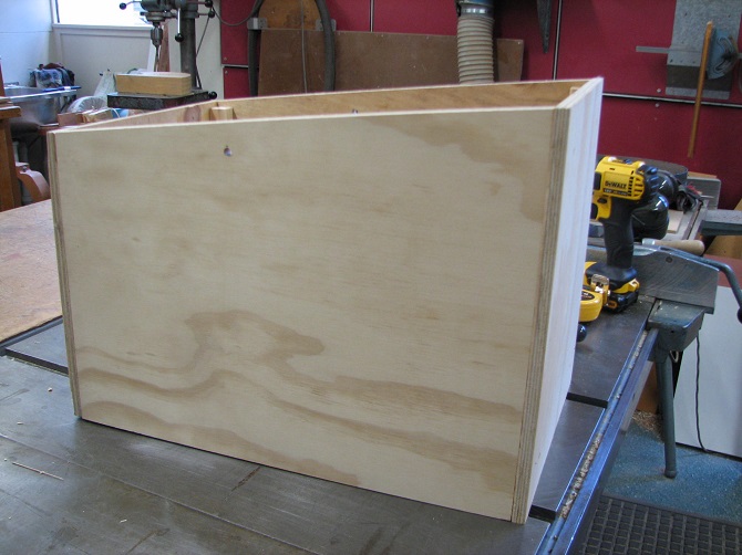

Here's a few pics I took during the build.

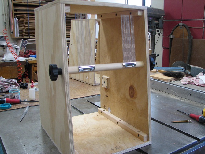

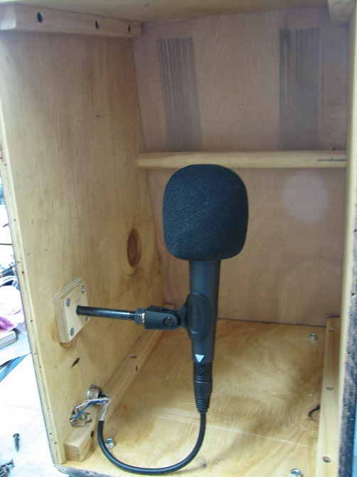

'frame' made from construction grade 12mm ply and a 22mm dowel carries the snares (a 13" snare cut in half), I made it so that the handle/knob on the left clamps the snare bar in position and the right one adjusts the bar so the snares can be 'disengaged' just by loosening the left and turning the right knob.

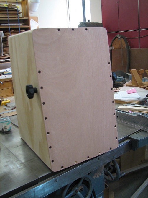

With the front 'tapa' in place.

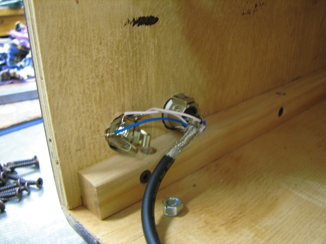

From what I can make out commercial ones use 3mm ply, the closest I could find here in Un Zud was 4mm Marine ply so I used that but ran it through the thickness sander, it would have worked leaving it at 4 but I felt the snares became a little more active at the lesser thickness. Because my step son is right into his music and sometimes records with DJ's e.t.c (actually does a mean beatbox!) I added an internal mic and wired the XLR output into twin plugs, a balanced XLR for going straight into a P.A or desk and a 1/4" jack for amping
I used a stereo jack socket so that it didn't cancel out the balanced line signal at the XLR (usually you bridge terminals 1 &3 when going into a mono signal) with terminal 1 going into what would be the ring on a stereo jack but the earth on a mono.

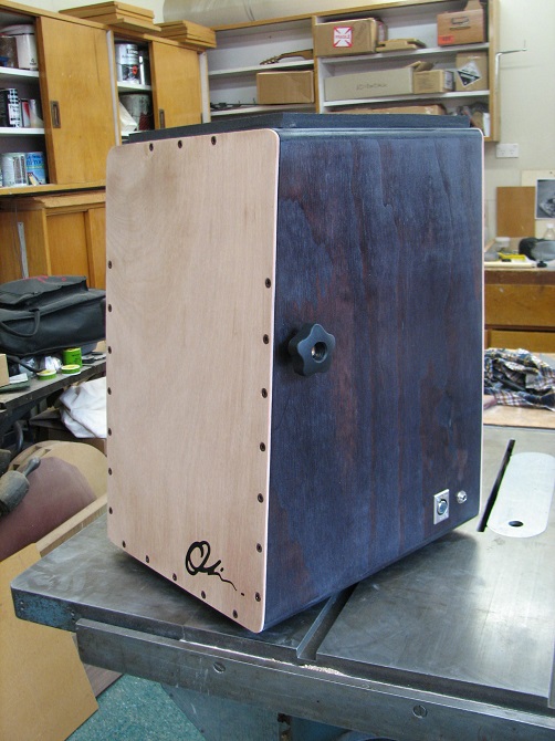

A bit of 'tidying' up the frame by rounding corners and a sand, a quick wipe with some half strength black stain so as not to hide the grain on the ply and a few sealing coats of lacquer and the body has what my workmate termed "Speaker Black" (apparently all the speaker cabinets in the 70's had a similar appearance :shock:, I'd forgotten!). I left the front and rear faces natural added an "Oliver" signature sticker to the front face (have plenty left over from the vibraphone I made as I had to order at least 50 before the sign company would do the job!) and voila........

I saw a design (maybe on YooToob) that had the snares mounted on a rotatable dowel with a spring to engage and a string and knob at the back to disengage, but your system to set the amount of snare (or none) is better (simpler, more elegant) than what I saw.

Dennis Leahy wrote:Did you pad the top? Looks like you did.
Yeah just a small amount of cushioning for the backside Dennis :wink: It's a bit of 1/2"thick high density foam. Interestingly enough when running the Cajon through an amp, if you hop off it and hit the padded top it gives you yet another sound! More of a muffled 24" kick drum without any of the snare action.

Dennis Leahy wrote:p.s. Oh, one last thing: what is the logic of why you arranged the tapas screws as you did (with an area not screwed down)? Did you see that done by someone, or is that your own intuition, or...?
Cheated and copied others Dennis :wink: The idea is with no screws is to allow the tapa to sit off the box slightly at the corners so that when you hit it it gives a slight tapping/clicky or slapping sound similar to a rim hit, so another flavour to add to the sound. The guy I saw doing it actually "tuned" the gap slightly by adding shims under the higher screws on the side, this altered the amount of slap sound it produced.
