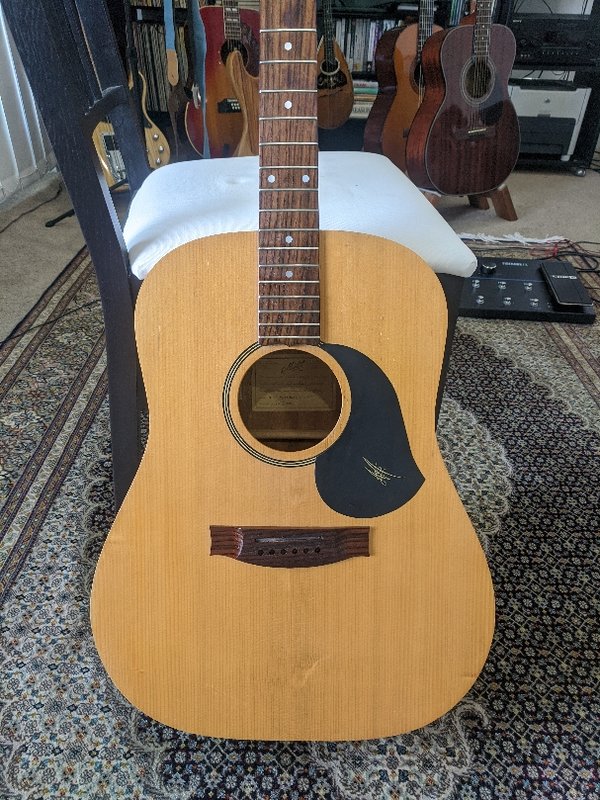

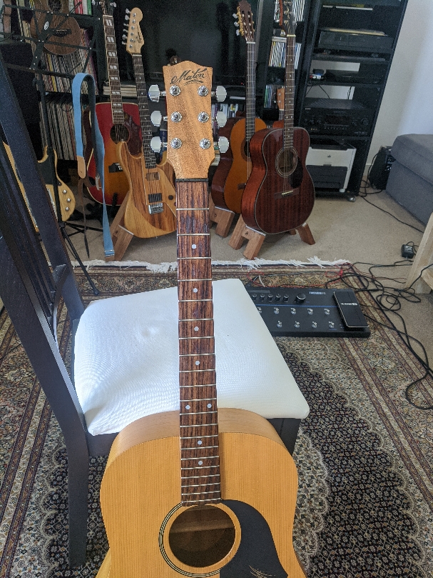

Hi people,
I recently purchased an oldish Maton guitar yet to receive with a cracked neck, I will share some images as soon as I receive the guitar. I thought a good idea to use titebond hide glue for repair (might not be the best choice) anyways to be prepaid go ahead and ordered some from Amazon. it arrived and I test it on a piece of balsa and after 24h still softish and can dent with fingernails, also been a really damp and cold weekend in Sydney. is it the glue or weather? should I wait more or heat the joint or better to use epoxy or superglue? I have a special low viscosity epoxy wich set super-strong which I used it before on a 1/2 size guitar neck and worked beautifully.

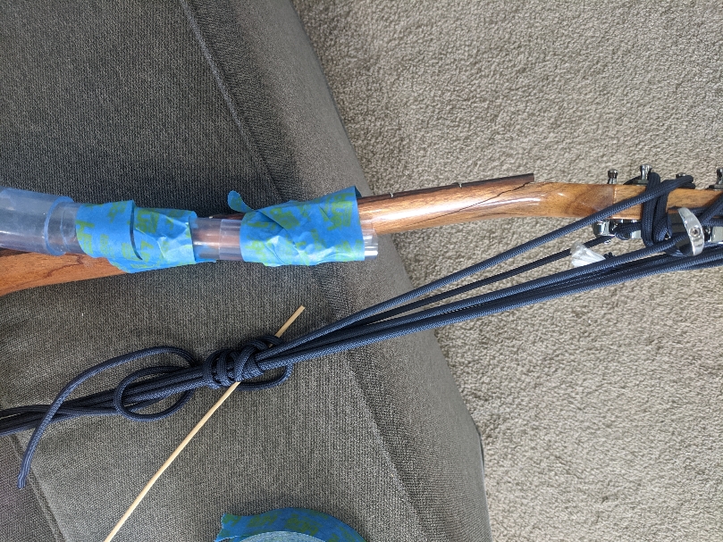

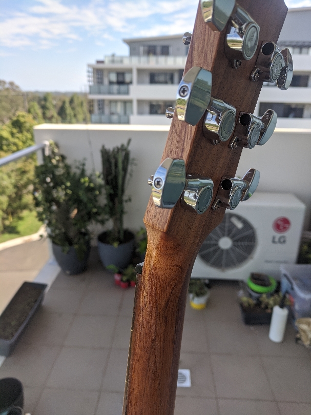

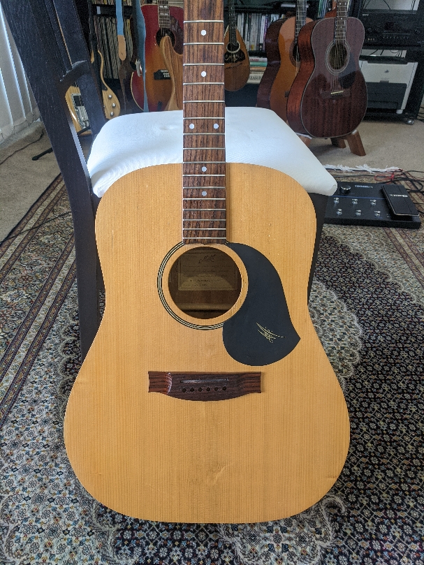

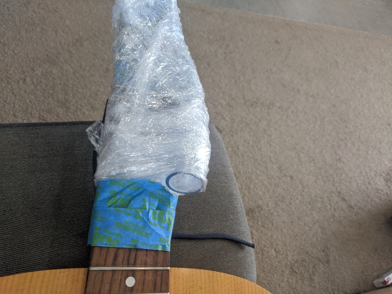

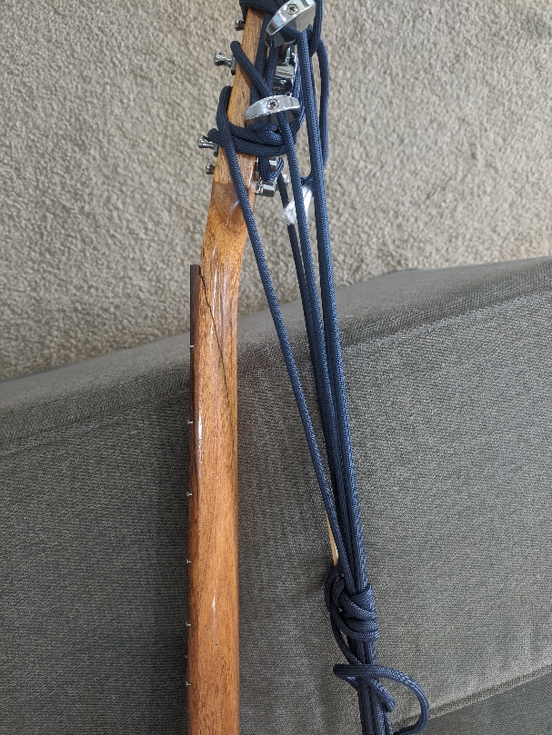

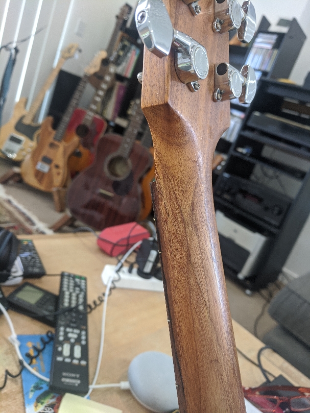

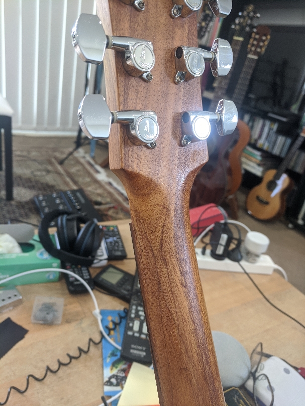

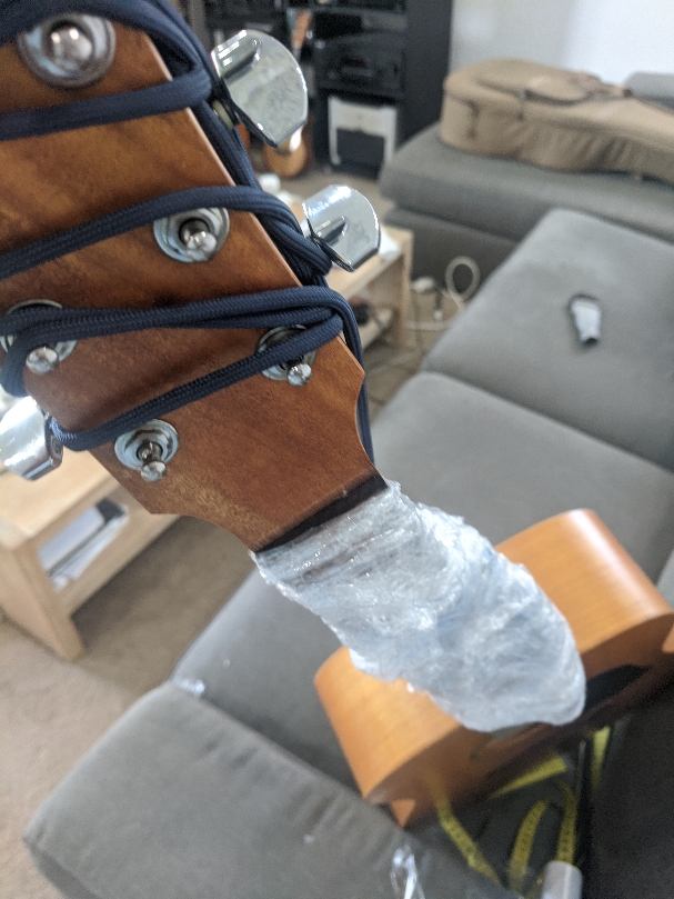

I returned the bad glue and used your advice and purchased titebond original I, the guitar arrived yesterday tuned with strings on, the crack was very thin and clean crack wich very hard to open, I used some parachute wire to pull the neck backwards to glue the crack. I read people use an air compressor to push the glue but I don't have an air compressor to use it to push the glue in the crack so I invented my reverse glue pull method and pull the glue with some plastic hoes and plastic food wrap. it worked perfectly and I inject 5ml glue while vacuum cleaner sucks the air and glue while stretching the crack. I clamped the neck for 2 houver4s and after that lightly sanded and used some leftover shellack to hide the sanding area. I have to say it turned better than what I thought and so far I'm very happy with the guitar. i don't know anything about this brand but it is made in Australia it's very light and smallish. even the saddle is 2/3 of the other guitars. again thanks for the advice.
