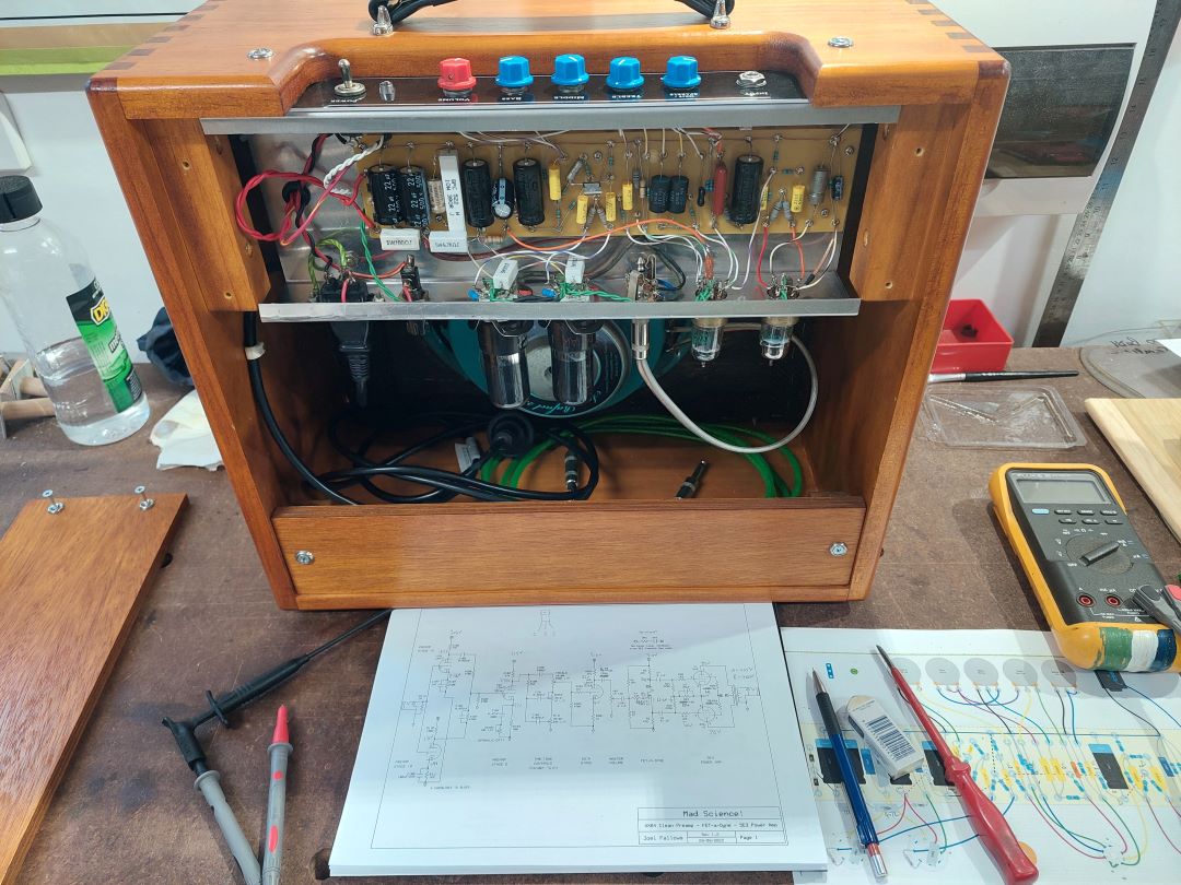

It's a 100% recycled junk box build. AX84 Clean Preamp mated to a MOSFET Cathodyne mated to a 6V6 cathode biased power amp (5E3 style). All the parts were recycled from previous builds or other salvage.

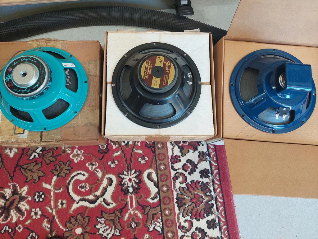

Last weekend I went to a repair shop shut down sale (just around the corner from Brisbane Guitar Making School!), and I scored a Fender 10" Alnico Blue speaker brand new in box for about $5! (along with some other choice bargains). The speaker I orginally used is a 10" Tone Tubby San Raphael hemp coned speaker. It's too dark for me. At the sale I also got a Fender V1030. Pic of speaker shootout attached.

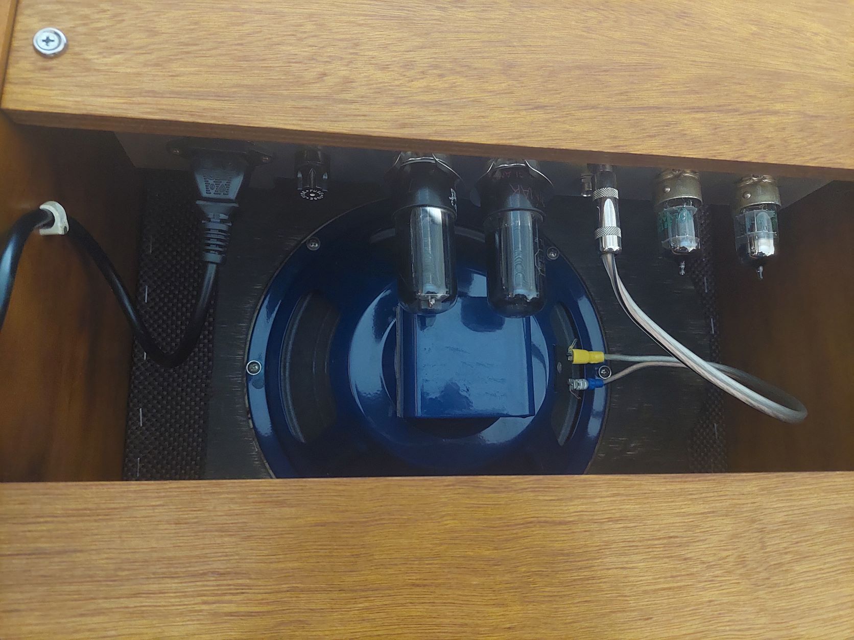

The 10" Alnico is awesome! The V1030 was an improvement, but that Alnico! So sweet! I now understand the love for Alnico speakers.

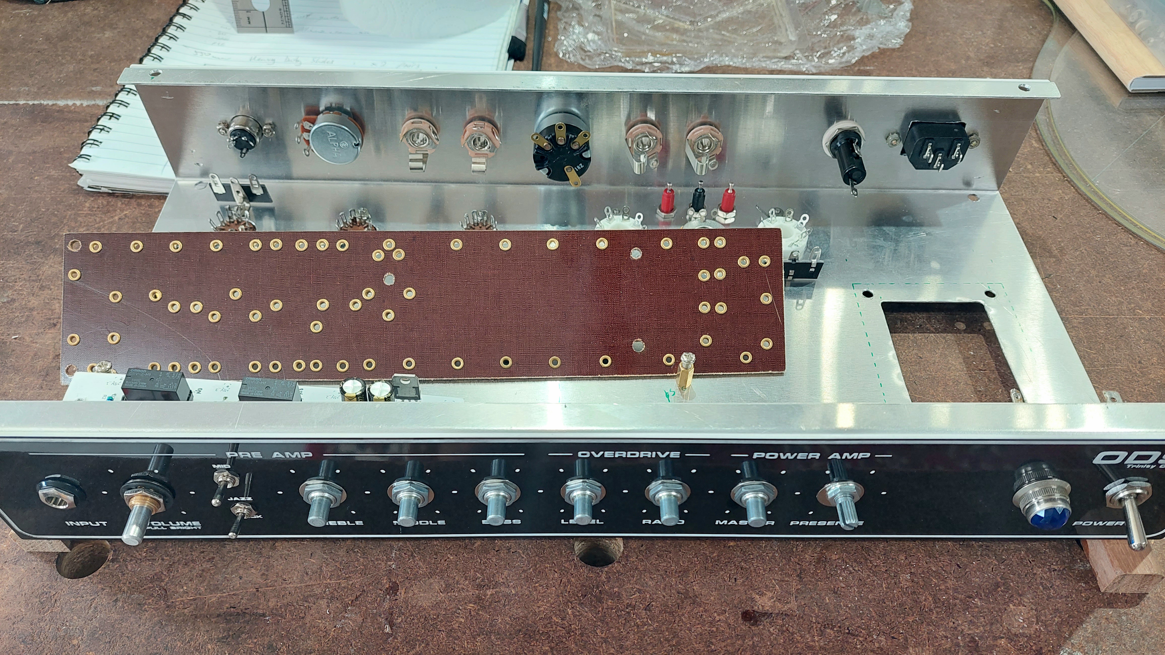

Sneak peak of the Dumble style ODS (Overdrive Supreme). This shot is test fit of the faceplates, pots, switches, etc. Making sure the eyelet board and relay board fit correctly. I'm a bit of a DIY tragic, everything is sourced or made from scratch. I bent up the chassis from some scrap aluminium at work. Designed the face- and back-panels. Eyelet board is scratch built as is the relay pcb, which I etched this weekend and soldered on the components.
