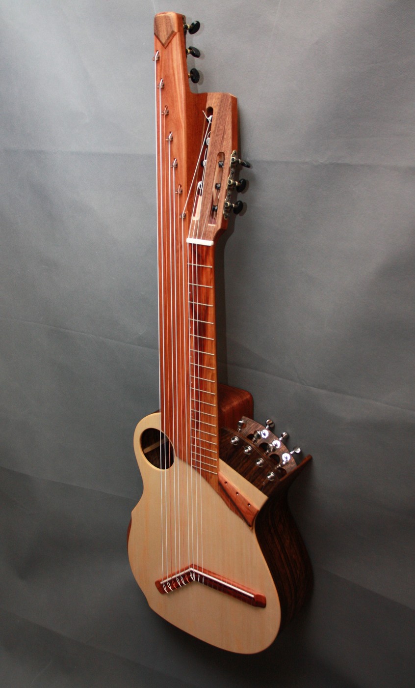

Hi, I'm Edi from Bavaria (Germany). I've been hobby guitar maker for about ten years now and I found this forum on a web research about falcate bracing. My interest lies in building stringed instruments of all kinds and sizes just for fun, from ukulele to harp guitar and sharing ideas and skills with other builders.
A little selection of my projets:
harp guitar - 20 strings

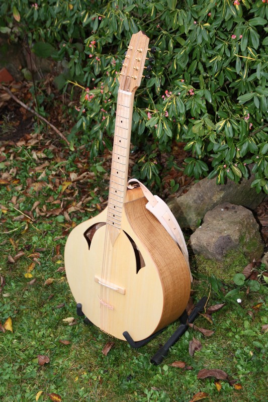

mandocello

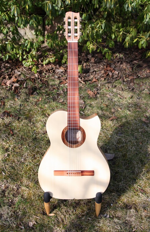

nylonstring

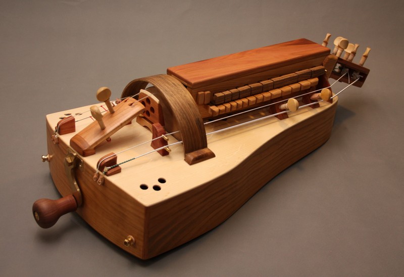

hurdy gurdy

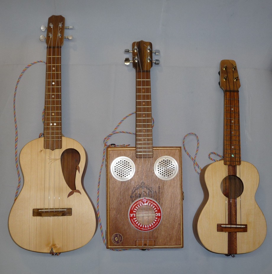

some ukes

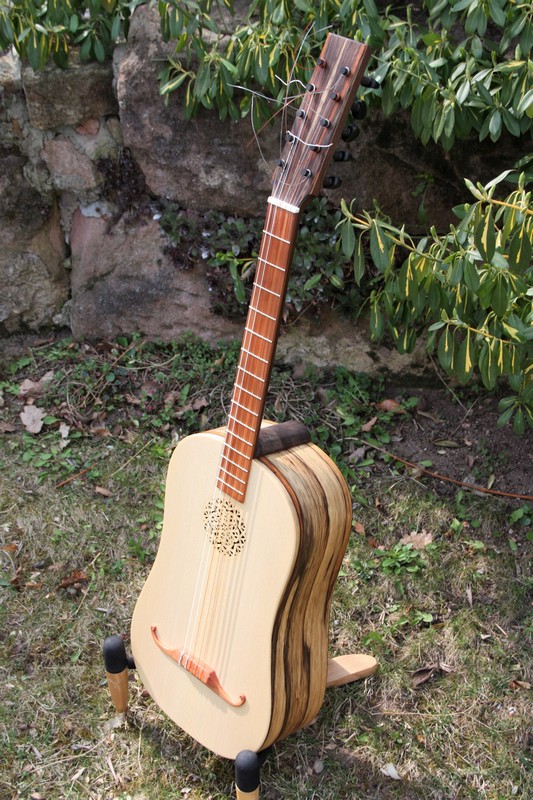

baroque guitar
harp guitar - 18 strings

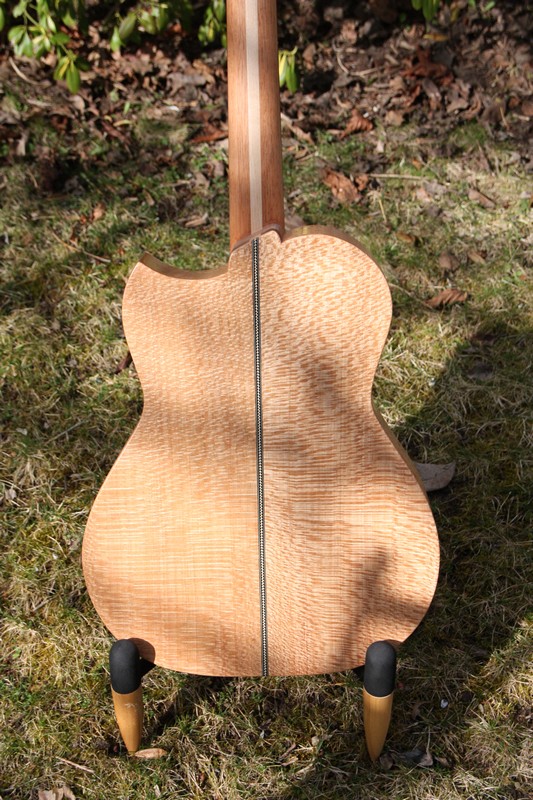

Some interesting work there Edi. I'm glad to see someone else building cutaway nylon strings. You have obviously thought through that curve across the centreline into the Florentine cutaway - vey interesting.

Hi Edi. Thanks for showing us your instruments and I am very impressed by your inventive and original designs. You obviously love designing and problem solving. I am interested in the harp guitars. And (like Dave said) I really like the curves in the cutaway design. Looks like some Australian timber in some of those too! There are lots of innovative ideas shared on this forum. We are definitely not stuck in the rut of building copies of 1930s Martins.

I like that smooth transition to the cutaway and it's not a big effort to build it like that. I adapt the heel to this design an make it flat.
Back an sides of this guitar are made of australian timber (Grevillea).

I once heard a serious player of the hurdygurdy at a musical event and was blown away by how musical they actually be in the right hands. They don't need to be the drone things that you so often hear. I wondered if you play it at all?

I'm not a hurdy gurdy player and i built that gurdy for a builders competition at the GBB-Forum. My skills are enough for a little demonstration of the possibilities of melody and drone strings by playing Amazing Grace and that's it. I' d like to play more on the hurdy gurdy but there is not enough time because among others some projects like the Arpeggione (Bowed guitar), Mohan Veena, Oud or Bajo Sexto and some more are still waiting on my long want-try-to-build-list.

Hi Edi. Thanks for showing that picture of the cutaway design from the back. It helps to understand what is going on. What sort of neck joint did you use? I am guessing it is a glued dovetail, with the back covering the end of the heel. Very interesting. I use bolt-on neck joints most of the time but I think I can imagine a way to fashion it with a bolted on heel, or to do a heel-less neck. I will check out your build pages for the harp guitars.

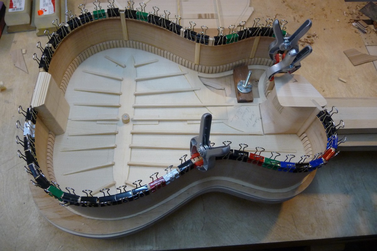

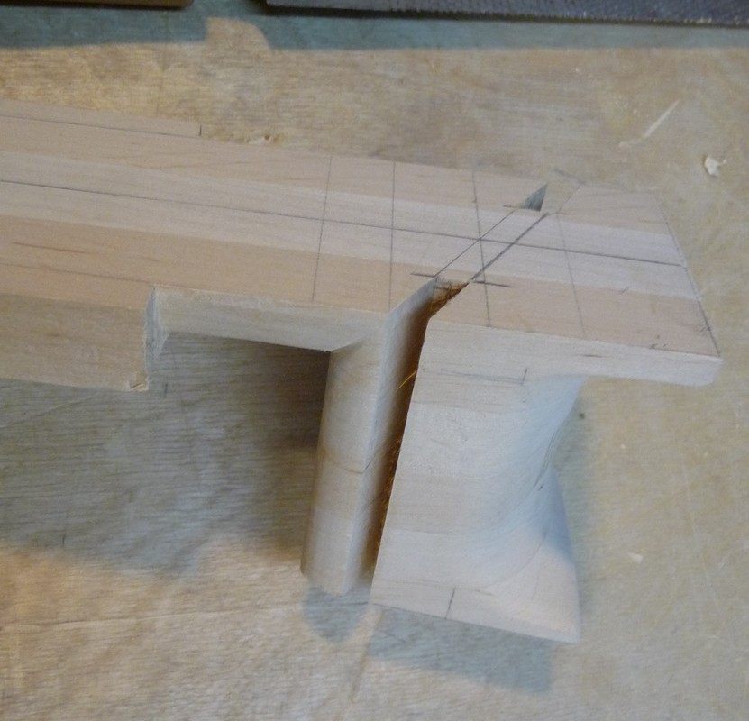

Hi Mark, I used a spanish one piece neck (like on most of my guitars). I love the spanish construction method and I even use ist for steelstring guitars.
Here I used it for a 3/4 classical childs guitar.
About Your solution for building the heel-less neck I'm curious.

Hi Edi, your work looks great. I really like the hurdy gurdy the most. I am wanting to build one and I got some plans recently, so I might have a couple questions for you if I get stuck. Also, very cool on the Spanish heel in the last post. I have never seen one at an angle like that. Nice job, and welcome.

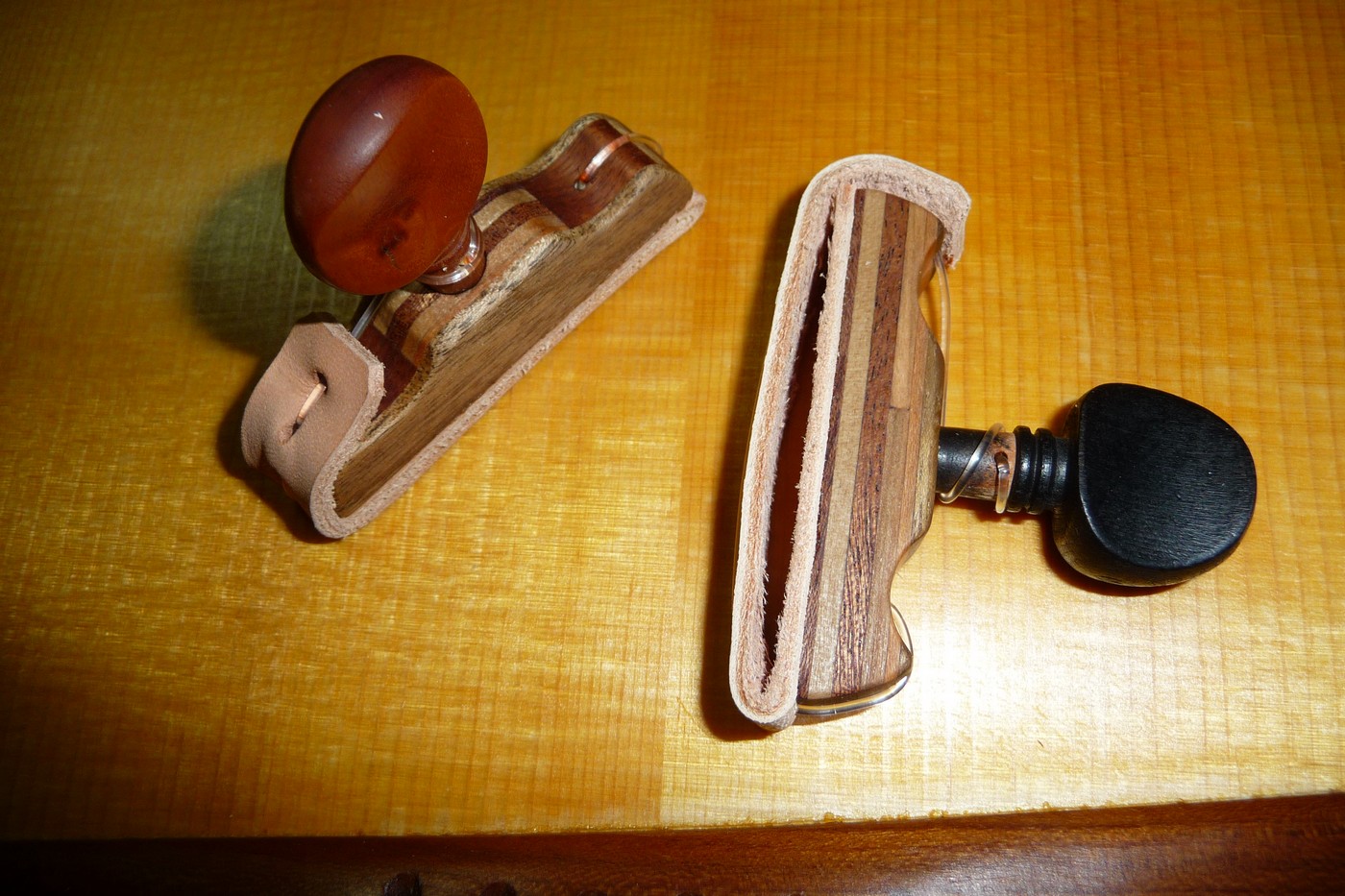

Also, i looked at your website and those wooden “stamp” capos are really cool. They look like that of the old world. I might try to make one. Thanks for the idea!

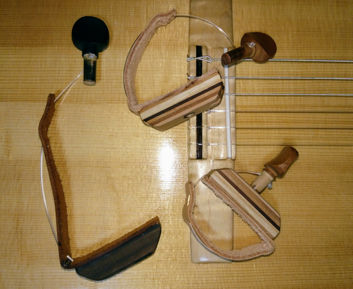

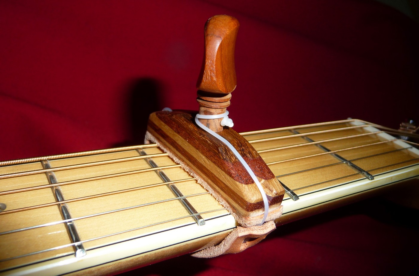

I'd be appreciated if I coud help You with the hurdy gurdy. The capos are a good option to use scrap tonewood. meanwhile i reworked the design so they look a bit more elegant.

How does those capoes work? Is that fishing line that is connecting the leather to the wooden tuning peg?
Re: Hello from Bavaria
Post by kiwigeo » Mon Apr 03, 2023 10:36 am
Yes you can see the nylon wrapped around the tuning peg.

It's not fishing line, it's a g nylon string. The string with the leather strap ist wrapped around the neck and tightened with the tuning peg. The leather just prevents the string from cutting into the neck.
