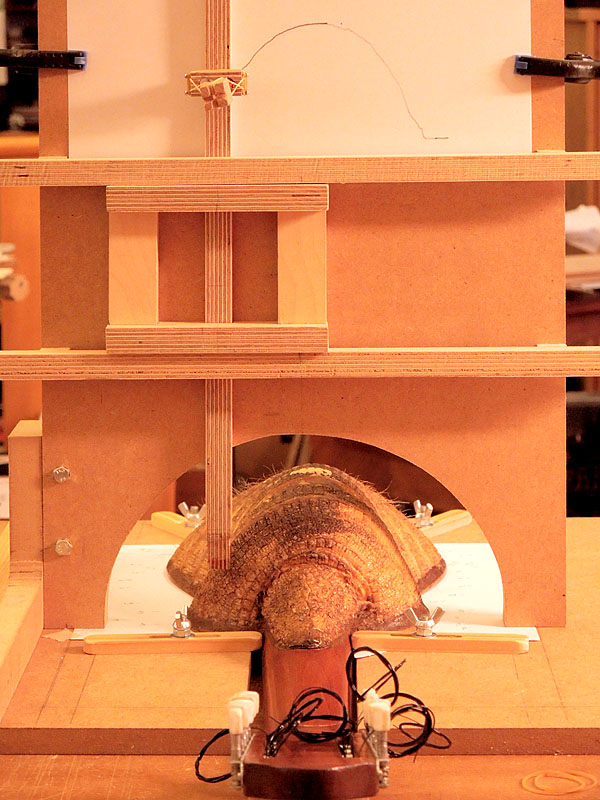

The drawings include two sheets containing a set of cross section outlines I drew with this apparatus:

Nick wrote:Nice technique for copying the section
On the first charango I drew a plan of I used this tool...
... which I had made using the idea of Stephen Barber and Sandy Harris (http://www.lutesandguitars.co.uk/ , picture of their apparatus halfway down the page). But its use was too tedious and slow for my taste, so I came up with something new which gets the job done in a fraction of the time required by the Barber-Harris tool and, as a bonus my own tool is not patented, so I could produce and sell it! :lol:
