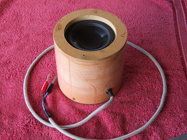

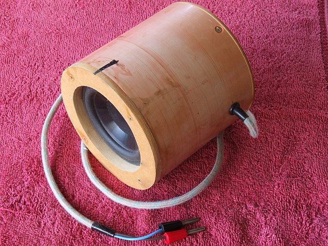

Thanks Trevor, would you be able to post a few pics of your speaker tube?

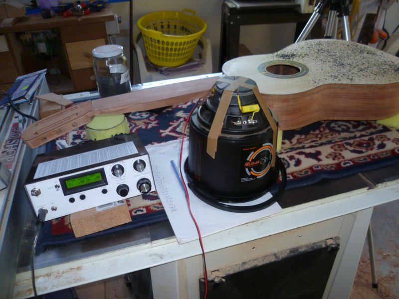

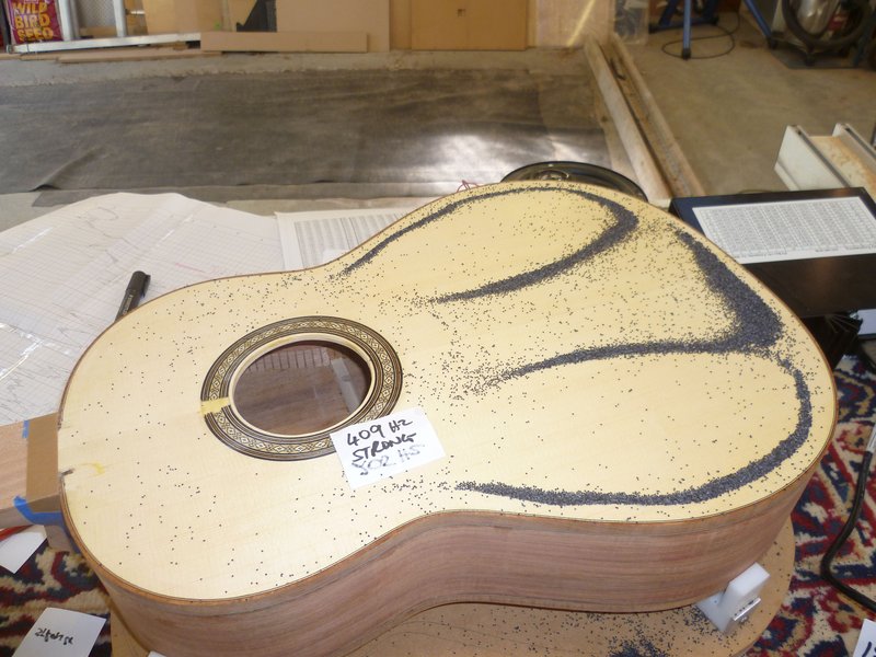

Post by kiwigeo » Sun Nov 11, 2012 9:58 am
Heres my set up. The speaker is a 50 watt unit I got from Jaycar running off a 50watt Bradley signal generator. I had the speaker taped to an old plastic bucket at the start but found I was getting quite acceptable results without the plastic bucket and now do testing with just the naked speaker.

Thanks, I have been just foolin around with the speaker naked on a braced top, I see you have to get the speaker position just right for each mode. I would wonder if Trevor gets more output with his setup.
kiwigeo wrote:Heres my set up. The speaker is a 50 watt unit I got from Jaycar running off a 50watt Bradley signal generator. I had the speaker taped to an old plastic bucket at the start but found I was getting quite acceptable results without the plastic bucket and now do testing with just the naked speaker.

Pics of speaker as requested. I use a 15 watt amp.
Top side.jpg (156.22 KiB) Viewed 16105 times

ScottC. wrote:Thanks, I have been just foolin around with the speaker naked on a braced top, I see you have to get the speaker position just right for each mode. I would wonder if Trevor gets more output with his setup.
I find it doesn't take much time to find the "sweet spot" for each mode. The monopoles and dipoles are easy, some of the more complex modes in the higher frequencies can require moving the speaker over the top and exciting several areas of same. After a couple of sessions "playing around" you soon get the hang of it. By then the neighbour will be knocking on your workshop door wanting to see the alien spaceship :mrgreen:

Thanks for the pics, pics help me a lot! Do you find it to work better than an open speaker?
Scott C.
trevtheshed wrote:Pics of speaker as requested. I use a 15 watt amp.

Trevor Gore
Posts: 1643
Re: Speaker
Post by Trevor Gore » Mon Nov 12, 2012 9:05 am
ScottC. wrote:Do you find it to work better than an open speaker?
I've always used this arrangement, so I have no extensive comparison. I've always been able to get good patterns using a fraction of my 15 watts. I think you get less ambient noise with the enclosed back, but as I said, not much comparative experience. I've always been concerned about all the sharp edges of an unenclosed speaker chassis, giving a high risk of dings etc. That reason alone is sufficient for me to use some sort of enclosure.
