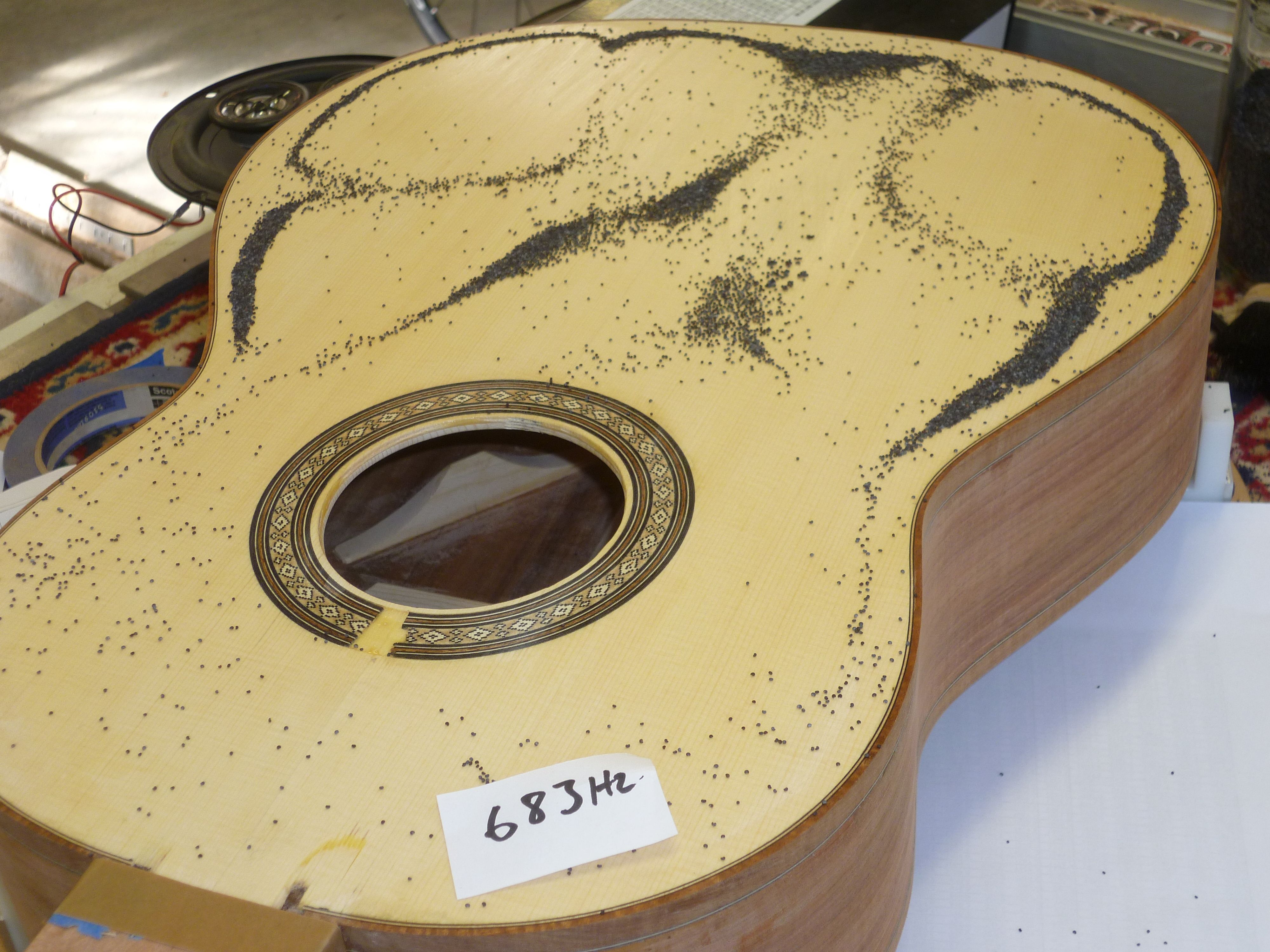

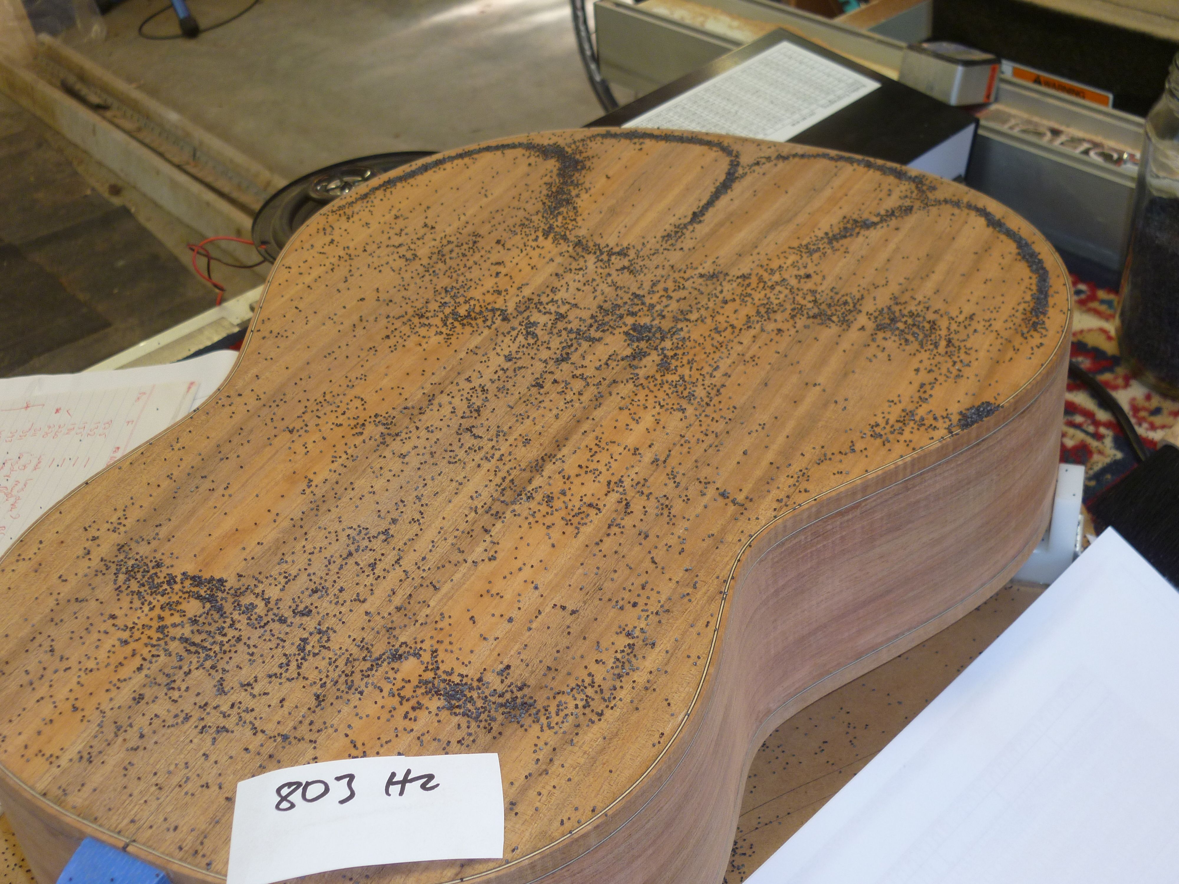

Two interesting Chladni patterns I snapped while doing tests on my falcate braced classical. At higher frequencies the nodes seem to follow the bracing more than at lower frequencies. Any idea what youd call the modes in the photos below?

Punch and Judy?
There are endless shape permutations as you go higher up the frequency range, many of which are difficult to categorise under the usual nomenclature systems, and some that you'll never see again. A generic name I've heard is multi-lobe modes.

The top one reminds me of one of your equations.......therefore I shall call this mode "Trevor".

The other mode is on the backside of the guitar so I shall name it.......Kim. :mrgreen:

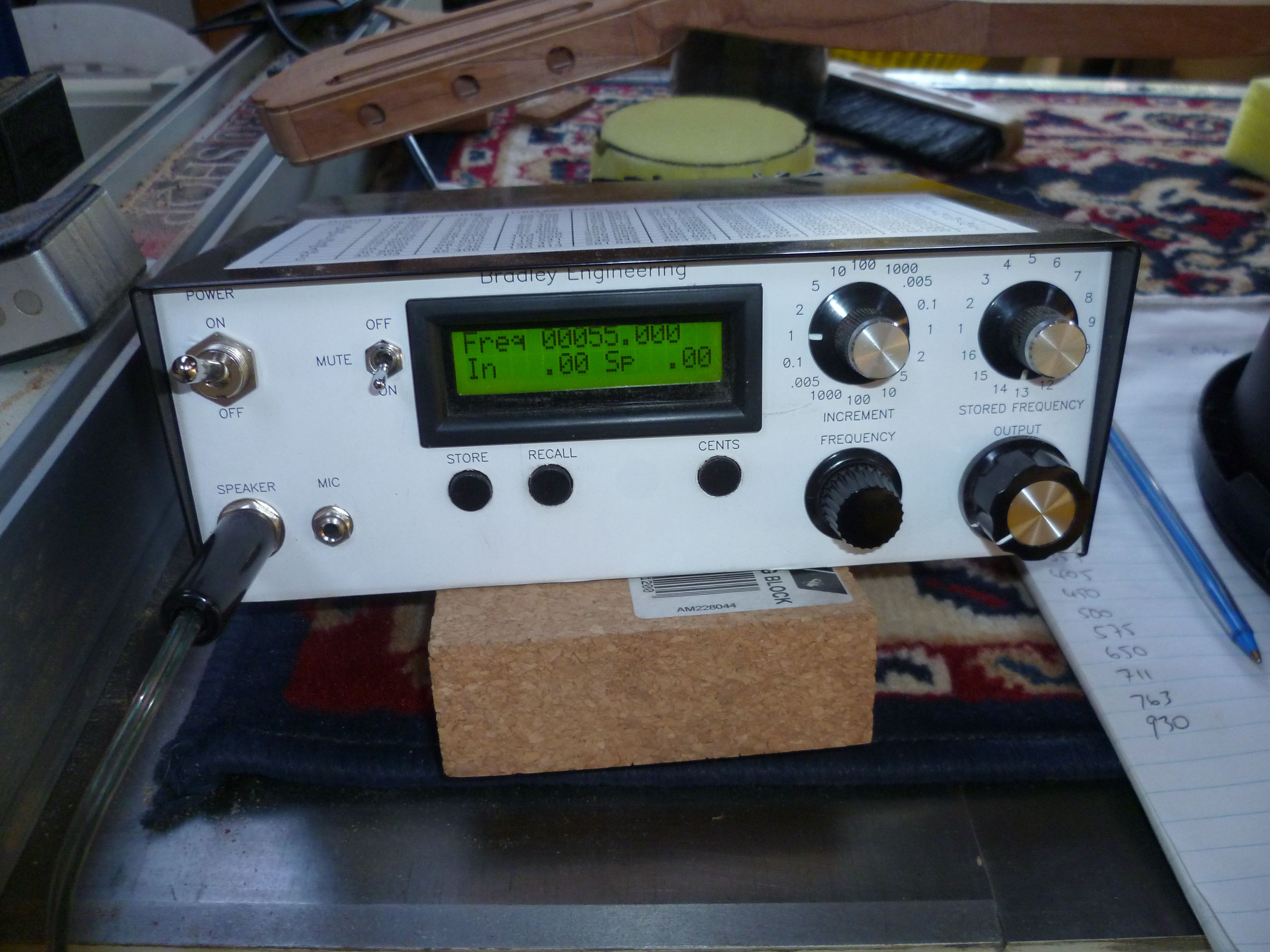

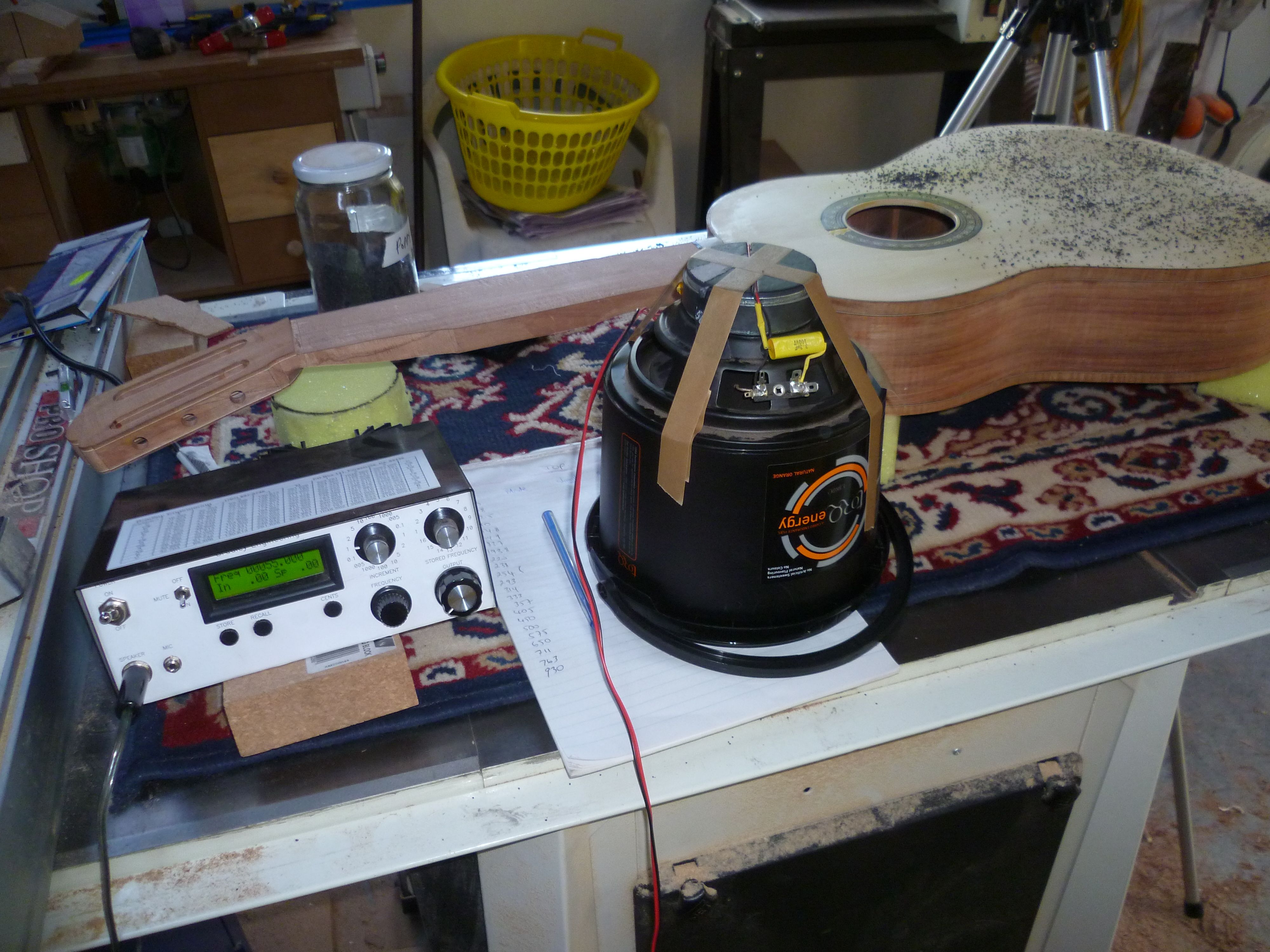

Nice set up to get such clean lines at those high frequencies Marty. I wonder if there is a frequency that would outline all the braces?. You got a ubeaut analogue one from that guy didn't you? My sig gen works great but I only have a shitty little component amp and need something cleaner and more powerful.

Yes there was one mode I got that pretty much outlined all the top bracing quite nicely. The signal generator is a Bradley I got from the US. Its got a 50 watt amp built in and Im using a fairly large speaker as well.
