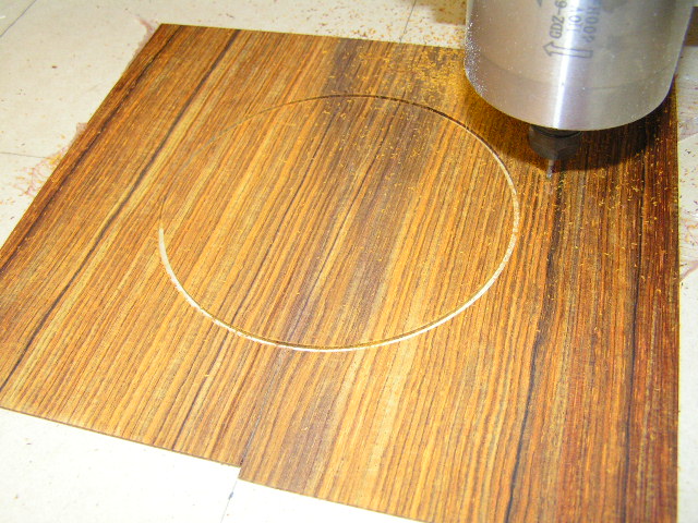

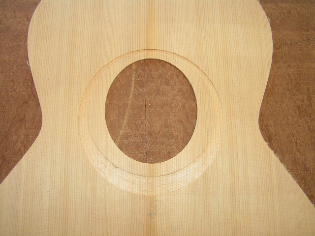

Hmm interesting concept the hose analogy!!!
I have a new small cnc that opens up a lot of new possibilities in soundhole shape...here is a practice soundboard I was playing with and got me to thinking about the shape, seems to me that as long as the area is the same it should be ok, but I am no engineer and consult the "books" on most everything I have a question with, and altering the shape definitely opens up new aesthetic ideas!!!!
