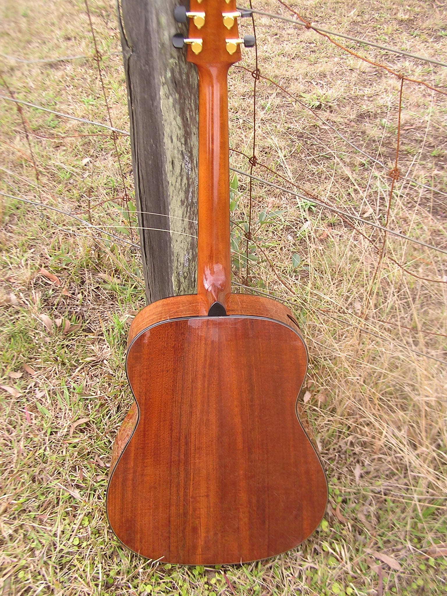

Post by DarwinStrings » Sat Aug 02, 2014 4:48 pm
Nice look Leonhard.
"Rose Cliche"
My second guitar since buying the books (9th guitar). My first live back guitar so I was trying to achieve that and get a grip on modal tuning. Very happy with the build especially getting the T(1,1)1, T(1,1)2 and T(1,1)3 into the suggested relationships and in between scale notes. Also very happy with the sound of the guitar though I also know from building it that I have room for improvement, so on to the next happy in the knowledge that I am getting some control.

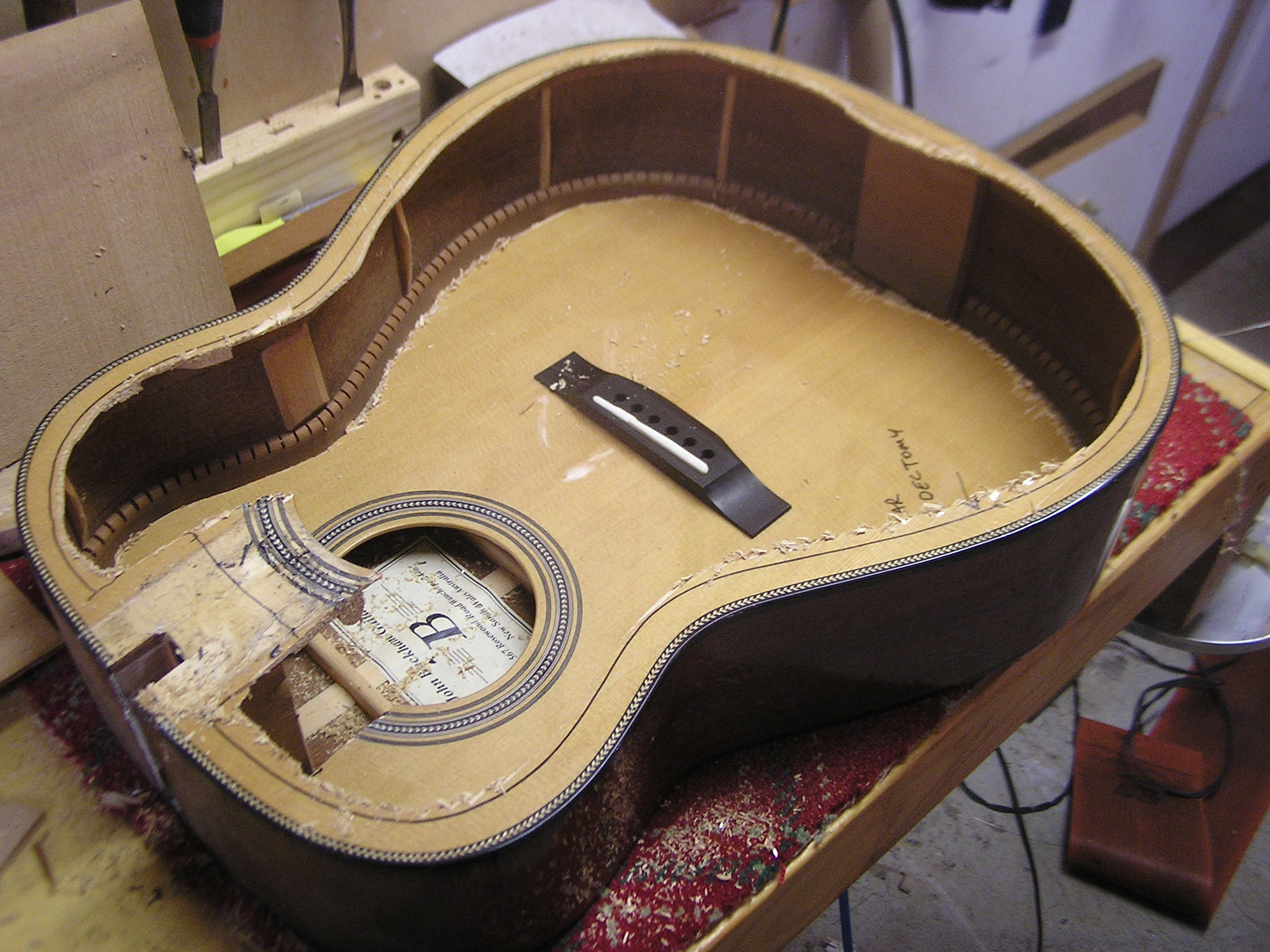

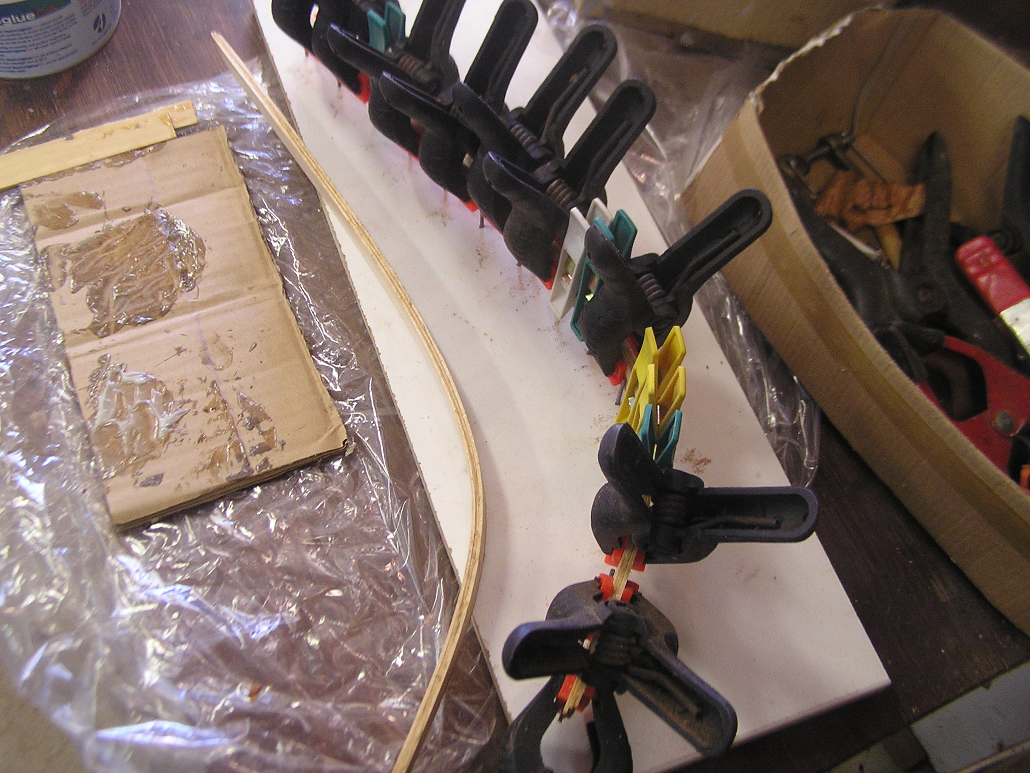

Post by woodrat » Wed Aug 27, 2014 5:24 pm
Hi All, I have just finished this guitar for a customer called Adrian so it is called Adrian's Baritone. It is a 13 fret Mahogany and Cedar Falcate with a sound port. It is the first baritone that I have made and I was pleasantly surprised with the lush sound that emanates from it. It is a 27 inch scale tuned to BEADF#B. The strings are massive bits of wire when compared to normal 12-53 guitar strings.
This guitar started out as a Sitka and Mahogany Dread that I built long before I read "the book" and I was never quite happy with the sound of it....So I used that as the basis for this build...a retop and a new neck later and here it is...
Leonhard
Posts: 2
Joined: Thu Jul 31, 2014 4:06 pm
Location: Germany
Re: Gallery of "Book" builds
Post by Leonhard » Fri Aug 29, 2014 9:23 pm
Woodrat,
that is a very interesting way to re-do a not so good guitar.
And the result of this work looks interesting as well.
Did you also replace the back bracing?
Regards,
Leonhard

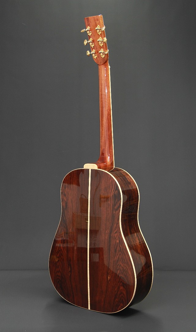

Post by Munchkin » Mon Sep 01, 2014 10:09 pm

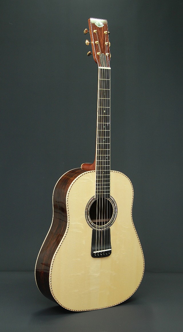

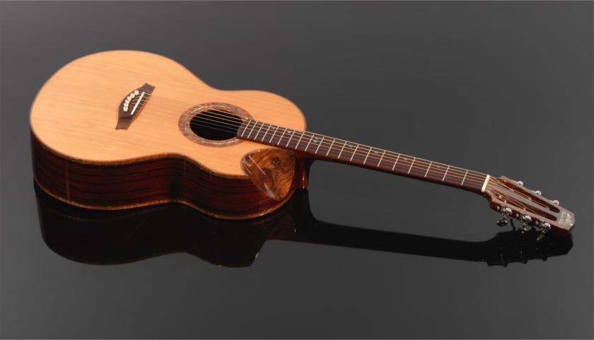

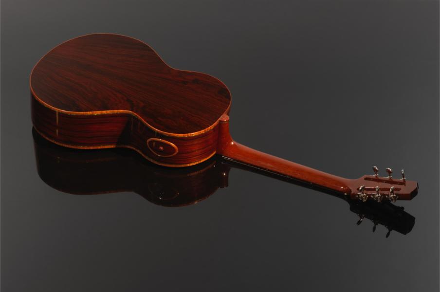

Trevor suggested I post some pictures of my latest build here. I have been inspired by 'the book' and it has made a huge difference to the quality and, most importantly, the tone of my builds. This parlour size guitar was designed with my customer involved at every step, which was inspiring. I don't like the look of conventional parlour guitars so we went for a 13th fret body join which balanced the design nicely (I hope you'll agree!). The spacing at the nut is quite wide so the string spread to the saddle is subtle - a nice finger picker but the real surprise has been the volume and tone when strummed - almost a 12 string sound.
The top is WRC with X bracing, fingerboard, back and sides cocobolo (never again...), mahogany neck and marbled english walnut scoop cutaway, koa binding with green celluloid purfling, scottish burr elm rosette with paua ring. I had to bolt 400 grams to tune the body, so she's heavy, but I think that's where the projection comes from! I managed to get the bridge (coco/walnut laminate) down to 22 grams which is also a factor.
The photos are by Tony Hutchings, http://www.tonyhutchings.co.uk/ a real pro, friend and guitar enthusiast. And the polyester finish was applied by Phil McAllister http://www.spectrumguitarfinishes.co.uk/ Thanks for making the guitar look even better!

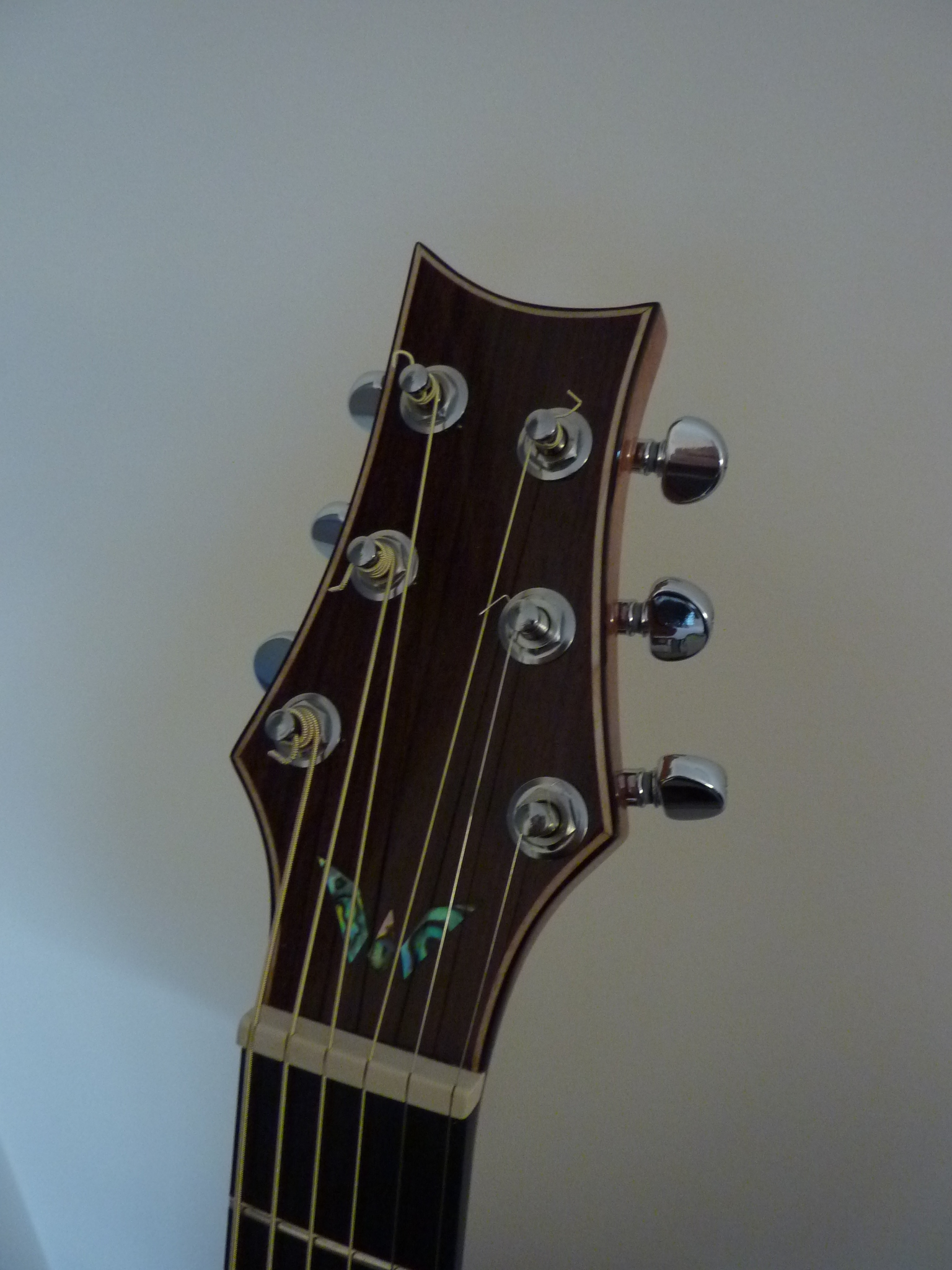

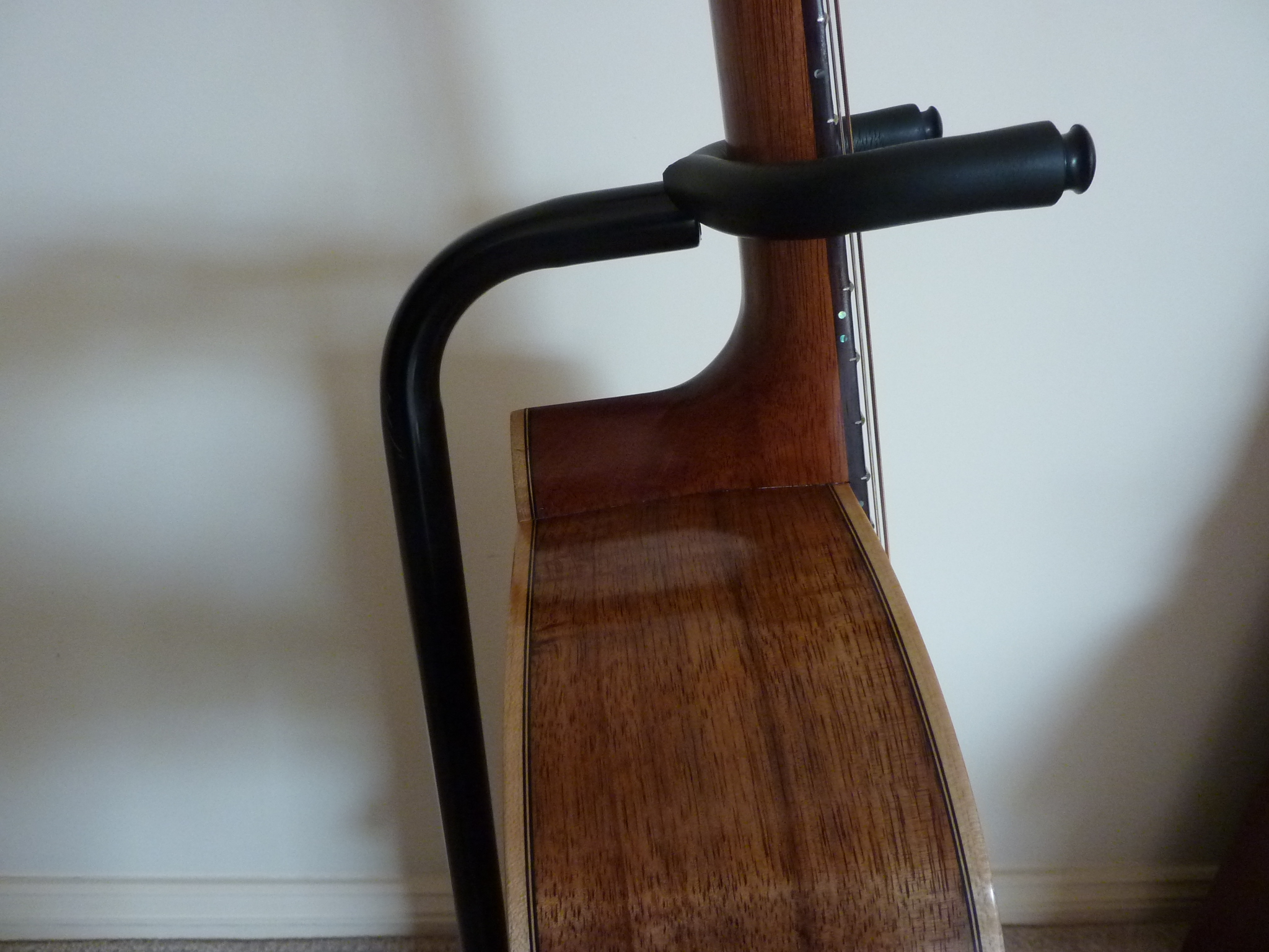

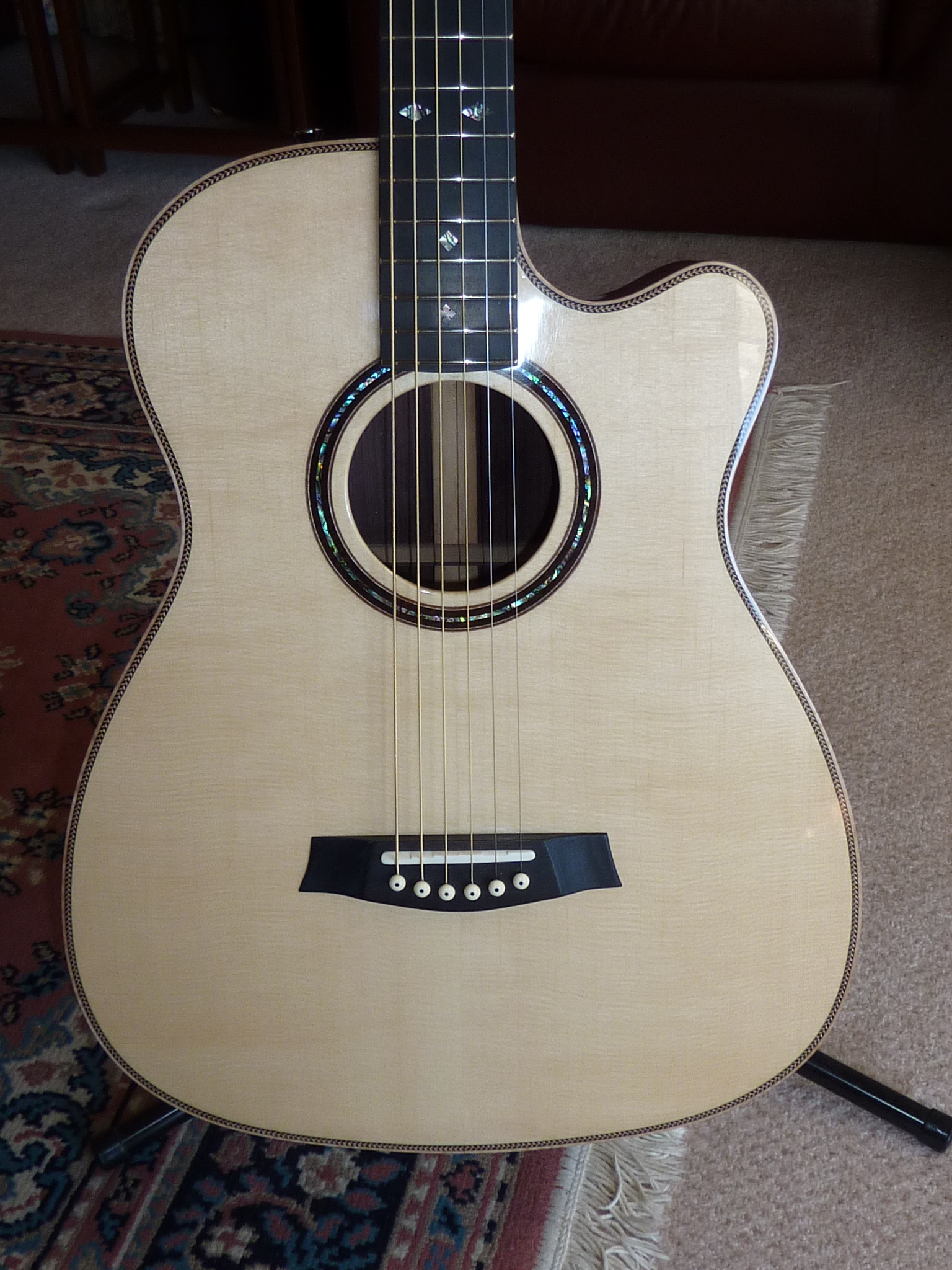

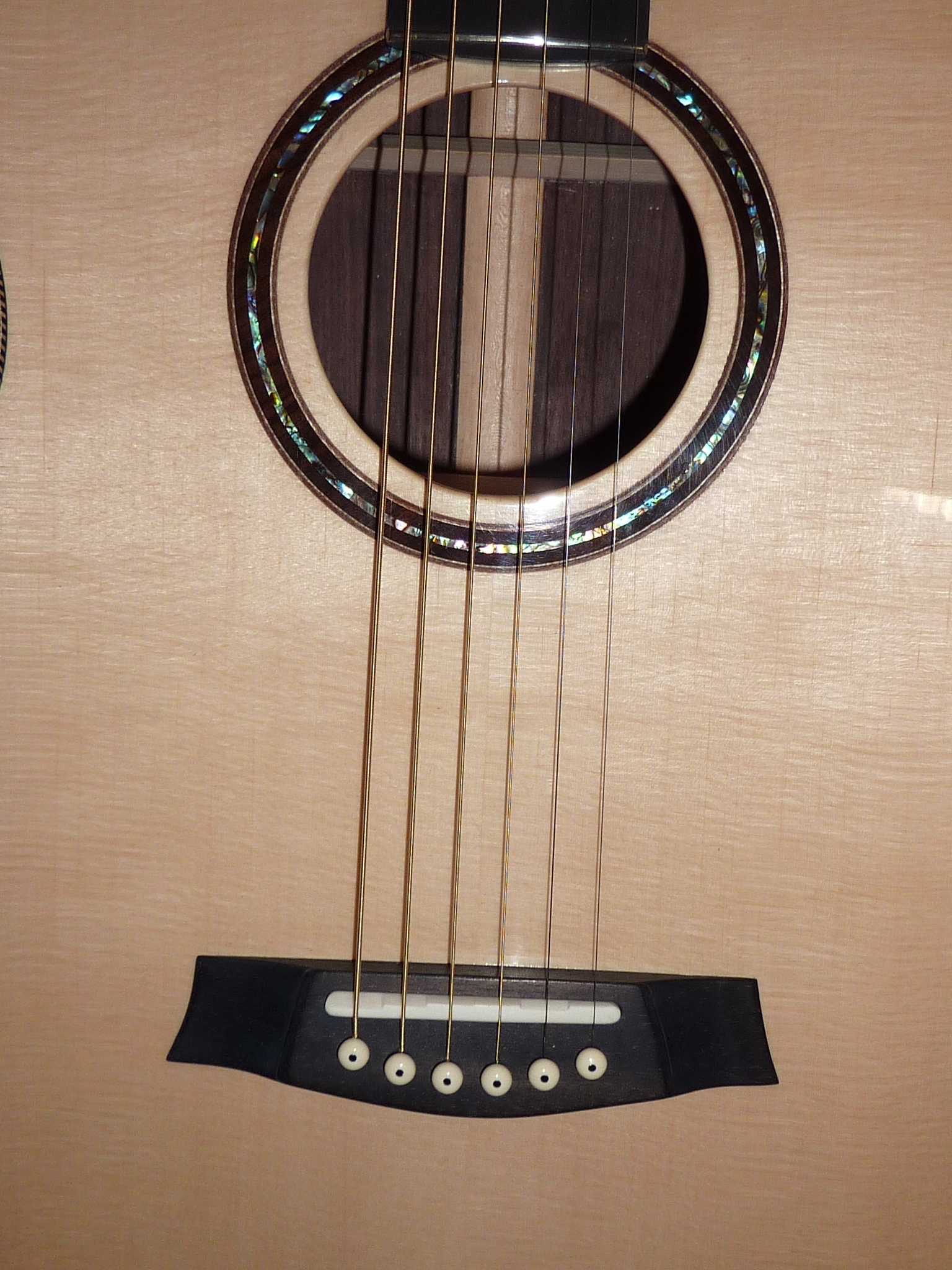

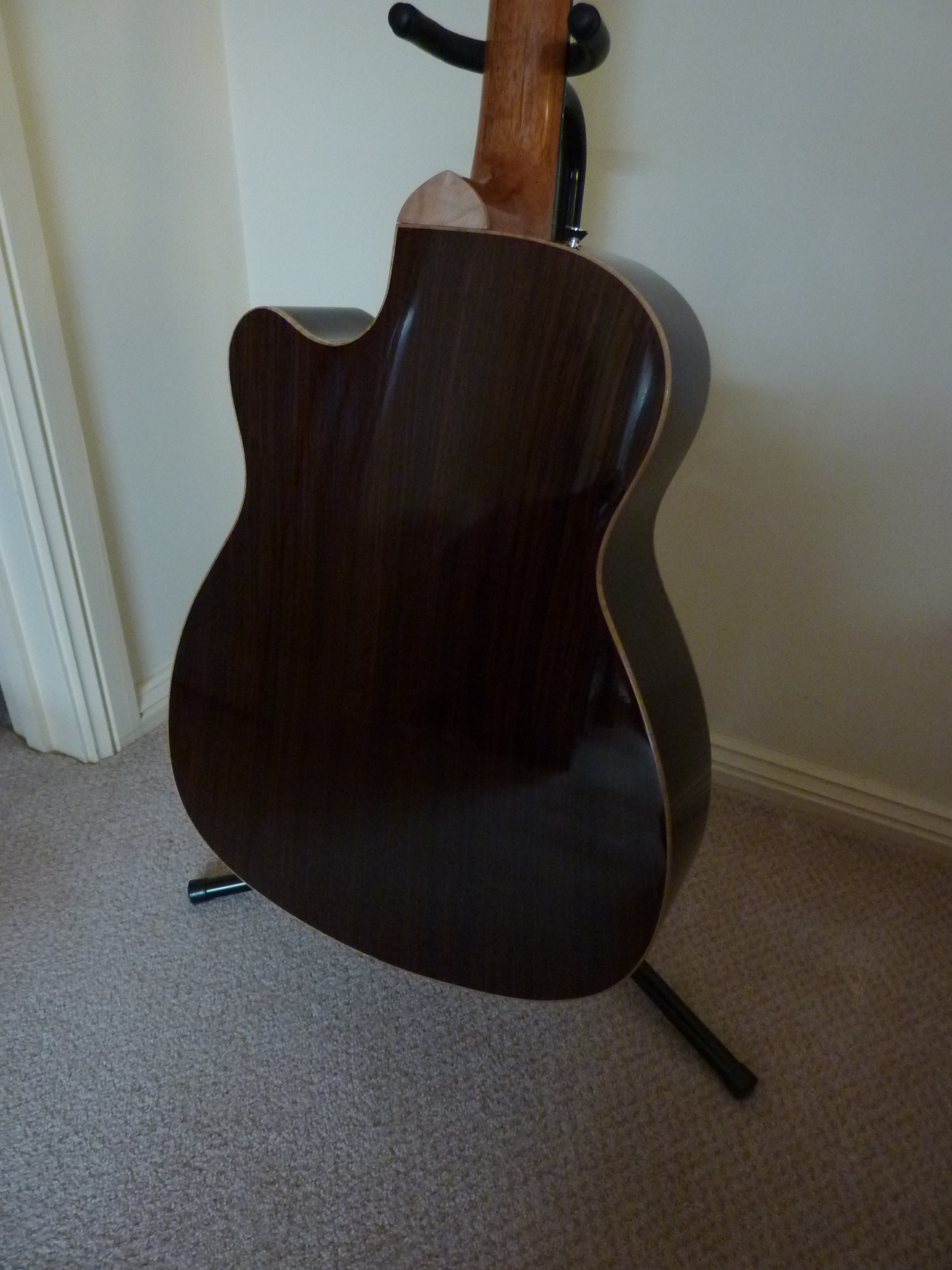

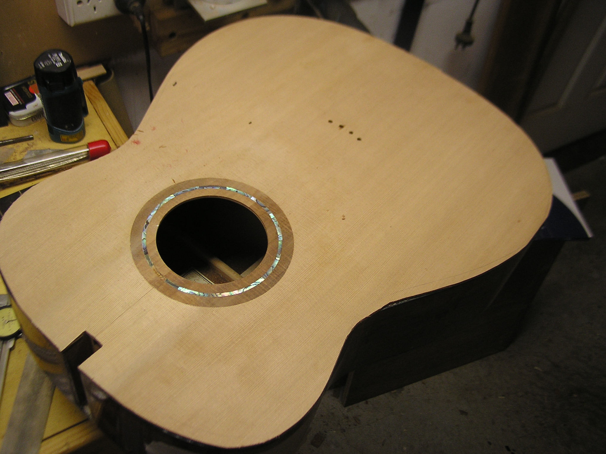

Post by Woodsy23 » Sat Jul 04, 2015 5:03 pm
Well, after the posts above displaying some stunning builds by professional and semi-professional guitar builders, here's one from a hobby builder. I started building electrics in about 2007 and only recently started building acoustics after buying the books. This post is about my second build, basically the falcate steel string from the plans in the book with some changes to the shape of the horn at the cutaway, to make the radius larger, and minor changes to the shape of the upper bout, hopefully to suit the changed horn. My first acoustic build was a 12 string and I'll post some pictures of that next.
Thanks to everyone on the forum who helped me. There are many that assisted through various threads, even if they do not know it.
Basic details:
Top : Engelmann Spruce
Back and Sides & headstock overlay: East Indian Rosewood
Neck : Honduran Mahogany
Fretboard : Ebony
Bracing : Sitka spruce (Carbon fibre reinforced)
Head and tail blocks : Queensland maple
Binding: Maple (ready made)
Purfling : Herringbone
Bridge : Wallnut (CF reinforced and ebonised. Linseed oil finish – thanks John Parchem for the tip)
Rosette : Cheap ready-made one from China. (I’ll make my own next time)
Nut & Saddle : Tusq
Pickups : K&K Pure mini
Finish : Nitrocellulose lacquer
Most of the wood came from Guitar Woods (Gilet). Thanks Daryl.
I did the Bolt-on Bolt-off neck and the carbon fibre laminated bridge, exactly as in the book. The curved braces in sitka spruce didn’t present any major problems for me during bending. I made the braces a tad shallower (6.8mm) because the sitka is stiffer than KW pine. I didn’t use carbon fibre reinforcing on the UTB or minor braces, only on the curved braces and the side braces (that is, only the braces that are highly stressed).
The only other departure from the method and sequence in the book is that I routed the mortice in the head block before gluing the block to the sides.
I did a fully compensated saddle but used a constant 1.2mm compensation at the nut. An additional benefit of using a 5mm thick compensated saddle is that you are not totally dependent on achieving perfect saddle placement. In placing the saddle, I ignored the 0.5mm shortening due to compression of the wood under string tension. When it came to measuring the string end position for the top E string on the saddle, it was 0.2mm from the front. Had I set the saddle back 0.5mm further, I would not have been able to achieve the correct length.
Here's some pictures.
This post viewtopic.php?f=33&t=6706 is about measuring the resonant frequencies, monopole mobility and bridge rotation.

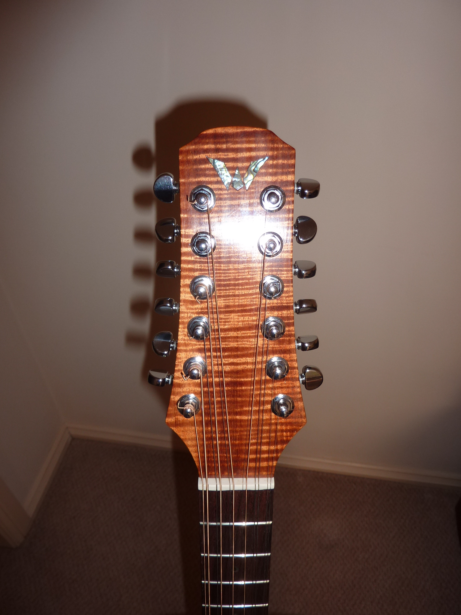

Post by Woodsy23 » Sun Jul 05, 2015 8:52 pm

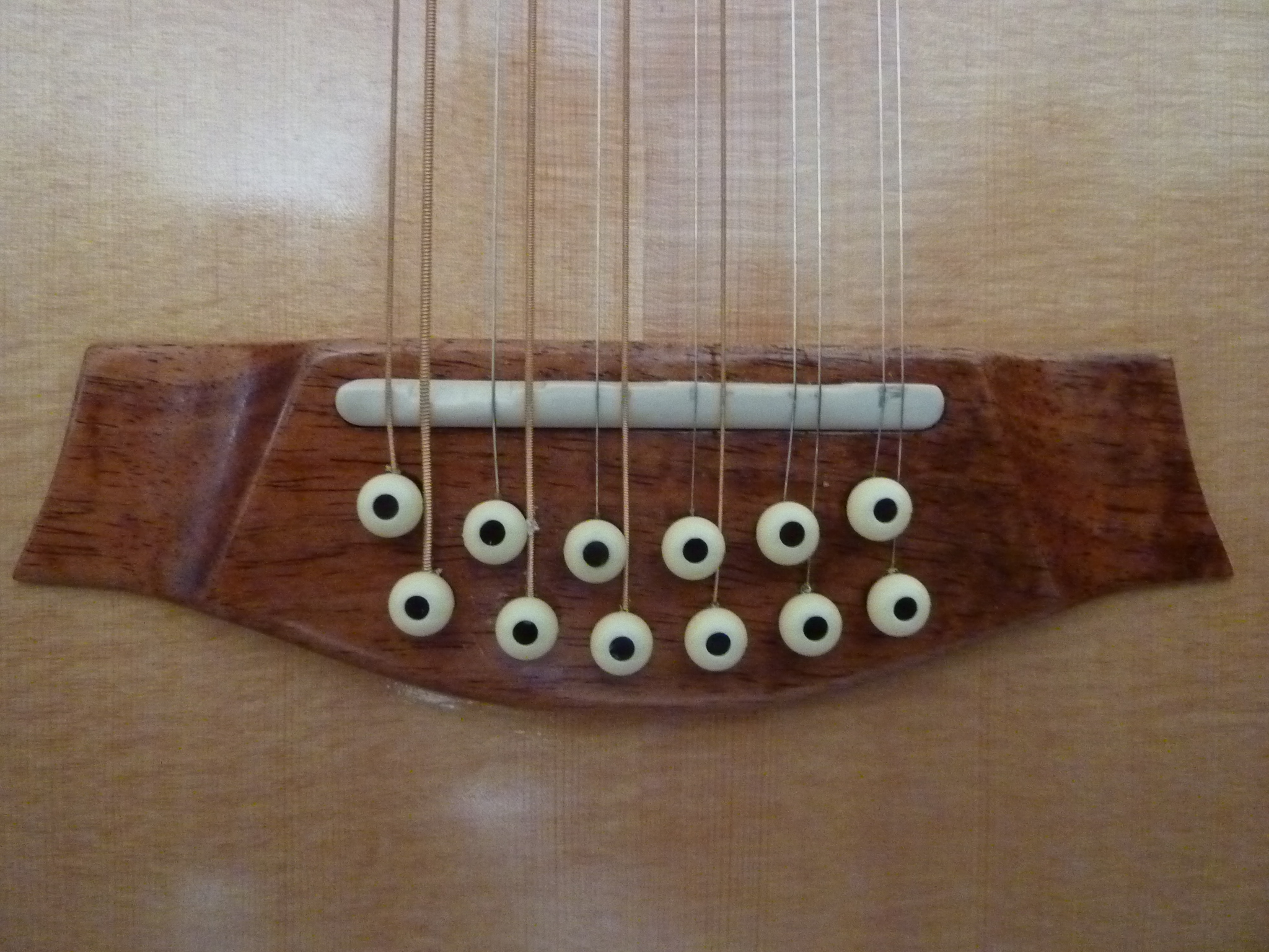

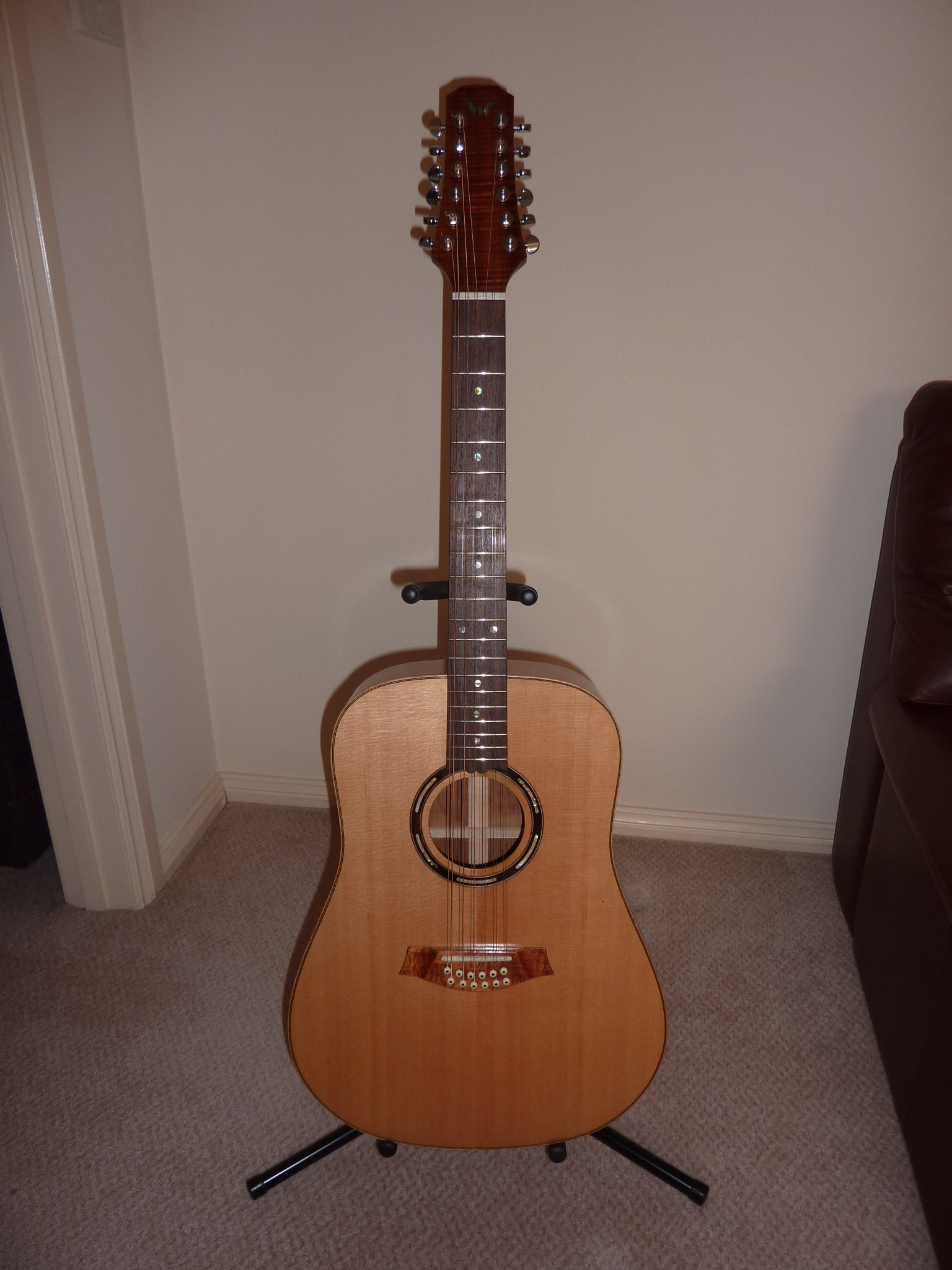

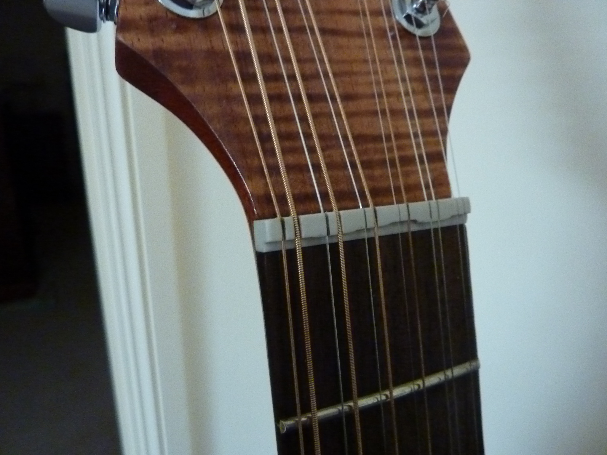

Here is the 12 string that was my first acoustic build. I started with plans of a Martin D12/28 from Ultimate Guitar Online but, after getting the books, I adapted the book plan of the J45 to the Martin body shape. The main change I made was to the top bracing. I made the X braces basically rectangular in section, 15mm high x 6.5mm wide and I made the sound hole braces and upper face braces a little taller.
Basic details:
Top : Sitka Spruce
Back and Sides & headstock overlay: Tasmanian Blackwood
Fretboard : Rosewood
Bridge : Tasmanian Blackwood
Nut & Saddle : Tusq
Pickups : K&K Pure 12 String
Finish : Liberon Finishing Oil
I did the Bolt-on Bolt-off neck and I routed the mortice in the head block before gluing it in place. I did a fully compensated saddle and an almost fully compensated nut (used the same compensation for both strings in each pair).
This post viewtopic.php?f=33&t=6706 is about measuring the resonant frequencies and monopole mobility.

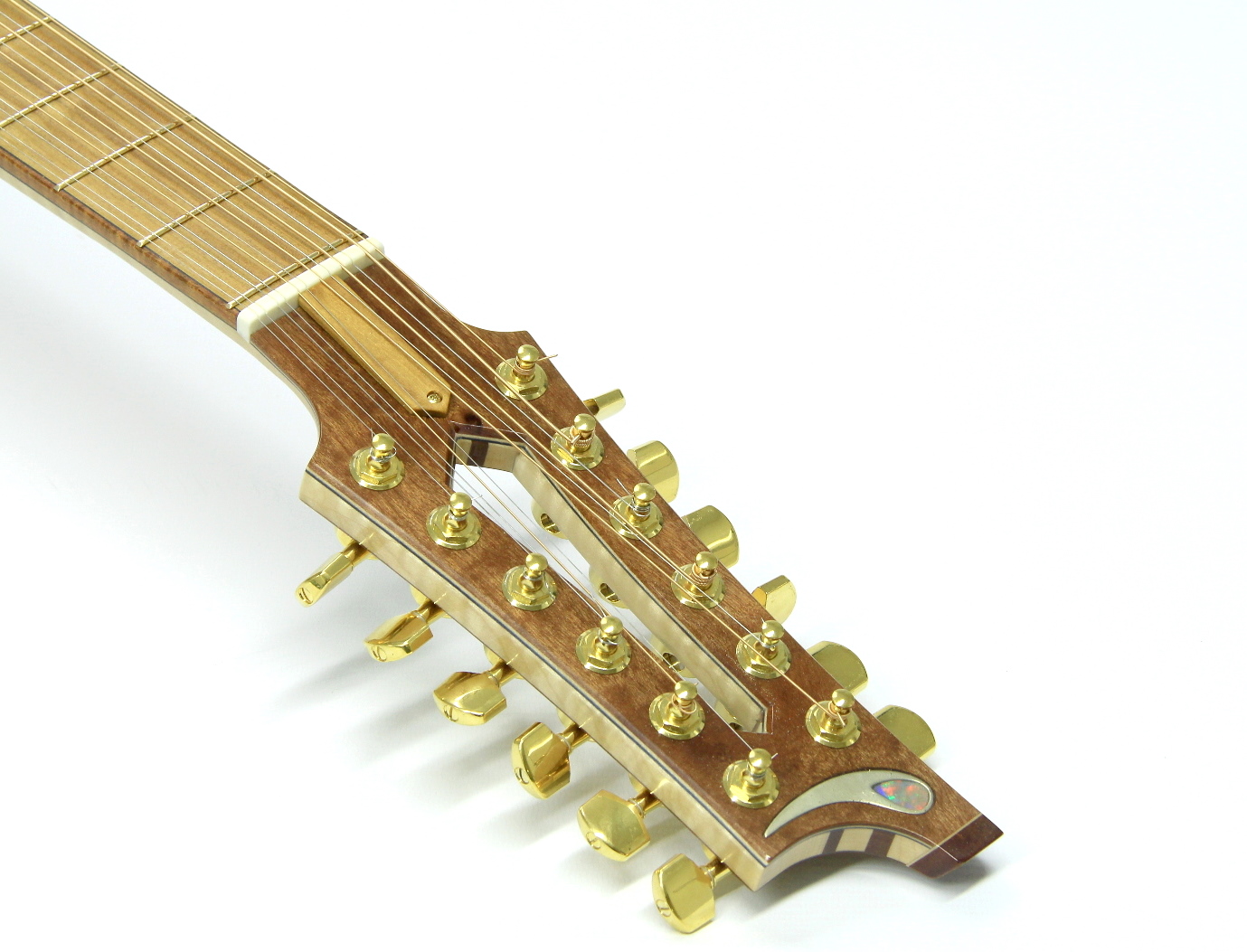

Post by johnparchem » Mon Aug 08, 2016 10:16 am

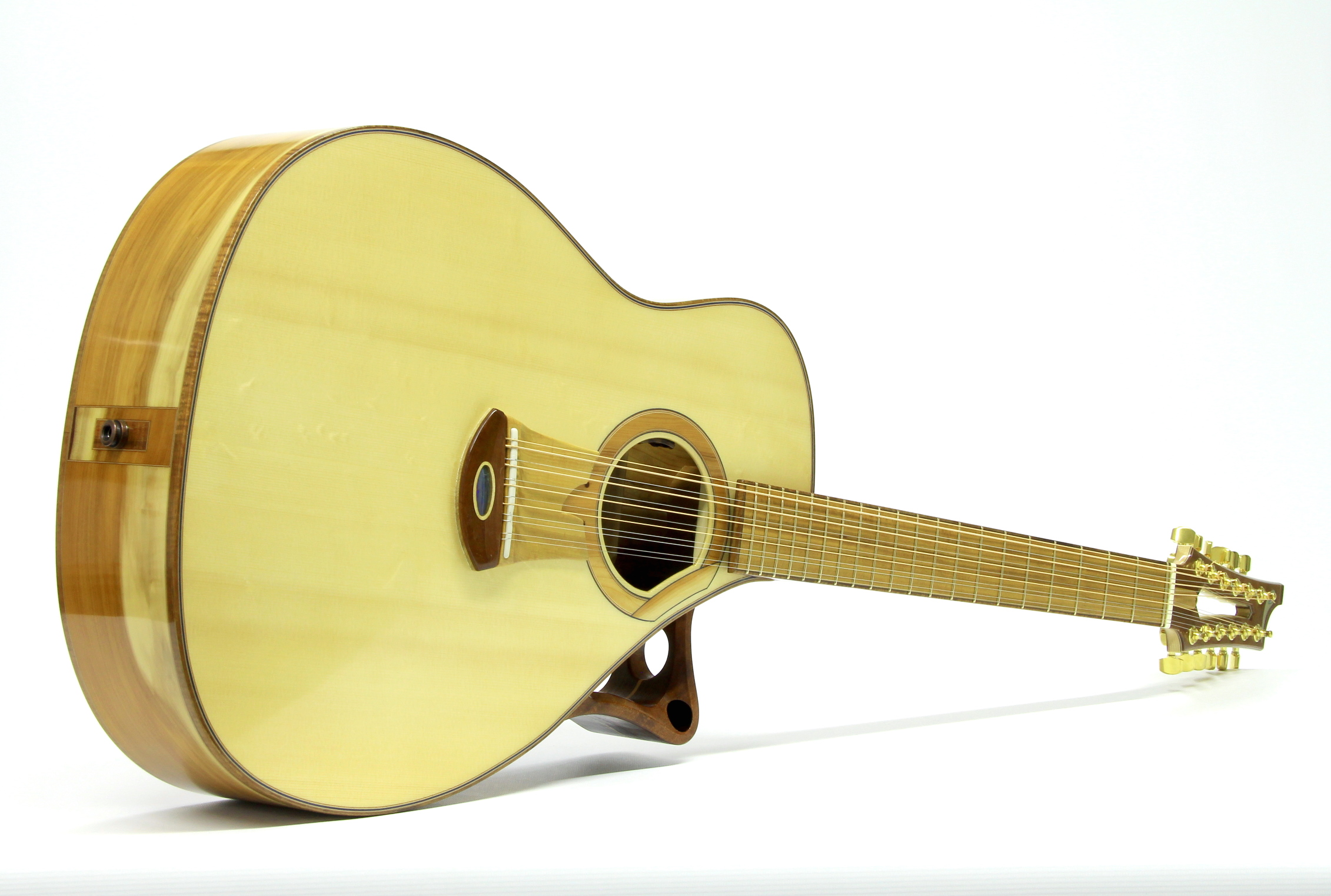

Ziricote\Spruce 12 string falcate.
I built this as a commission, although I told the client that it was an experimental build as it was my first 12 string. I did use a lot of information from the Gore\Gilet books including the bracing pattern and bolt on\off neck design. The body is the Gore medium size steel string. I followed a tutorial from Craig Lawrence for the 2 string per pin bridge. Richard Woods (Woodsy23) modified and ran an existing Finite Element (FE) model he had, for 12 strings load, both light and medium (EJ38s and EJ39s). He determined I would need to increase the height of the falcate braces to 10 mm for the EJ38s and 11 mm for the EJ39s. I ended up with 10.5 mm as I wanted to limit the monopole frequency of the top to keep it in the typical SS range. I ended with 175 Hz top frequency (that I may work to lower to 170 Hz). I have a spectrum analysis with strings at the bottom of this post. I did not measure the bridge rotation under load, but it looks good to my eyes.
My SS guitar instructor played it and the guitar sound great. I set up a recording session with him tomorrow and I will post it in my build thread.
The top is Lutz Spruce, back and sides Ziricote.
Bridge BRW, Fretboard EIR, Ebony bindings
rosette, Headstock, backstrap, end wedge, heel cap and side purfling are all Koa.
Finish: EM6000 on zpoxy fill for the body and CA fill and Royal Lac for the neck and head stock.

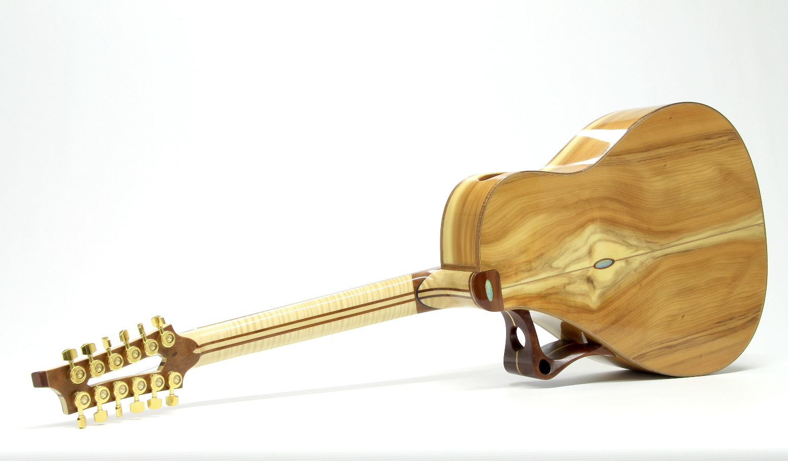

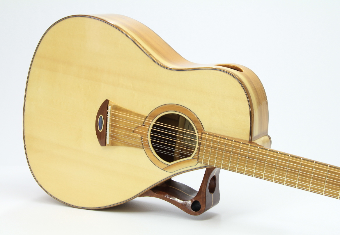

Here's another remarkable guitar from Leonhard Augenstein:
"Last year I had the chance to buy two sets of a beautiful and quite rare (it is under protection, as you surely know) yew from a local wood dealer.
I used one set for my B-model and showed that on a local guitar show. One of the visitors was so excited about that guitar that he asked me to make a 12-string out of the second set together with German Spruce. The neck is made from maple and African Makoré, the Bindings are Tasmanian Blackwood. Fretboard and my bridge design is made from Lemon wood.
He wanted to have a cutaway, a sound port, Inlays with specially cut opal (oriental opal) on four places, he wanted Schaller Da Vinci tuners (!!!) and also a bevel. After some discussion I could convince him to forget the bevel. Instead I proposed to make a quite heavy domed top and, linked to that, an elevated neck, to get a better sound out of the guitar.
After he agreed with all my proposals I built the shown guitar. I had the idea of a separate cutaway for quite a long time already since that would allow the player to play up to the 20th fret without any touch of the sides. My client liked the idea a lot and I made that cutaway (which is a true cutaway actually) out of African Macoré. In the beginning it was quite heavy, but with forming and shaping it the way it finally looks I came to exact the weight that keeps the guitar in perfect balance. It stand perfectly vertical on the little end pin for the L.R.Baggs Lyric!
When I started to work with the guitar, I had your book in mind and what you wrote and explained with the extra weight inside for a better balanced tone. My (a little strange) thinking was “why hide something that can improve a guitar”? What I have built is surely not exactly what you explain in your book. But the result shows me that it even works this way. Inside the sides I have glued two blocks to reinforce the side for the weight outside and the sound of the guitar (which is a modified Dreadnought actually) is exactly what my client expected. Well balanced, it is just played with 10-47 strings and with that it is pretty loud, basses are there but not as heavy as in a normal Dreadnought.
There were a lot of problems and challenges to master. The most difficult one for me were the inlays which had to be covered with epoxy to protect them and later brought to a bright shine. Also the neck with the heavy tuners, the way I connected it to the body to get a totally free play feeling was also very challenging. The strings are fixed pin less, the head is slotted “negative” to save weight and a lot more details that are different to standard guitars.
We have named the guitar “Taxus” which is the Latin word for yew".
