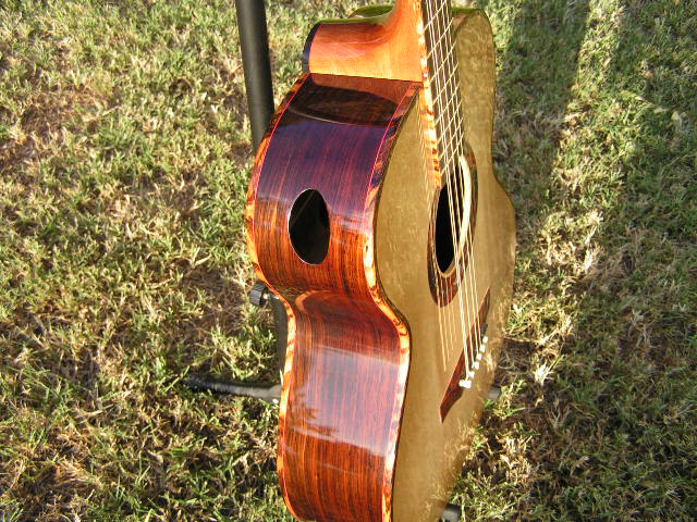

Re: Designing 12-string guitars and baritones
Here is the result, great sounding 12 string, very, very loud, completely compensated nut and saddle cut on my small cnc, set up is as follows.
string height at 12 fret low e .080 high e .070 relief < .010 but > .005, string height at 1st fret .013, .015, for e and b .019 for the rest of the strings, makes for a great playing guitar.
measuring on my tuner cents different at 1st, 5th, 7th, and 12th as best as possible
low E +2 +5 0 -12
a +3 -6 -4 -3
d +1 -3 -4 -3
g +1 -3 -4 -3
b -1 -2 -3 -8
e 0 -2 -3 -6
low E +2 +5 0 -12
a +3 -6 -4 -3
d +1 -3 -4 -3
g +1 -3 -4 -3
b -1 -2 -3 -8
e 0 -2 -3 -6

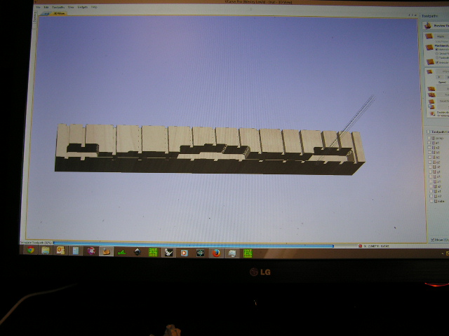

no it would be 12 the first cents error listed is at the 1st fret all based as close as i could get to zero in open strings, comp numbers were derived using a jig with a movable nut and bridge for each string including the octaves then drawen on cad the saddle used the numbers I came up with plus just a little more after adding in the exact postiion of the saddle from the 12th fret.
- Posts: 1643
Nice work Wes. How do you find the playability with the almost uniform string spacing at the nut?
Wow..yeah I just noticed that.Trevor Gore wrote:Nice work Wes. How do you find the playability with the almost uniform string spacing at the nut?
the bottom drawing is the depth I cut into the nut for string height for each string, using a .019 bit for the e and b and octave strings and a .023 for the rest, on the setup I just reduced the bottom till I was close then final adjustments with nut files

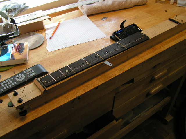

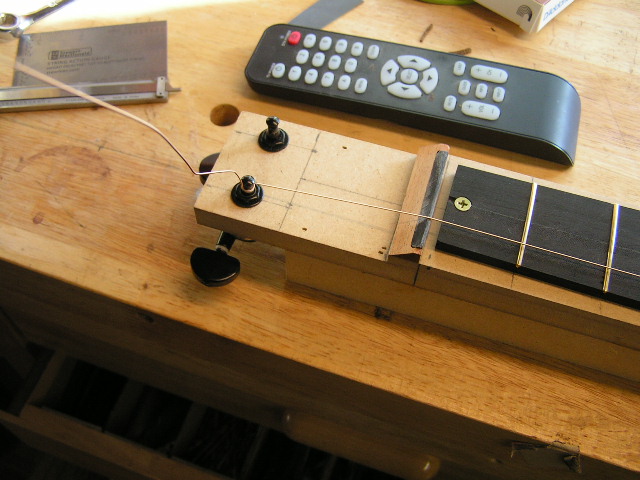

Hi Wes,
Would you please post a pic of your intonation jig? I'm really interested, I have posted some pics of my jig in the "Jigs & Fixtures" section (viewtopic.php?f=24&t=6406).
Thanks,
GregL.
Thanks,
GregL.
Pretty simple jig, consists of a recycled fretboard, a movable nut and saddle, which are tapered so I could slide in and out to adjust string height, the feeler guage stuck in the middle sets relief and a old chinese tuner with a bridge pin stuck in the rear, the app is ap tuner for android, it cost 3 bucks and works great. nut slot is cut in about .200 which is more than is need but leaves plenty of room, there are lines draw for zero fret and front of saddle slot. then I use my handy dandy stew mac string gauge to measure offset, I did this for each string including octaves and then actually used these strings with the exception of the octave g, which of course broke but not till after I measured it, I had gotten 2 sets of string before starting.
- PICT0039.JPG (143.54 KiB) Viewed 28920 times
- PICT0040.JPG (174.6 KiB) Viewed 28920 times
- PICT0038.JPG (148.73 KiB) Viewed 28920 times
Hi Wes,
Looks good. Thanks for the pics!
Thanks,
GregL.
Thanks,
GregL.
