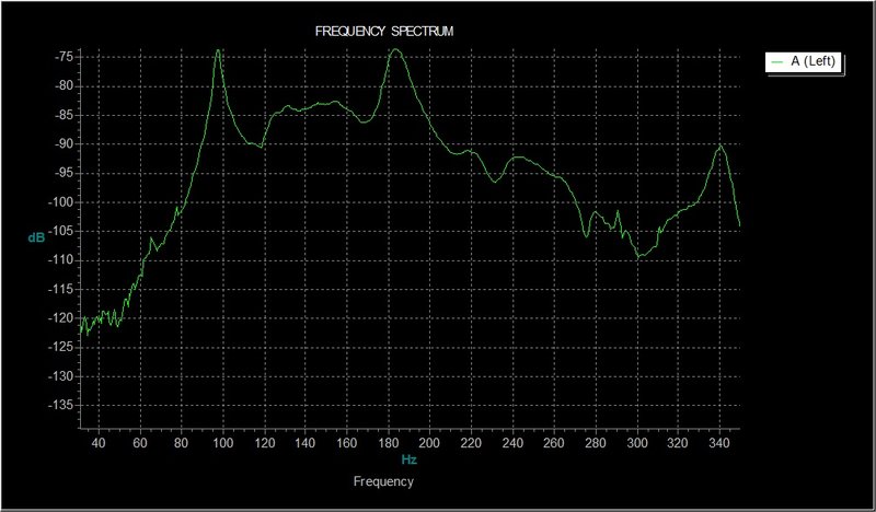

Post by Woodsy23 » Thu Jan 16, 2014 9:31 pm
Trevor,
Your were completely correct. I hadn't checked the microphone input level. It was way too high. How stupid of me. I also had the microphone (a Shure SM58) sitting on the computer deck feeding in the computer fan vibrations.
I guess if you're feeding the sound signal directly into VA only, with no monitoring of the input level, there's nothing to tell you if the input level is OK. So there's a tip for beginners like me - monitor the sound input level by, for example, making a recording of your voice with something like Goldwave. There are, of course many ways to check the sound input level.
Below is a new frequency spectrum which looks much better (to my untrained eye). This time, I had the microphone sitting on a cushion on a separate desk. The computer fan noise in the room is still significant so there's a lot more I could do to eliminate extraneous noise but it does not seem necessary, at this stage of the build anyway.
The peak at 99 Hz is still there but the one at 155 Hz is gone and the Main Top T(1,1) is at 207 Hz - Much closer to Fig 12-49 of the white book.
Do you think it is worthwhile thinning the edges of the top to change the top frequencies? I know you say that it would make the guitar louder buy how much effect would it have on an X braced guitar?
Thanks for your help.

On X-braced guitars the bridge has more of a mass effect than a stiffness effect. So, make your bridge (if you haven't already) and stick it on with double sided tape and tap it again. For a first 12, shoot for 180Hz for the T(1,1)2 if you can get it that low without compromising the structure, otherwise settle for 190Hz. With the bridge glued on, you'll likely come out a bit higher than with just tape, but remember that you'll have a saddle and 12 pins to add on. Don't take the edges down thinner than ~2.5mm unless you really know what you're doing. Have your end point in mind early, so you can get to it without a truck load of side mass.
Let us know how you get on!

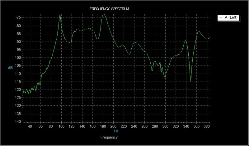

As suggested, I attached the almost complete bridge with double stick tape and retested. The bridge was complete except for tapering the thickness at the back edge so I figured that the mass of the wood not yet removed in the tapering would be about equivalent to the mass of the 12 bridge pins (6 grams) and nut. Anyway, the frequency spectrum is below. The T(1,1)1 has dropped to 97.5 Hz and the T(1,1)2 is at 188.5 Hz.
I would appreciate your suggestions about where to go from here.
Am I correct in believing the T(1,1)1 is getting too low - too close to the G note at 98.0 Hz? For the T(1,1)2, is it feasible to get it down to 180 Hz or is it better to try to get it to 190 Hz, as you suggest for dreadnaughts in 3.2.2.4 of the white book?
Thanks

Post by Trevor Gore » Sat Jan 18, 2014 5:39 pm
Woodsy,
It's hard to give you any more advice than I have already or is in the book. Check out Fig 4.6-3 in the black book and look at the SS X-brace part of the histogram. The chart is for glued on bridges. See how that compares with what you're getting and then make a call. You want to shoot for 180 or 190Hz. You may need to alter the bridge mass, possibly by using wood of a lower density to make sure you get up to 190Hz. You have a lot more information then I have so you are best placed to make the call of whether to go up or down. A well done 180Hz 12 string will be a total killer though.
You could also mass load the guitar in increments whilst tap testing to get an idea of its sensitivity to added mass, which will help your decision making.
I'd say don't worry too much about the T(1,1)1 at the moment. If it ends up too close to G and you can hear it, leave it a good while to see where it goes. If it doesn't move, a small increase in sound hole diameter will fix things. It's a very easy adjustment to do with a sanding block curved to the current sound hole diameter and then a bit of shellac wiped around the hole to seal the end grain.

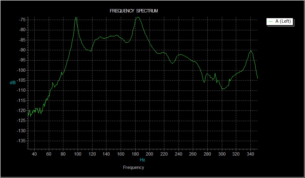

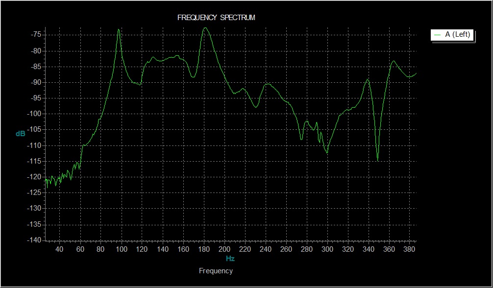

Today, I was able to make 4 steel blocks to mass load the sides and I have some more spectrum tests with two different masses.
I first added 394 grams total (2 steel blocks each side) and obtained the following result. The T(1,1)2 is at 181.5 Hz, a drop of 7 Hz or 3.7%. Figure 2.3-13 would suggest a drop of 3.1% for 400 gm mass loading.
I then removed two of the weights, leaving 202 grams total, and obtained the following results. The T(1,1)2 is at 183.3 Hz, a drop of 5.2 Hz or 2.7%. Figure 2.3-13 would suggest a drop of 1.5% for 400 gm mass loading.
My 2 results are not as linear as the plot in Figure 2.3-13 but I am very happy with the results. The mass loading is more effective that I had hoped (based on Figure 2.3-13). They give me confidence to aim for a T(1,1)2 of 180 Hz. With edge thinning and a mass of a little over 200 grams, I hope I can get close to that value.
I may have to get used to the idea of a heavy acoustic guitar but having a heavy body may be a good thing. With the weight of 12 tuners at the peghead, the guitar may feel more balanced.
I will now proceed to do the edge thinning, following your advice and recommendations. I'll let you know how I go.
Thanks again.
