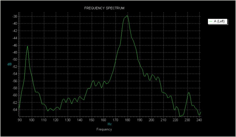

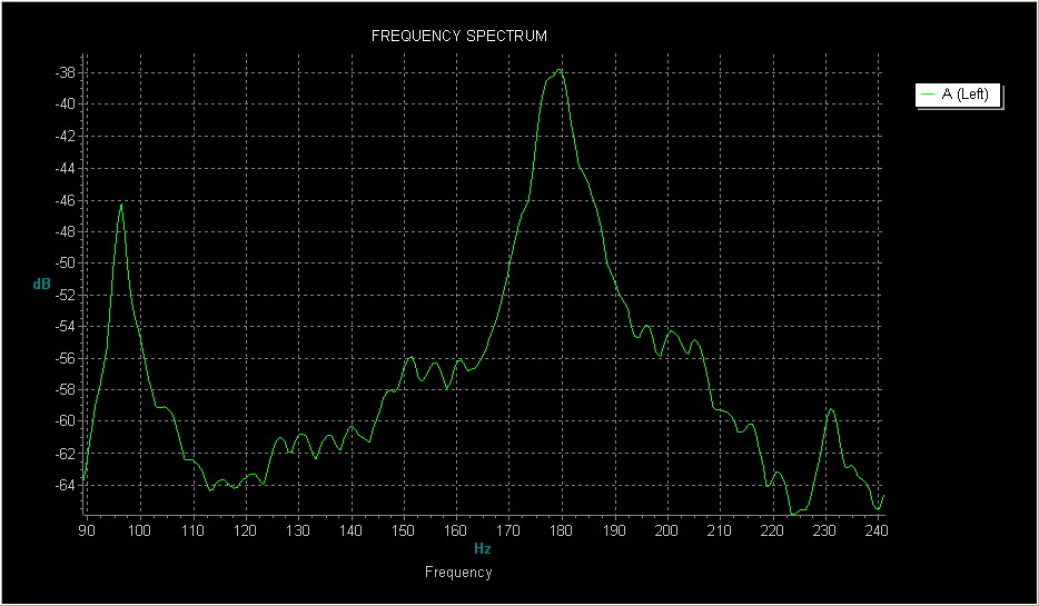

I recently buffed and glued the bridge on a 14 fret SS. Lutz top with Ovangkol B&S . I followed the Books' methods for bracing and thicknessing top and back as well as laminated maple top linings and live back. Top thickness 2.8 mm, back thickness 2.4 mm.
Before installing bridge the the spectrum freqs. were just above 98hz for the main air, 193hz coupled top and around 230hz for the coupled back with minimal scalloping on the main rear brace. After stringing up the spectrum plot is as below with main back brace shaved to around 10mm for about 110mm. I tried adding some weight to sides and back with magnets and washers, couple hundred grams or less, with negligible results. No provision for side mass loading as the guitar seemed heavy for me already at 2.5kg. Since the main air and top freqs. are favorably placed at 95ish and 180. I'm curious as well as cautious as to how to procede with further freq. trimming. The guitar sounds as good as any others I have built but probably not better. I would like better. This was my first based on the books. However it has only been strung up a couple of days and setup is not yet complete, very close though, out of the gate.
Also, the fact that the coupled back freq. doesn't seem to want to readily move for me means what? that the back is not as live as we would like it? perhaps.

Interesting! I've not built with Ovangol, but that seems like a heavy guitar. Mine come out at about that for a 000 size (the drawing in the book) with weights added, EIR B&S. They clock in around 2kgs without the added mass. Ovangol is in the same density range as EIR, but stiffer, if the Wood Database sample is representative.Ken Lewis wrote:I tried adding some weight to sides and back with magnets and washers, couple hundred grams or less, with negligible results. No provision for side mass loading as the guitar seemed heavy for me already at 2.5kg.
Unfortunately, adding mass using magnets won't get you anywhere. The added mass needs to be seriously attached, which means fully torqued M6 socket head cap screws when I put the weights in. If there is any chance of the weights not moving with the sides they don't work.
Try taking a tap response of the back and check if your 231Hz peak actually is the T(1,1)3. Did you measure the monopole mobility?

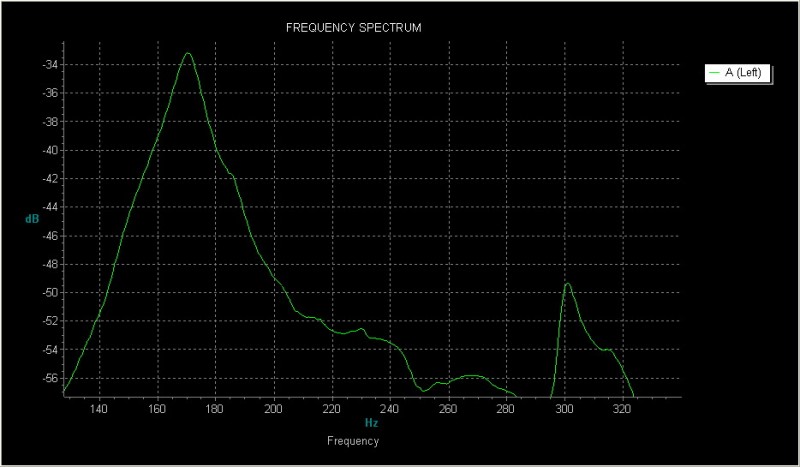

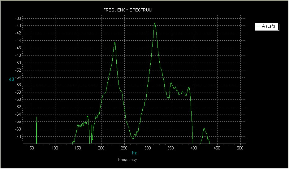

Getting to Trevor's response I did some more tap testing and ran the numbers for monopole mobility. Bridge rotation is 1.7 degrees. Other guitars I've built came in closer to and just a little over 2 degrees. This one a little stiffer no doubt due to the CF. I came up with 24.5 s/kgx10^-3 for monopole mobility. I'll give the data so that you can double check for me.
Mass .448 kg (measured 1 lb.dumbell)
Deflection .0001016m (.004 in. measured)
Closed box frequency 170hz.
With a 2 lb. dumbell the deflection was doubled.

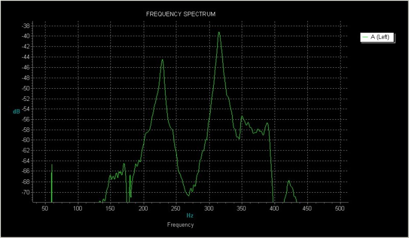

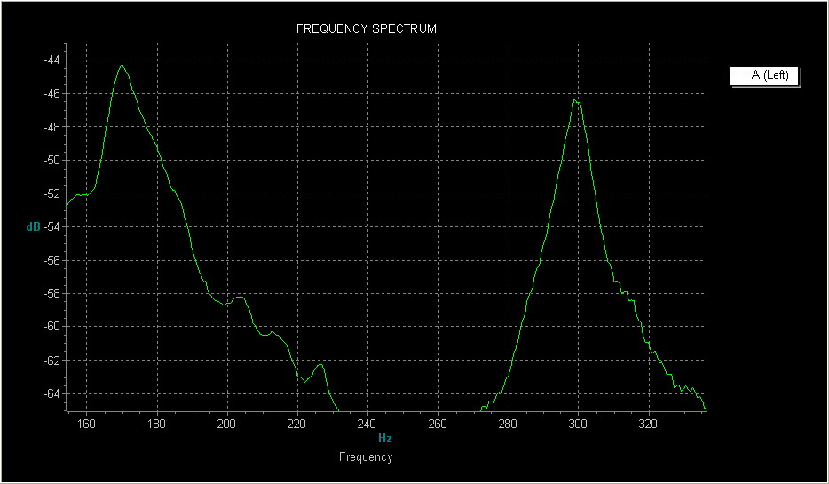

I've included three taps all with soundhole plugged. Trevor when you said to do a back tap test I assume you meant to tap back with soundhole plugged, I am not sure. The middle plot labeled back-back closed is the one where I did this with 230 hz showing up. Perhaps you could clarify this for me. The guitar sounds fine, I just want it to be all that it can be, and learn a few things in the process. Maybe 230 is ok for the back, just not sure?, maybe shave more off back brace but am aware that might mean moving main air and coupled top freqs. to less desirable locations.
Thanks for your help.
Ken

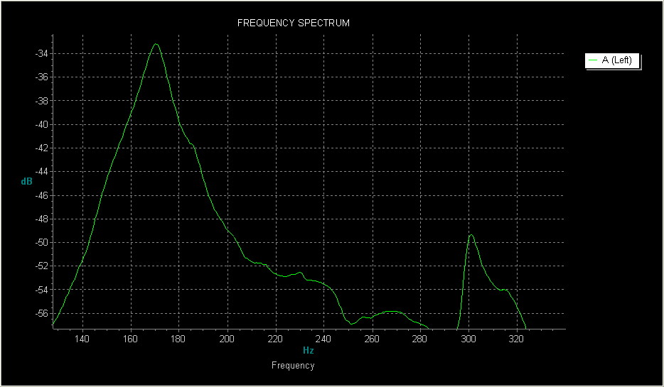

Here is my data for the half plates for the lutz top
L 563mm
W 210mm
t 5.3mm
mass 243g
fl 99.4hz
fc 174hz
flc 69.25hz
By all means please run the numbers as a check for me. I came out at 2.8 mm
Oh! I used standard SS top numbers for f (75 I think)
Ken

The maths checks out OK, Ken. Certainly pretty high!Ken Lewis wrote:I came up with 24.5 s/kgx10^-3 for monopole mobility. I'll give the data so that you can double check for me.
It doesn't really matter, Ken for the purpose of this exercise. I just wanted to be sure that what you were seeing was the T(1,1)3. You're showing a peak at 230Hz on your back/back plot, which is probably the back monopole, though normally the back main monopole is the tallest peak in the picture. You seem to have something going on at ~300Hz. Do you know what that is?Ken Lewis wrote:Trevor when you said to do a back tap test I assume you meant to tap back with soundhole plugged, I am not sure.
With a 180Hz T(1,1)2, having the T(1,1)3 at ~230Hz is fine. You could drop the T(1,1)3 a little if you wish to a 4 semitone separation (226Hz) though the difference in sound would be fairly subtle.
It seems like you've been making some nice guitars!

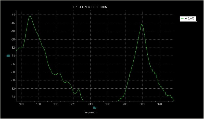

Trevor Gore wrote "You seem to have something going on at ~300Hz. Do you know what that is?"
Not sure at all, thinking it could be just ambient or system noise I recorded some taps using a recording software (Audition) whereby I could do a noise reduction thus eliminating anything other than sound from the tap. Checking the FFT's still there, seems to be more prevalent when tapping the back and with soundhole plugged as seen in the plots in my previous post.
With soundhole open T(1,1)2 T(1,1)1 T(1,1)3 have amplitudes in that order with the one at 300hz being lower than these.

I also did some more tap testing, (again after rereading some more) this time more systematicly, paying close attention to where I was tapping. Trevor asked about the peak
at around 300hz in one of the plots, as to what it is. I'm thinking it is the cross dipole freq. because I can call it up to a high amplitude by tapping the bridge wing. I am not set up to
do Chladni testing so I haven't thought about this before. It's in the book though.
