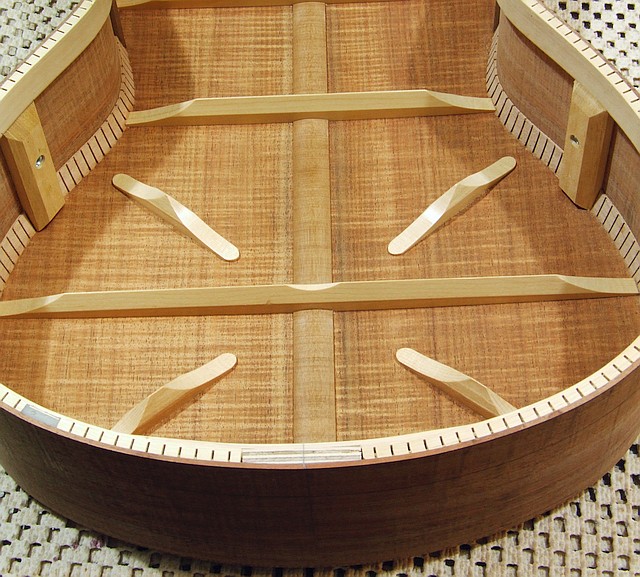

You can get an idea of the B(1,1) by tapping the back once it is glued to the sides and this will give you an idea of where the T(1,1)3 will land, so you can pre-do some of the scalloping. I've been trying a different type of scallop that is a bit easier to adjust and it seems to work OK. I just file a notch in the centre of the lower back brace using a piece of aluminium tube about 140mm long by 65mm diameter with coarse sand paper on one side and fine on the other. I file a starter notch in before I close the box and then deepen it working with the same tool through the sound hole to fine tune things. The tube will just fit through the sound hole of most of my guitars.

Trevor,Trevor Gore wrote: I've been trying a different type of scallop that is a bit easier to adjust and it seems to work OK. I just file a notch in the centre of the lower back brace using a piece of aluminium tube about 140mm long by 65mm diameter with coarse sand paper on one side and fine on the other. I file a starter notch in before I close the box and then deepen it working with the same tool through the sound hole to fine tune things.
Is there a minimum height of brace at the notch that you wouldn't go below? There must be some point where the depth of notch weakens the back too much. Do you find that you always get the back frequency you want with sufficient brace depth remaining?

I've never had to go particularly low. I'd probably start to broaden things out if I got below where the gabling starts. How strong does a back need to be? It's not taking much load!Woodsy23 wrote:Is there a minimum height of brace at the notch that you wouldn't go below? There must be some point where the depth of notch weakens the back too much. Do you find that you always get the back frequency you want with sufficient brace depth remaining?
Here's one I broadened out a bit using the same sanding tube I mentioned before:
I can't remember where it finished when fully tuned, but I took some more out of the middle for sure.

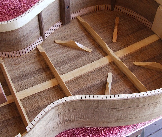

I've wondered this. Using a floating brace to connect the four ladder braces has become popular, and Rick Turner used carbon fiber to reinforce the arch of the back on a number of guitars, though I'm not sure if he still is. The purpose of both approaches is supposed to be to strengthen the arch and reduce the need for a neck set in the future, but I'm not sure how the floating brace reinforces the arch, or how reinforcing the arch prevents neck resets.Trevor Gore wrote:Woodsy23 wrote:How strong does a back need to be? It's not taking much load!

Apart from that dumb Martin design where they chamfered away most of the bottom of the neck block, I've never seen neck angle failures associated with the back of the guitar "stretching". All my guitars have a back dome of 3m radius, so, if anything, they should be more prone to exhibiting problems of this sort. They don't. Nothing. Ever. Usually it is the head block folding into the sound hole that causes problems. Why? There's a big hole in the support structure (the sound hole), often with inadequate bracing around it, with a panel made of thinner, less stiff material with much greater load on it. So where's it going to fail?
Anecdote: I just made a replacement neck for a guitar that is ~ 5 years old. Not that there was anything wrong with the original neck, it was just about perfect with a buzz free 2.2mm/1.8mm action, but the owner wanted a different nut width and neck profile. The panel curvature templates fitted over it like the day if was made, so no measurable distortion. It was a bolt-on/bolt-off neck, of course, which is pretty well engineered with the primary falcates and sound hole braces let into the UTB which butts the neck block top plate. Ain't goin' nowhere. So I'm not seeing the need for floating back braces or truss rods between the end blocks, etc.
