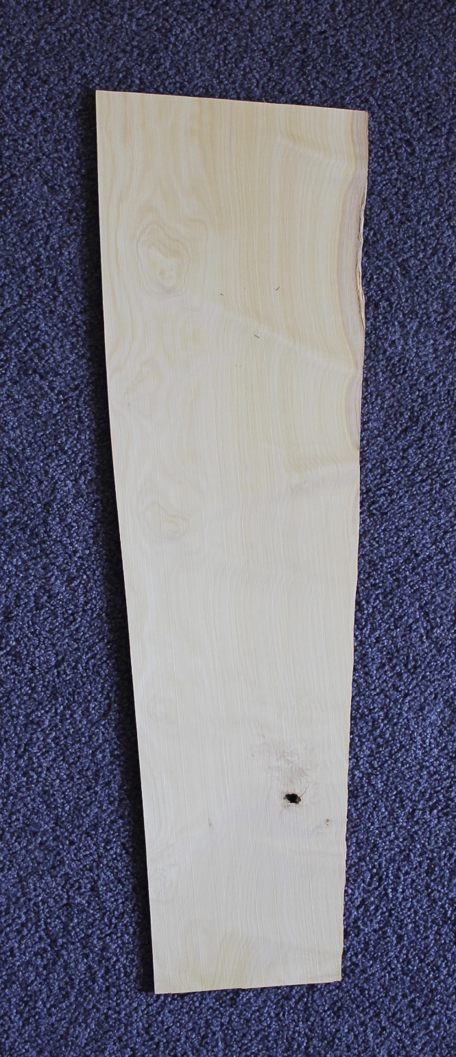

I have some back and top panels that aren't rectangular and due to the odd knot or tree shape etc, the panels can't be made rectangular before joining and so on. I'm attaching an example, but I'm sure everyone would be familiar with this. So Trevor's dynamic method is only valid for nicely rectangular panels, and I suspect, panels without knots or other defects present. I thought maybe the beam deflection method is the way to go, but again I can't see how I can apply that to a non-rectangular panel.
Any suggestions or do I revert back to the "take a stab at what feels about right" method?

The usual method is to find a short section that can be made rectangular and do a 3 point beam bend test on that. However, on your sample, because the grain is all over the place, including knot shadow, its hard to pick a part that is going to be representative. Panels looking like that are usually indicative of high damping. I'd do a quantitative bend test on any section that I could get close to rectangular then a "feel" test to see how well the rest of the panel matched. Then I'd know whether I was totally guessing or just guessing big time.

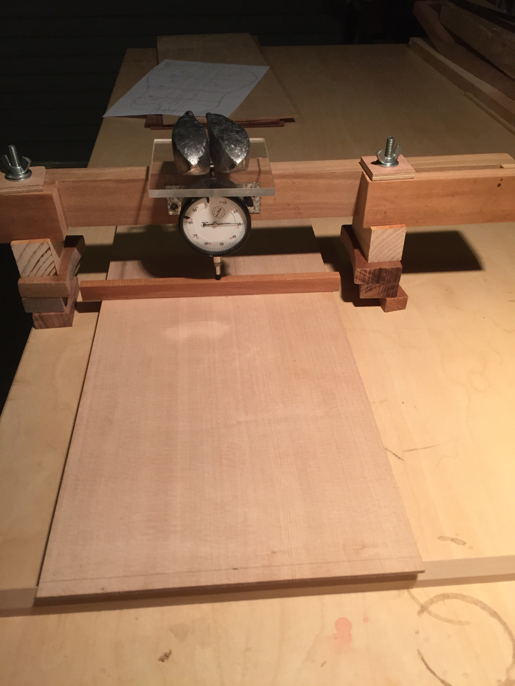

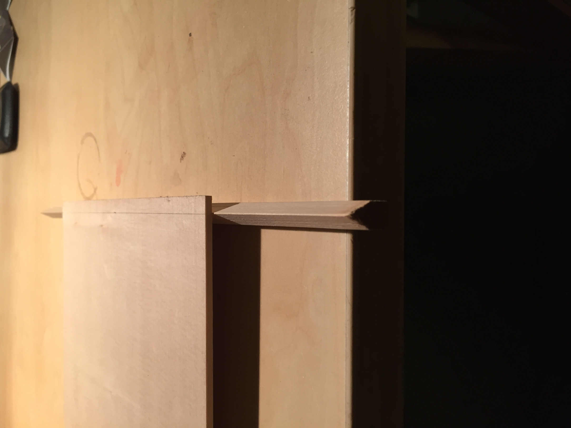

The "Top Deflection Rig" of the style that Trevor and others use can be readily adapted for this purpose. In the photographs below, you can see that I used two strips of "gable shaped" back braces for my line supports. I applied the central load via a transverse piece of stiff timber (at least 20mm high) to ensure that all points across the middle of the piece deflected equally.

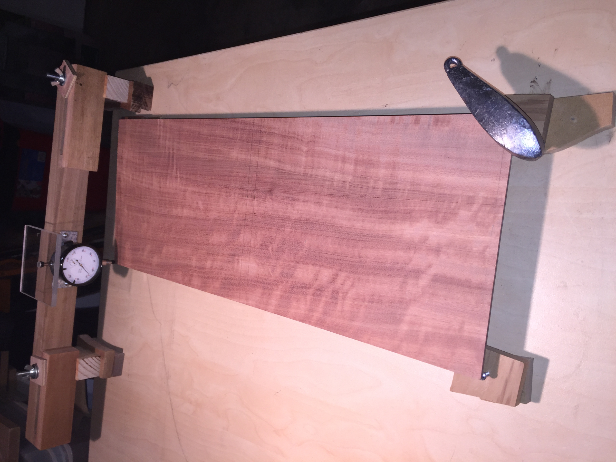

Determining the Glc is also difficult. I have set up a test on a whole piece to measure the deflection of one corner with the three other corners point supported. (See photograph) However, I don't have a formula for the corner deflection of a rectangular panel as a function of the Glc. Maybe Trevor knows one that could be used to back calculate the Glc.

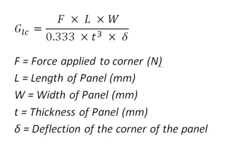

In my post above I said that I don't have a formula for the corner deflection of a rectangular panel as a function of the Glc. However, I have just realised that the deflection of the corner of a rectangular panel with the other three corners supported is equivalent to the twist of a "beam" with one end fixed against rotation and a torque applied at the other. The plate is effectively a very flat beam. The rotation angle at the end of the beam is given by the formula:
For a thin plate, the Torsion constant is given by where b is the plate width and t is its thickness. If both b and t are in mm, J is in mm4 and G will be in MPa.
So the value of G can be determined by rearranging the formulas.
For panels that are not uniform in width, determine the J value from the average width.
I have quickly put together an Excel spreadsheet which I can mail to anyone interested.
where T is the torque (N.mm), l is the length of the plate (mm), J is the torsion constant of the "beam section" (mm4) and G is the Shear Modulus we are looking for (MPa). The rotation angle is in radians. The applied torque is the load applied to the corner of the panel (N) multiplied by the distance from the load point to the support point adjacent (mm).For a thin plate, the Torsion constant is given by where b is the plate width and t is its thickness. If both b and t are in mm, J is in mm4 and G will be in MPa.

For the pieces that I did a twist test on, I couldn't get a good value for Glc from the dynamic tests because I was not getting the distinct peaks for the longitudinal and twist frequencies. I determined the Glc using FE analysis of the panel and adjusting the Glc until the corner deflection matched the test deflection.Trevor Gore wrote:How does it correlate to dynamic testing results?
I have checked the calculation of panel twist angle using the formulas in my previous post against an FE model with the panel supported at three corners and loaded at the forth. There was very close agreement (within 0.5%).
Using the formulas in my previous post, a simple formula for Glc can be obtained by assuming the supports and loads are exactly in the corners and that the twist rotation in radians is approximately the corner deflection divided by the width. The simple formula is:
