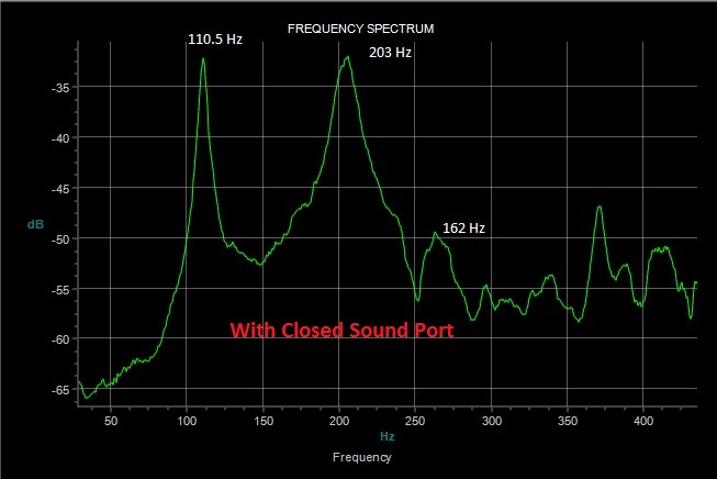

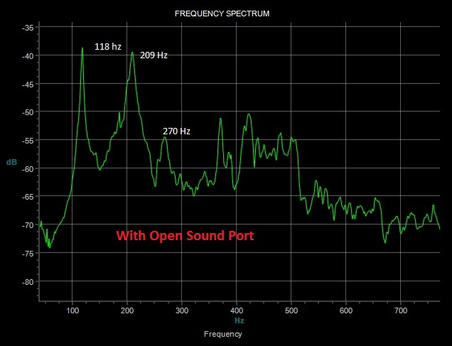

During a discussion on the effect of increasing the sound hole from 3.5 to 4", a question came up questioning whether a sound port would affect the guitar in the same way. It occurred to me I have a permanent setup that allows me to do spectrum analysis and I have a small guitar with a sound port. My sound hole on this guitar is 3.68" so an area of 10.64 sq-inch; my sound port is a true ellipse 2.816" by 1.373" so an area of 3.03 sq-inch. In the discussion I stated (based on information in the Book) that a change from 3.5" to 4" would result in about a 7-8 Hz higher Helmholtz resonance.
A change from 3.5 to 4" is a 2.94 sq-in difference in area. Coincidentally that is very close to the area I added with my sound port, 3.03 sq-in. Amazingly my test showed a 7.5 Hz different in the first resonant peak, The main top resonance and back resonance the second a 3rd peak also shifted down when I covered the hole. So adding a sound port seems to be equivalent tuning wise (with my sample size of 1) to increasing the area of a sound hole.

Matching the difference with area may have been a coincidence, as the Helmholtz frequency should be proportional to the diameter of the sound hole, where area changes exponentially.

Interesting, John. The Helmholtz frequency is proportional to the SQRT(Area), so it might be interesting to do the comparison on that basis. That's based on a "rigid" vessel, of course. I hate to think how all the coupling would interact!

I used sound port area, as I was looking for an equivalent to a change in the diameter of a sound hole. Hypothesis: adding a sound port of a given area is roughly equivalent to increasing the sound hole diameter to achieve the same change in area.
A simple next test would be to make some masks and plot a few sound port sizes. In that case I would think to support the hypothesis the change in the T(1,1)1 would be proportional to SQRT(area). To be a good test I would also have to plot changes in the size of the sound hole. I just used the table in the Book for the change resulting in a larger sound hole.
Looking at the graphs I think that sound port really becomes part of the sound hole as there is not any new peaks that I can see associated with the sound port. It just moves the T(1,1)1,2,3 to the right.
I will make some cutouts for both the sound hole and the sound port to see if what the correlation really is.
