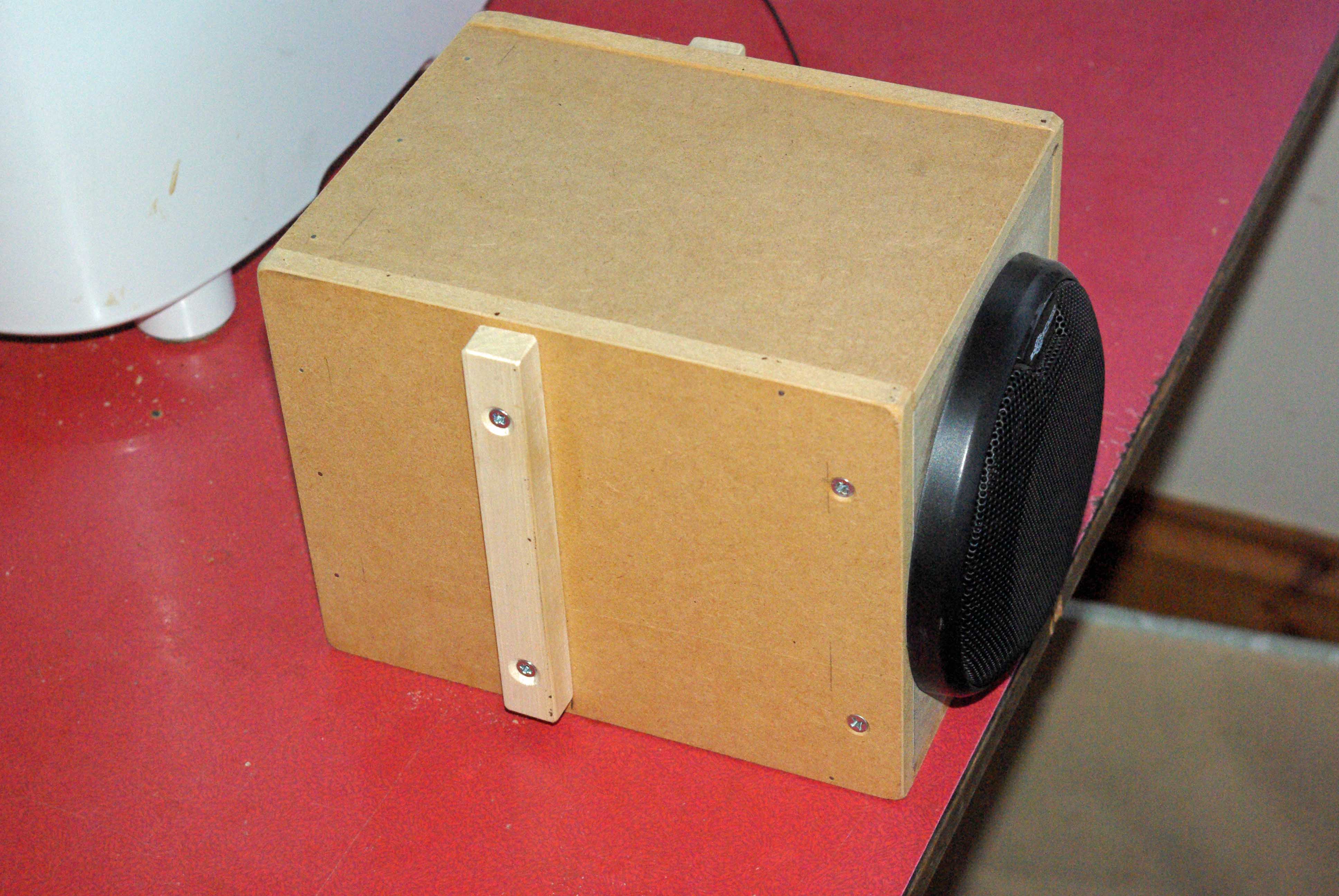

This evening's installment covers the building of the speaker unit. I think it is the part of the system that seems to get the least attention and is likely the root cause of a lot of issues when trying to produce Chladni patterns. So, a few "rules of thumb"to start with...
First, the speaker needs to be quite small. The reason for this is that to excite some of the higher frequency modes, you need to excite over an antinode. Because at higher frequencies the soundboard has divided up into quite small vibrating segments, each adjacent one in anti-phase to the next, you need quite a small speaker to be able to excite over a single anti-node region. A larger speaker will sit over adjacent anti-node regions of opposite phase to each other, with only one being in phase with the drive, whilst the other is out of phase with the drive. The net result is that not a lot happens.
Second, you need a speaker that will produce low frequencies well. In general, small speakers don't work well at low frequency, or are very inefficient. But small speakers generally won't take huge amounts of power, either.
Third, you need to enclose the speaker. They get much louder in front if you can cut out the sound from the back of the speaker which is out of phase and radiating straight at you.
So we end up looking for a smallish speaker that is efficient at low frequencies and that will handle a fair amount of power.
The answer is a four inch (100mm) speaker. Smaller ones don't produce the low frequencies we need. My original unit, which works really well, used a 4", 8 ohm driver from a stereo pair of full range car speakers bought years ago from Jaycar. They don't currently seem to stock the identical driver, but they have similar units in their catalog. I mounted it in an enclosure made from a piece of 140mm outside diameter electrical conduit (probably nominal 5" (125mm) conduit), mounting the speaker at one end on a MDF baffle and closing the other end with an MDF disc.
For the new Chladni box of tricks, I thought I'd build a smaller speaker unit, making it from a piece of 100mm (nominal) uPVC low pressure pipe using a closing cap as a baffle and another cap on the other end. Old unit on the left, new unit on the right:
The new unit uses a 4" Monacor driver with an efficiency of 91dB, 1W/1m, which is about as good as it gets. The frequency response is 70Hz to 7kHz.
The assembly is pretty self explanatory. I needed to trim away a bit of the speaker top flange so it would fit in the pipe cap. I cut the hole out roughly with a jig saw and then found a bearing from my binding cutter kit which fit on a half inch pattern follower bit and ran the bearing around the cap flange to produce a cutout of exactly the right size. (Sometimes you get lucky...) The speaker is held in position by being trapped between the pipe end and the well rammed on cap.
According to the power amp data sheet, (Fig 9), either a 4 ohm or 8 ohm speaker with a 26v supply voltage (what we have) will deliver close to 30 watts. I might experiment with a bit of wadding in the pipe to see if it makes much difference. Otherwise, wire it up and it's good to go.

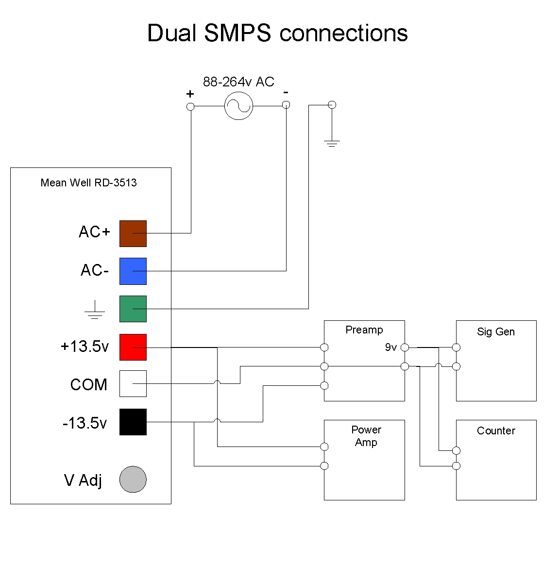

Moving right along to the SMPS's themselves, I've left these until last so you aren't tempted to use them prior when setting up the other modules. These things "do what it says on the can", but can be a bit idiosyncratic. Also, the mains input terminals are pretty close to the low voltage output terminals and you really don't want any mix-ups there. Here's how I wired them:
The voltage trims have quite a wide scope and you can dial up to around 14v on this model. Another thing to note if you substitute a different SMPS is that you may find that the DC negative terminal is also connected to ground, which means that you can't series connect them like I've shown unless you break that connection, because you just get a direct short to ground on the output.

If I may add something about the speaker enclosure... I boxed in a car speaker - they seem to be a useful source of 4 inch speakers - then found that the box was a bit awkward to hold. And you really don't want to drop the little darling on a guitar so added handles.
I intended to support it with a bungee cord but never quite got around to it, but this would also help prevent mishaps!
Cheers Dave
Cheers Dave

Yep, the magnet in a decent driver weighs quite a bit. Certainly not to be dropped. The 4" uPVC is easy to hold by the end caps. I don't glue the caps on mine, but have them fixed with small screws through the flanges. If anyone makes ones of these, either glue them or screw them before you hold the unit over someone else's guitar!

In this post, I mentioned that the power supplies don't always switch on properly. They can also be somewhat noisy, in terms of "ripple" getting through to the output of the power amp, which I guess is a function of them being really cheap power supplies intended for powering LED strings. Whilst looking for a different type of power supply for another application, I stumbled across a dual supply, the Mean Well RD-3513, which is really well suited to this application. It seems that the reason I hadn't found it before is that it is rated at +13v and -13v rather than the +/-12v that I had been searching for previously. The spec says it is adjustable over the range +/-11.5v to +/-15.5v, so it covers the range needed for this application perfectly. I sourced one for $22 from Mouser Electronics. Very fortuitously, it also fitted into the enclosure, once the previous SMPS's had been removed. It works really well. No start up issues and a lot quieter than the previous units. Almost no extraneous noise from the power amp getting through to the speaker. I guess you get what you pay for!
So here is the revised power connection diagram...
