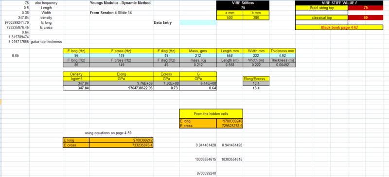

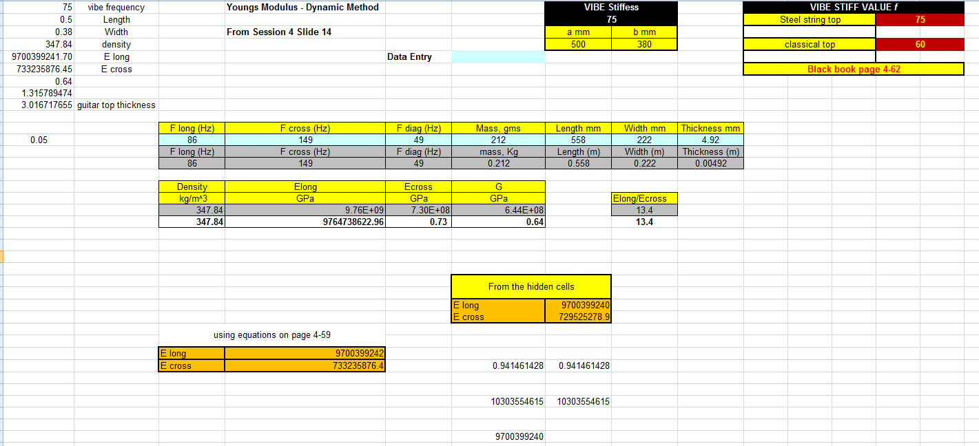

Beginning new build 00 size very similar to a Gilet 00. this is for one of my sons and he has chosen some Engelmann for the top so we have tap tested the top for the following results.
I contacted Kiwigeo (who i received the wood from) and martin was able to confirm that the figures were close to similar timber he had records for
I used Spectrum Analyzer on my phone after reading Steve Toscano's review, initially had trouble getting the Fc so changed my tapping tool from knuckle, to rubber on the end of a sharp chopstick (worked well).
Any comment would be appreciated, some time since I did the course and had used the formula.
NEW BUILD tap testing Englemann

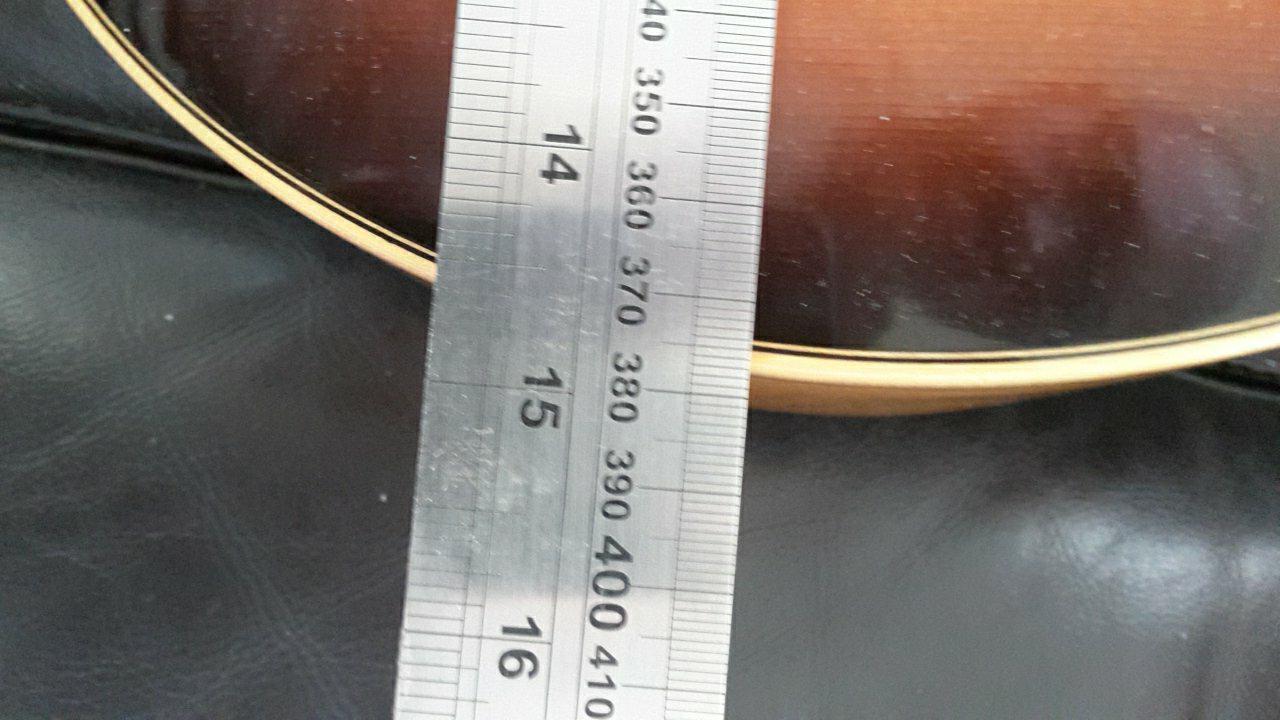

Lower bout at 380mm is large for a 00 sized guitar. They are usually around classical size at 360-370mm. I recently measured one of Gerard's 00's at 370mm. I think CF Martin make them a little smaller than Gerard's version.

Just re-measured and its 378 across the lower bout, I see their website they are 368. so maybe this is 00@1/2 somewhere between the 00 and 000. Beautiful sounding instrument if we can get close to the quality of sound it would be very pleasing.
Just looking at the frequency responses can you tell if a particular piece is stiff across the grain, ie high Fc equals stiff piece of timber across the grain.

The trip was very good, thanks. Was over with Robbie O'Brien doing the Modal Tuning Course a couple of times.
Nice burst on that Gilet guitar!
A high frequency tap tone tells you that you have high E*I (Young's modulus * 2nd moment of area), so just the wood being thicker means it taps higher. You have to work out Ecross to get a comparative measure. An Ecross over 1GPa is pretty stiff wood across the grain.
